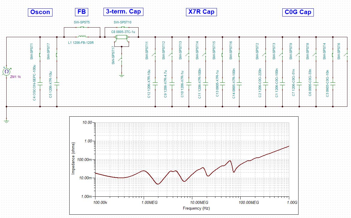

PDN (power distribution network) design and bypassing is a very intresting thing. A lot of capacitor manufacturers provide a proper spice model of the products and you can simulate your network transfer impedance (see e.g. picture attached).
@ Markw4: My question is, how good must be my PDN for a 50Mhz clock oscillator? What are the design steps? (some times ago I've created the excel sheet attached)
Well, first of all that's not exactly what we have here. What we have in one can/module is an oscillator (which is a sensitive linear circuit), a squarer (which is a quite nonlinear circuit), and maybe some associated support circuitry.
There are some things we don't know about the significantly-black-box we call a clock module. We don't know its tolerance to voltage variations, if its more sensitive to voltage variations at certain times in the clock cycle and if so by how much, and how sensitive it may be to interference from magnetic fields associated with ground currents flowing underneath the oscillator. There may be other things we don't know too.
For Crystek CCHD-957 in particular, it is module that has some discrete parts in it (including one or more capacitors), and one plastic case IC. If it has a bypass cap inside the module, we don't know its value and or its parasitic inductance as viewed from the outside terminals where we might place a bypass cap.
Regarding PDN design concepts, I have mostly seen them applied to high speed digital, which is not exactly what a clock module is. Its more of an analog RF device, some of the performance characteristics of which are hard to measure, despite tending to have audible effects at some level depending in part on the particular internal architecture of a given dac being used with the clock.
Normally if we don't have a model of a device in question, we could try to figure out its tolerance for voltage variations by injecting noise into the PDS and observing at what point device failure occurs. However a clock module is unlike a high speed digital device. A clock doesn't simply fail at some PDS noise level, rather its performance degrades to varying extents as some function of PDS noise. Since degradation of its performance is hard to measure (phase noise measurement equipment is expensive to obtain, time consuming to perform statistical measurements, and does not exactly give all the information we would like to know), we have different problems to deal with as opposed to if it was an FPGA or something like that.
As a practical matter, historically speaking a number of different approaches to clock bypassing have been tried. That includes a set of C0G and or mixed C0G and C-II ceramic caps to try achieve a low inductance controlled damping bypass model. Most of that stuff sounded like crap in practice. And don't even get me started on the touchy subject of ferrites.
At some point a fellow forum member, @diyiggy, experimented with a newer type of SMD capacitor, acrylic (or similar) film caps. diyiggy found that the .22uf Rubycon MU cap sounded best in his opinion with Crystek CCHD-957. There was also a CDE .1uf film cap part in 805 size that was his second choice, but it now EOL.
For whatever reason I decided to try the caps diyiggy recommended, and damn if they didn't work they as he said. Since then a fair amount of experimentation and clock board building has occurred which tends to confirm that the small physical size Rubycon SMD film caps work well for dac clock circuits. That said, the same caps don't sound very good in analog audio frequency circuits, so IME they are of limited usefulness.
Thus some of us use the caps for practical reasons without having a more satisfying theoretical justification. I am okay with that since there are plenty of other dac design problems to work on. No need to speed excessive time trying to study why these particular caps seem to work as well as we think they do.
