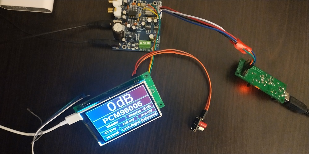

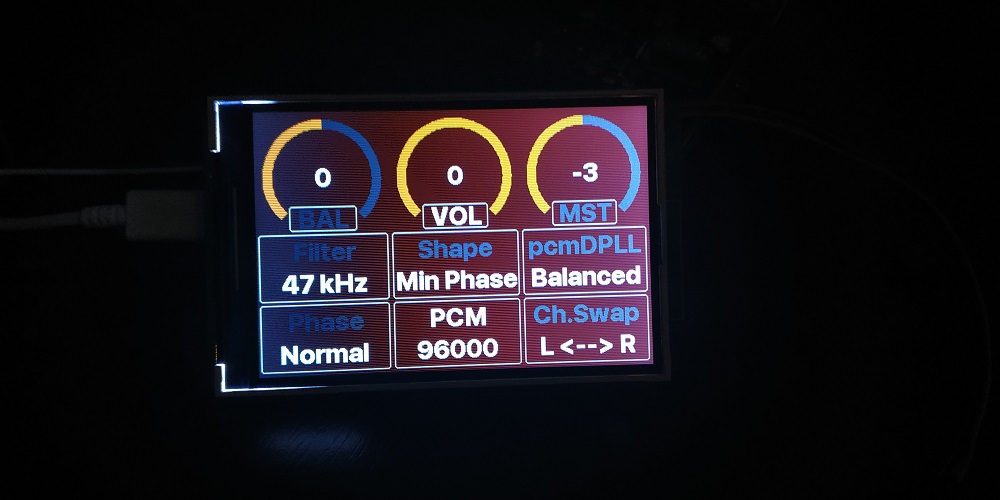

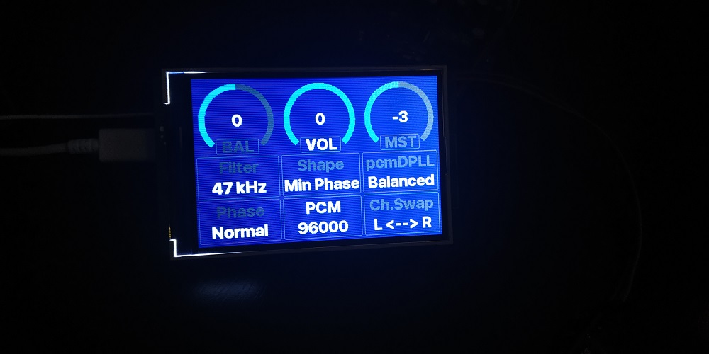

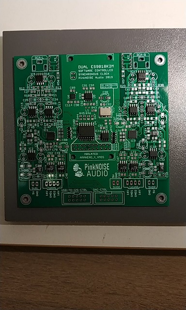

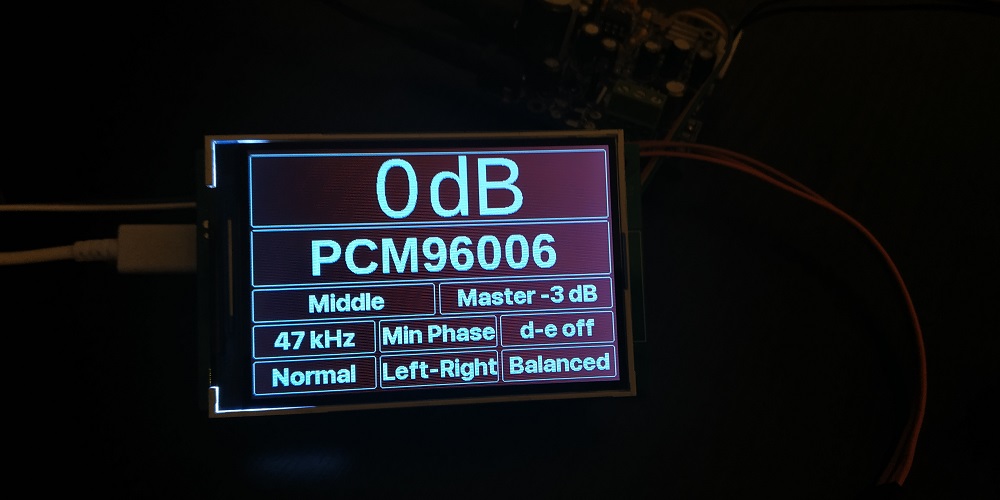

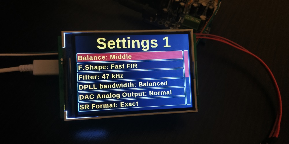

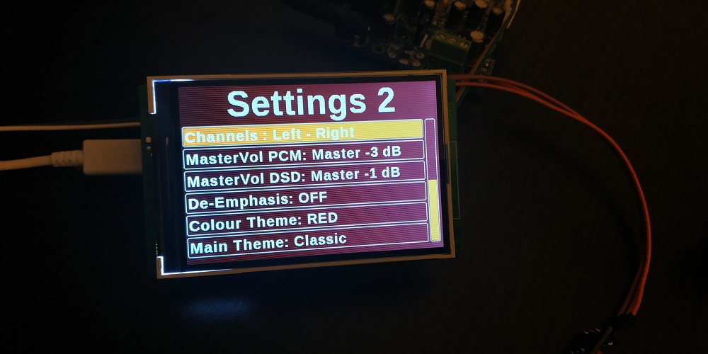

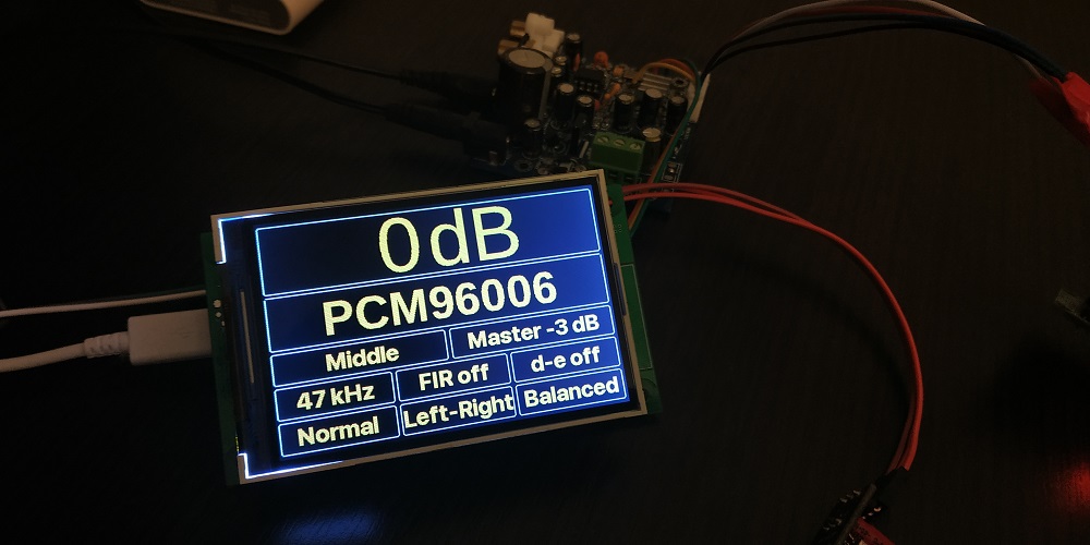

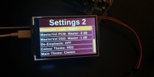

Speaking of I2C control of the dac, I sort of assume that those few who have tried using I2C bus with ES9038Q2M have been using the RPi driver posted by eslei? At least, nobody has asked for any detailed information about how to use Arduino for that, something that seems a bit odd. Of course, maybe some people have already figured it out for themselves so no need to ask?
You are right!
I use Arduino IDE with STM32 (blue pill) for ES9018K2M (9 USD board from ebay) for code testing purposes. I was inspired from the K2M code provided by HiFiDUINO many years ago and from Dimitri's blog Dimdim's Blog | DIY Audio, Arduino, Computers, Music for the hardware and software stuff (i.e. TFT code, I2C isolator schematics , etc). I presume it is not too hard to modify the code for 9038Q2M if you have the datasheet.
There are some pictures bellow, I am sorry for the low quality and the color aberration, but the light and my phone camera are not so good.
My next testing project is 8018K2M dual mono, synchronous MCLK from Si549 (I already made the Arduino library for it) so 90.xxx and 98.xxx for K2Ms, with 542 chip divider for MCLK/2 for XMOS, with simple flip-flops reclock 74AUP1G79 and galvanic isolation. I will finish the PCB's in a couple of weeks, you can see a picture below.
