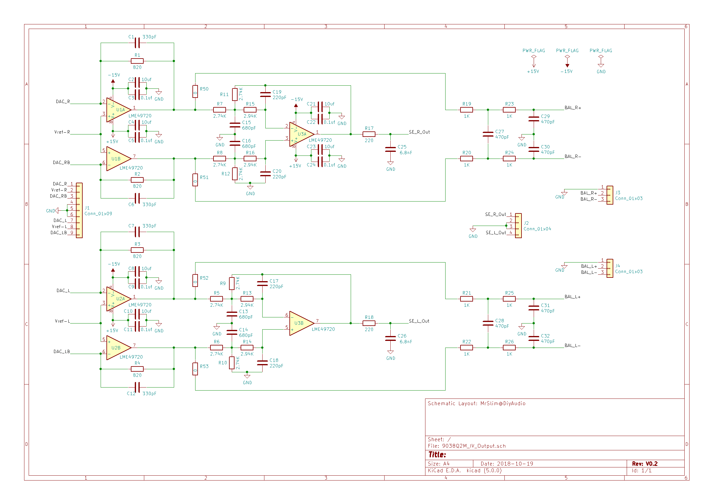

I've looked at the unity gain op amps in the first stage in the schematic, and it goes into an lpf on the xlr alternative. That lpf filter is symmetric around ground, but the first opamps revolves around Vref/2. What happens to the signal because of this? Do each op amp acts as a grounding path for signal from the the other op amp? When combining these signals should these signals ideally be combined around Vref/2? If someone you give me some clarification around how this works it would be a lot easier for me to experiment with other solutions further..
How low could the output resistors in the lpf filters be when driving a 10k impedance (using OPA1612A)? I've been playing 1:4 matching transformer between my pc soundcard and nearfield setup, and it makes a very positive impact on the sound. Better dynamics and a slight tube like sound which I really enjoy. Impedance between components obviously plays a big role, I would like to have the dac's ouput impedance as low as possible.

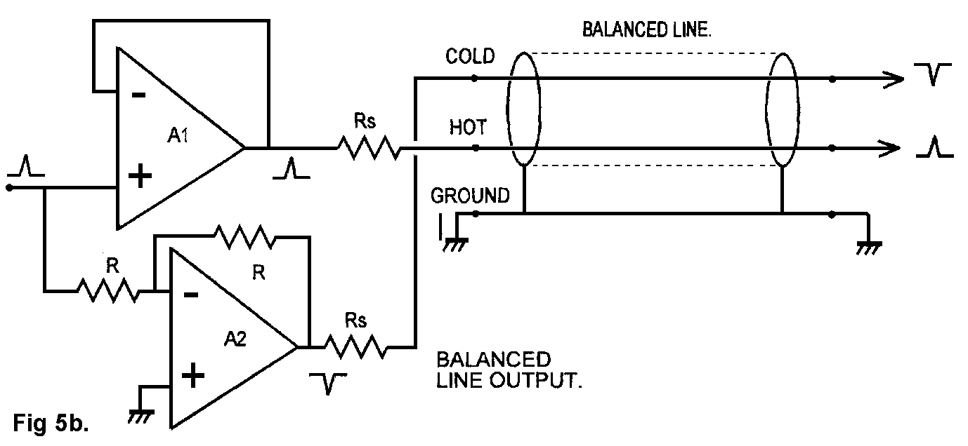

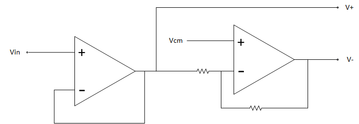

Hi impuls60,
There has been lots of discussion about those balanced outputs since MrSlim added them to the schematic. I personally do not recommend using that method of producing balanced outputs, and have been advising people to add a re-balancing circuit following the unbalanced outputs if balanced outputs are wanted. In most cases the circuits are designed to be symmetrical around ground, although they could be designed to provide symmetry about another common-mode offset. The main reasons for using circuits like these after the unbalanced output it so that the DC offset can be fully removed, and the final output stage filtering can be fully completed.
One of the schematics below shows a terminal labeled Vcm, which could be used to create an asymmetrical common-mode offset, but in most cases it would probably be connected to ground.
EDIT: Regarding the improvement in sound quality you notice, the tube-like sound is probably from a little transformer distortion. Other improvements in sound quality would most likely be from minimizing signal return ground loops. At low frequencies ground returns for unbalanced lines will split up and take multiple ground paths depending mostly on the resistance of each path. There are other ways to minimize problems with that, but using balanced signal lines is one way that can work very well.
EDIT 2: Besides opamps as shown below, there are differential line driver chips available (and also differential line receivers) that can provide very high performance solutions.
That Corporation makes some good ones.

The balanced outputs that MrSlim added to the schematic he drew were basically taken from what ESS was using for their early Sabre evaluation boards. The newer evaluation boards now have additional opamps for the balanced outputs and more filtering, although they still don't use re-balancing circuits.
Probably worth mentioning that the small amount of DC offset on my DAC disappeared after the balanced output was fully disconnected from the unbalancing/filtering op amp's input, before it was connected like Mr Slims schematic.
