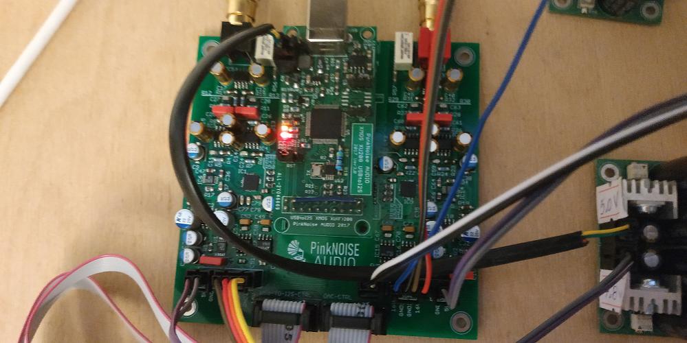

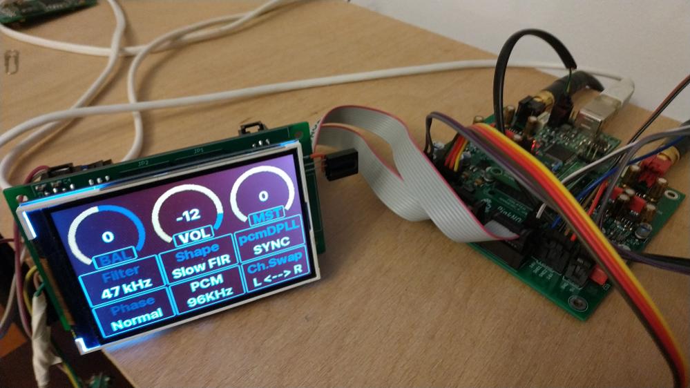

Returning to K2M project:
I don't have any doubts, the best sound is achieved when the sync_mode registry bit is set to 1 - it enables quick lock when fs and MCLK are synchronous. In this case, adjusting the DPLL has no effect since it is by-passed.
I had to modify my code because it used the K2M registry to read the incoming signal sample rate for display it, but when sync_mode is 1, the 4 registries who store the incoming sample rate are empty. At this moment, XMOS board not only switch the MCLK from 90.xxx to 98.xxx, but also it provides the information for sample rate display.
The first issue I have found is that the 1.3V power supply didn't worked. Reading the DAC's registry were tricky for 96+ kHz incoming signal and it took me a while until I figured out. Re-soldering LT3045 solved that problem.
The second issue is that the K2M chips don't like MCLK change (from 90xxx to 98xxx). From the read-only registries I get sometimes strange values, from both dac chips, sometimes from only one dac chip, sometimes from the other. Only when the sync_mode is 1, all the registries have the expected values.
I am still working on that. After I will get a "free of bugs" code, I will try different timing delays and/or hardware reset, software reset and other registry settings to find what is going wrong.
