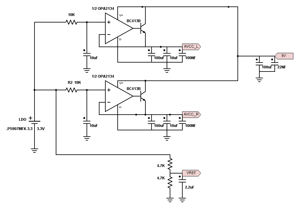

Another version of SABRE AVCC powering.
I am testing original SABRE version, but something troubles me in sound quality (bass impulse response, cymbals clarity, etc.), so I'm trying simple emitter follower, and result is actually impressive...

zenonn67, ES9038Q2M AVCC consumption is < 8mA, OPA2134 output 35mA, hence, you don't need bc413, I guess any 0603 beads 1k@100MHz in-serial, or just 50ohm resistor, may prevent opamp(BTW, quite slow one 8MHz) self-oscillating. bc413 in that circuit will fast charge and slow passively-discharge AVCC caps, and this is not an improvement of regulation for sure.

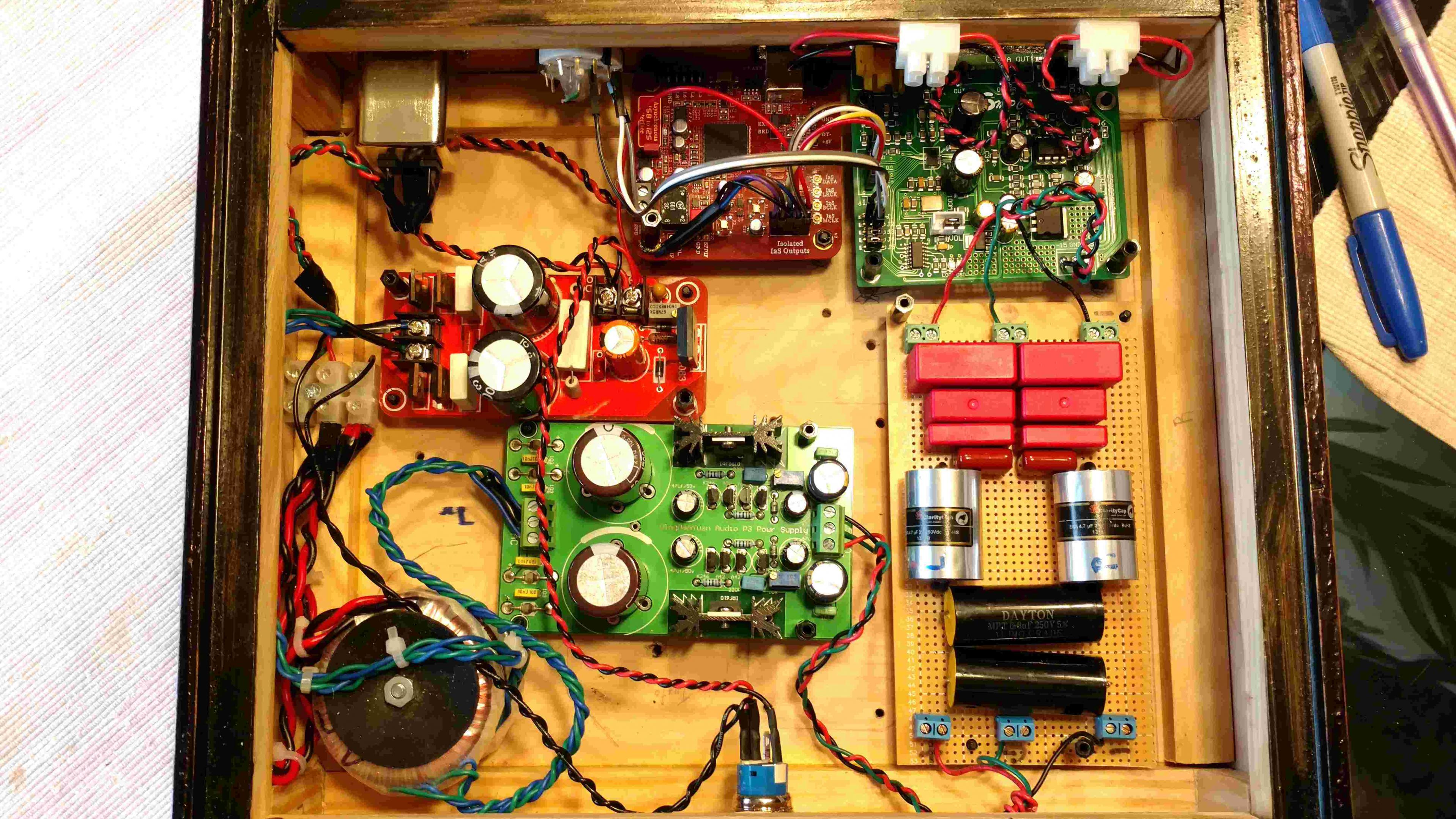

888777, i have used the TPS7A4700 modules one for each channel of the AVCC.
for me this was the best upgrade for the dac, along with the clock.
i have not tried the method that mark suggests though, it might be much better
here as a picture of the finished dac as i promised few months ago🙂

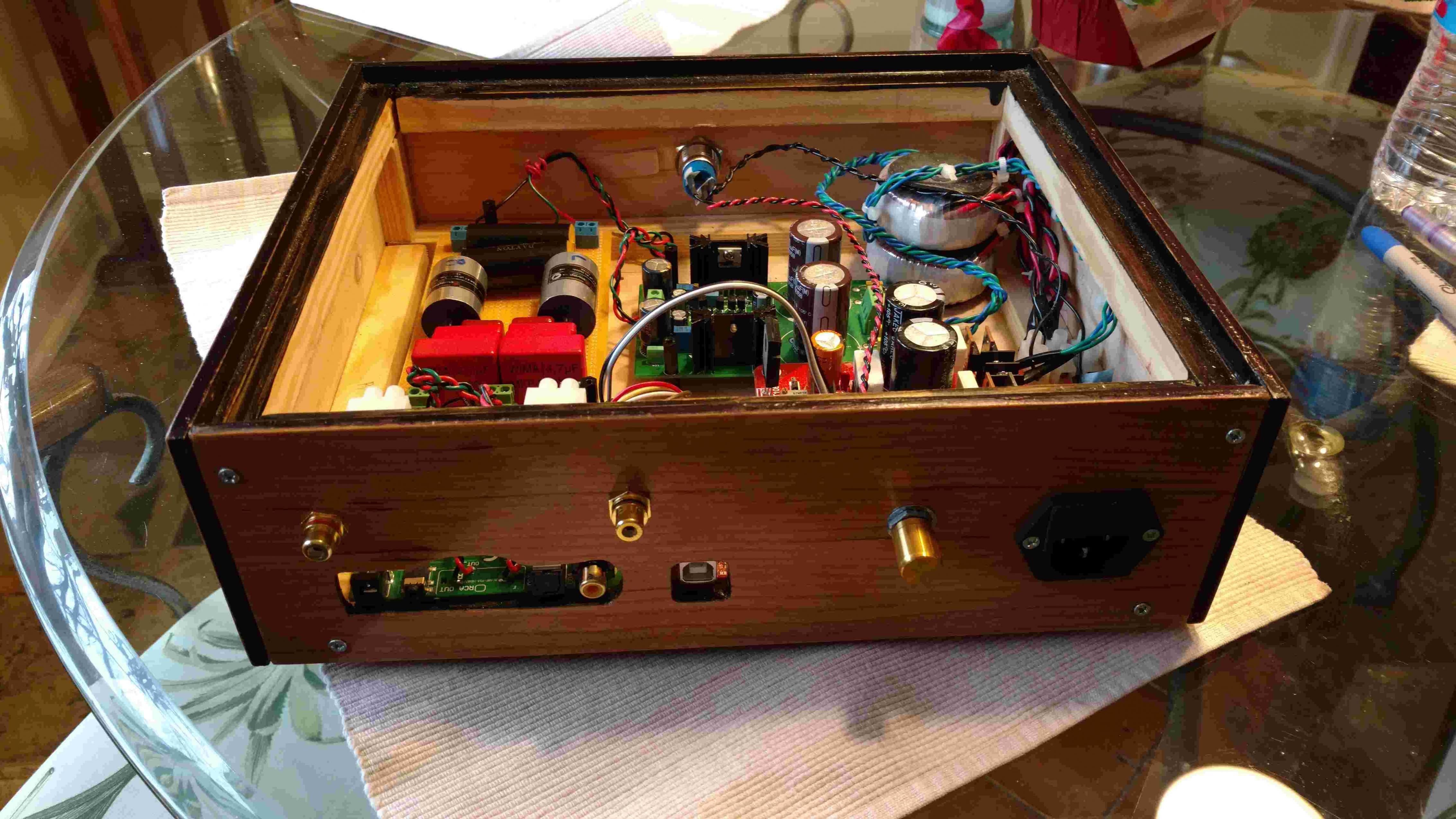

Well it two steps forward and one step back for me. The added capacitance on the AVCC rails did really help a lot and things were sounding really nice. Then the crappy low quality RCA output jacks broke. So I took things apart to fix things by adding some new higher quality ones to the back of my enclosure. This would also allow me to hook up the new output stage. I also decided to try the film cap thing that Mark had been recommending for the =/- 15 v rails. I made up a separate board for the caps and scrounged around in my parts bin for film caps, I managed to put together 18 uF. I needed to rearrange the inside layout to fit everything in the case. What I didn't find out until it was too late was that a tiny blob of solder landed on the pins of the dac chip and shorted it out when I powered back up. I managed to remove it, but the damage was done and the chip is dead. I've got a new board on the way.

...a tiny blob of solder landed on the pins of the dac chip and shorted it out when I powered back up. I managed to remove it, but the damage was done and the chip is dead. I've got a new board on the way.
Ouch! Which pins got shorted out on the dac chip? Just wondering because the chips might not be that easy to kill in most cases if all the pin solder connections are returned to normal. The reason I ask is because it can take some very tiny and sharp needle tip probes to actually come into good contact with individual dac chip pins. Ringing out back to solder joints or connectors at the far end of affected traces may show opens, or there could still some solder shorting two pins together. If by chance you don't have needle probes, you can use a jumper clip to make a sewing pin or needle into a probe tip for your DVM to probe for good connections at the actual dac pins. Easiest with a DVM that can be set to give an audible tone for continuity testing so you don't have to take your eyes off the probing.
To remove excess solder, usually adding a bit of paste flux and using good quality solder wick and a larger, but sufficiently sharp chisel solder iron tip to get down right next to chip and heat quickly may work best. In fact that's one way to solder high density SMD pins, simply use enough low temperature leaded solder to short the pins together a little out at their ends, but not so much solder as to get it way back under the pins, then remove the excess with solder wick. Usually it wicks out all the solder shorts very effectively while leaving the pins nicely soldered.
