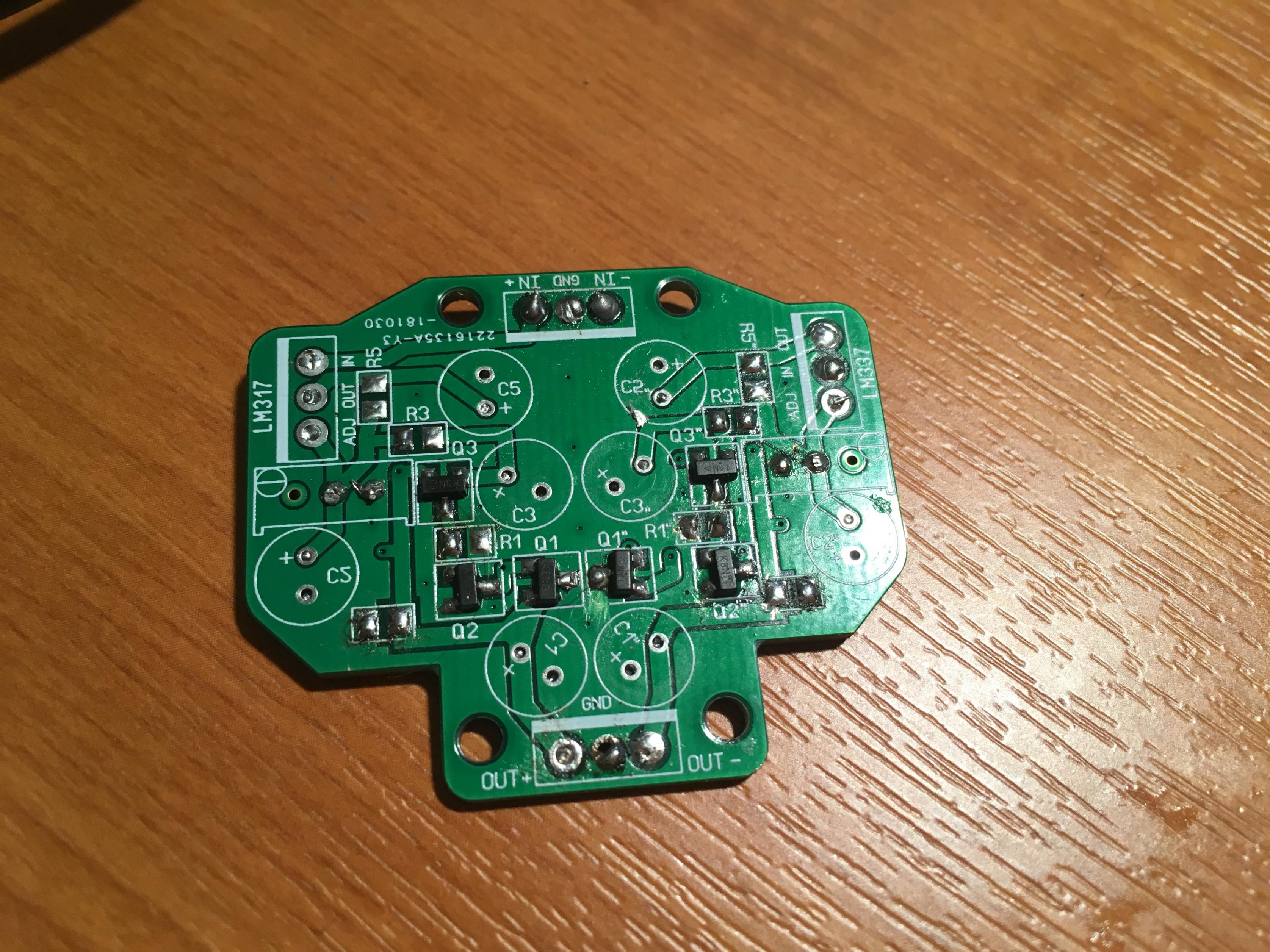

But there is no scheme and you can’t see what's what on the photo ... So I’m not risking buying.
I actually have one of those here and sketched out most of the schematic. It is not as good as a Jung regulator, and not the right design for AVCC. Might be usable for +-15v, but maybe with a pre-regulator.

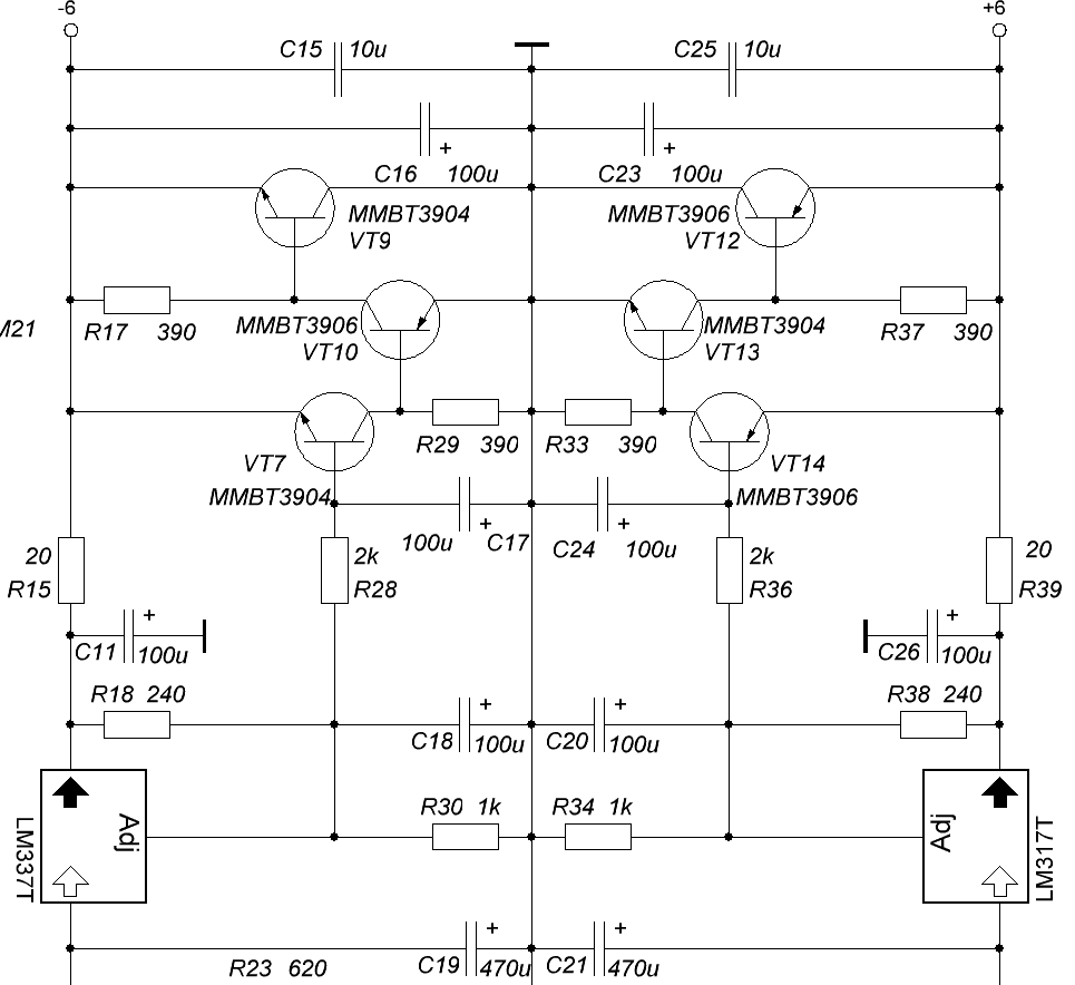

a while ago I mentioned the use of LM317 based Nazar's shunt regulators. 317 there has a triple function of pre-regulator, ripple dumper, and a reference. Put it dual voltage version for I/V and LPF opamps with some 30mA current and there won't be a need for ridiculous capacity film caps there.

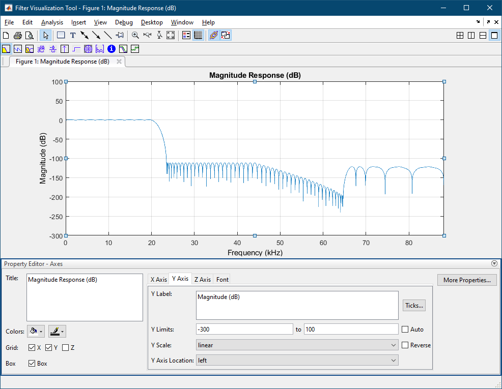

Here is my first custom FIR interpolation filter. It is also linear phase, but it is not so vibrant as built in Slow Roll-off filter and it is not so laid back as built in Fast Roll off filter. The next filter will be an "Apodizing" one, as in ES9038Q2M, but I have to figure out how to also keep the phase linearity.

as I said, there is no need for ridiculous capacity film caps there. I really doubt whether you have paid attention that 3-transistor version has about 5mOhm FLAT impedance over the audio range and some -120db PSRR. if you wish I can send you little pcb with smd soldered.
just tell me what voltage and load you prefer.

as for the Nazar's the simulation and measurements you can find here: Nazar vs Salas_Output Impedance: アナログ回路のおもちゃ箱

Looks like Nazar's regulator is using LM317/LM337 as the current source for a shunt regulator. However, the shunt devices are 2n3904 or 2n3906 depending on supply output polarity. If I have found the right information, do you think they have any benefits for sound quality as compared to other good shunt regulator designs? Obviously, they have some benefit of simplicity when a small shunt regulator will do.
basically I have design as shown here:

the shunt transistor type depends on how much power it should deal with, so current set by R15/39 and output voltage. their value can be calculated R=(1.25-Ueb)/(0.3/Uout)+Iload
Ueb typically 0.65V, 0.3 stands for the max wattage of the transistor in this case. so if one wants to pump more current then something like BD139/140 should be used. LMs need some 4V overhead, and the whole thing radiates a little heat. anyway, the noise is in uV range, but the impedance is what rules. elcaps better not very low ESR, the reg may start to oscillate. ceramics perhaps better np0, but i am fine with x7r so far
Interesting, but only so much can be done with the internal filters. For best results they would need to go into an FPGA, ideally a low-cost one like Spartan 6. Unfortunately, it is a lot more involved that getting coefficients from Matlab and loading them into the dac filter. More can be done with the PRO chips if they are configured for stereo only then the number of coefficients for custom filters can be doubled, which might actually help some. Even that isn't as good as external filters in combination with upsampling.
