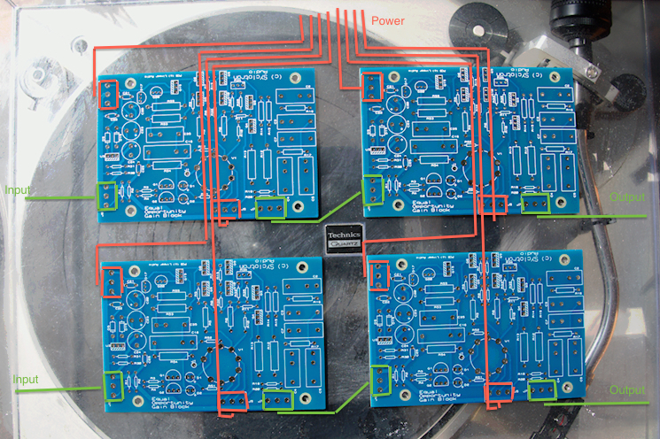

I have been making steady but slow progress on my EQ OPP build. This thread as been very quiet. Am I the only one actively trying to build this pre, or is everyone else just have fewer questions?

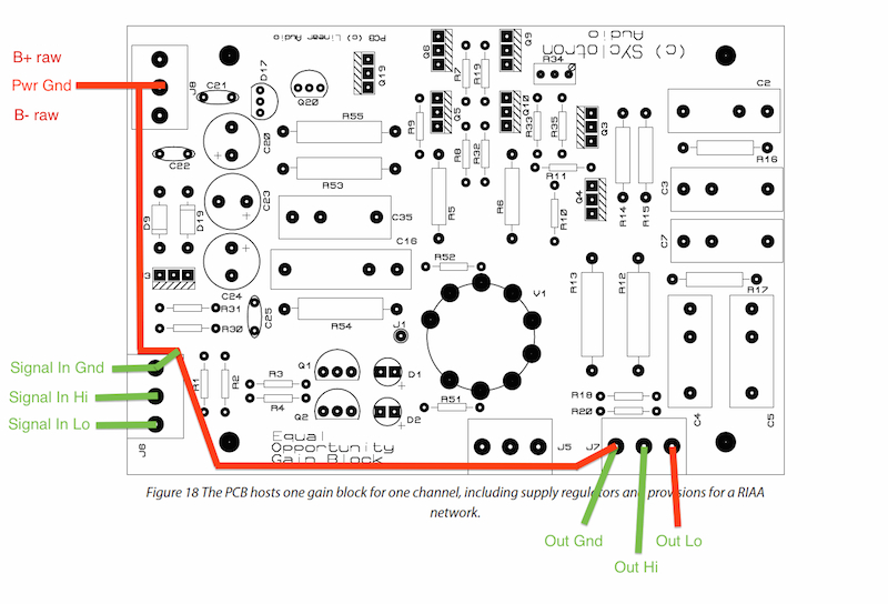

I have been thinking about the layout of the boards and their power wires. Of course, having regulated DC power and a good design for noise rejection should help, but I might as well use good practice and minimize any noise risk.
The boards are laid out such that you can't help crossing under the signal sections of the PCB. My current thought is to run power for the lower boards under the middle of the PCB where the CCS and tube live. Please see the photo for a rough idea. Red is power and green is signal.
I am open to ideas. You gents have much more experience with this than I do. I could shield the power wires if helpful.
Thanks in advance.

You are probably ahead of a lot of us. I have the boards waiting until I can get around to building them, but have to sort out a miniDSP, 4 power amps and a speaker rebuild before I start. Oh and deal with the baby!
In terms of the power cabling as long as everything is twisted together properly it shouldn't be an issue You have the 'cross' between the boards you can use for routing power wiring. Of you could put the regulators centrally.

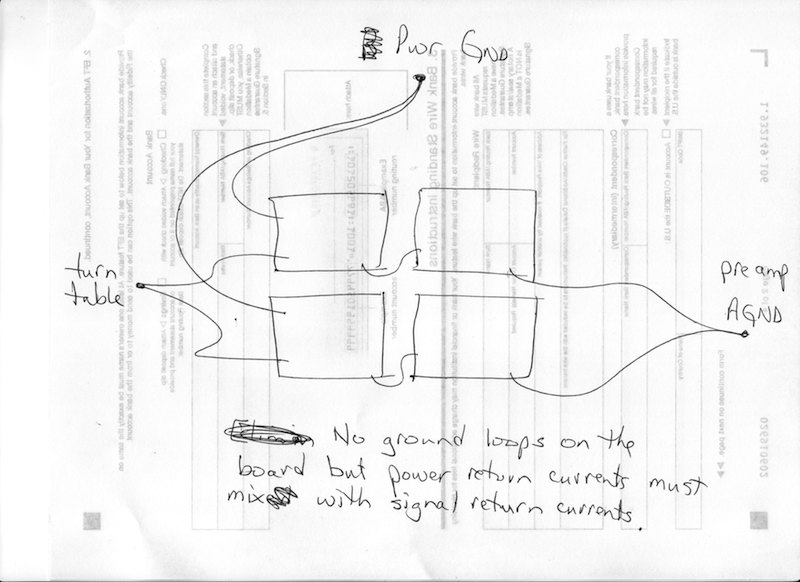

I have been looking at the Didden boards and thinking about ground loops. I am mostly thinking out loud here, but would be grateful your thoughts on the subject.
As shown in the first figure, the power, Signal In, and Signal Out grounds have a common connection on these boards. I would guess that they would be a fairly equal potential on the board, given the relatively large ground trace.
Since we have two boards per channel in series with each other and are using a common B+ and B- power supply ground, running power to each board in parallel would be the natural thing to do. The next figure (sorry for my poor hand drawn illustration) shows the ground wires only. This approach would seem to open the door for multiple ground loops with different impedance. Also, there is no isolation of the power supply currents from the signal circuits. On the other hand, it is nice because it allows the power and return lines to run together and twisted.

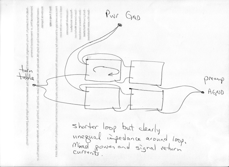

The next figure shows a possibility where the second gain stage is powered in kind of a slave to the first gain stage. Power supply and return can remain together and mixed power supply and signal currents are the same as the first option.

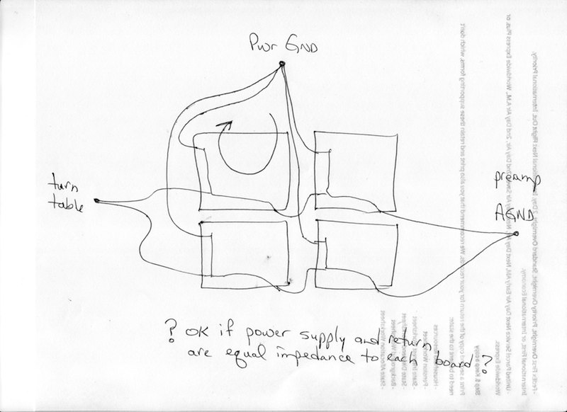

The last figure shows using only one power ground per channel (although B+ and B- would still run to the 2nd gain stage board). In this version, both power and signal return would return to the 1st gain stage board through the signal ground connection between the boards. That forces 100% mixing of the power and signal return current. Ground loops still exist, but we have fewer paths for matched impedance.
I honestly don't know which way to go. Input requested.

between the input signal ground and the output signal ground, what current is anticipated?
might be better to just use separate ground trace for each...
Remember: balanced. Ground is arbitrary.
Does that mean that any of these approaches is fine?
