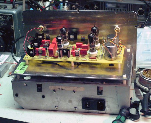

Now you see why Jack was looking at laying out a smaller board.
One of my sister's is a quilter, the other a painter...it has to look nice. Compact is ok as compact wants, but minimalism can set you down the wrong path.
My "His Master's Noise" board is pretty big for an MC stage and sits in the carcase of an Eico 378 Signal Generator:
And that doesn't include the heater regs! 😀
Nor the power supply box full of transformers, diodes, caps, and such.
I like that look too. Thanks for the picture. "His Master's Noise" and the Equal Opportunity are similar enough that it gives me a better idea what the boards will look like when populated. I always think of Wima caps as pretty small, but some of these are half as tall as the tubes!
Beauty is in the eye (and ear) of the beholder (or is that the builder?).
