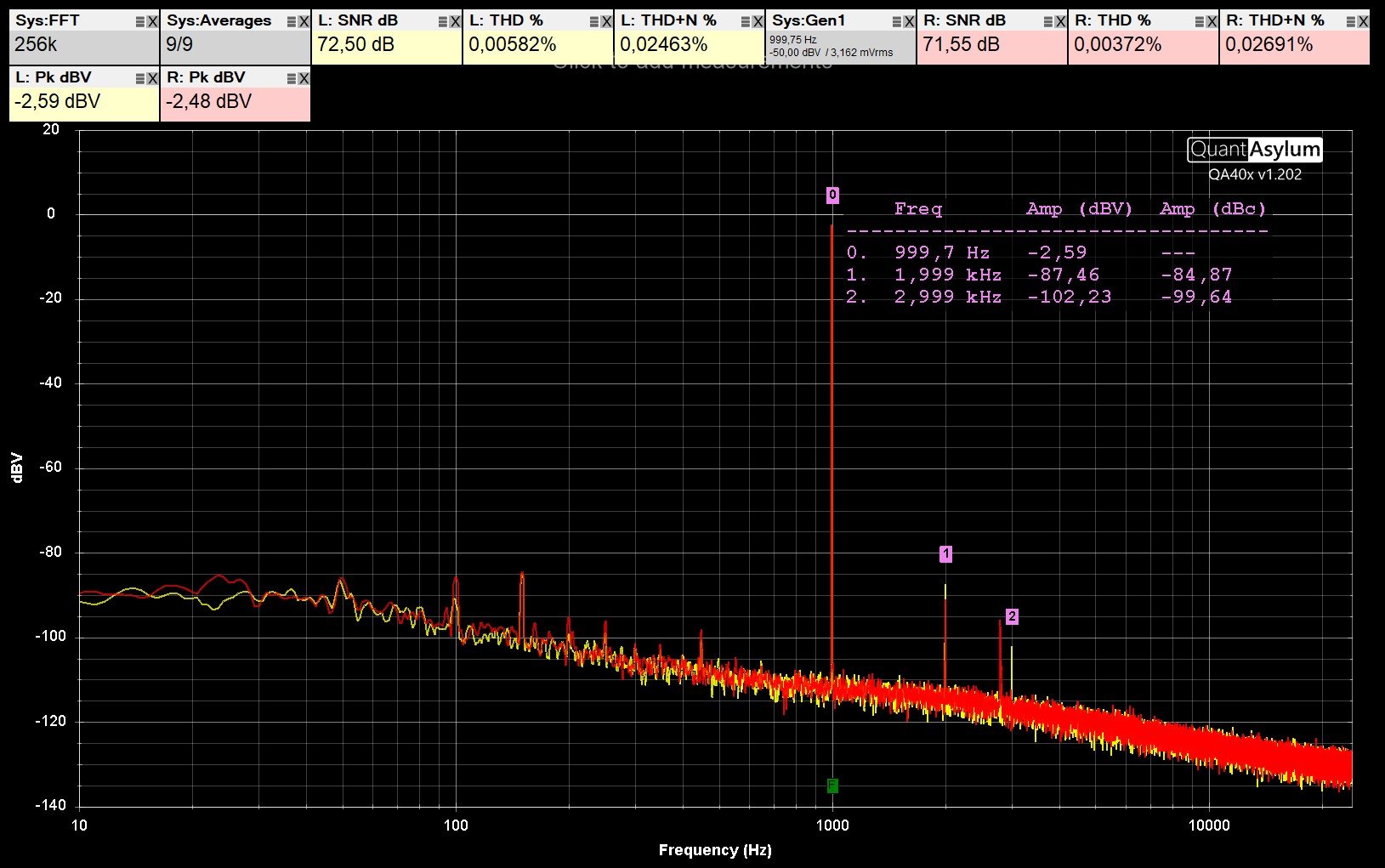

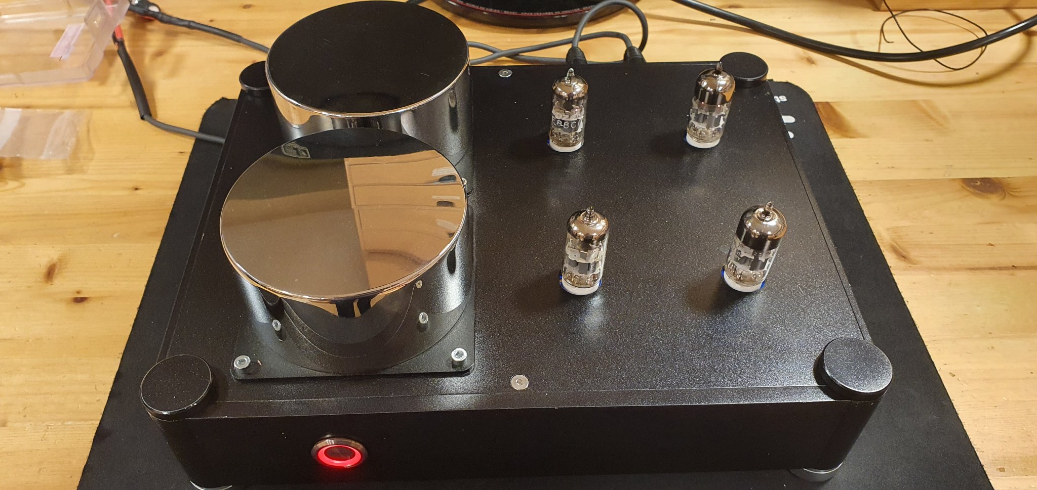

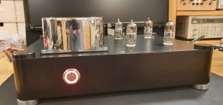

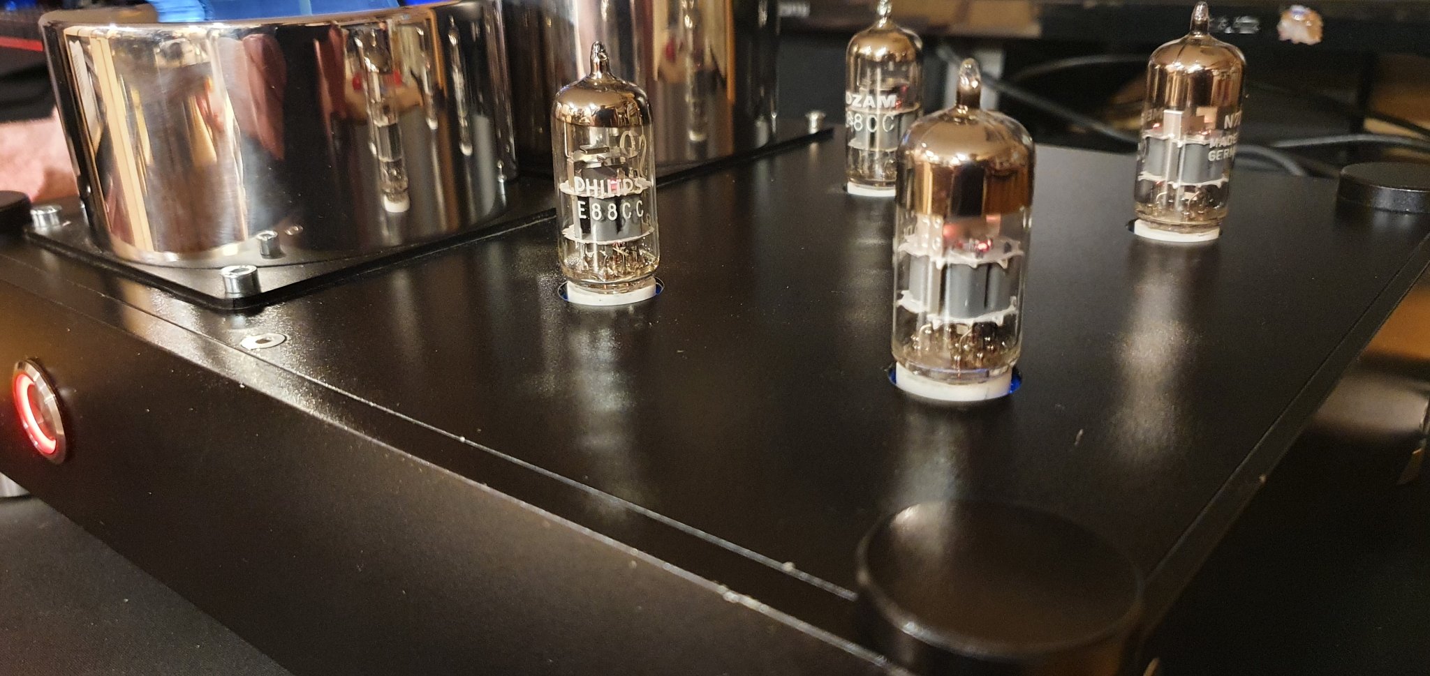

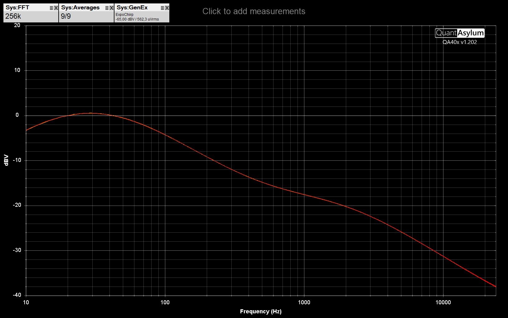

And now i am a bit proud to pesent my version of this great sounding amp. I build my device in this 4 year period an now i am satisfied with the results and like to show some pics. I designed my own single layer PCBs ( 2 stages on each PCB + one for the powersupply ). The transformer and the choke too are from Toroidy, costum made in Poland, nice looking and for a fair price. I also made some mesurements as you can see in the pics down below. The mesurement results are not as good as SY described in Linear Audio but the amp sounds really great, no hum an low noise at all. I modified my Ortofon Super OM30 for symetrical wiring and changed the RCA Jacks on my turntable for a Tiny XLR connector because of the small space in the back of my PRO-Ject turntable. The tubes are old and used ones from a 70`s oscilloscope, but with good emission. The rest of the circuit is pretty much 1:1 what SY published in the LA Volumes.
All in all a real nice preamp, thanks to Stuart Yaniger an all the people here in the DIY Audio forum who told me the way to build "The Equal Opportunity".
