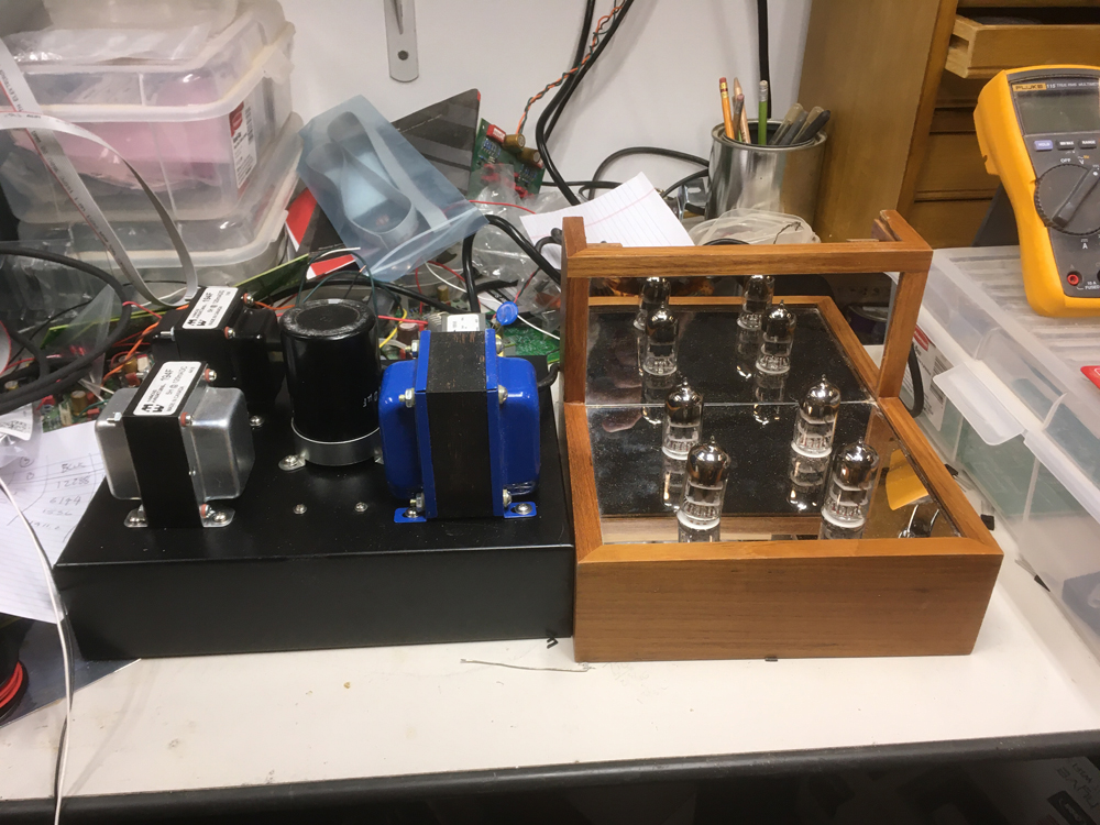

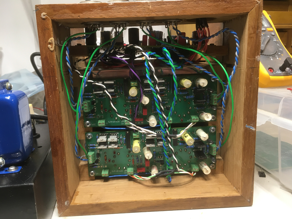

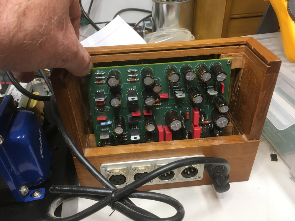

I have tested most of the bits. Waiting in a new filament transformer (the current one is bit too hot for the +/- 3 volt filament circuit, so the regs get a little hot.
Ready to try out some LPs!!
Nicely done! You are clearly a creative thinker with things upside down and standing up. The tubes will make a nice display in a dark room with the mirrors. Enjoy.

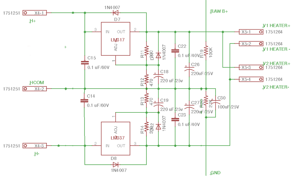

Hey Lehmanhill;
I have a question about your heater supply. I have been having a devil of a time getting mine to work properly.
I am using SY's HMN design modified for 6.3 volts (±3.15) with the common point floating about 30 V above ground.
Everything works great except I have about 0.5 volts of ripple on the heater lines. If I remove the tubes, I get perfect ripple free ±3.15 volts. I have tried adding capacitance (although 4700uF seems like it should be fine), and that didn't change things much, even going to 47K uF. So this isn't a filtering issue.
I am using an 8.5V CT transformer, so I have raw DC of about ±6.5 volts at the input to the 337 and 317 regs. I am running each channel on a separate regulator set, so presumably I am drawing about 0.7 amps per side (350 mA per tube), which should be well within the regulator capability. The regs run a bit hot, but stabilize at about 50 deg C with heatsinks.
I have tried changing the bridge, swapping out the bridge for diodes, changing the caps and also tried two different power transformers. One was a 10 Amp 6.3 V CT unit, and one was a 12V CT toroid I had lying around. Neither had any real effect. The 12 volt transformer causes the regs to oscillate (thermal shutdown because the overhead is too high). The 6.3 volt unit still has ripple, but the overhead is so low that the tubes barely light up.
Seems silly that this simple circuit should be so bothersome!

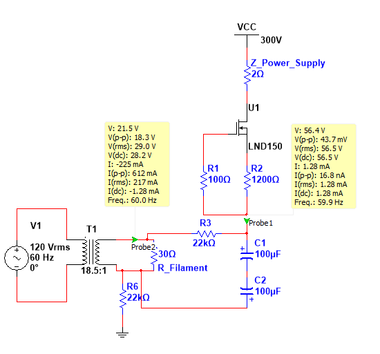

A transformer with a split 6.3VAC secondary, or the "THINGY" described by Morgan Jones in Valve Amplifiers, 4th ed.
I haven't explored it in detail, but simulation suggests that this will probably work. LND150 is an inexpensive DMOSfet. As a current source it has a much higher impedance than the THINGY

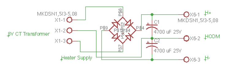

Here is my regulator. I used SY's approach of floating the ground on the heater circuit, and then lifting it using a simple voltage divider off the B+. The schematic is attached below.
H+ H- and HCOM are from the raw supply shown below.
This is a simple bridge rectifier with two 4700 uF caps, one for H+, and one for H-. The caps are referenced to HCOM, which is the transformer CT.
This is the same as the circuit shown in SY's HMN article (Figure 9). The only possible difference is that I connected the "ground" ends of the caps to HCOM. Figure 9 does not show a connection there, but it seemed logical, otherwise the "ground" is referenced back to the un filtered transformer CT.
Without a load the outputs of the heater V1+ and V1- are at 33.15 and 26.85 volts, so the filament voltage should be 6.3, raised 30 volts. This is all fine until I apply a load. When I do that I get ripple on the supply and that seems to go right through the regulators.
Is it possible that HCOM is changing depending on which direction the current flow is in the transformer, and this is effectively reducing the ability of the caps to filter? I am intrigued that Jackinnj's circuit appears to have two ungrounded back to back caps, so maybe that's the trick..

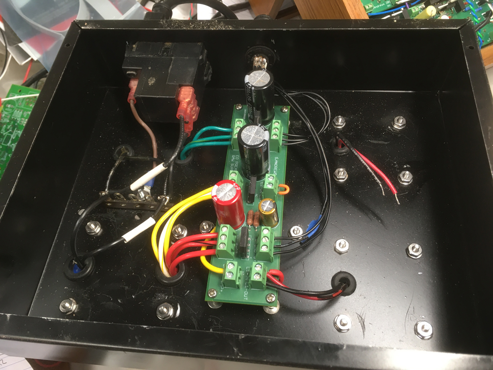

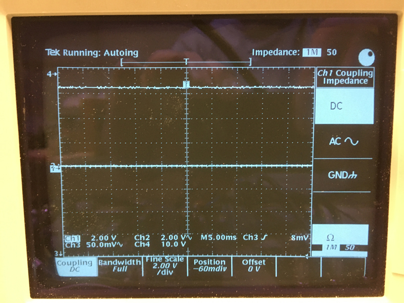

Jackinnj had suggested that HCOM was modulating the regulators. I set up an experiment and compared HCOM (the elevated heater "ground") to ground, and to V+ and V- (the heater lines).
The suggested cap between HCOM and actual ground is there on the regular board, and it seems to be doing its job properly. The noise on HCOM relative to real ground is in the mV range. So, that's not the problem.

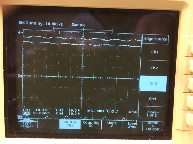

Here is HCOM at 2 mV/div.
Here are the heater lines (V+ and V-) It's hard to see the ripple, since this is DC coupled, and the scale in 10 v/div. However, you can see that the two signals are about 6 volts apart, and the ripple is anti phase (if it was common mode, then the balanced nature of the amp would reject it (not ideal, but not as much of a problem).

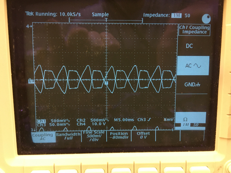

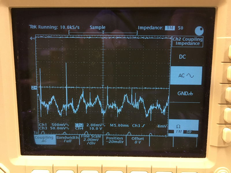

Here are the same signals AC coupled at 500 mV/div. I have separated the traces. They are exact anti-phase mirror images of one another.
I also tried disconnecting the two 4700 uF caps from HCOM (letting them float between H+ and H- (which is how they are inn SY's HMN diagram -fig 9). No difference at all.
I decided to try to narrow this down a bit. So, tested the raw supply with none of the regulators attached.
Here is H+ with no load. Flat as can be... About 6.5 volts.
I hooked up a 500 watt 8 ohm resistor I use for power amp testing to the H+ and H- lines, (this was with no regulator attached). This should pull about 800 mA, which is a tad more than we would see with two EC88 tubes.
Here are H+ and H- at 2 v/ div. You can see the ripple is about 1.5 volt!
So clearly the issue is in the super simple raw supply.
