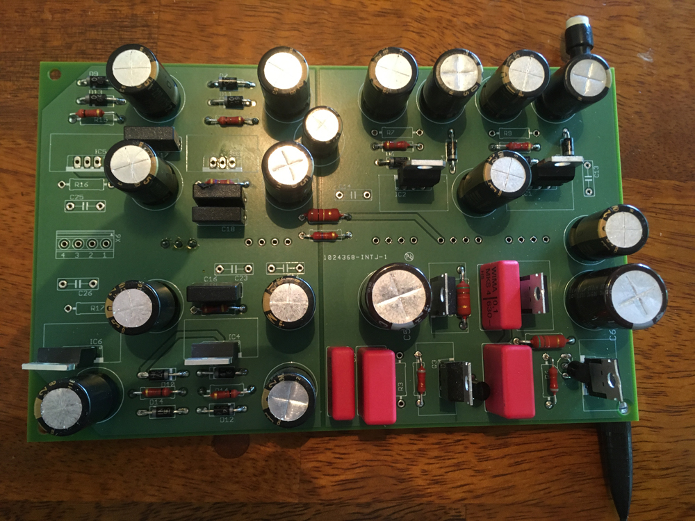

I ended up redoing the regulator board so it has a dual heater regulator. It's quite a lot larger, but should work fine. Here's a pic of that. I am waiting on a few random parts from Mouser to finish this off. And then I can't back into tuning up the overall amp.
One thing I did on this board was use separate ground planes for the supply ground (signal ground) and the heater "ground". You can see the two ground planes divided just to the left of the left-most red WIMA cap. The voltage divider that elevates the heater "ground" is formed by the two resistors that cross the gap (one os oversized..it was what I had lying around). I still need to put in the 317 regs (amazed that I don't have any of those!), some of the smaller caps, and the terminal blocks. This effectively provides a "ground plane" for the heater circuit, but that ground plane is actually elevated above signal ground.

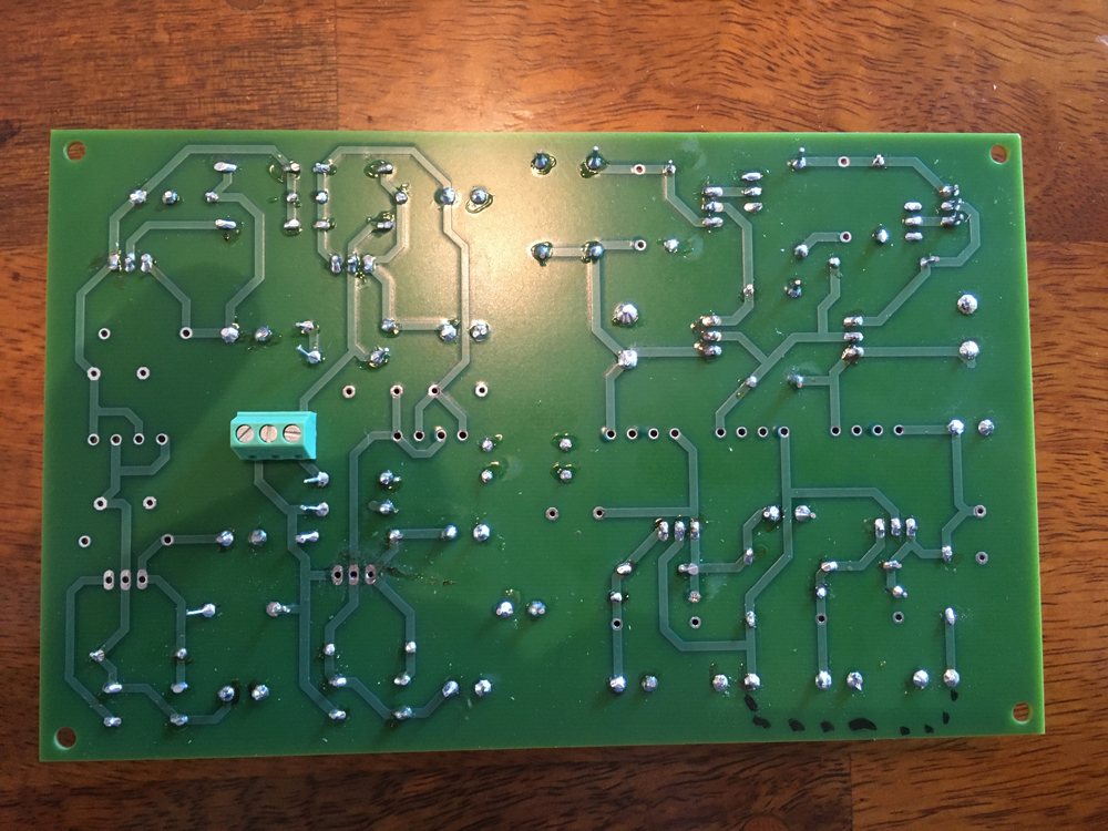

Here is the new board. You can see my one booboo...didn't connect two overlapping wires on the schematic, so there will be a short jumper (dotted line)..I also forgot to do the silkscreen on the bottom to label the connections..It's always something... In my next iteration of this board, I also plan to allow a little more room between the regulators and the caps. .
As I was getting my head back into this project, I re-discovered the few odd differences between the various incarnations of the schematics. Specifically the 1 nF input cap on the 337 negative supply regulator. The 337 data sheet uses a 1 uF cap here, and on the output, for their "high stability" regulator example. I ended up using both a 0.1 uF and a 220 uF cap on both the input and the output. I am hopeful that this will kill both ripple and high frequency noise.
Not super sure if my ground plane approach is a good one or not. The use of a ground plane should eliminate the inductance of a bunch of traces all trying to converge to a single point, but it may also provide a plethora of potential "loops". Of course those loops are also all shorted together in a distributed fashion, so we'll see.
