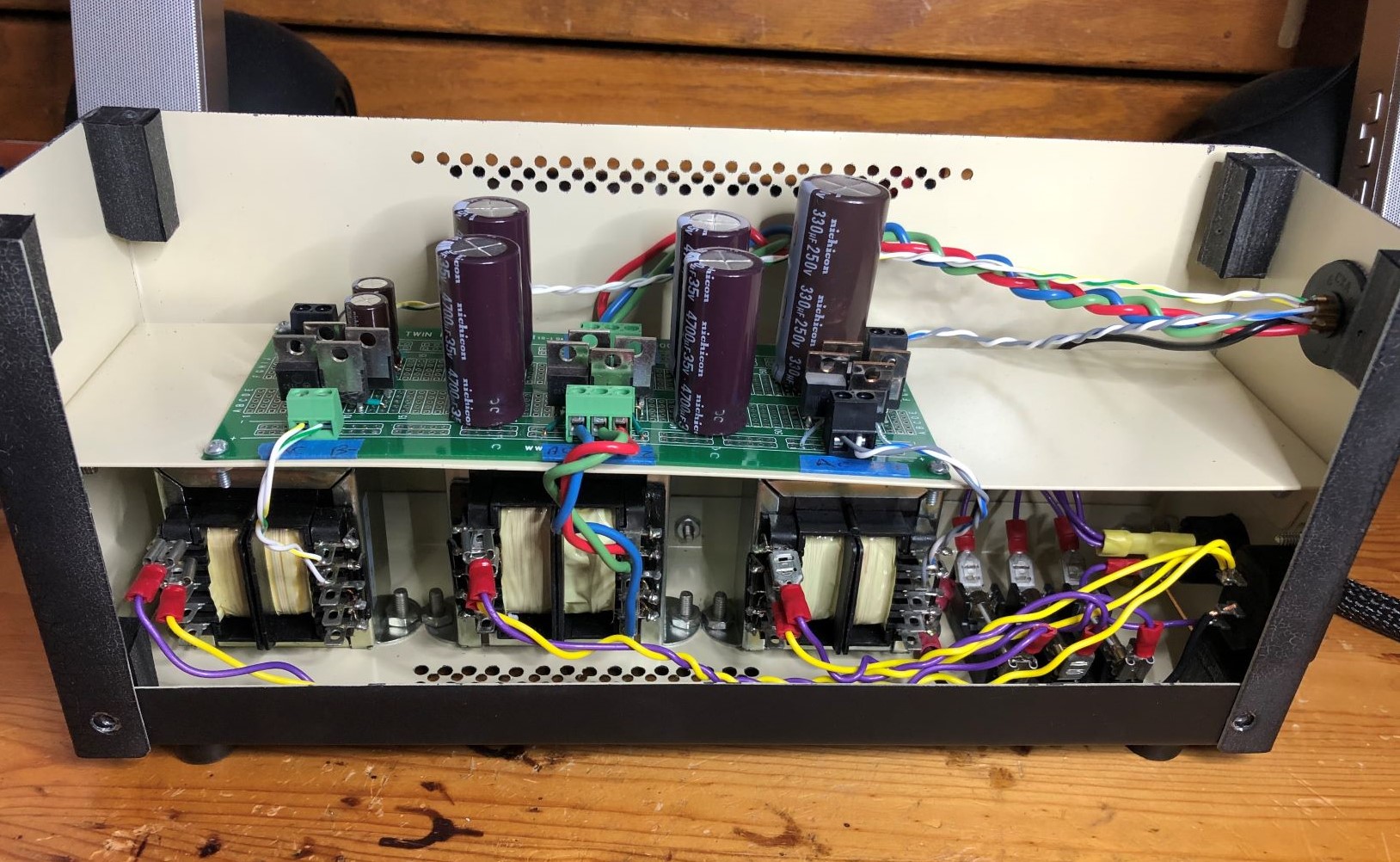

First, a caveat that shouldn't make any difference. I am using PCC88/7DJ8 tubes with a 7 volt heater for their perceived cost/value. Actually, they will run just fine on a 6.3V heater supply, but I made mine 7V or +/-3.5VDC just because.
This was my first tube project, so I may have gone overboard on the power supply, but I will say that it is silent, so the difference in the raw supply may be the difference.
I am using 3 transformers. One for B-, one for the heaters, and one for B+. Overkill.
The transformers, diode bridge, and first stage of smoothing are in a separate box. The DC goes from that box to the main regulator where there is a resistance, followed by another capacitor. In other words, a split CRC filter. My first stage is two 4700 uF caps in parallel per rail. That is followed by a 1R Ohmite carbon resistor (my father parts box) and another 4700 uF. That feeds the HMN regulator with the heaters wired as you have, that is a single H common.
With the EO powered, the output of the first box is + and - 7.75 VDC with 180 mVAC. After the second stage of the filter and the regulator, the output is + and - 3.55 VDC with less than 1 mVAC.
As I did this, I remembered that I had originally started with a different heater transformer. I found that the heater drew down the voltage more than expected. A rough estimation of the transformer suggested something like 25% regulation which I hadn't counted on. The transformer I am using is a Triad VPS12-3400 that is a 43 VA, parallel 6.3V secondary EI transformer. The 7DJ8 heater is 7V, 300 mA, so the 3.4 rated amps is a bit overkill for the 1.2 amps draw of 4 heaters, but the headroom was needed to get things in the box, at least for me.

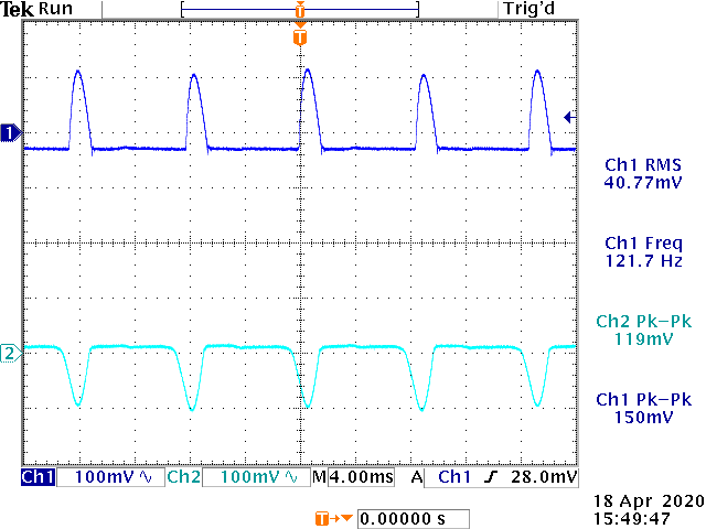

I did some figuring. The ripple is given by the following calculation:
Vr=I/(2FC), where C is in Farads.
Based on the cap values (4700 uF) and the current 750 mA, the ripple should be:
Vr=0.75/(120*.0047)=1.33 volts, so this actually seems to be working as designed. Not a very good design, but at least there don't appear to be any goblins lurking in the implementation.
I tried out some big 38K uF caps I had, and that cut the ripple down to about 0.25 volts (odd that it is not following the relation above..)
For fun, I tried putting a choke in series with H+. That pretty much killed the ripple >100 mV. The problem is, I have only one choke, and if I put it on H+. then the resistance of the choke throws HCOM off from a virtual ground. This is not a problem for the unregulated supply, but the regs relay on HCOM, and if one side has more resistance, the other will pul HCOM it that direction (which is what it did...).. I also put the choke in series with HCOM for fun. That significantly reduced the ripple, But it doesn't seem very efficient, since we then have a lot of interaction between the regulators because they then share a squishy virtual ground reference.
So, I think I'll get a couple of smaller chokes and add a second pair of 4700 uF caps following that. That's a much more efficient filter anyway.

Did you look at the ripple on the 125V regulated line?
While each regulator sees 730mA or so load, they are also fighting to send current through the voltage divider -- the LM317 has about 65dB PSRR, the LM337 77 dB -- the 4700uF caps are a bit over the top.

Thanks Jac! I appreciate you taking the time to see what you did.
I think the key is the CRC filter. I think I'll try that. I was just researching coils, and finding a high current coil with reasonable inductance is tough, and expensive!

The ripple on the 125 V line is near zero. I Have a 4 H choke on that with Caps on either side. So it is super clean. Good idea though.
I did some quick calculations.
With 1 ohm internal resistance, the bare 4700 uF filter cap will provide 12 dB of attenuation at 120 Hz .
In contrast, if I use the 4700 uF caps, and go through a 5 ohm resistor and then another 4700 uF cap, I get 45 dB of attenuation at 120 Hz.
The resistor will dissipate about 15 watts. I need to account for the voltage drop across the resistor. Turns out I can use the same transformer I started with on the HMN (18VCT). That produces an unregulated 13 volts at the 4700 uF caps (tried this using the existing circuit). Since I am aiming for about 6 volts at the regs (to get 3.15 out of each) a 5 ohm resistor in each leg will do the trick. Those are $3 ea versus $30+ ea for a coil.

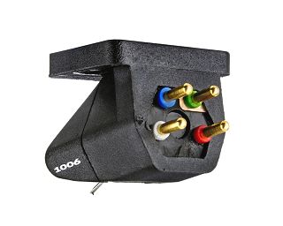

Hmmm some of the cartridges particular the MMs have their cases shilded by one of the grounding pins (cold) on the back of the cart so if I want to make a "balanced" connection the shield should be separated! How do you cope with that kind of issues using the balanced phono? (Using MCs??) I like the goldring 1000 series and they have all this shild connected to green pin and looks its very hard to separate...Any thoughts, experiences?
The coloured rings come off quite easily, but the rest... You could cut the ring on one side to slide the ground off the pin.
Or
If they used the same body structure than my old 900IGC you could try to gently push off the 'ring' with the base (where you attach the cartridge to the head shell). This ring is normally glued, but might come off if you gently push between the pins while holding the ring.
Please be very careful and please don't hold it against me if something goes wrong
