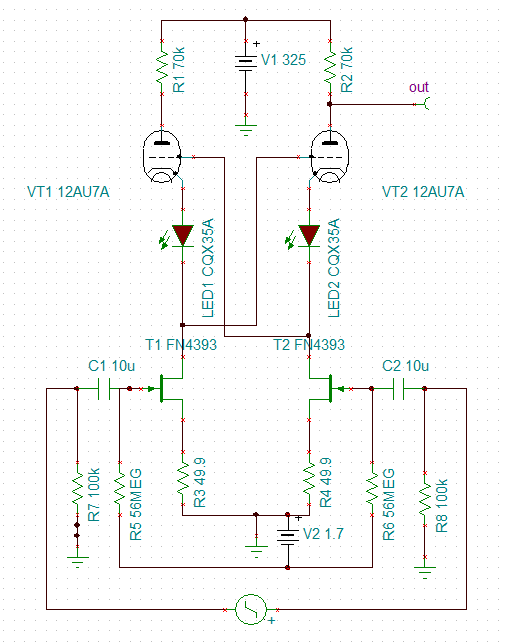

Here's an implementation which attains ~50dB of gain. If you've been watching Scott's 1000x amplifier thread, http://www.diyaudio.com/forums/grou...1000-low-noise-measurement-amp-ikoflexer.html you'll figure how the NFets gates are biased.

That's a pretty interesting schematic, similar to Eq Opp in some ways, except using Nfets and a pretty big capacitor in the signal path. Any idea how the noise level compares?

Will breadboard it and see!
Might be able to use active rather than passive RIAA compensation

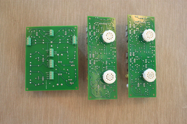

I designed a new boards because I wanted a particular physical layout. So I have the signal stages on tow identical boards, and the regulators on a separate board. The signal boards have tube sockets on one side and components on the other, so the tubes can stick up though the chassis for ventilation, and esthetics. I built a teak chassis frame with mirror finish stainless panels to mount the boards. Here is a notional view of the partially finished setup.
The raw supply worked OK once I changed out the power transformer, but I also found that the heater supply for the HMN had too high an output voltage, so the LM317 and LM337 regulators were getting too hot and shutting down. I think a simple transformer change should remedy that.
I also discovered, too late, that the 3LM337 regulator pinout is different, so I'll have to do some surgery to fix that. Other than that, the build is coming along.
Here are the boards.
I did the signal boards separate from the regulator board. The reg board will be mounted vertically behind the vertical face of the chassis, so it will cool by convection. I can then run wires from the terminals on that board to the two signal boards.

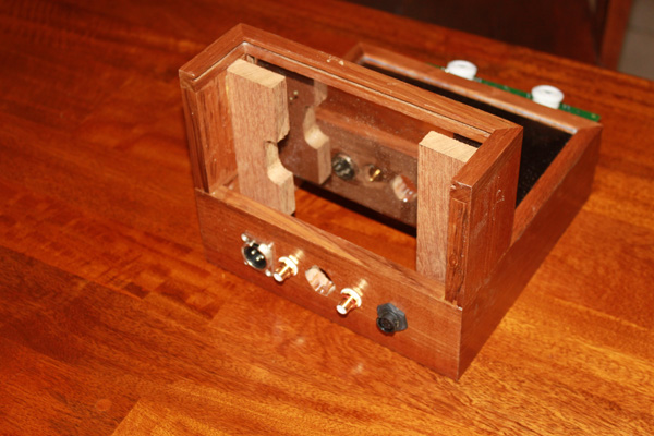

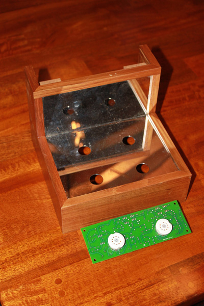

Thanks Jac!
I have an old (1929) wooden boat, so I had to learn a lot about woodworking...
I got the stainless panels from Online metals.com. They will cut them to fit. I then drilled the holes for the tube sockets. The metal panes slide in to slots in the wood sides.
The axial caps are Mundorfs (and, I think, Vishay Roederstein). I haven't seen many audio quality radials.
Somewhat disappointed with the tube sockets (from Tube Depot), since the pin contacts are very very tight. I worry about breaking a tube getting it in or out.
There will be a perforated metal cage that slides into slots on the top and back to allow convection cooling of the regulator board (which mounts vertically behind the vertical steel panel.
But first to get the supplies working without lighting themselves on fire!

I spent part of today trying out the signal board with the regulator.
First thing I noticed was that when I went to hook up the VPP line, the voltage dropped from 125 to about 20. Hmmm. Farted around with that for a while and found that one of the VPP supplies was good, and the other wasn't (put a 10K load on each of the terminals and tested it that way. Turned out the collector on the pass transistor wasn't actually connected! (My board layout program can sometimes show a line over a pin, but not actually connected to the pin - surprised the DRC didn't find that). So a quick jumper fixed that, and now I seem to get a solid 125 v supply when hooked to the signal board.
I then found that I had forgotten to do the twisty dance with the LM337 leads (pins 2-3) for the negative 15V supply.. Once I did that, the negative supply worked (still only -12.5V because of the resistor error)..
So then I hooked up the signal board, and installed the 10K resistors. LEDs light, I get 64 volts at one plate pin and about 28-30 (depending on the trimmer resistor) at the other. Seems a bit low. The first "plate current" is 6.4 mA, and the second is under 3 mA.
I then found that the -15 volt supply was no longer at -15V. When it is connected to the signal board the supply droops to -2.5 V.. so clearly there is still something amiss in the negative regulators.

Well, I sorted out the regulators today. I had somehow neglected to include the 200 uF caps on the -15 volt regulator outputs. Once I put those in and adjusted the resistors, the -15 volt supply is rock solid, and sits at -15.1 V.
So, I connected up the signal board, and set out to adjust the CCS. As noted above, the current in one leg was rather high. I traced this to an incorrect resistor value. When I first laid out this board I used some earlier version of the schematic and, apparently never corrected it, so one of the legs had a 100 ohm resistor, and the other had 620 ohms in parallel with the 5K pot and 5K resistor. Once I changed that to 560 ohms, the current were close (about 2.7 mA), and I was able to adjust them for a perfect match.
I then put in a tube and tried out the first stage.. Voila! we have gain!
I then repeated this on the second stage, and found, for some reason the current in the adjustable leg was too high. The resistor in that leg is intentionally higher than the other leg so it can be adjusted down, but 620 was too hot. So, I put in a 1K resistor in place of the 620, and was able to adjust the current to match.. again about 2.7 mA.
Seems odd that the resistor values want to be so different. I suspect this may be something in the FETs.
Doing a crude gain test, I get about 60 dB air 20 Hz, about 40 at 1KHz, and about 20 at 20 KHz, so this seems about right.
