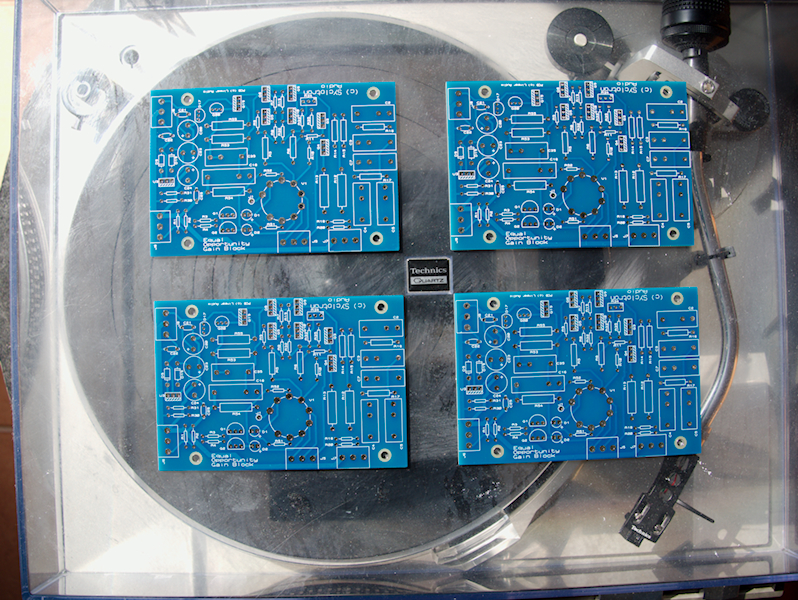

For the discussion on available and appropriate pFETs, look at posts 92, 94, 99, and 100 of this thread. Basically, for this project you need 4 matched pairs with the lowest noise choices in the input stage.
As for the LA thread, I don't know of any forum on that subject. There is great information in the articles on the "The Equal Opportunity" written by SY for LA in vol 7 and 8. They can be purchased form LA as individual articles here;

I've got an order going into Mouser for another project, so I thought I would put some parts for this project on the order as well.
Looking at the volume 8 article, both schematic and BOM, C22 is shown as a 220 uF electrolytic cap. On the later schematics downloaded from the LA site, C22 is shown as a 1 nF and the board reflects the smaller cap with 5 mm lead spacing.
Can I assume that the 1 nF C22 is the correct value?

The schematics on Jan's site have a lot of placeholder values. The article schematic and BOM are correct. The 220u caps I used had 5mm spacing. The value there isn't critical, it stabilizes the regulator, so if it's easier to use, say, 100u, that will work fine.
Thanks for the clarification.
Looks like 220 uF will be OK.
To others ordering parts for C22, take care with the diameter of the electrolytic. 8 mm diameter should fit, but 10 mm will be a squeeze.

Now you see why Jack was looking at laying out a smaller board. I need a balanced line stage so will be trying to fit 6 boards in a case.
