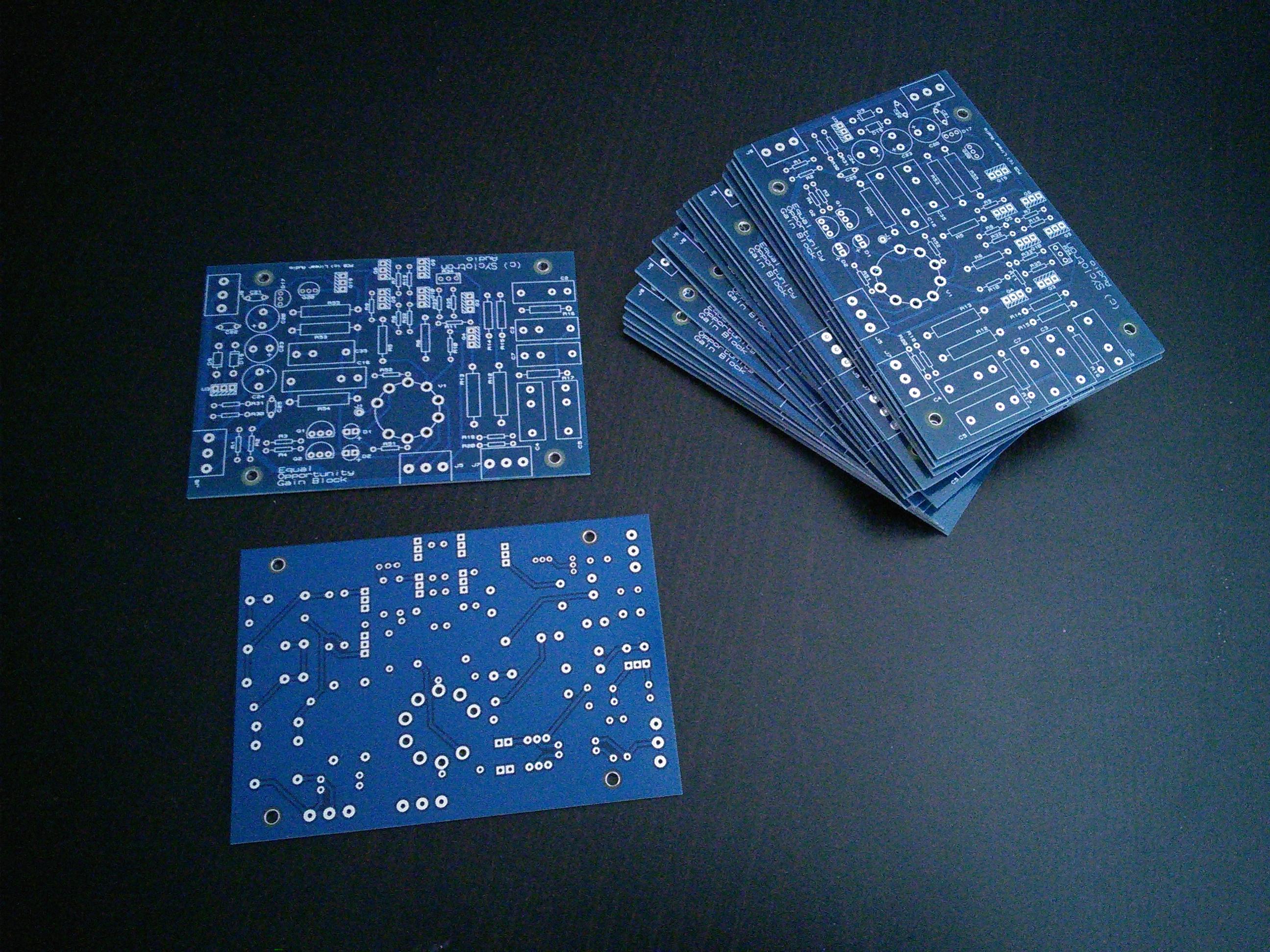

Here's a suggestion input stage, filter and buffered output on one card measuring 3.5 x 8.0

I had some of Jan's boards ran a few months ago, so the tooling costs are sunk. I could have more made up if there's interest and Jan and SY don't mind. I think with shipping cost is around $6 per board.
That's cheaper than me sourcing my own so yes please if we can find a few more to come in on that. I have someone who can receive in Dallas to keep shipping down.

Not sure if they have caught up with the thread, but jgf and Joel (Canada) were interested on page 7. That would be in the neighborhood of 24 to 32 boards. I'm in no rush, but that looks like it could be getting in the range where an order would be cost effective. How many did you have in mind for an order?
I just offered because billshurv wanted Jan's boards specifically. I'm not sure what the other folks want, and don't want to step on any toes. There's no minimum with the shop I use, so it's really about the economics of shipping and insurance as the tooling has already been paid for on my previous order.

I'll get a fresh quote, but it came out to $5.88 per board on my last order of 24. I'll get a quote for another 24.

Now that it looks like we are on the path to ordering some boards, I went back to the pFET discussion between jgf and SY. Looking on google and the usual suspects (Digikey, Mouser, Newark), there aren't any of the 2SJ108 alternative suggested by SY available commercially. In fact, the only available p-channel JFETs I could find are the Fairchild J176_D74Z which are an order of magnitude worse for noise.
So the choice appears to be the diyAudio store LSJ74 C spec with too much Idss or ebay for questionable 2SJ74. Price is about the same between the 'bay' and the 'store'. How do you guys weigh the C .vs. GR spec LSJ74 against the risks at ebay? How much trouble does that C spec introduce?

Correction. I did find a few pf the J271 at Mouser for a cheap price. The only other p-channel JFETs were more expensive than the LSJ74. I must be missing something here.

The other transistor to look out for is the 2SJ107BL. They show up from time to time.
My noise experience with early '80s vintage J271 was not great, but I have no idea if the newer devices are better. Anyone have any measurements?
