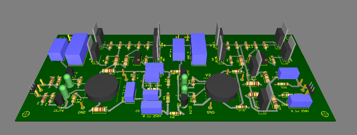

I hope to obtain X2 stereo sets of PCB's for this design..

According to OSH Park, this is the file naming convention used for their gerber uploading service.
boardname.GTL Top Layer
boardname.GBL Bottom Layer
boardname.GTS Top Soldermask
boardname.GBS Bottom Soldermask
boardname.GTO Top Silkscreen
boardname.GBO Bottom Silkscreen
boardname.GKO Board Outline
boardname.XLN Drills
But it is no matter, when the time comes I will just discuss it with customer assistance.

I recently read the linear audio articles for this preamp, and am considering building one in the semi-near future. (I suppose I should finish the phono pre I'm working on now, first!) If there's a board order happening, I'd like to go in on it...!
I can do a board, as I did for the Impasse, His Majesty's Noise and Dick Marsh's HA -- sell them at cost which should approximate $3 -- but can't get them turned around until early October. Why cost? It's Stu's IP.

My CAD (Labcenter's Proteus) generates no separate board outline layer, but there is an outline on the top silk screen layer. I went back to my fab house, Eurocircuits and you're right, they post a warning in the board analysis results but nevertheless turn out perfect boards...

Jan, when you did up the dummy values, you didn't change some of them on the schematics. The grid and gate stoppers should be 100R, not 10k.
The board Jan designed contains the regulators...thus you have 4 sets of regulators. I have a different idea.
Will also use Mouser's BOM tool for the RN55, RN60 resistors, MOSFETs, WIMA caps etc -- this will, thankfully, get me out of the parts business. Just download the CSV file and send it into Mouser. You'll have to get your JFETs from the DIYAUDIO store.
