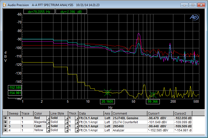

The Idss of the 2N5460 is about equal to that of the DN2540 current source -- 3.8mA. I recognize that it isn't optimal. The Idss of the J74BL's is 8.3ma and the bogus parts 17.4mA.
The bona fide J74s came to me in a sealed lot of 200 (of which I had several boxes) -- most went to folks making F5 amplifiers.
I have some surface mount 5460's -- will have to check them out for noise at some point.
