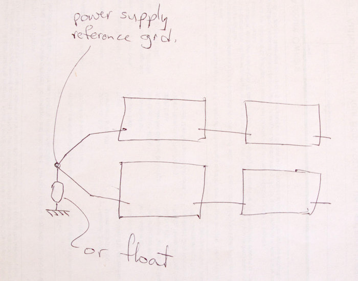

OK, could you sketch out a detailed pic of your grounding scheme (including any connections to the chassis)? And double check it against the actual unit, not what you intended it to be.
edit: One more thing- what is the idss of your FETs?

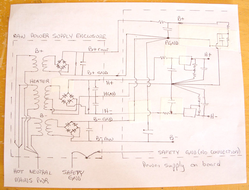

At present, the raw power supply is in an enclosure with safety ground as shown in the sketch, but the heater regs, final power filters for B+ an B-, and the 4 gain blocks are on a plywood board. See the first photo. The power supply board (heater regs, etc) is at the top with the gain blocks below. Note, I am planning on trying a couple of different RIAA and output caps, so those connections are currently clipped to faston tabs. I removed the RIAA caps on the upper (noisy) channel to see if they affected the noise.
The 2nd and 3rd photos are sketches of the power layout including ground scheme. For the 3rd photo, I have only shown the grounds. The B+ and B- power run from the power supply board at the top to the gain boards parallel to the grounds and twisted together.
The heater plus and minus have an offset common (per His Master's Noise Heater supply) which is on the power supply board. Only the H+ and H- wires run to the boards, no parallel ground.

Look at your grounding sketch- you have a few loops in it, which you very much would want to avoid.

As for the ground loops, I have been aware of this as a potential issue and have done experiments on different configurations. None of them changes the noise, however. Even though it doesn't affect the noise, I will go forward with the last picture in post 170.

You may not lose any CMR at all. It's really more dependent on matching of mu than anything else, and that's a variable which is pretty consistent.
In my build, nothing is grounded directly to the chassis. The signal ground is connected at one point (the junction of the input resistors) to the chassis through a groundbreaker (100R with a parallel 0u01 cap and two 69'ed diodes, which I symbolized as an oval in my sketch). No loops- the grounds of the two channels only meet at that input point.
Is your power ground completely separate from your signal ground? Or in some way isolated from signal ground? The way these boards are designed, power and signal ground are on a single PCB trace. Since the power ground is common to both channels, loops are possible between channels. Maybe something that should be considered before additional boards are made.
Jac
Jac
As long as the two channels' grounds only connect together at one point, there's no loop. Remember, in a balanced circuit, "ground" is notional as far as signal goes- amplification is differential.
