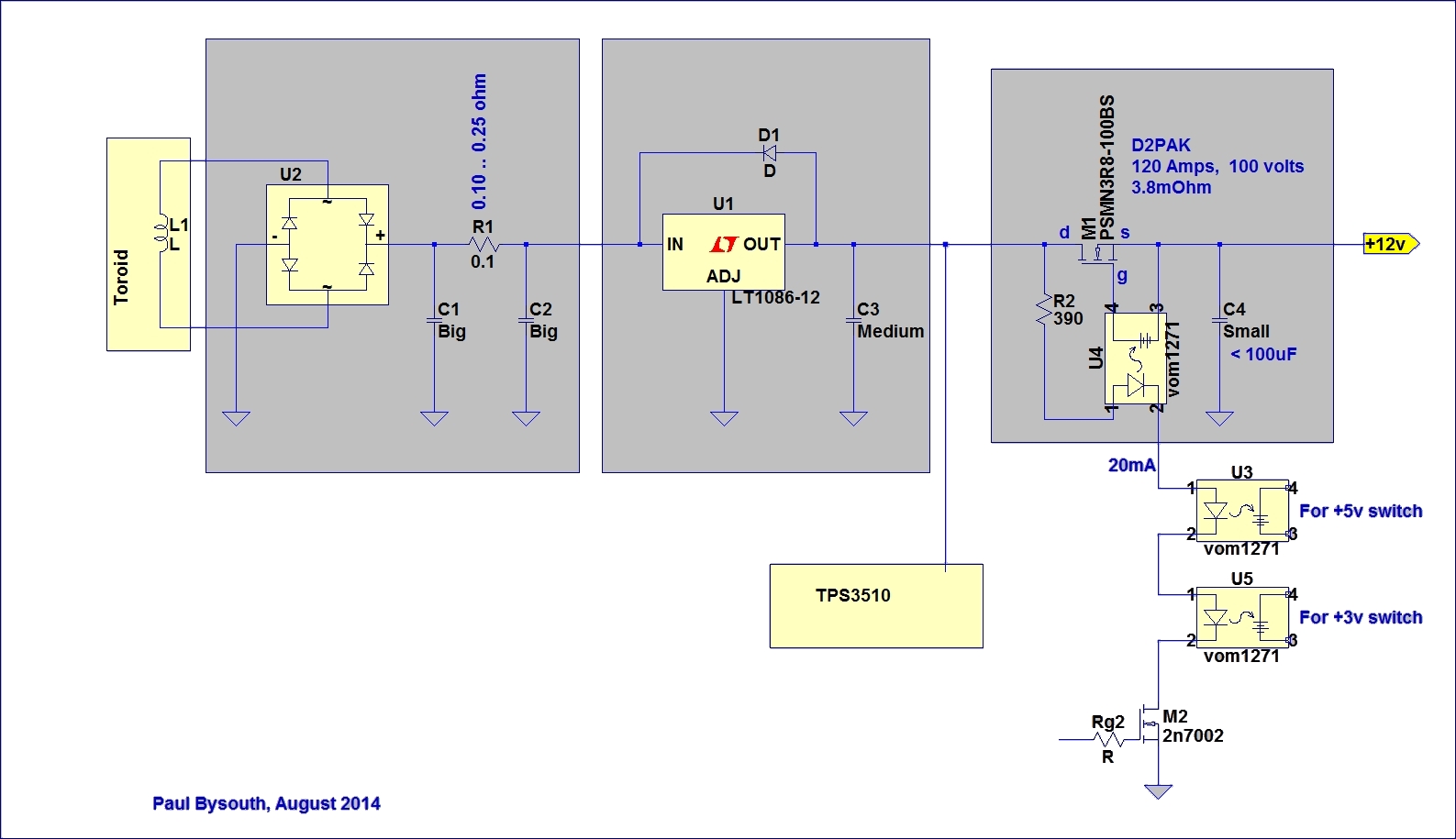

You need to have the mosfet switch after the regulator, else the system will never turn on. The TPS3510 supervisor will need to monitor the regulator output voltages (ie +12, +5 and +3) after the regulators, and if all are OK, then the mosfet switches are all turned on.
I suggest a circuit of the form attached. Note the following:
- Splitting the main capacitors (C1 & C2) into two and putting a small resistance between them helps to reduce the current charging pulses, and the regulator will see a little less ripple.
- C3 will be what ever the regulator requires (aprox 150uF).
- Put all the vom1271 input LEDs in series, then they all turn on and off at the same time, and run at 20mA to 25mA.
- Put each vom1271 close to their mosfet switch. The pin 4 to gate distance should be small (5mm), and the pin 3 to source distance less than 10mm if you can manage it. You don't need a gate resistor (if the above distances are small).
- The mosfet switch ideally would be a DPAK or To220 size device as the turn on current pulse will be high, which is why C4 needs to be small.
- The vom1271 will turn the mosfet switch on slowly (10s of millisecs) which is what you want in order to limit the current pulse from C3 into C4. The turn off time will be microseconds as the vom1271 has an internal fast turn off circuit.
regards,

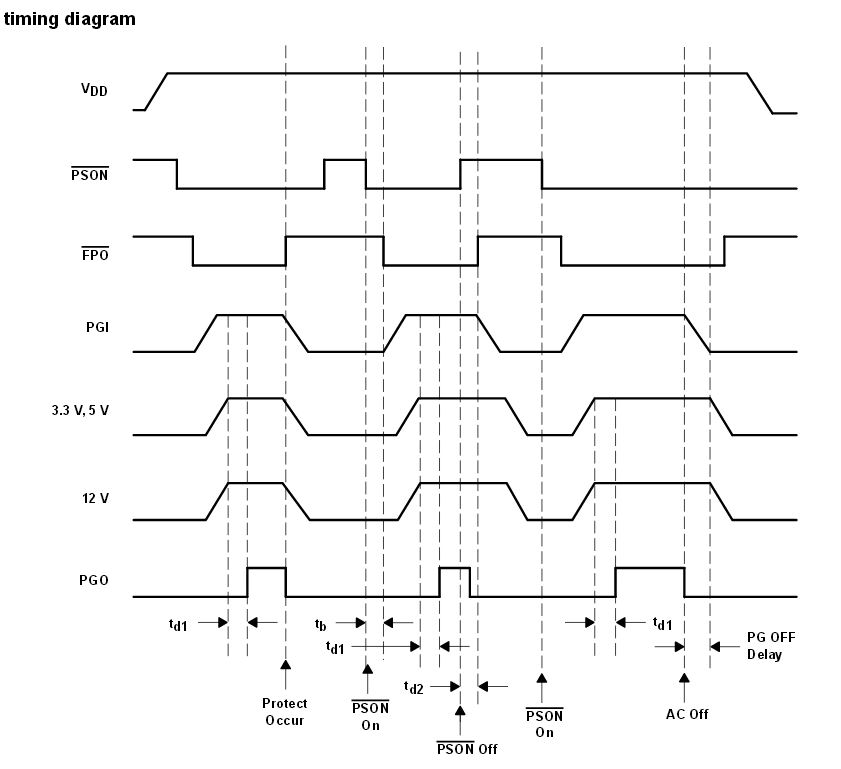

I think there are at least two core ways to skin this cat. I have attached the timing diagramme from the TPS3510 datasheet. Consider the following two 'triggers':
1. PSON/FPO Low with "switches" before regs.
Mains connected. 5VSB active/functioning. Main power rails' (12V, 5V, 3.3V) filter caps charge but their switch not yet on and regs are inactive. Switches (and VOM1271) need to be on the power rail boards rather than the TPS3510 board. (Rdson not an issue.)
When the motherboard sends PSON low, FPO goes low also. Power rail switches turned on by 5VSB and TPS3510 with FPO going low. Main power rails output voltages come up to spec. This is monitored by the TPS3510 (pins 5, 6, 7) and when they reach threshold voltages the TPS3510 sends PGO to the motherboard (with the requisite delay). Motherboard boots. (When PSON goes off/high, FPO goes high, switches close and the output caps should really be discharged.)
2. PGO with switches after regs. [This was indeed my original heading]
Mains connected. Main power rails come on, regs are active, output caps charge. Switches prevent flow to motherboard except for 5V to the 5VSB pin of the 24-pin ATX connector. Here the switches (and VOM1271) can be on the TPS3510 board with the ATX 24/12 connectors. Another big advantage is that there's no need for a 5VSB rail as all the power rails are on and 'available'.
Motherboard sends PSON low and FPO goes low as well (but doesn't trigger any switches). The main power rails are already at voltage and so PGO can be sent to the motherboard (after the requisite delay). PGO acts as a trigger to turn on the VOMs and power rail pass transistors. (When PSON goes off/high, FPO goes high, PSON goes low and the switches turn off power to the motherboard, except for 5V to the 5VSB pins of the 24-pin connector, although I note t4 in Fig 1 of the TPS3510 datasheet. Caps need only be discharged on mains disconnection.)
As previously noted, the second methodology was where I started until I became fixated on Rdson and current limiting. Most importantly, I thought that current limiting needed to occur before the regs to protect them (or prevent them shutting down). I now see the regulators' current limiting attenuates the current to acceptable levels ( a bit of 6A). As to Rdson, I agree that 1.8mOhms of resistance post regulators is trivial in the context of the wiring that follows. One might conclude that the first scenario is closer to the intended operation of a computer power supply while the second is more expedient (and cheaper).
This suggestion likely makes sense in either configuration. Thanks.
This is an area I have never really understood i.e. how large an output cap is required... Is the only consideration regulator circuit stability?
Agree re current and agree re in series if the second scenario above is followed. If the first then simply their placement on the power supply boards dictates the configuration I have used.
Understood. I had pin 3 to source less than 10mm but pin 4 to gate was more like 13mm because of the placeholder for a gate capacitor to manage Cload in-rush if needed (likely not). Advice applies to either scenario.

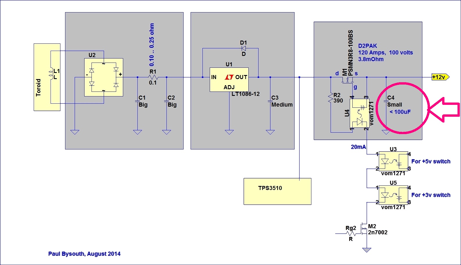

Why is C4 needed at all?
I made the jump to D2PAK during the safe harbour guidance discussion
I'm not sure I understand this. Fig 5 of the VOM1271 data sheet has turn on/off time versus diode current. T-on at 20mA looks more like 50 micro seconds.

I suggest a circuit of the form attached {copied below --MJ}
Paul, there's a pretty good chance that the +12V output rail, the +5V output rail, and the +3.3V output rail are all connected to an ATX-formfactor motherboard, for a personal computer. The motherboard contains bypass capacitors on each of these rails, which are larger than your recommended "C4" value.
If this is the case, then there is an inrush current event when the MOSFET turns on. To take one phony-baloney, made-up, hypothetical example, when the +12V rail turns on, if its total rail bypass capacitance is 20,000 microfarads, and if its gate ramps up in 50 milliseconds ("tens of milliseconds" as you call it) then C=0.02, deltaV=12, deltaT=0.05, and I_inrush = (0.02 * 12 / 0.05) = 4.8 amperes. During the initial segment of the turn-on waveform, the MOSFET has 12V on its drain and <1V on its source, so power dissipation is 11V x 4.8A = 52.8 watts. Maybe too much for small-die MOSFETs having puny thermal pathway from die-paddle to PCB heat spreader. Maybe it violates the datasheet "Safe Operating Area" by a frighteningly huge amount.
