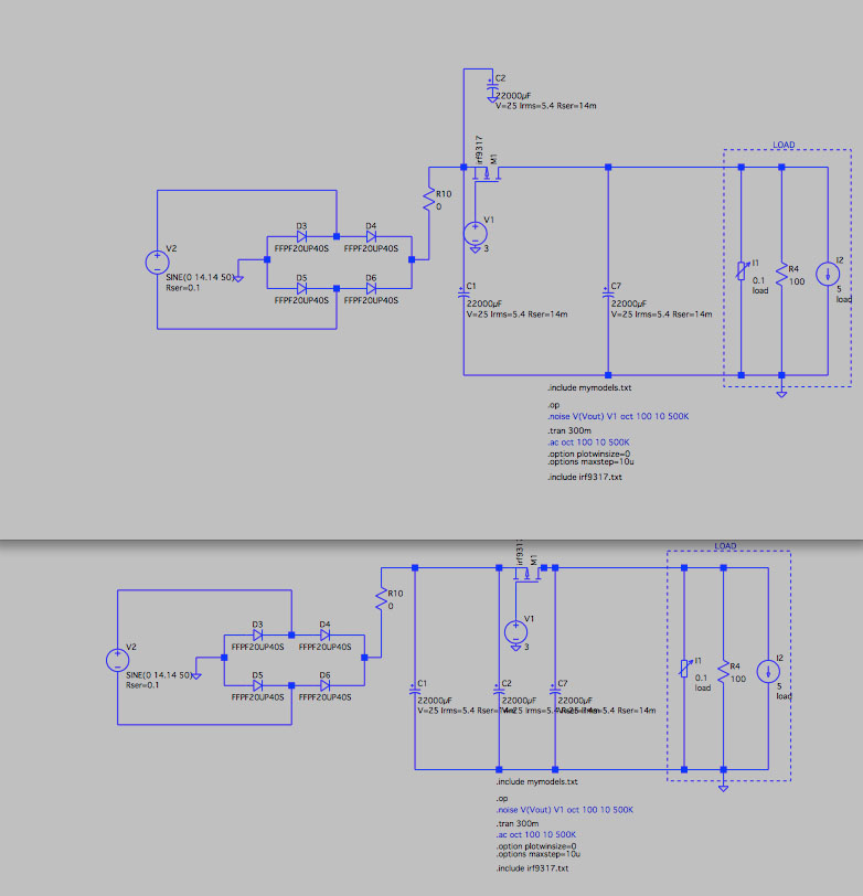

Ok so I did a little test in LTspice to confirm that the attached two circuits produce identical waveforms. (The lower schematic is a more aesthetically pleasing presentation.) LTspice ignores trace resistance and so I conclude that if the trace resistance = 0 waveforms are identical then the board layout with the least trace length (all else being equal) wins. Were I to redo the board in #114 I would take a more direct route to the pass transistor than the trace snaking from C2. The boards are functionally the same (if the pass transistor is off both caps still charge) but the board layout with the longer trace from C2 to the pass transistor involves greater trace length and greater impedance, a cost it needn't incur.
Hopefully that deals with the nagging concern I had...

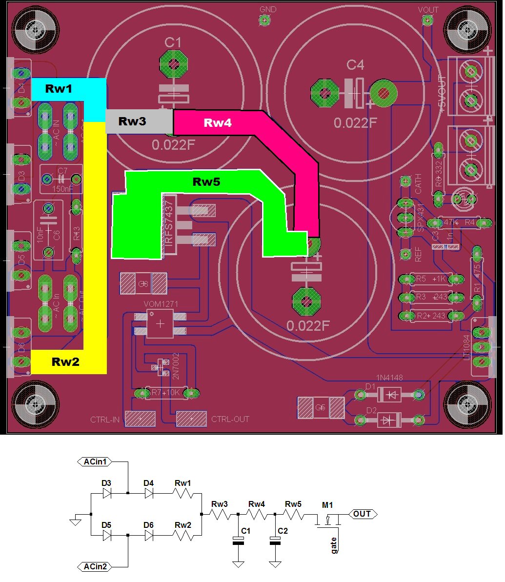

Here is my analysis, would you critique it please?
Two layouts are presented below, each with its corresponding schematic diagram. Resistors "R sub w" are wiring resistances, namely, the resistances of PCB tracks.
Personally, I find that only one of these two schematic diagrams appeals to my aesthetic sense of what-looks-good. But hey that's just me.
The right hand drawing breaks the rules
Run the input to the capacitor.
Run the output from the capacitor.
Use the left hand drawing. it performs better, particularly at the harmonics of the supply frequency and at the lower frequency interference.
I absolutely agree that the schematic on the left is more aesthetically pleasing and would be how I would (and did) write the schematic (when skipping trace resistances). When I came to draw the board, indeed I followed the 'flow' of the schematic, ignored the air-wire guidance and drew Rw5. My hesitation stemmed from looking at the likes of the Universal PSU board, which has a schematic drawn in the aesthetically pleasing style yet a board which places C2 on a spur like trace-wx in your second graphic.
Now, perhaps I can simplify your second graphic slightly to shift trace-wy to the right such that trace-ws and trace-wt collapse to a trace identical to trace-w3 in your first graphic. Can I not then directly compare the parallel resistances Rwx (=Rw4) and Rwy with the series resistances Rw4 and Rw5 (noting that all else is the same in both cases)? Would I not conclude that the former presents a lower resistance to the circuit? If this is nonsense then I'm all for the aesthetic "flow" approach which is where I started. Presumably I then reject implementations such as the Universal PSU board as being sub optimal...perhaps for the reasons listed by Andrew?
Perhaps you may find that the two schematic topologies produce nonidentical simulation results when room temperature, 1oz/ft2, copper metallized, PCB trace resistances are included. Perhaps the one that looks better, simulates better too. Or perhaps it (surprisingly) does not.

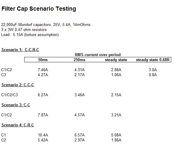

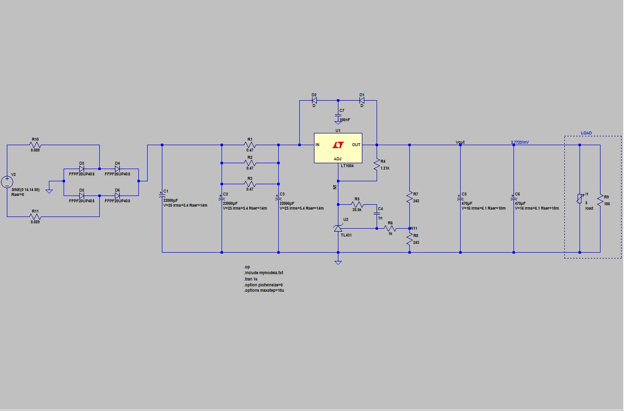

I've been busy modelling filter cap configurations in LTspice and also refining the regulation circuit. 5V only at this stage. Test circuit for filter cap tests and results are appended below.
I attempted to model the start 25C resistance of an NTC CL-80 ICL by, as previously noted, converting the 47R primary resistance into a secondary equivalent. 230V mains transformer, 10V secondary, turns ratio (K) =230/10=23. K^2=529. Rs =Rp/(K^2)=89mR. I note that as the ICL heats with current its resistance will fall. As load current falls its temperature will fall and resistance rise. I did not attempt to model this and simply used a fixed resistance. When reading the datasheet, I'm unsure about the implications of the stated minimum end of the current range and whether this means there has to be a minimum load...
I noted the way that adding an additional cap (from 2 to 3) spread the 'ripple burden' and how adding the resistors shifted the balance between pre- and post- resistor bank capacitors. I also noted how the resistors change the shape of the voltage waveform going into the LT1084. I've heard people say that they prefer a more rounded waveform as this supposedly makes the job of the regulator easier (I assume because the rate of change in the feedback network is less).
It seems to me that it may well be beneficial to add another input capacitor (total of 3) and, if indeed the foregoing sentence is true, to add the resistor bank even if this is a regulated circuit. The resistor bank will also help burn off some of the voltage headroom I have if I stick with a 10V secondary.

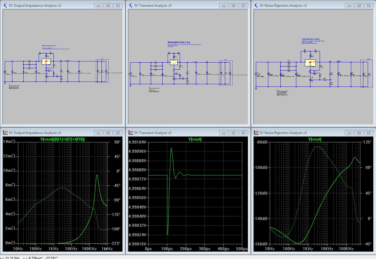

Output caps are a lot smaller. I've added a pic of output impedance, transient and noise rejection. Loop gain analysis suggests the circuit should be stable.

Well, I spent the better part of today running simulations rather than working. Quite a complex set of trade-offs tweaking cap values, R from bridge, R values for CCRC filter etc while observing power dissipation across the resistors, 2nd harmonic of voltage waveform into the LT1084 etc etc.
I'm not sure I'm that much more advanced. Adding some resistance directly after the bridge rectifier makes sense as does increasing the resistance in the resistor bank of the CCRC. But it doesn't take much to blow 3W resistors (5A torture load, integral of first second of waveform). 5W resistors are huge (24x8mm).
On smaller caps at the front of the CCRC I found that while ripple dropped, ripple headroom (measured versus max permitted) fell. It also didn't seem to be beneficial to the shape of the waveform into the reg. (Or did you mean smaller filter caps and larger output caps post the reg?) (I did notice that adding another large cap just before the reg boosted noise rejection a bit at 20kHz.)
So perhaps a 28mOhm resistor between bridge and first cap (2.3W dissipation first second, steady state slightly lower) and stepping up the 3 resistors in the CCRC filter to 0.68R (2.4W). With 3 x 22kuF caps, no base resistors, the 200Hz harmonic ripple going into the reg is 7.2mV.

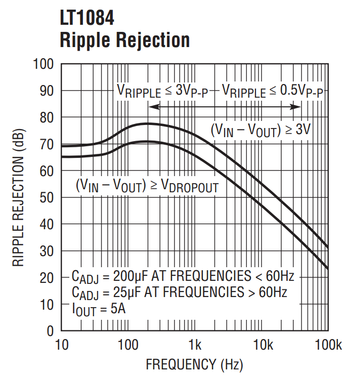

... the 200Hz harmonic ripple going into the reg is 7.2mV ...
What is your stopping criterion, your "good enough for me" finish line? Presumably it's stated in terms of output ripple, which is input ripple divided by 2.2E3 (LM317), or input ripple divided by 3.5E3 (LT1084).
Have you met this design objective yet? Or do you need further iteration?
With respect to noise rejection, I would say that if the modelling of this circuit is even close to reality then I am there.
If there's some easy yardage to be had, for example for capacitor longevity, safety or other reasons, then I'll take it but PSRR seems rather good.

One thing I was wondering about was output impedance. Model output below. The bump seems tiny to me but one person suggested I try to reduce it.

You can connect an ideal current source to the output, that switches from 95% of Iload_max, to 5% of Iload_max, in less than 200 nanoseconds. If this step function current produces non-damped oscillations near the impedance bump frequency (250 kHz), that would be a concern. IIRC Bob Cordell's book discusses closed loop gain-peaking {on log axes} and suggests worry-thresholds for how tall a peak can be before it becomes worrisome.
In SPICE you'd use a PULSE current source, with risetime=200ns, falltime=200ns, high time=20us, low time=20us, period=40us. This lets you observe the 5%-to-95% transition, and the 95%-to-5% transition. Your circuit will handle one of them far worse than it handles the other. But which? Why predict, just simulate both and let SPICE tell you.
