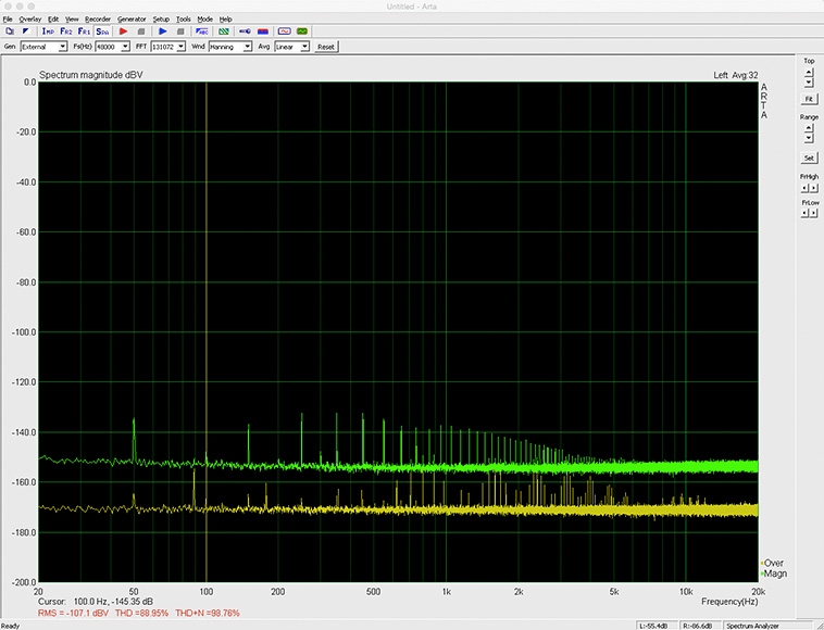

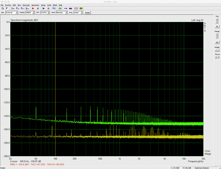

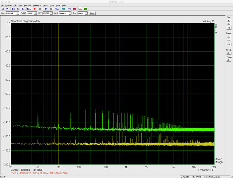

I redid the measurements with the changes to the resistor values and with the Juli@ XTe. I have still only entered the modelled gain of the pre-amp rather than measured its actual value. I think all these need to be taken with a bit of salt. Clearly specialty equipment is really required to do this sort of stuff well. I wonder if Mark has access to such in order to measure the regulator board he put together.

No, I only built that regulator to see whether I could get the whole thing to work on the very first try, including double shunt regulated VREF (from the raw DC input, a la Sulzer), opamp powered from the input for better load regulation, and a single MOSFET pass transistor + frequency compensation circuit that works with 0.6 MHz opamps and with 60 MHz opamps. Having achieved those objectives, I do not plan to put it through further testing. Besides, I've got newer ideas that I am convinced will perform much better. If I only get one chance to submit a board to Jack Walton and the New Jersey Audio Society for rigorous testing, I don't want to squander it on a preliminary effort which lacks many of the hot rod parts, unorthodox stunts, and exotic departures from conventional practice that I'm considering.
For true glory I suspect you will need to submit both positive and negative regs...
