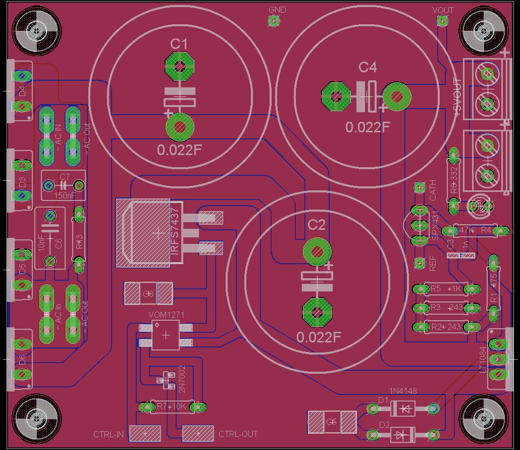

Latest version attached. Hopefully this is looking ok and I can turn my attention to the power rails and current controls.
I hope I can solder C4 - it will be the smallest part yet. I've extended the pads to make things easier (as I did with the 100nF surface mount caps) - time to learn frying pan surface mount soldering I guess…

Ok so I am now working on the main power supply boards, looking at low RDSon NMOS pass transistors and I come back to my question regarding soldering.
While choosing between them may be polishing the proverbial, I need to pick one and run with it. Should I just forget about D2Pak? 😱
How difficult is it to hand solder a D2Pak or D2Pak 7 Pin package. Is it possible with the drain tab? I want to learn how to do "skillet SMD soldering" but would like to be able to fall back to hand soldering if I find I am mess in things up. This will help me choose the NMOS transistors (IRF1324S 1.0mR max Rds(on) D2Pak 7 Pin; IRFS7430 1.2mR max Rds(on) D2Pak, TO-262, TO-247AC, TO-220; IRLS3813 1.95mR max Rds(on) D2Pak, TO-220AB; IRF8252 2.7mR max Rds(on) SO-8 etc.)
Actually, ignore my question above. Unless I have missed something, I will run with IRF8252. It has Max Vds = 25V and Id = 25A which would seem to be plenty; Max Rds(on) = 2.7mR; easy to solder SO-8 package (as noted by Mark some time ago) and Max Power Dissipation of 1.6W @70C which is more than enough headroom for the 67.5mW I will need. Less than half the price of the IRFS7430 which, while it has higher ratings in a number of areas, it isn't worth focusing on the lower Rds(on) (1.2mR) given the potentially more challenging D2PAK package (although I note my thermal demands are such that reflowing solder all the way under the drain tab likely isn't critical).

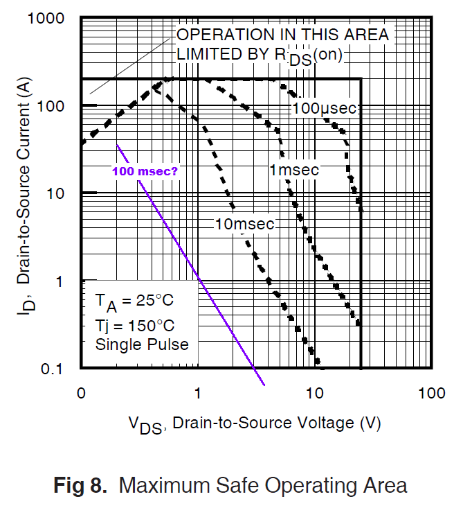

I copied the slope of the "10 msec @ high VDS" piece of the Safe Operating Area curve, and positioned it with approx the same spacing as the other curves.
When the switch finally gets the okay to "commence soft start", the MOSFET drain is at Vsupply (12V, 5V, 3.3V) and the MOSFET source is at 0.00 volts, so Vds = 12 or 5 or 3.3 volts. Notice the permitted Ids. Cowabunga!
Of course, they plot the curve for a worst case temperature scenario so you get that margin-of-safety back. But still: owww!

Hmmm... so she blows. So I understand, the 100ms comes from where? As the output caps charge, Vs rises, Vds falls and so does current. I know the formula for Vc as a function of supply voltage (in this case Vd) but... (Also, when I look at the same chart for the IRFS7430 is has a curve for "DC" - what is meant by this?)
I also see that with Vd of 12V and the VOM1271 at 20mA current providing Voc of 8.7V then a Vgs limit of 20V isn't enough...
Ta=25°C in that plot tells you that the device is tested without a heatsink and that at the start of the pulse the Tc also equals 25°C...........................
Of course, they plot the curve for a worst case temperature scenario so you get that margin-of-safety back. ................
That is the best case for junction temperature.
If Tc starts higher due to previous history of dissipation, then the permissible currents go down according to the temperature de-rating, usually specified in the datasheet.
That plot also shows that this mosFET is affected (quite severely) by second breakdown.
Many here deny this can happen for mosFETs.
Try plotting on the 1.6W curve (straight line). This would be the DC line.
This new line clearly shows that the 100ms guesstimated line cannot be correct.
Then try estimating where the second breakdown knee happens.
note that the second breakdown knee is shown:
100us - 17Vds
1ms - 5Vds
10ms - 0.5Vds (not the second knee @ 1.1Vds)
Hmm, Tambient = 25 C and Tjunction = 150C according to the plot legend.
Sounds like they put the parts-to-be-tested in a preheater at 150C, to stabilize TC = TJ = 150C. Then when the loader machine slides a part into the DUT socket, sounds like they turn on the Thermostream (semiconductor tester air blower {LINK}) at 25C during the test. Voila, Tambient = 25C and Tjunction = 150C.

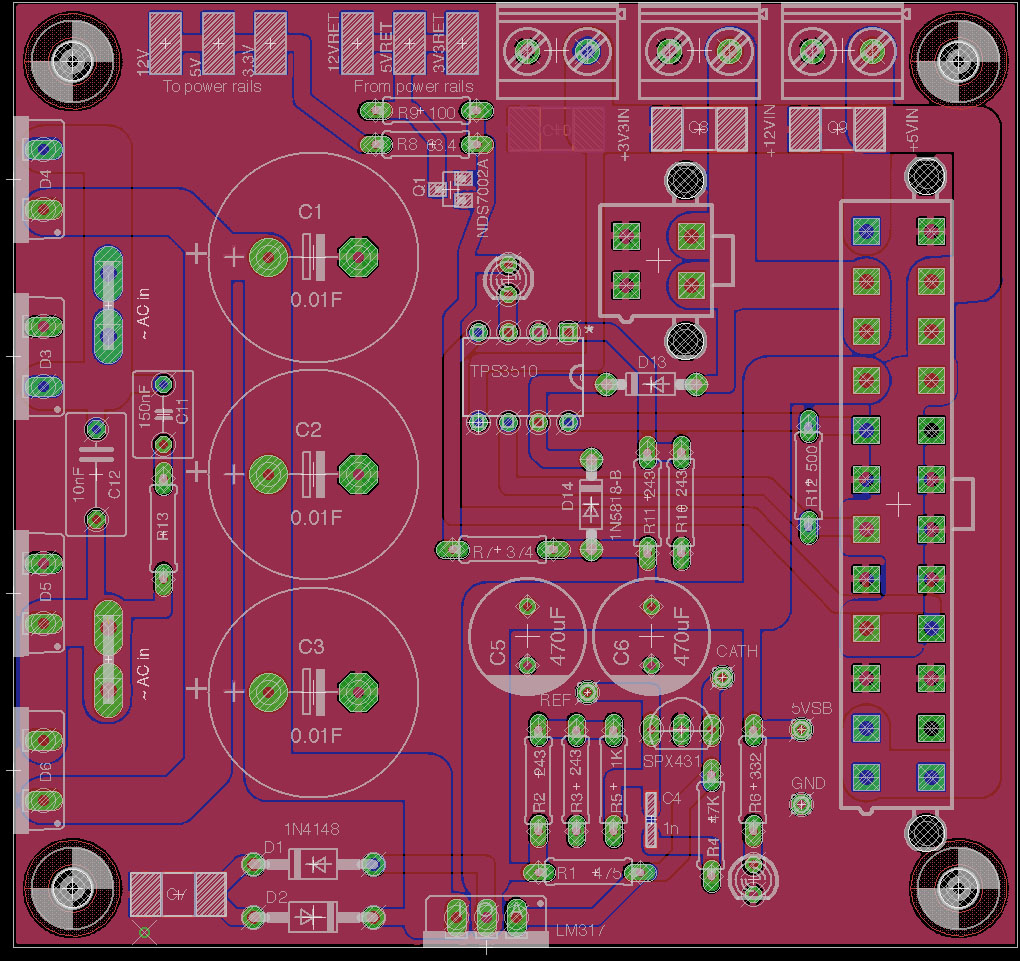

Hi
I spent a few hours today working on the PSU board (work is slow). See attached draft. I still have a few things to do e.g. I should remove the resistor values for parts that will depend on desired output voltage. C8 is a placeholder for now.
I also looked at the datasheets of various International Rectifier N-MOSFETs and their max safe operating areas. I understand that a DC curve is for continuous current (rather than pulsed) and looking at this curve is a safer thing to do. If the FET can handle 12Vds + 5A continuously then it should be fine (?) assuming I manage to curb the in-rush appropriately.
From this exercise, it seemed that making the leap to a D2PAK was worthwhile (or even necessary). With minimal Rds(on) and only up to 5A of current, thermal considerations would seem very manageable. Take, for example, the IRFS7437. Unless I am missing something (and I probably have 😱 ) thermal resistance junction to ambient is 40C/W and so, using worst case Rds(on) of 1.8mR and full 5A rail current, that's only 45mW of power dissipation for a mere 1.8C rise from ambient. Also, while Fig 10 requires some estimation of safe operating area for a 12V Vds, looking at the DC curve it would seem 5A is "ok" ?
I tentatively put forward my draft for scrutiny....
Steve
PS: One question about traces for smoothing caps. I have always thought of current flowing into the caps sequentially (C1 fills and then C2) and hence the trace must go to C1 before continuing to C2 and on from there. Hence I have the trace snaking through the board. This wouldn't seem consistent with power planes, however, and so I'm questioning whether this is correct...

Just in case it wasn't obvious:
- the plan is to mount the rectifier diodes and LT1084 on the enclosure
- AC Out is intended to provide a junction to share the AC secondaries with another board should it become necessary/desirable. I'm not sure I have enough gap between them to allow two insulated Faston connectors... Also, would I need the snubber on the second board?
Rather a surprising schematic.
AC -> rectifiers -> two electrolytic filter caps -> MOSFET switch -> no caps at all -> LT1084 voltage regulator -> one electrolytic filter cap -> +5V output
I was under the impression your goal was to put the switch(es) downstream of the regulators, so that the voltage dropped across the switches immediately reduces the regulated output voltage by (Iout x Rds_on).
No that was the problem I encountered and sought to avoid.
Originally, I had the 5V (and 12V and 3.3V) power rail and no standby 5V. This was because I couldn't figure out how to have the switches triggered by anything other than PWR_OK i.e. the main power rails and regs were always 'on' and the switches would have sat on the other board with the TPS3510.
I was then introduced to the issue of Rds(on) and I thought it foolish to invest in regulated power rails only to (intentionally) introduce a load-dependent resistance after regulation. (Now if that is just a couple of milli amps perhaps it's a non-issue...)
(With help here) I then managed to get the switch trigger to be FPO low (or at least I think it works). So now PWR_ON signal comes in, FPO goes low, the power rails are 'turned on' (current flows from the initial smoothing caps to the regs and output cap) by the 5VSB and TPS3510 "control board", the rails come up to spec voltage and then the TPS3510 sends a PWR_OK signal to the motherboard. Probably more like what's meant to happen. Rds(on) now sits before the regulators which can combat its (now minimal) resistance. One problem with this setup is that when the power rails are meant to be turned off there's still the charged output cap. The advantage is that the switch and gate cap regulate the initial in-rush through the regulator.
Well, that was the thinking... Am I smoking dope?

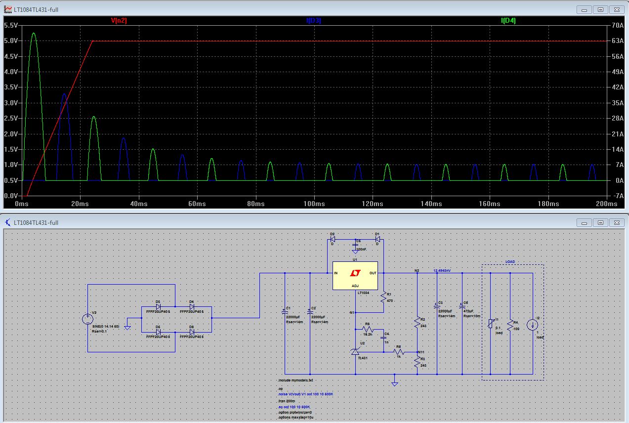

I've redone the stability, PSRR, output impedance and transient analyses for the 5V power supply with the larger caps. I did not, at this stage, insert the pass transistor into the analysis but will do so. The LT1084 (rather than LM317) and the larger filter and output caps implied a different value for R4 in the circuit (16.2k rather than 47k) and the peak output impedance seemed to benefit from the addition of a 470uF output cap after the large one (albeit this peak is at circa 200kHz - should I care at all?). Adding the additional output cap altered stabilisation and hence R4. I will post a link to the results of this work later.
Current flows. I had also modelled an AC source plus rectifier diodes as I am also aware of the points you raised above. I could not find a model for the 30A FFPF30UP20STU diodes I was planning to use (and which you had once recommended to me). I did find a model for their 20A equivalent, the FFPF20UP40S, and have used that for now.
The results of this are strange and perhaps I am doing something incorrectly. Or perhaps the modelling is correct and highlighting a problem with the circuit. See attached.
Even with just a 1.15A load the current through the diodes settles at 7A peak. Yes, there's the in-rush as the caps are charged but this appears to be within the peak limits. (The FFPF20UP40S have a non-repetitive peak surge current 60 Hz single half-sine wave absolute maximum rating of 200A while for the FFPF30UP20STU it's 300A, as I am sure you are already familiar with.) The one exception to this is the second wave through D4 but this would be below the repetitive peak limit of the 30A version.
So this doesn't seem like a good foundation for looking at current through the filter caps - unless of course a problem with the filter caps is indeed the cause! When I look at current through the LT1084 I see it rising sharply after a few milliseconds to a touch over 6A (limited by regulator?), presumably as the output caps are charged, before falling to 1.16A (with a 1.15A load) after about 26ms.
The 25V (29V surge) caps I have are rated as follows:
- rated ripple IR~ at Tmax and 100Hz: 5.4A [the R is not presented as a subscript]
