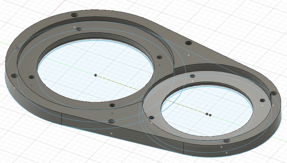

For those interested, I've created a digital model for 3D printing based on the SEAS 27TBFC driver. Fits perfectly and aligns with the original screw holes. Given the changed dimensions of the tweeter I'm not sure I can build the recess for the grill in. I may end up designing a grill specific to the mid, since the new tweeter has it already built in. I haven't figured out how to share a photo on here yet. Since the prototype worked I'll likely get another printed and put the speakers into action.

So that rendering is the back side. The drivers are reverse mounted. The front edges where they meet the drivers are filleted (rounded) for that very reason. I should have done a front rendering... Maybe I'll open the model later today.

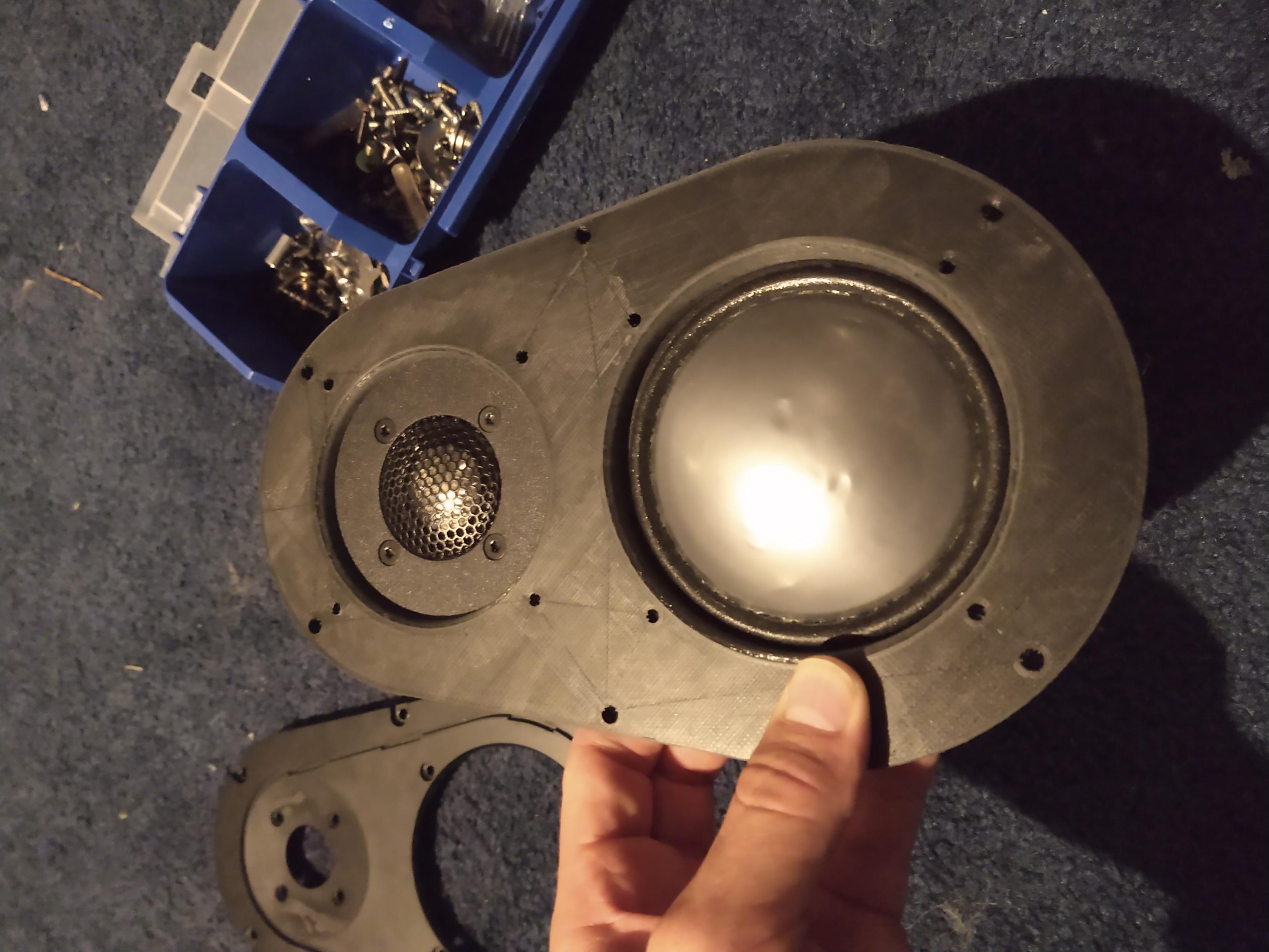

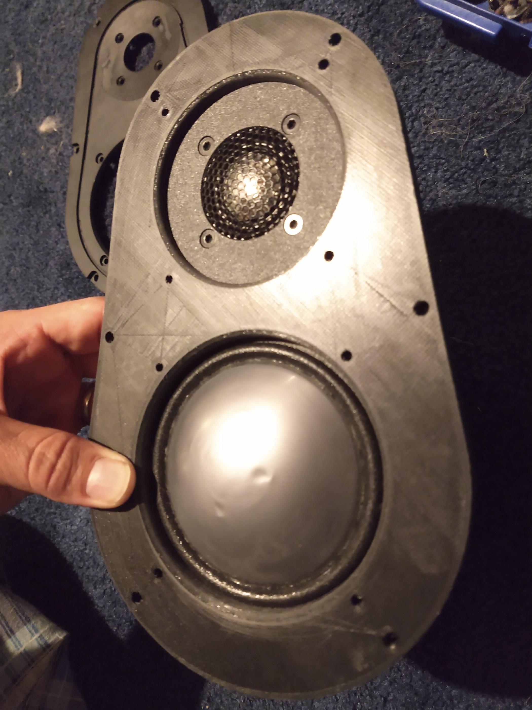

I actually haven't used them yet. The prototype baffle just came off the printer around 6pm. I only had 1 printed to test fit. I suspect the cab may need to be modified slightly due to the larger SEAS tweeter that had to be shifted 3mm down.
I'll get a second one printed this week (not my 3D printer). and then do a proper test. That said, I'm hesitant to modify the cab until I know if the original tweeter can be repaired or not.

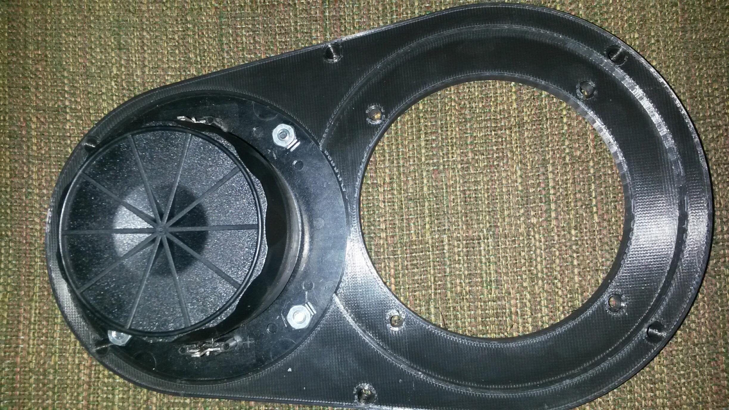

You probably modified the cabinet already. The terminals for the tweeter are on too large of a diameter to fit the cutout in the cabinet so I took a rotary tool with a bit that is used for cutting wood and cut a notch in the cabinet to clear each terminal. Only had to cut in about 1/4" and 1/2" long for each terminal. The rotary tool I thought would make the least amount of saw dust to keep things clean.

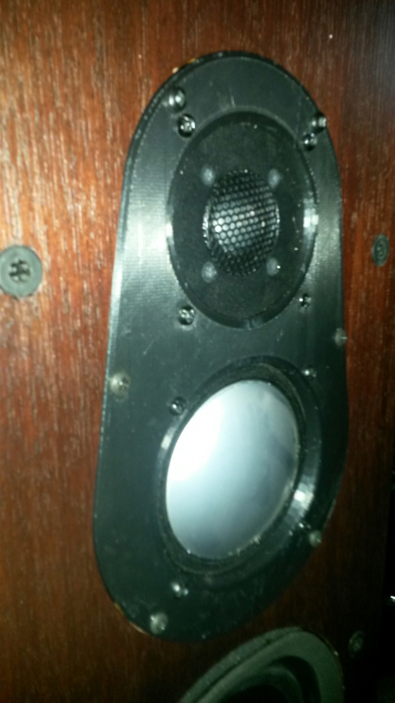

Endervox sent me the panels he made and I got them installed. Everything worked pretty well. Had ground out the cabinet for clearance for the terminals of the tweeter and then had to grind out a little more of the cutout in speaker cabinet for tweeter to move about a 1/4" lower to fit the new panel and also fit into the cabinet. Used some 8/32 bolts and nuts to mount tweeter to panel and tapped the midrange for 8/32 bolts also - the original is metric thread and I didn't want to hunt around for longer bolts in metric and the 8/32 was not much different so not much removed with rethreading.
The plastic is a little soft. Some washers under the bolt heads would have been a good idea in hindsight. Couldn't find black hardware where I was looking so just painted some bolts. Never thought ahead enough to paint some washers.
