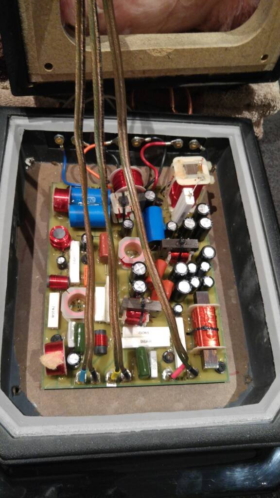

Some more pictures just for the history books.
Thanks for the pics Ken!

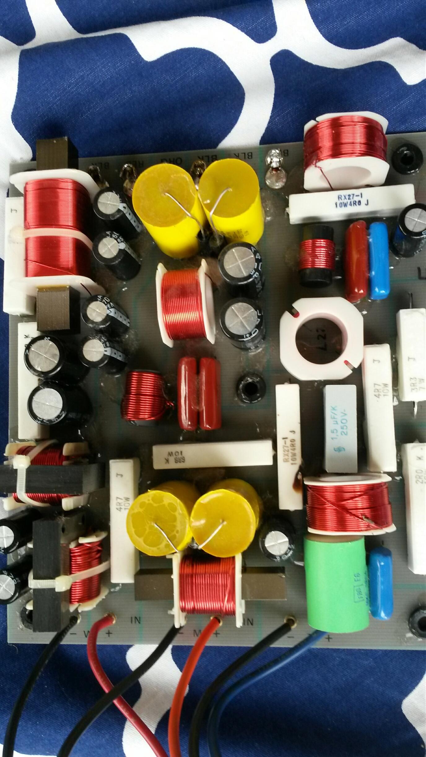

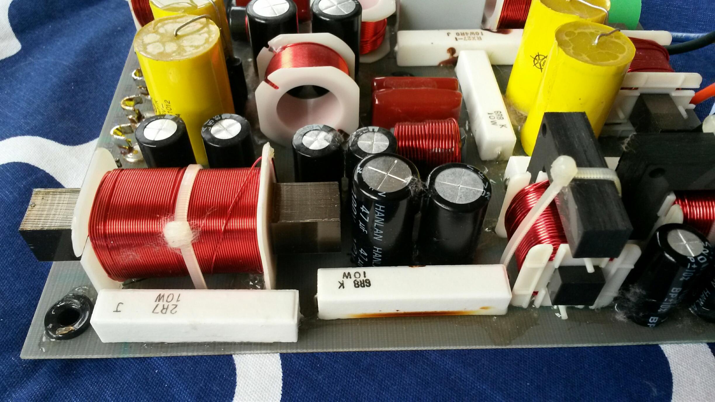

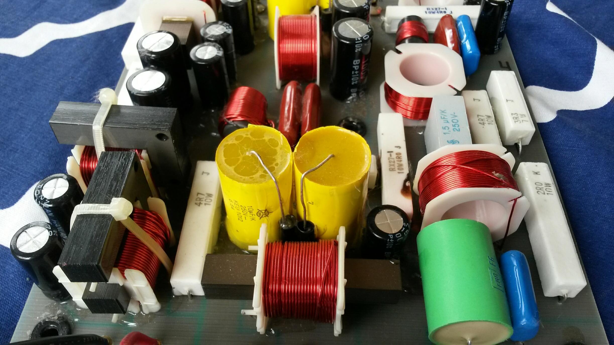

Here's a pic of the 2.8's crossover.
It has a bunch of extra parts when compared to yours.
I figure that explains the speaker slopes seen in the Stereophile review .
BTW, where did you get the crossover schematic for yours ?
You don't by chance have one for the Veritas 2.8 do you ?

That is interesting. As I understand it both speakers used the same mids/tweets. The midrange is cut off lower at 380hz on the 2.8s which I can rationalize but the tweeter is 2.5khz on both designs. Perhaps it is a marketing plan where Energy knew they could obtain better performance in the tweeters of the 1.8s but instead gave the 2.8s their best offering and gave the 1.8s a slightly lesser performance. It would be an interesting trick when a customer is doing A/B comparisons in a sales room between the two designs. Bass is a little deeper, highs are a little smoother so the 2.8 is purchased.
Space may also have created a compromise on the 1.8. Its pretty tightly populated and there is not much room to make the board bigger to fit the base. They would have to mount it to a vertical wall of the cabinet if it was any bigger.
No industry connections or any special skills for me on the crossover drawing. An internet search found it for me on this website. I did search quite a bit for info and didn't come up with much therefore figured I would post what pictures I can. The 1.8 drawing is exact to what I have.
Not likely. The markings are not in the Foster format. I have seen those kinds of markings but have over 2k of pictures to go thruyet to try to find simialr markings.

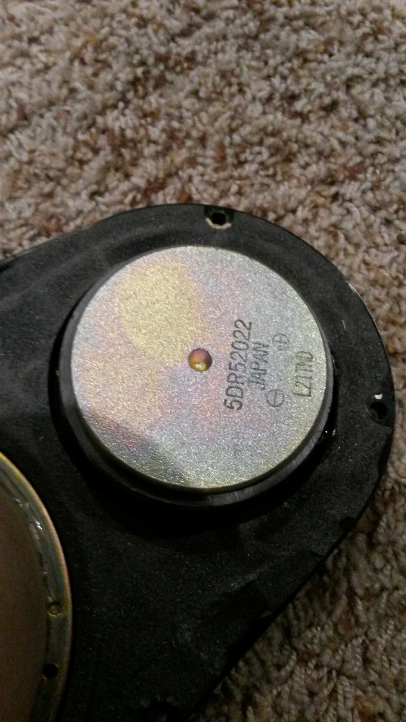

LPG? I seem to remember their metal dome tweeters not having dispersion/phase
plastic in front of them similar to that look. This is an auto version:
LPG 26NA Aluminum Dome Car Tweeter
I'm really surprised that they would bother to notch the metal dome resonance since it
is above the audible range. I bet they are doing it for better measurements. If you want
a hard dome but with an even higher breakup this corundum dome tweeter might be interesting:
Peerless DA25TX00-08 1" Corundum Dome Tweeter

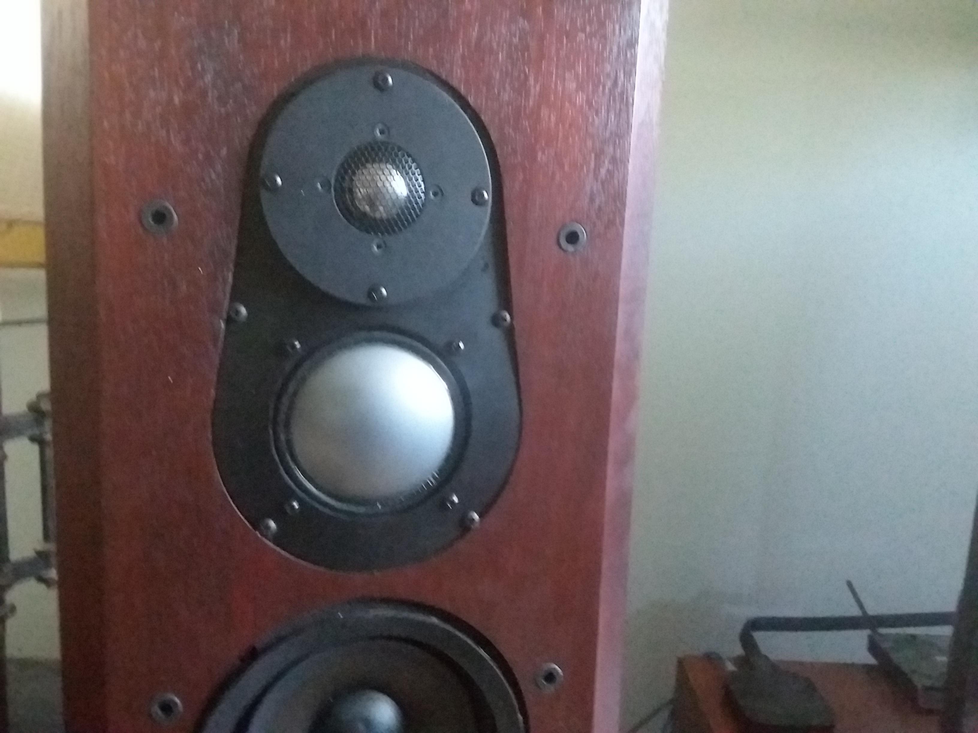

Hello. I'm in the same situation. Since the recommendation seems to be the SEAS 27TBFC/G06, I haven't seen or potentially understood if crossover work is required for this tweeter. I'm prepared to order a set but would like to know what I'm getting into with the xover, if anything.
Assuming "same situation" means you also have Veritas 1.8's , I would advise proceeding with some caution.
To the best of my knowledge, Ken never did buy and install the SEAS tweeters ( or if he did, he's never mentioned it here ).
( Chris at ) Solen did recommend the SEAS 27TBFC as an electrical replacement // it's still uncertain if it physically fits or what may be required to make it fit ( you'll need to check that out for yourself ).
Crossover mods ?? My simulations show that one can drop in that SEAS and start listening ( a minor mod > a disconnection of a one capacitor might be required if you find the replacement is "too bright" ) .

Sorry I should have been more specific. Yes I have a set of Veritas 1.8's. Funny enough a friend of a friend gifted them to me. I have tried reaching out to Ken to see what he actually did and if he went with the SEAS. I've heard nothing. Wouldn't it be something if these were actually Ken's speakers? I know... doubtful...
OK, so I'm just going to do a bit more leg-work and double check measurements as well. at cursory glance I'm thinking it should fit. I believe the biggest difference is the magnet diameter which is probably no more than 3mm difference, likely less. When I pulled the driver assembly out I believe there's enough play to put in without having to ream out the baffle.
From the looks of it, the drivers are on back-order at Solen. Perhaps I'll touch base with them today or tomorrow. I'm not in a rush to get them however, as I needed another set of speakers like a hole in the head. HOWEVER, they're known to sound great.
Once acquired I'll pop the tweeters and and give them a listen. As one of the tweeters is good, I'll continue searching for a match but the SEAS will have to work for now. If it's too bright then we can revisit the cap mod. Pretty simple undertaking. Which cap specifically are we talking about?
It's the 1.5uF cap ( in the tweeter section ) that's part of a series LCR that's paralleled over a 4.7 ohm resistor.
- The LCR is setup as a PEQ boost that's centered at around 9.7khz).
It's that parametric EQ that might not be needed ( it's definitely a matter of taste, +/or hearing loss 😉 ) .
- I'd personally keep it active for my 66yr /old ears > though I'd be inclined to shift it upwards a bit for a higher center frequency > 1uF instead of 1.5uF would likely do it by shifting the center frequency up to 11.9 khz .

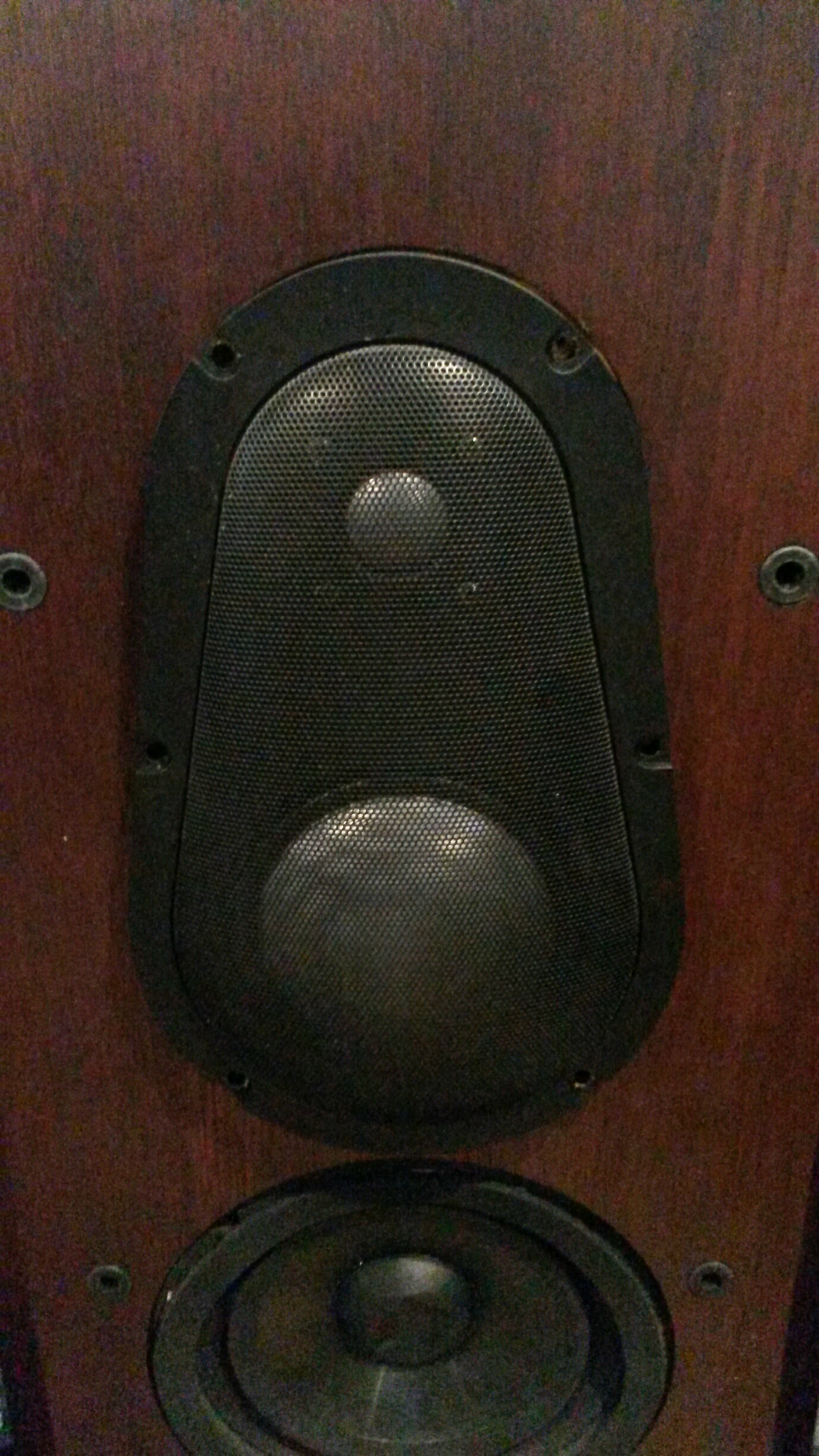

Any idea if you can remove the plastic/grill without it pulling out the diaphragm and VC? Obviously that front housing will have to come out, but I'm hoping it's not somehow attached... ??
Tweeter Removal ?
There are some clues ( left by Ken ) within the first page of this thread .
I imagine that the protective screen is held in place by the large tear-drop shaped trim ring// gasket ( but I don't really know ) .
That mesh/screen won't have anything to do with how the tweeter is a-fixed or mounted to the baffle board .

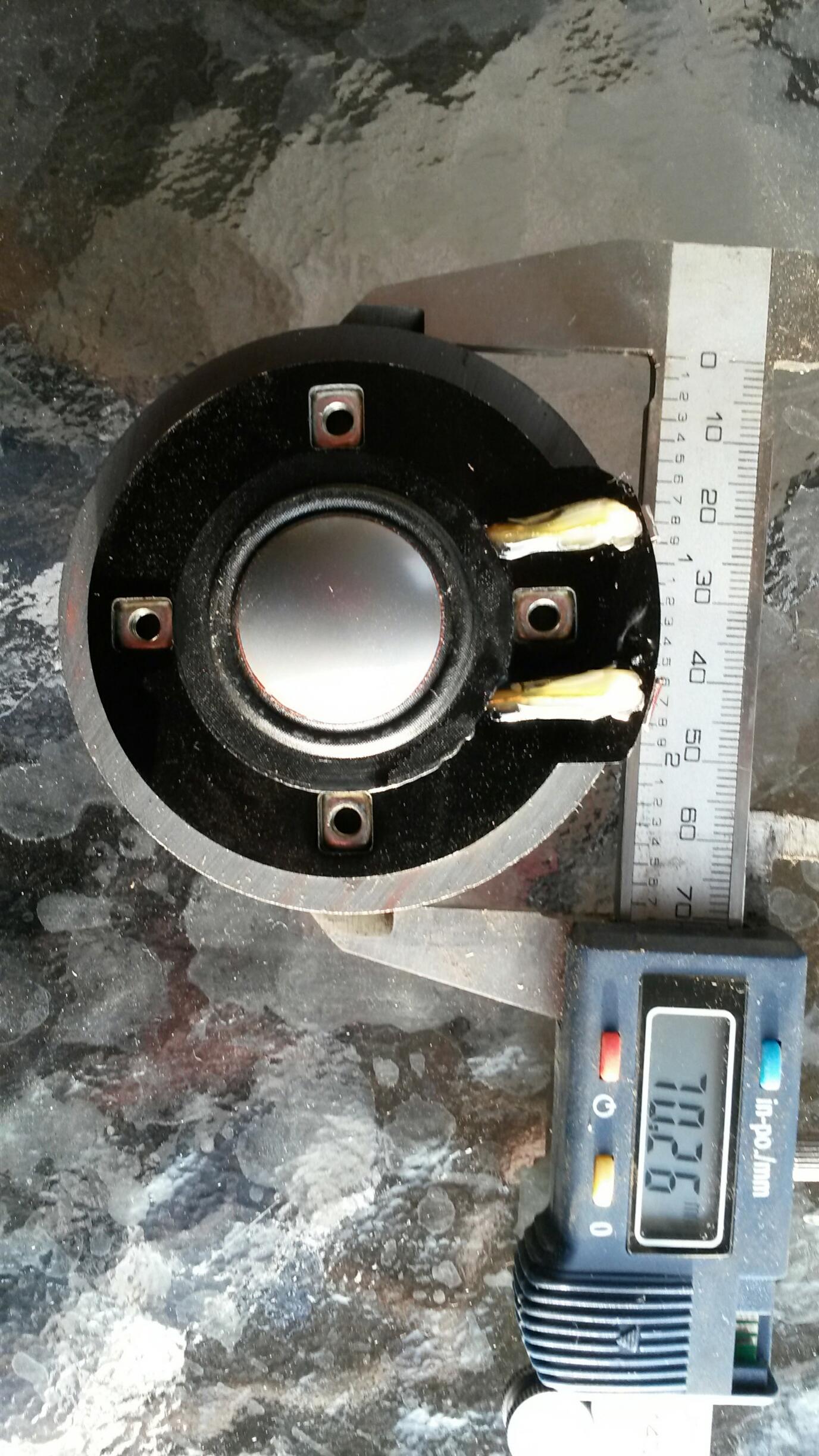

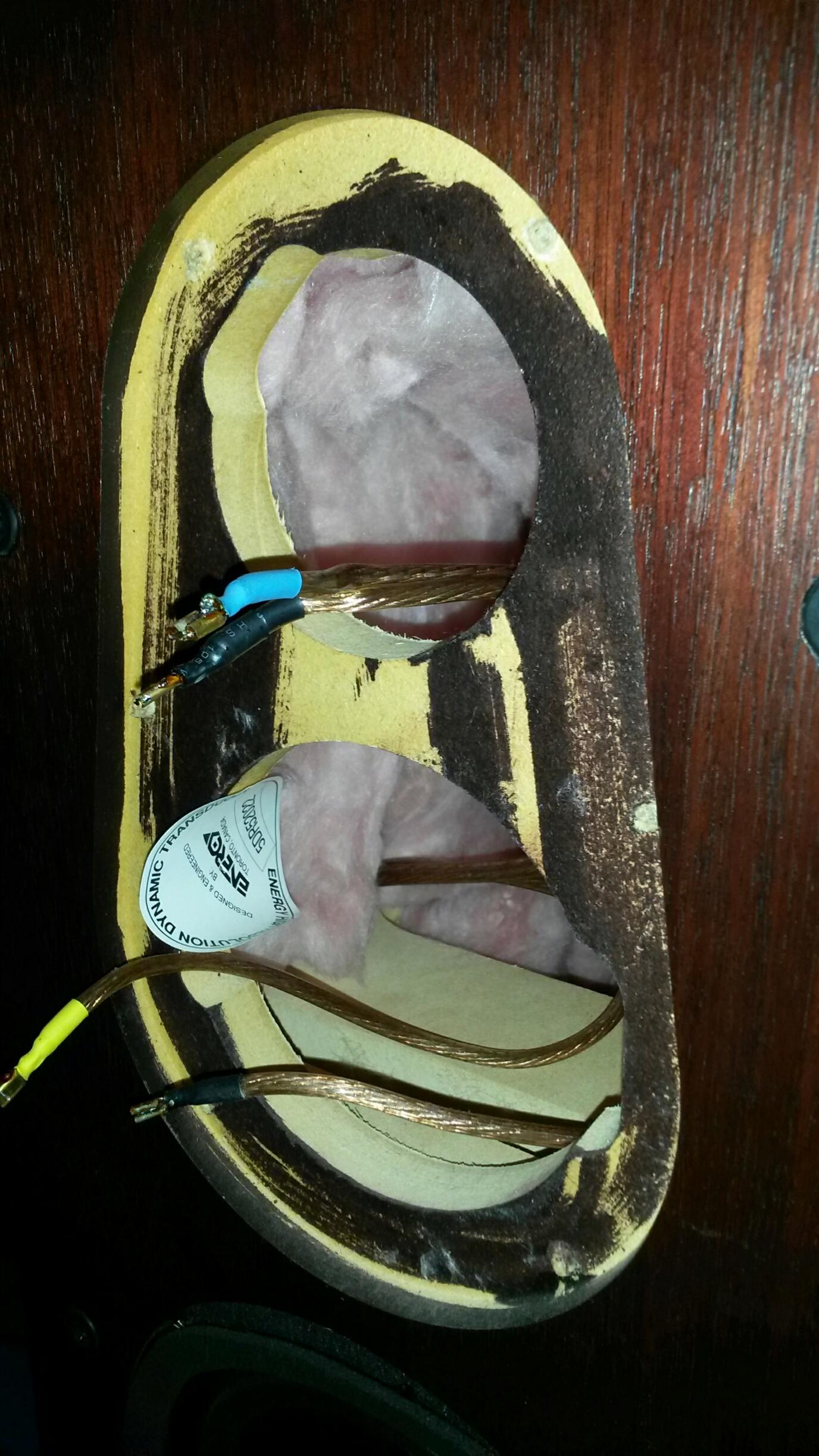

I'm not sure what the best way to upload photo on here is but I dismantled the assembly and took some photos. It kind of fills in some of the gaps in photos that Ken took. Essentially the mesh grill of the assembly pops off (rather easily) then you unfasten the 4 screws that hold the tweeter to the assembly plate. The plate is plastic, with a hole the size of the diaphragm. I suspect there will be some modification required.
The big question will be if the decorative ring can come off the SEAS tweeter and not take the diaphragm with it. I've emailed Solen looking for feedback but haven't heard anything yet.

Yes, I should update this. I went with the SEAS unit. Did not change anything on the crossover except a few caps on the midrange section because they were easy to come by. Didn't modify the tweeter section at all. Don't mind the sound, don't find the tweeters too forward. Certainly nothing noticeable to me but perhaps a frequency response test would say otherwise.
I made an adapter panel with some Hdpe I had laying around. The proper way to do all this would be to make a panel from wood so a recess could be cut in the front for the tweeter and the midrange needs to be recessed into the rear of the adapter panel. The midrange is not recessed into the speaker cabinet therefore this must be allowed for in the adapter panel. Therefore my use of hdpe is far from a quality change over. Keep in mind I was doing this through the scamdemic crap and businesses were not all open to the public or unwilling to have some one walk in the door to get a small item done. I don't have a router so did not have the ability at the time to do it myself and also a custom shop was off the table also. So I compromised.
I don't think you can remove that front plate from the SEAS tweeter. I wanted that option but looking at it myself I don't think it is possible.
The midrange dome is now exposed to risk of damage. The best I can come up with is either get some metal grill material and press a piece at home to create a cover or get something like a 4" speaker grill and screw into to the adapter panel.
I can always redo the adapter panel with wood in the future. With the grill cloth in place what I have now is out of sight so out of mind.
