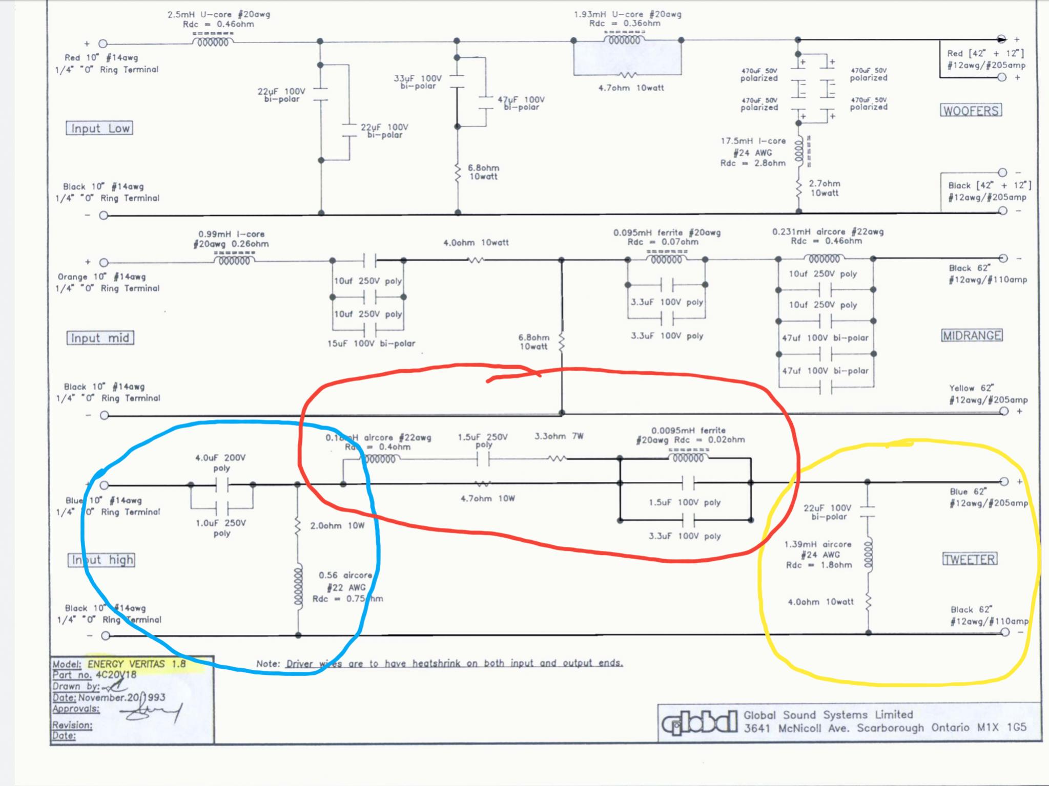

Much of the stock tweeter crossover is dedicated to sharp, frequency dependent corrections specific to the original tweeter. Fortunately you may not need to recreate their effect with a well chosen modern replacement, and can possibly remove or bypass them.
Apart from that the bass is removed with an L-section filter, whose resonance damping is affected partly by the series resistor.
Ok, to ensure I am thinking of this properly:
What is in blue circle I should not have to change since a similar tweeter design and size would use a similar crossover point so I likely would not be concerned with anything here.
What is in the Yellow circle is for impedance matching and therefore dependent on the tweeter ohms and impedance through frequency range. So perhaps that can be modified based on known performance of the replacement tweeter if it looks like this original design may be of concern.
The part in the red circle I don't know. I see the series resistor. The inductor/capacitor/resistor in parallel with the capacitors seem to me like a phase shifting arrangement. Is this the area that could likely be omitted? Aside from the 4.7 ohm resistor and two caps in parallel. It's a parallel circuit to the 4.7 ohm so lowers the overall circuit resistance therefore if it came to removing the inductor circuit path I would put a smaller series resistor in to start with.
Not going to try to reengineer the crossover, just want to understand the sections to know which I may need to give some attention to.

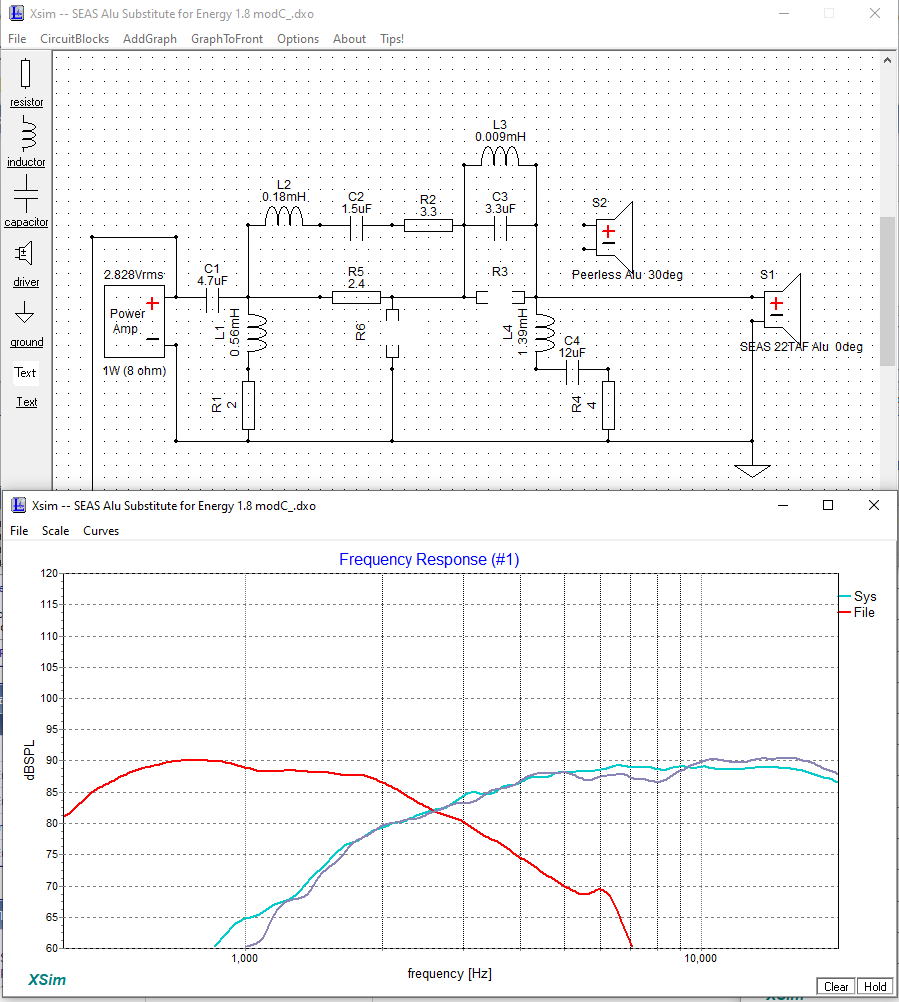

Blue ( Teal ) = the 2 Pole Hipass ( giving the 2.5K crossover point )
Yellow = a 910hz resonance trap ( notch ) that's wired across the load to attenuate the effects of the tweeters impedance peak.
Red ( there actually 3 distinct areas of interest here )
(a) 4.7 ohm resistor passes all audio above the 2.5K crossover point ( though the signal is attenuated by the resistor )
(b) ( LCR of .18mH + 1.5uF + 3.3ohms ) High Frequency Bypass ( with PEQ centered around 9700hz ) which allows a frequency dependent bypass route that skirts signal around the 4.7 ohm resistor ( effectively bumping up a specific frequency area ).
(c) The ( LC consisting of .0095mH coil paralleled to the 4.8uF cap ) is there acting as a 23.5 Khz "spike-killer" notch to reduce the effects of the typical UHF breakup that accompanies aluminum domed tweeters.
All the included parts offer powerful contouring capabilities that help match the curves of any replacement to that of the original tweeter ( IOW, they are really quite useful ).

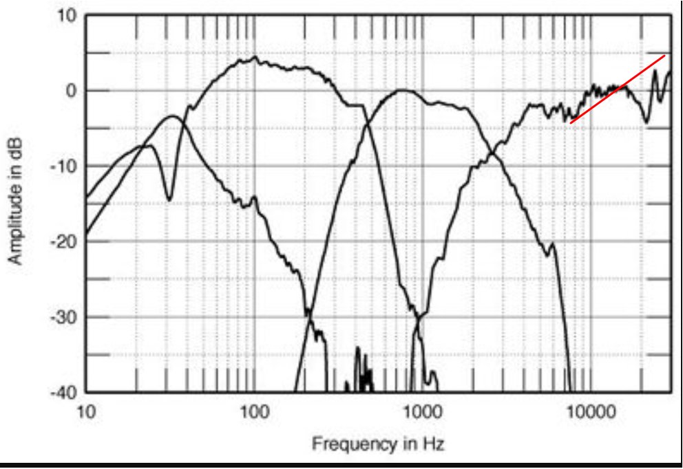

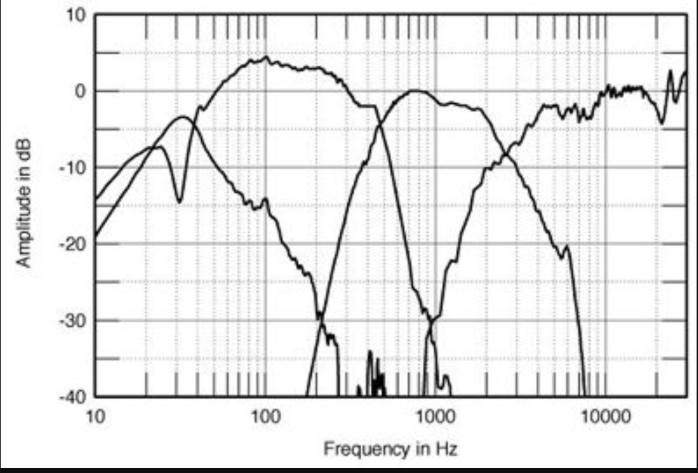

The original curves are here ( from a Stereophile review of the Energy Veritas 2.8 > which used the same mid/hi module );

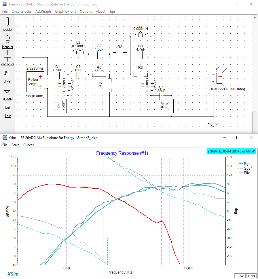

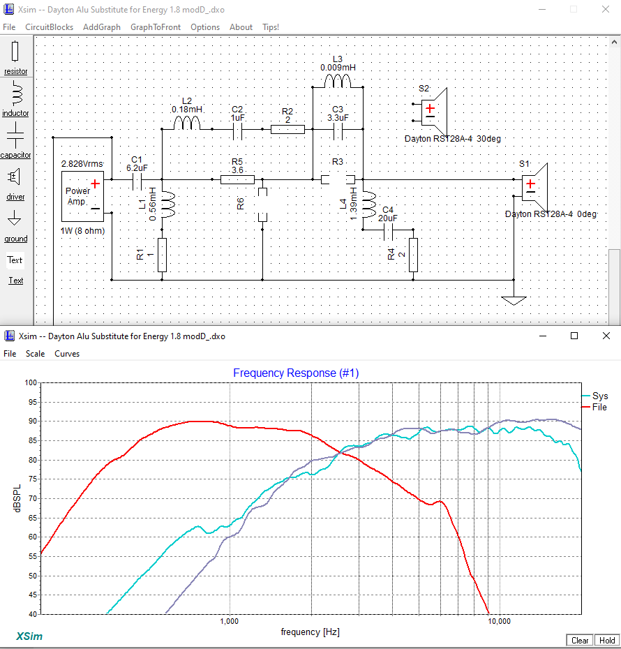

I'm done tweaking HiPass reworks for 2 of 3 possible tweeters in the less than $60. range ( taken from the Solen list I provided ).
- SEAS and Peerless reworks are finished with Dayton being the next needing some attention.
I'll eventually post all three when I'm finished ( sometime over the next day or two ).
EDIT: Here's the SEAS rework;
Blue is curve of replacement SEAS tweeter ( grey in background is original )
Red is 3" midrange ( derived from Stereophile review ).
attachment.php

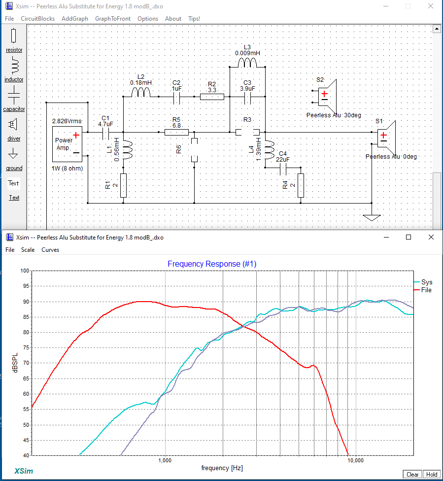

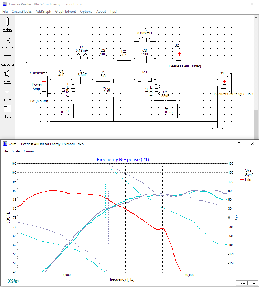

A revision since the 4 ohm version of the Peerless tweeter isn't currently available as a pair ( from Solen ) .
Therefore, here's the 6 ohm version of that Peerless.
attachment.php
FWIW, the phase tracking isn't as good as the SB version ( but then I'm only chasing imaginary lines here anyway ).
Also, like the SB I've added a 3rd pole ( capacitor ) to the HiPass to more accurately track the low-end roll-off of the original Stereophile trace.
  • Peerless Alu 6R for Energy 1.8 modF_.dxo
