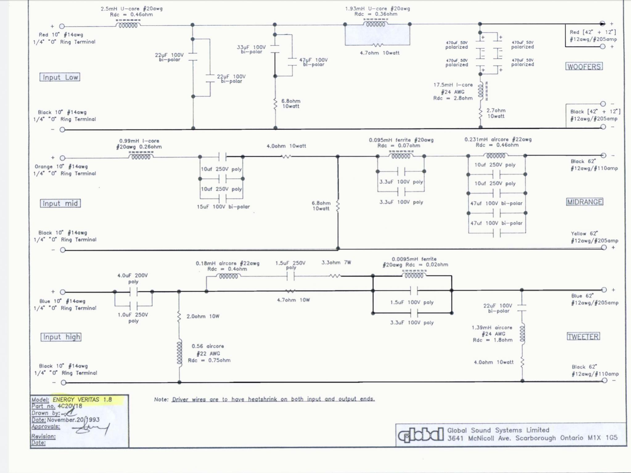

Energy Veritas 1.8 tweeters quit

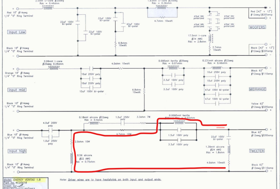

Wondering if the capacitors may have failed on the crossover rather than going worst case scenario and thinking tweeters are burnt.
I pulled out the tweeter/midrange unit far enough to get an ohm meter on the speaker terminals and get 8.0 ohms on tweeter and 3.0 on midrange. Midrange is making sound. So I don't think the tweeter is open or shorted but don't know proper spec to be sure. Leads are soldered so haven't disconnected right at tweeter.
These speakers are 25 years old now so wondering if it could be a crossover issue.
I don't even know where the crossover is or how to access. No obvious panel unless I must pull one of the base drivers out to access.
Is it possible the input caps are gone or is it wishful thinking?

Did you unsolder one end of the tweeter to check resistance? I don't think you did from what you say...
Your diagram shows a resistive path across the tweeter which would register even if the tweeter were open circuit.

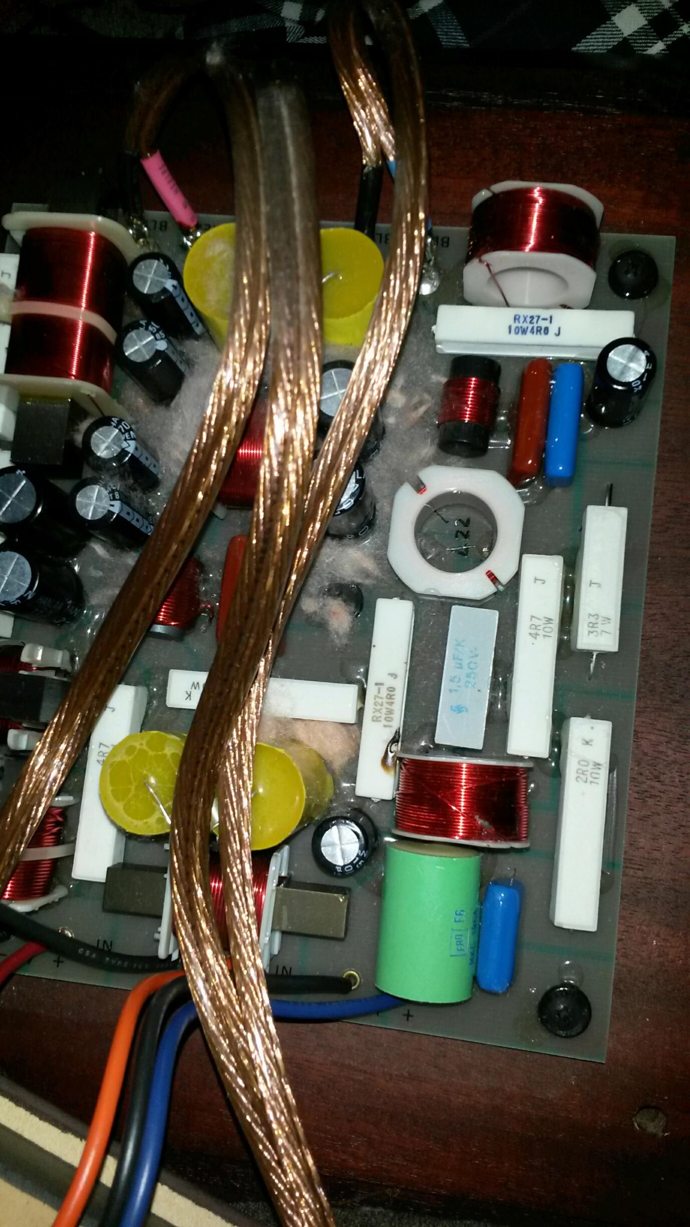

Missed that path through the inductor. I found the crossover is attached to base plate of speaker. The melted metal on 10w resistor seems out of place.
I will unsolder the lead on the crossover output and get a reading on tweeter tonight.

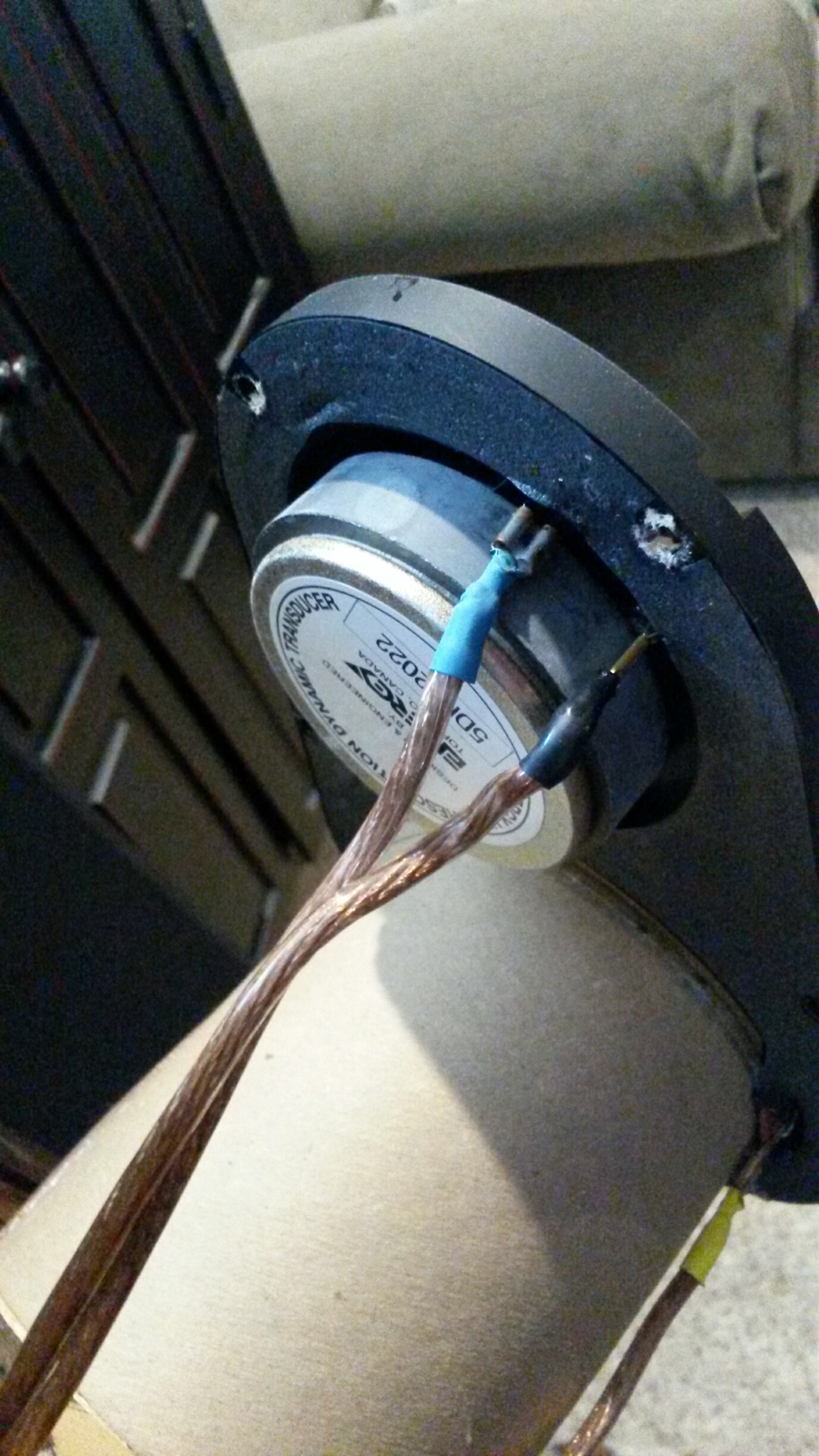

Reading open circuit on tweeter with the one wire lifted off the crossover so looks like I need to find some tweeters. How would I go about finding replacements? I can try Klipsch since I understand they bought out Energy. Is there some company out there that I can contact who can offer a comparable replacement?
That 4.0 ohm 10w resistor with brown spot it is 4.3 ohm so is ok. Must be a stray dab of glue got on it.

In the picture it looks almost like a solder splash... it's local and looks to be caused by something external during assembly. I'd just pick it off.

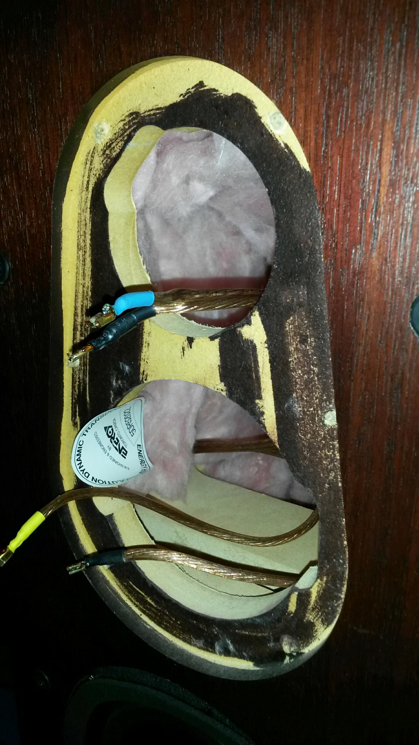

This appears to have been rewired. Is the discolouration beneath the blue capacitors some kind of chemical residue?
To help you pick a replacement tweeter, is there some kind of technical specifications paper on the web or sticker or plaque on the speaker? I'd be interested in the sensitivity at least.
There are a few different levels of replacement method, maybe the nominal impedance of the original tweeter would come in handy?
I have had these units since around 2004. Bought off a hifi salesman that had them at home, dealt with the guy for a few years so knew him well enough. Don't think they ever had work done on them since I never had reason to open one up. So any discoloration that is not an outright failed item would be from factory.

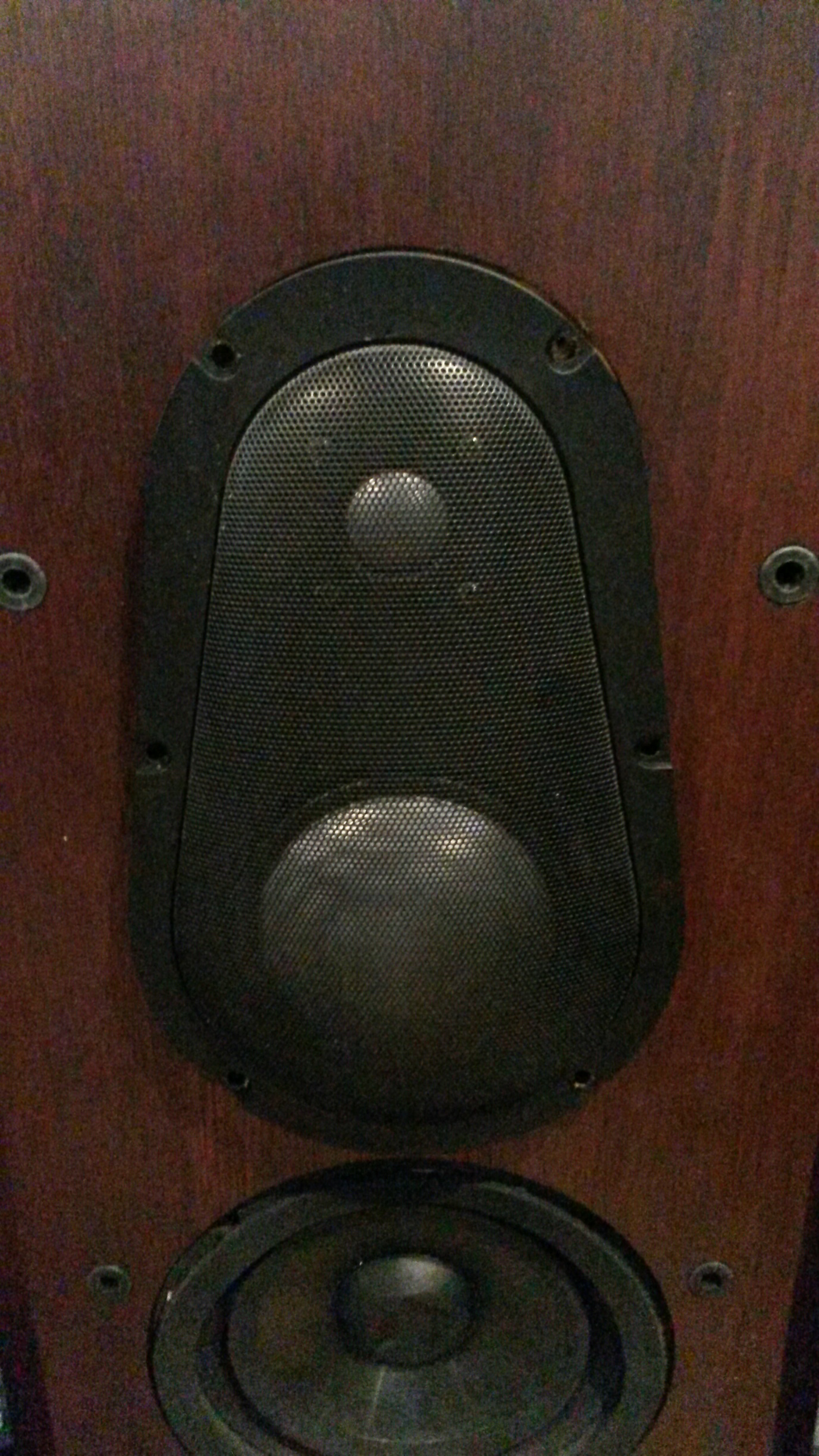

I'd suggest that you completely remove that tweeter ( from the plastic housing ) and then take a series of pics showing the tweeter from all angles.
The aluminum dome and large/thick ceramic magnet imply a certain level of quality.
The fact these speakers were from the 1990's ( when Dynaudio still supplied components directly through Solen in Montreal ) suggests a possible supply chain.
There are plenty of 1" ( aluminum dome ) enthusiasts around here ( and other forums ) that can should be able to make an educated guess at to what manufacturuer that tweeter was sourced from ( if you can just get the necessary pics put up ).
Also, quality substitutions can be had ( and most likely fitted ) once you provide the necessary mechanical specs/details.

Something to keep in mind here, your network has a few LCR notch filters dialed in to deal with the inevitable aluminum breakups >> those will need to be tweaked by a Pro if you substitute in a different tweeter.
+1/ That thick stranded wire is out of place — and from experience, may actually be counterproductive. I really doubt that such thick wire was factory.

How about a decent picture of the front of the tweeter.

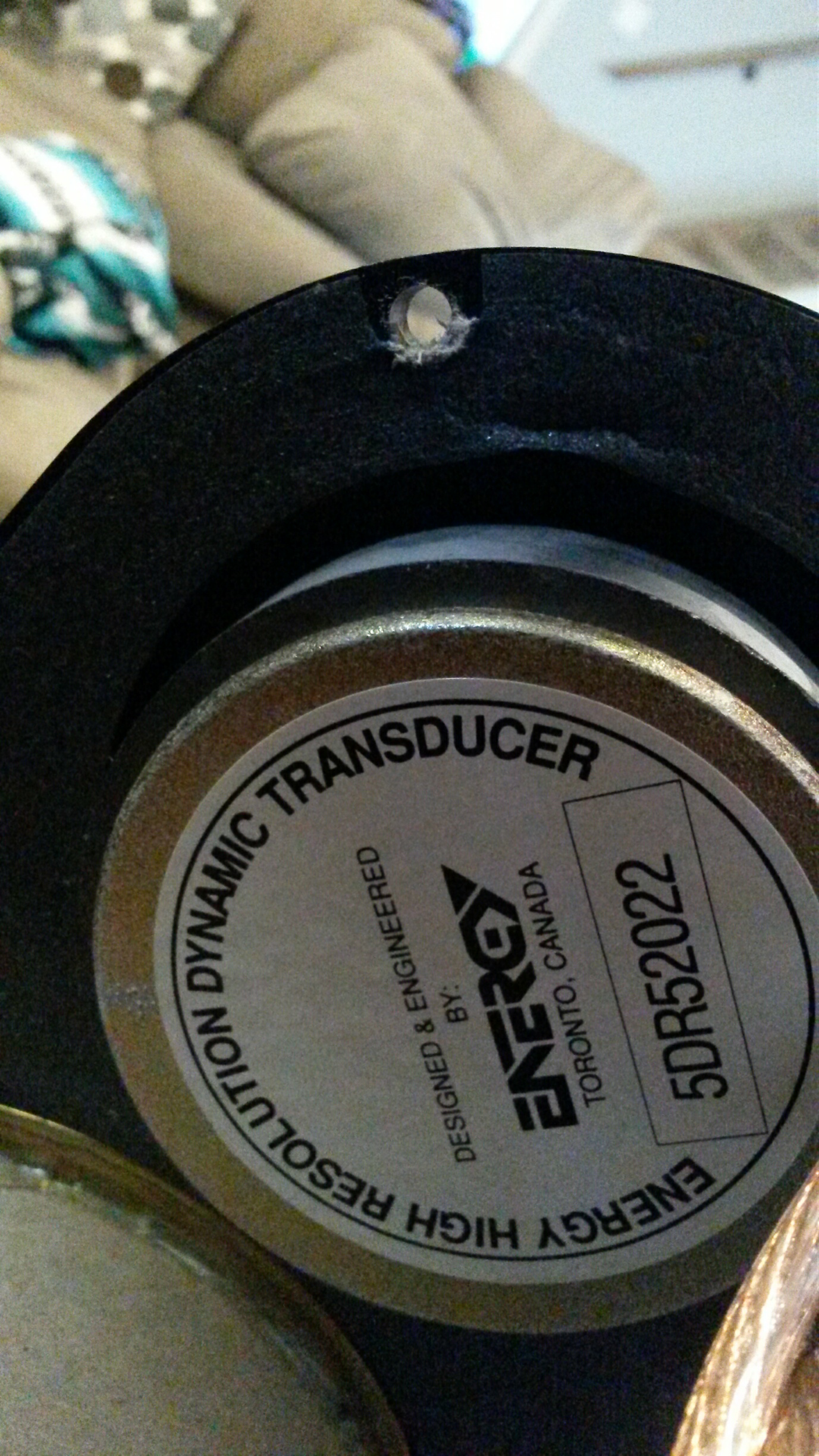

Ok, that's some good steps to pursue. I will get to pulling the tweeters out tomorrow perhaps. Taking the sticker off makes sense to see if there is an OEM part # or other such info underneath that won't mean anything to me but someone knowledgeable here may see as relevant.
From the info on the crossover drawing it does say 12 Ga wire so the wiring seems factory correct and so I am thinking likely untouched.

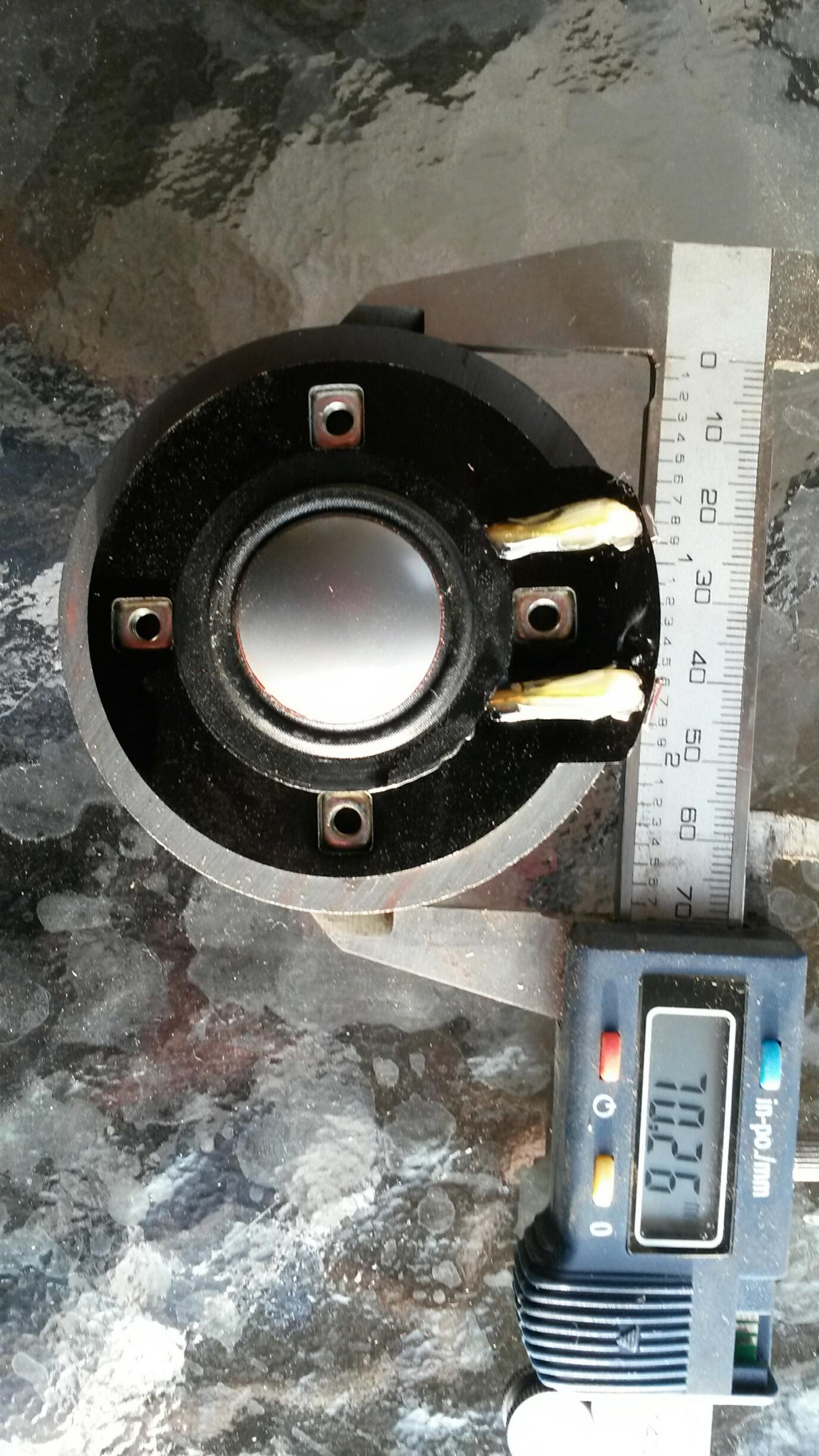

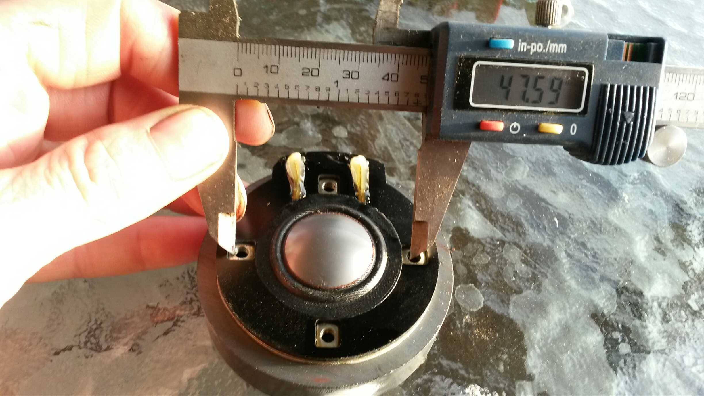

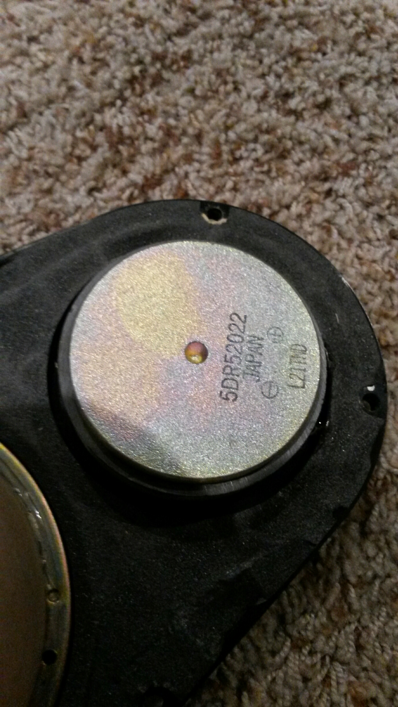

Had some time so went into this further.
Under the sticker is "5DR52022. L21TND" Made in Japan

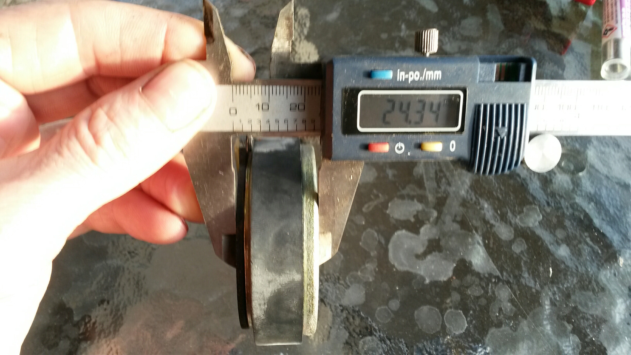

Approx 70 mm diameter, 24 mm thick, 47 mm bolt circle diameter, dome approx 26 mm.
Rechecked my ohms and still open. Leads off terminal connection to voice coil look intact.
Mid range is 4.0 ohm, just for posterity.
The other tweeter is failed so haven't attempted an ohm check on it. What ever I do to one I will do with the other.
Any thoughts on what might be a suitable replacement would be appreciated. Sending out for evaluation / possible repair or have someone look at it more closely to provide a good alternative replacement is what would make me most comfortable.

Thanks for the pics Ken!
If mine ( & I was wanting to save the speakers ) I would ditch the plastic ( tear-drop shaped ) insert and build a new one made from 5/16" multiply baltic-birch plywood .
- Making a new insert ( with the correct sized holes for a new tweeter ) will be infinitely simpler than trying to fit a new tweeter to the cut-out in that plastic insert .
The advantage you have here ( for retrofitting any new tweeter ) is the existing large cutout within the cabinet ( behind the plastic insert ) needing an insert to fill the hole in.
That large space allows you to choose from a pretty wide assortment of aluminum domed tweeters ( that will undoubtedly need a custom fit into a non-existent baffle ).
