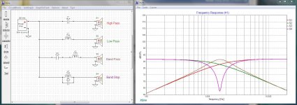

I'm adding a DXO file for XSim that will let you easily explore the fundimental types. Most crossovers are simply combinations of these filters. You can selectively enable one filter at a time, mess with the parts values and see what they do.

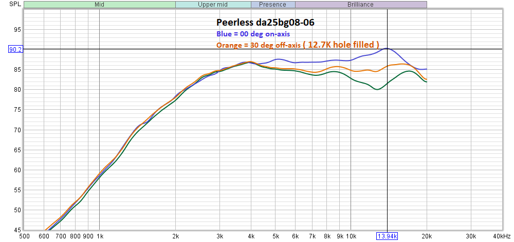

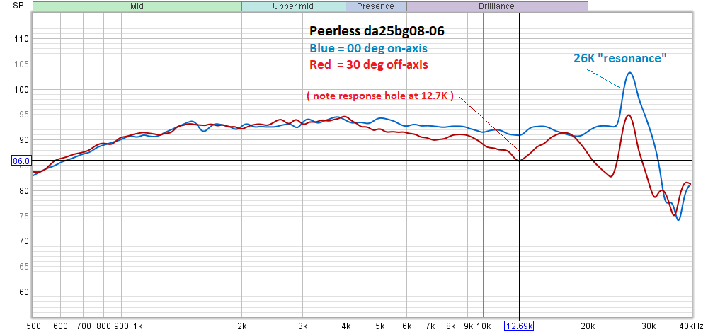

A working example ( of when to possibly use the ByPass circuit ).
Here are the 00-degree and 30deg off-axis traces ( raw response ) for the ( inexpensive ) Peerless tweeter.
Now here's an HiPass example of the LCR bypass in use.
The LCR in the HF bypass has been modified to specifically fill the 12.7K hole ( this treatment also gives a rising response on axis as seen in the blue trace above the orange ).
Neither the SB Acoustics tweeter or the SEAS 27TBFC ( recommended by Chris ) benefit by the inclusion of this circuit.
