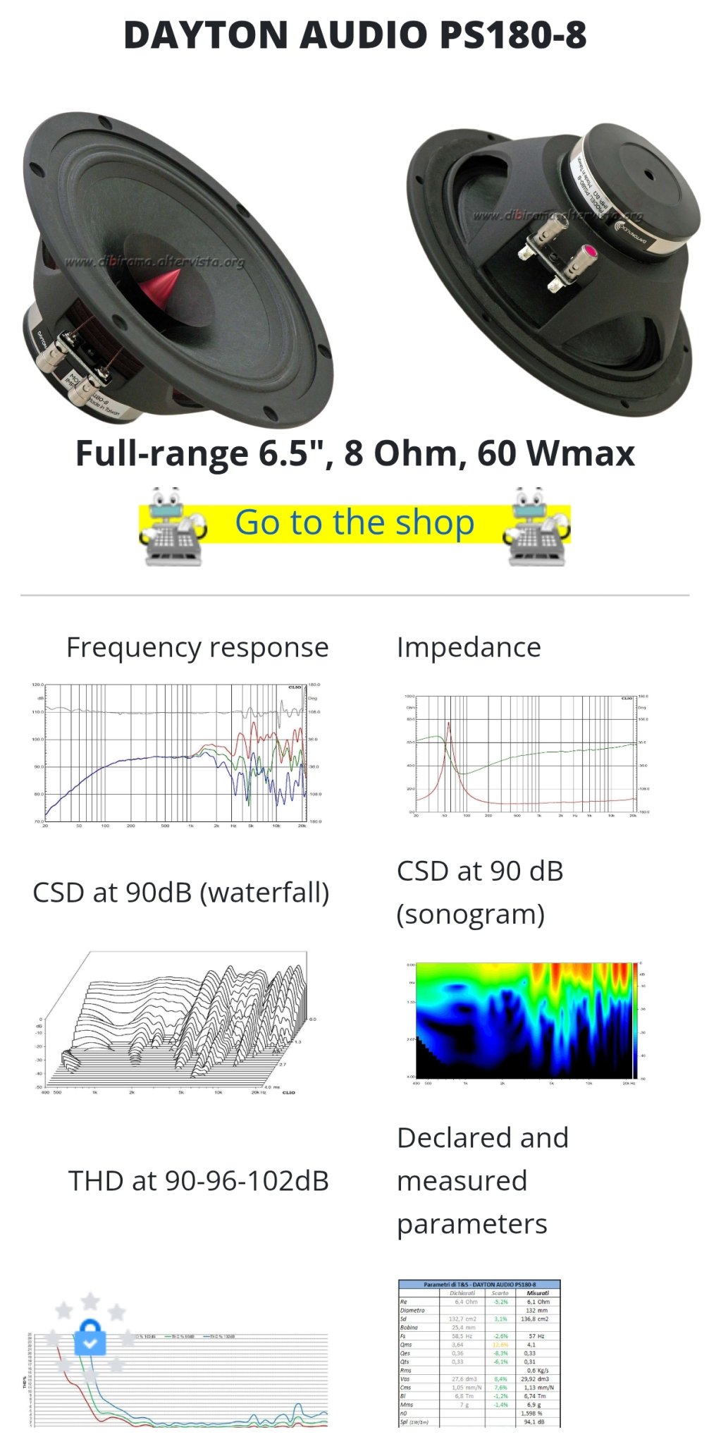

@Arez I've spent some more time on the that great Italian website. The data from the Dayton ps180 looks very nice. It doesn't have enough power but it rekindled my interest in the larger ps220

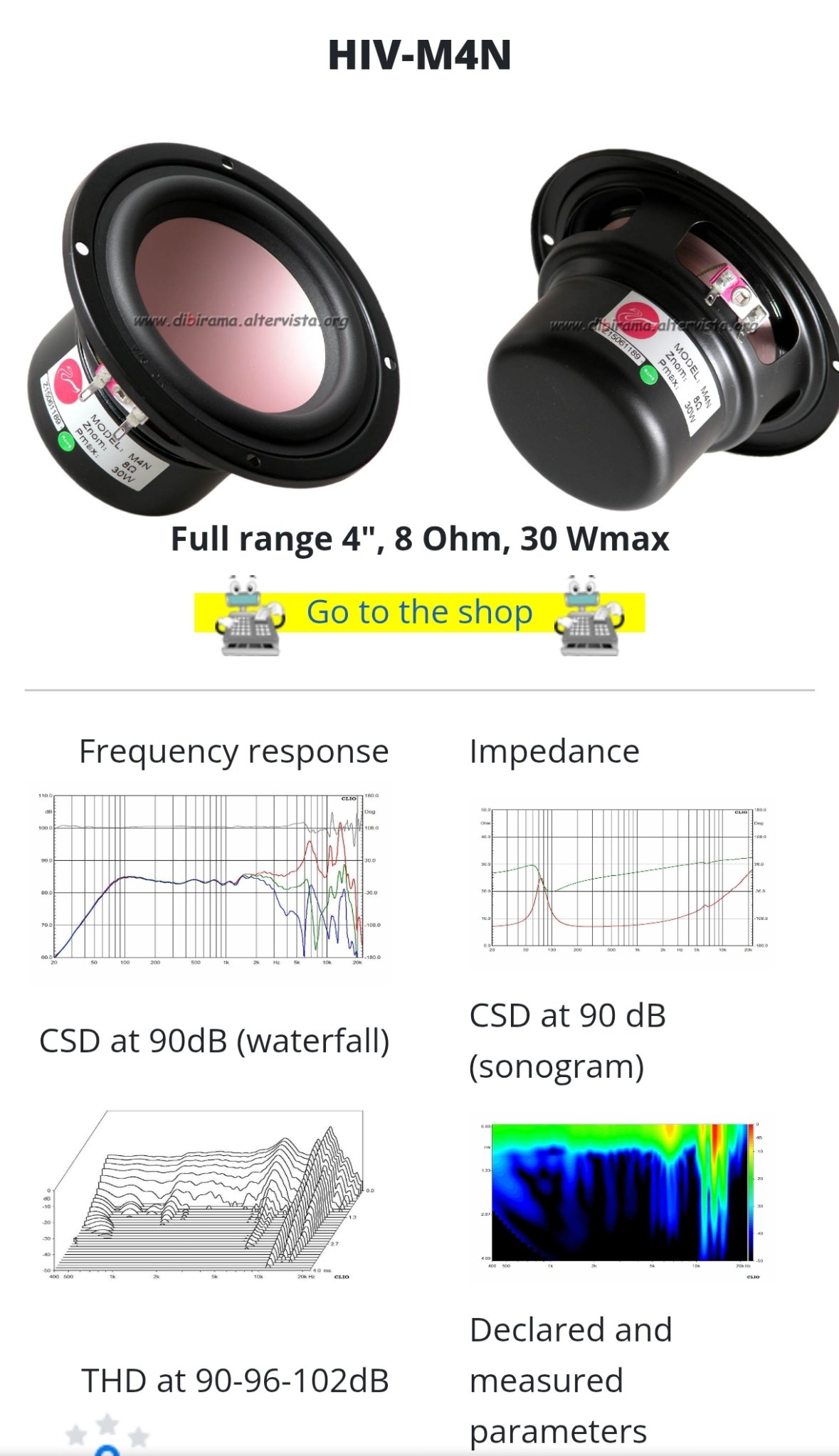

Also the Hivi M4N looks amazing. It is too insensitive and doesn't handle enough power but I may check out the M6N. That one may still not handle enough power and is less sensitive than I would like......but the hivi driver looks sooooooo damn clean! And cheap and readily available where I am.

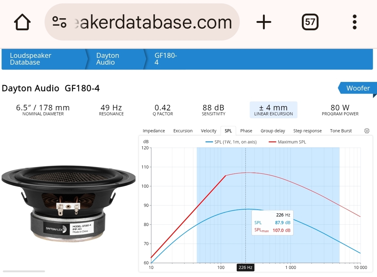

Had a deeper look at the hivi unit. I found a Dayton with reasonably close T/S parameters in loudspeakerdatabase and power handling looks poor, especially in the higher frequencies.
So the Hivi M6N is out. Still a great driver for lower spl scenarios. For it's price it looks stupendously good. I would definitely use them for some bookshelf speakers.

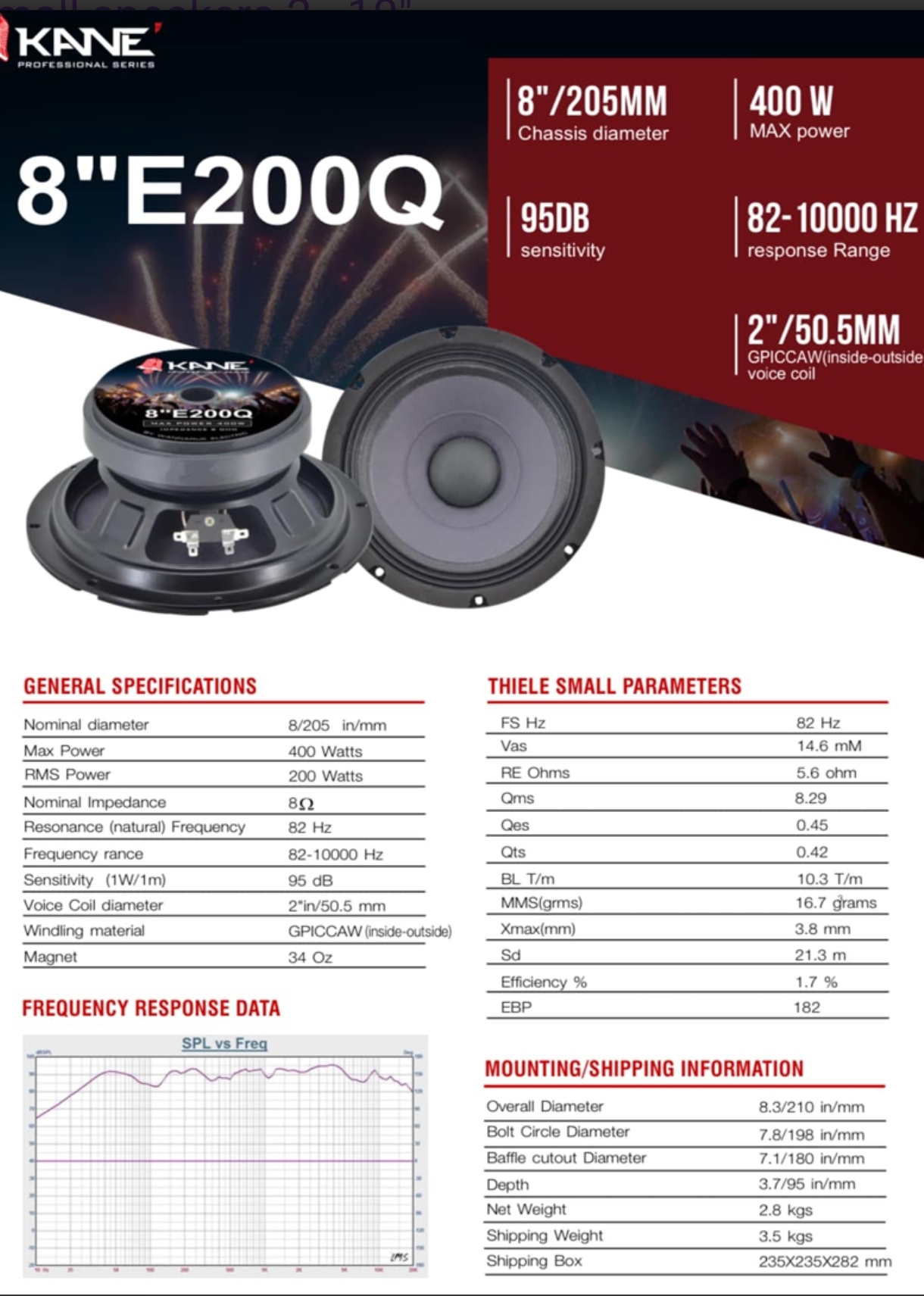

I found this driver from a major local PA speaker company. It is almost identical in T/S parameters to the Beyma 8MI100.looks like a nice setup - i think the 18sound could be swapped by a more midrange-oriented speaker
Except for the lowly pump frame it looks very nice. Is this midrangy enough?
I like the goldilocks T/S parameters. Decent xmax combined with good extension and modestly high QMS for lively sound but not super high as many shouty full rangers. And at 23USD the price is goldilocks too. I even dig the cone colour.
I ordered one sample so I can measure how it does on distortion and off axis behavior. I don't know if it has anything like demodulation rings. Hell, I don't even know if those are a must have for high fidelity. Even the Beyma 8MI100 documentation doesn't mention demodulation rings. I guess if they sound good it's all good.
If the response is really as extended as the graph promises I could probably reduce my 4 way to a 3 way.
+2400hz ESS Heil with foam inserts to improve vertical dispersion
300-2400hz 8" Kane e200q (similar to Beyma MI100)
