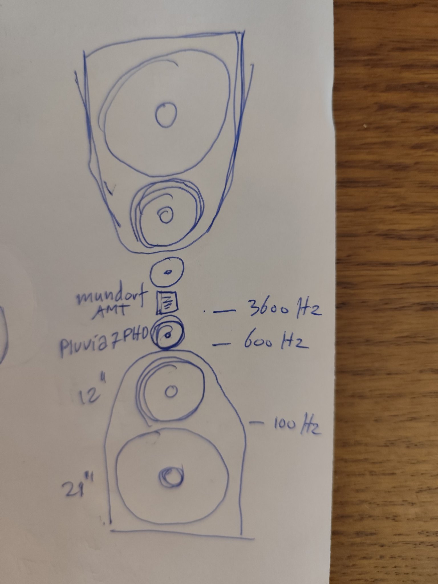

This is nearly impossible.I only want to use first order crossovers. So each driver has to overlap at the top and bottom the next driver for at least 2 octaves flat.

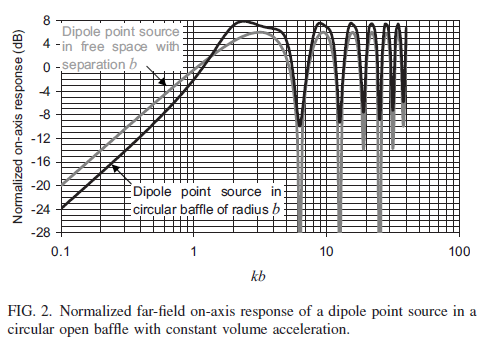

As driver response in OB is narrow then overlapping at least in bass and midrange is not possible.
https://www.linkwitzlab.com/images/graphics/Point_dipole_on_baffle.png

I only want to use first order crossovers. So each driver has to overlap at the top and bottom the next driver for at least 2 octaves flat. I know you can cross the Heils at 1 or 2khz but not with a first order crossover at 110db
I wonder what is a safe 1st order crossover point for the Heil tweeter? 3khz? 4Khz? Couldn't find any info on this.
I’d have those playing only to 80hz with an XO point around 100hz…..first order as you indicate…..if you choose 21” you’re going to run into listening axis height issues once you get to a tweeter or MTM section with 1st order filters…..
Next up would be your midbass driver……..1st order to midranges…….12” driver is about as large as you can go without a directivity issue
Oh…and with 1st order filters forget the WMTMW arrangement…..the center to center distances are just too far to pull this off. 12-15” midbass……6” class midrange and then your Heil crossed up around 4K…….with a 1st order high pass, the Heil just might be able to pull that off.

I was thinking exactly the same to get acceptable MTM spacing.i use this :
3000 and up Mundorf 17D2.2 - no baffle
Maybe flanked by 2 Pluvia 7 PHD drivers? Crossed at 3.5Khz or 4khz?
Center to center spacing can be close to 12 cm.
I would love to hear those. Usually very expensive speakers don't do much for me and I hardly ever think "if I were rich I would buy them"........but I could see these in my mansion 😊Also interesting to look into is Steinway Lyngdorf model B. They use six 12" woofers per side with 5" mid and AMT. Great bass.
Something like this..,..
The MTM section is around 88dB 1w/1m sensitive, the rest well over 100dB. So I guess this would only work with active crossovers.
Bummer, I just see in the Mundorf datasheet that they advise a 5k crossover for first order. But kudos for Mundorf to indicate a 1st order crossover. I cannot remember another datasheet that does. Usually I only see 2nd or maybe 3rd order crossover frequency indicated.
