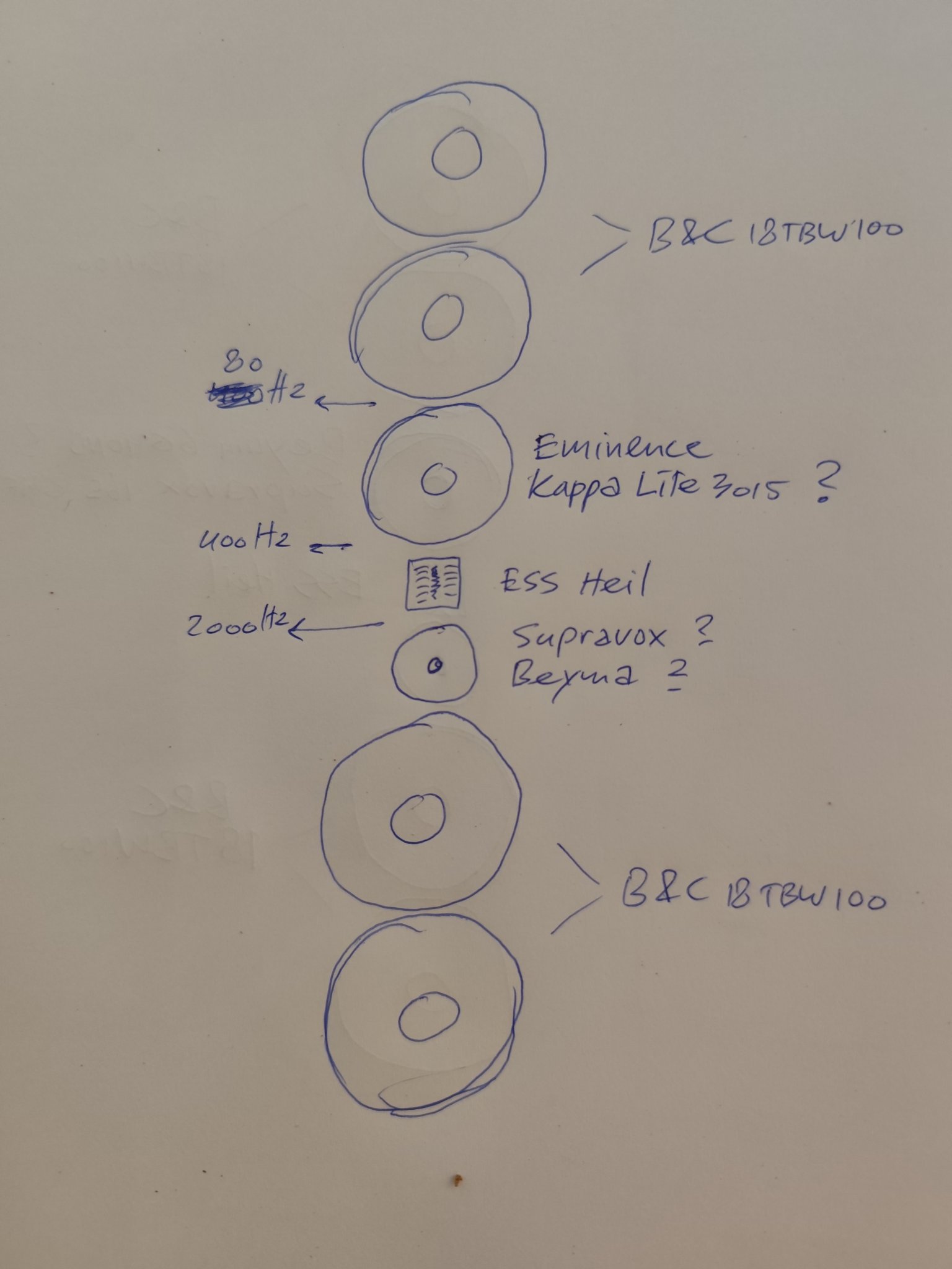

So this is where I am at now:

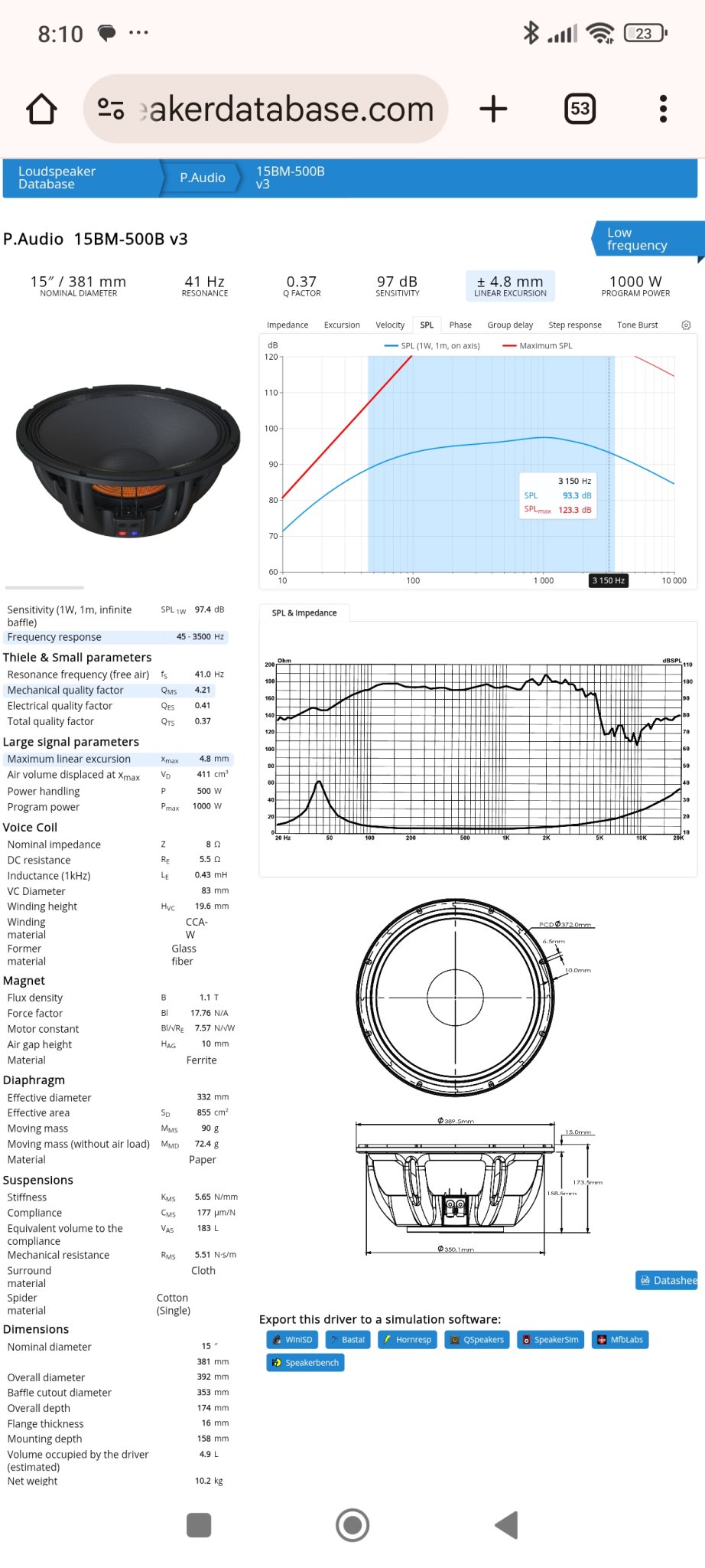

For comparison, my woofers have roughly 15mm xmax and Fs of around 20 Hz... a pair could move same amount of air.. but at a much higher price of course...
This p audio is not my subwoofer but my midwoofer (80-400hz). Below this I will play 4x b&c 18tbw100 with 14mm xmax. They move almost 5x more air than one 15" with 15mm xmax.For comparison, my woofers have roughly 15mm xmax and Fs of around 20 Hz... a pair could move same amount of air.. but at a much higher price of course...
My woofers only have an fs of 37hz but DSP can fix that. I can locally get these drivers (rebadged) for around 100 USD.
I am sure there are better woofers out there but those would be many many times more costly. Especially with shipping costs and import taxes added.
i like your setup for the B&C woofers and the tweeter
the 2 in between are perhaps oke, i miss there the reasoning
the size fits with the search for loudness
for the midrange dispersion is still important in combination with your 1st order filtering - these goals are in contrast with your goal of loudness
the first goals tell me to go about 4.5-5.5 inch your loudness goals tells us go bigger
the higher you can cross the the bigger woofer, the smaller you can go with the midrange - can you bring the crossoverpoint from 400 to 800 or even 1000 hz?

The Beyma seems to go plenty loud and seems great off axis. I feel it is a good compromise. I could always raise the crossover a little to 500 or 600hz. I even thought about making the speaker a 4.5 way by using two midranges and parallel one with a capacitor to only let it play below 900hz or so.i like your setup for the B&C woofers and the tweeter

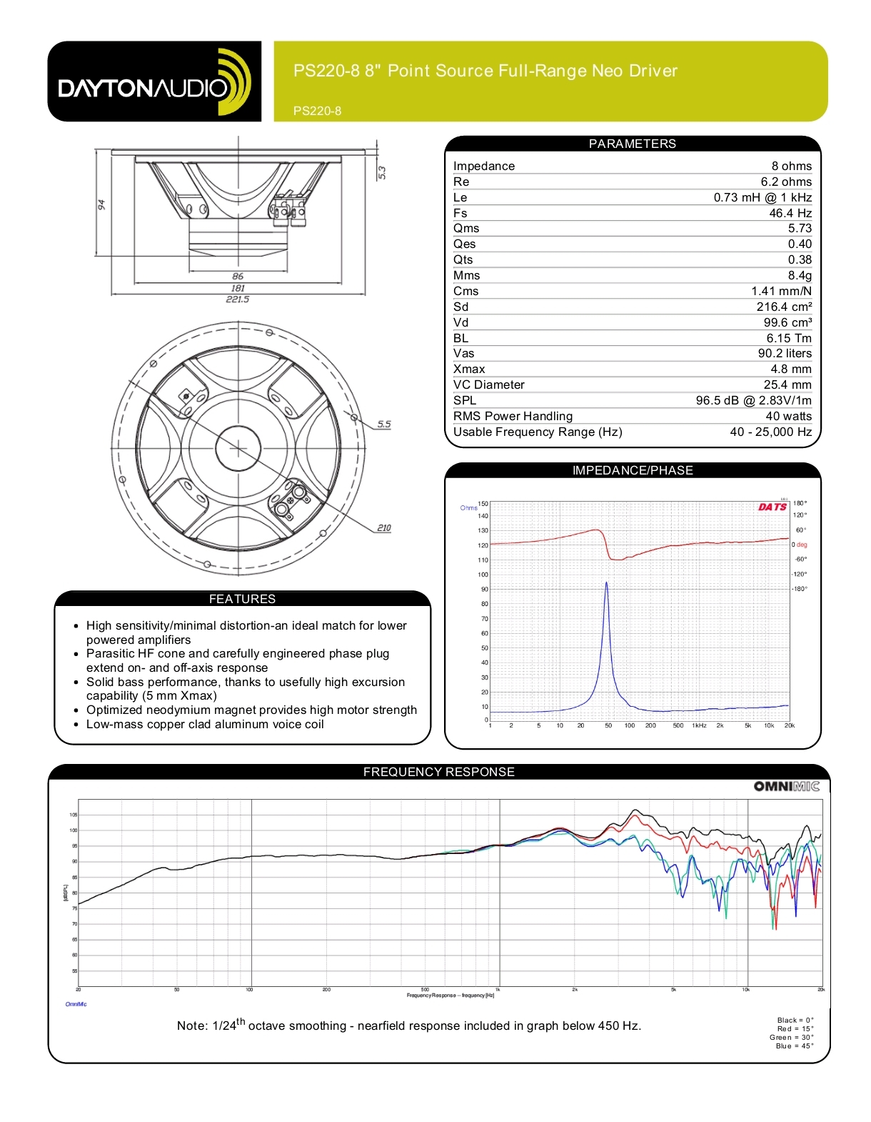

The Dayton point source looks very nice. Even the 8" version doesn't beam early. I could even see crossing it to the tweeter a little higher....maybe 2500 Hz?
Reviews on this unit are very positive and it is quite affordable. The T/S parameters seem very goldilocks to me.
Does anybody here own these or even better measured them? I would love some opinions on this unit. How do they hold up at higher volumes?

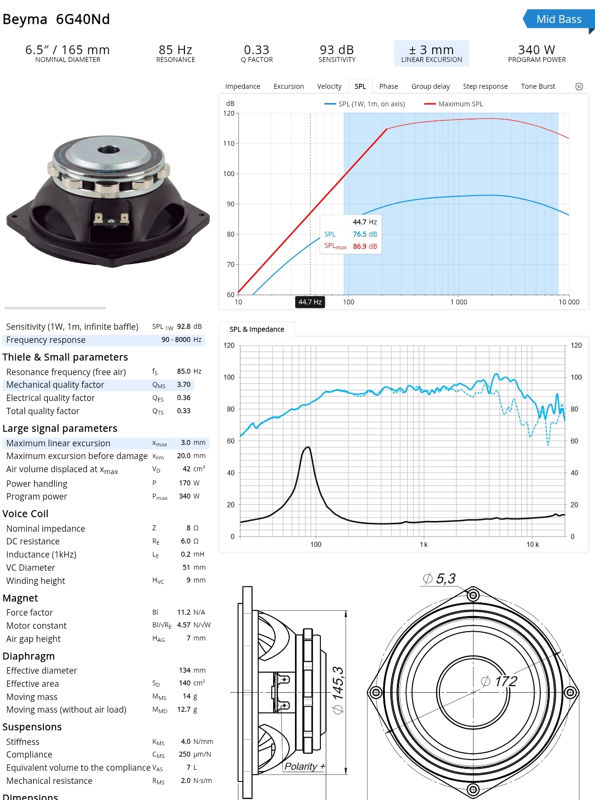

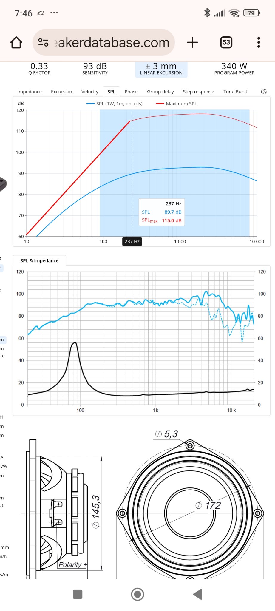

Better take PHL 1130, it was compared with beyma 5g40nd and PHL turned out to be better.The Beyma 6G40ND still looks the best for 400-2000k with 1st order slopes. The dotted line is 30deg off axis.

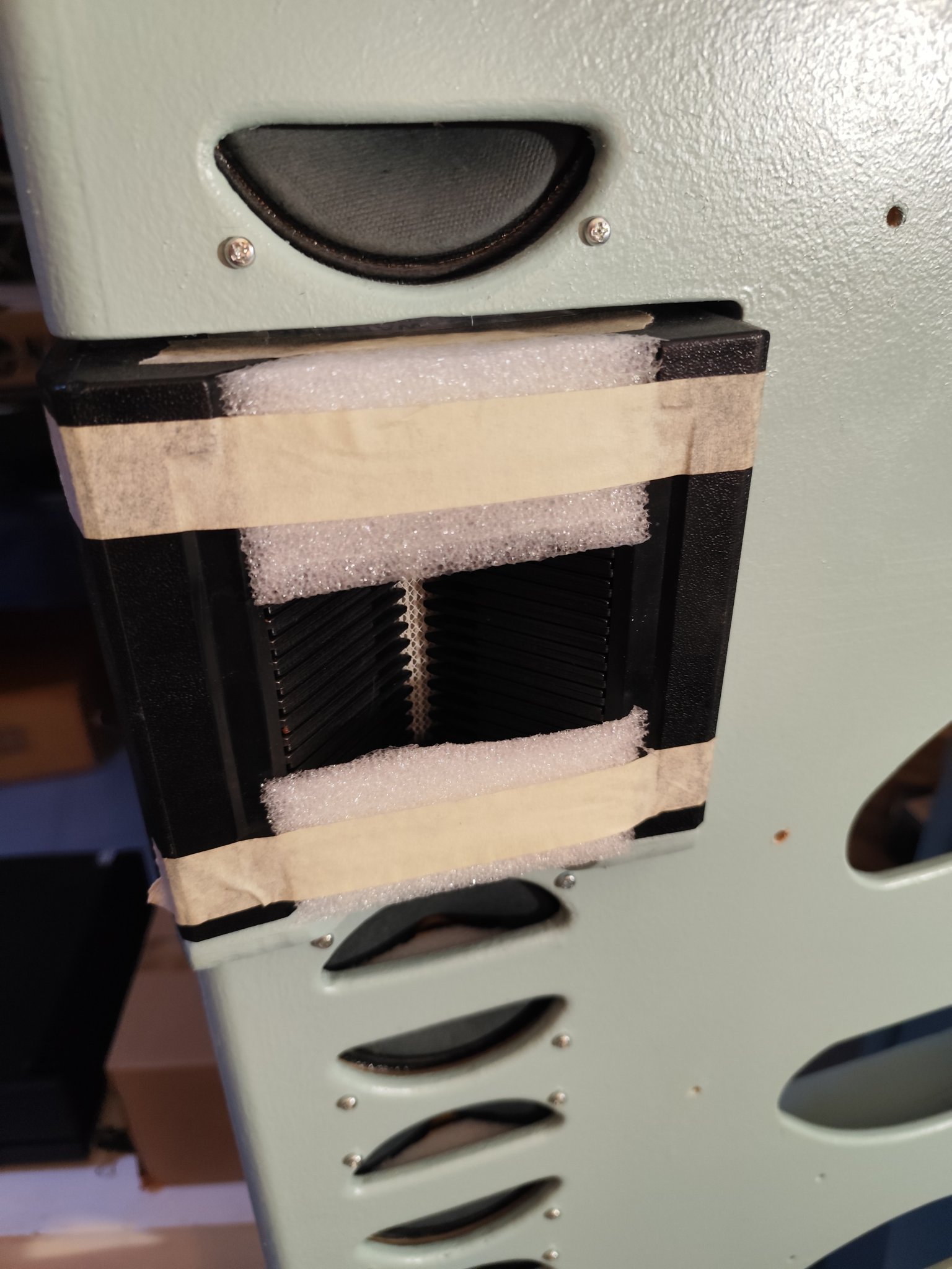

I have made some foam inserts to increase vertical dispersion of the Heils. By the way I am 200cm tall 😂looks like your listening axis will be around 130cm from the floor.......if that's ok?.......my seated listening axis is around 100cm and i'm 175cm tall. Remember your AMT has pretty awful vertical directivity so you really don't have much of a window. This thing is set to be around 250cm overall height........that means a 3m ceiling at least.

The 1130 is 16 ohm. The 1120 looks similar but 8ohm. I don't think this driver can go low enough to handle a 1st order crossover at 400 or 500hz. It only has 2mm xmax.Better take PHL 1130, it was compared with beyma 5g40nd and PHL turned out to be better.
I don't think a 6.5 beyma speaker would be better. So if you can buy it:
Still looking at the Beyma, the Supravox and the Dayton point source for midrange.

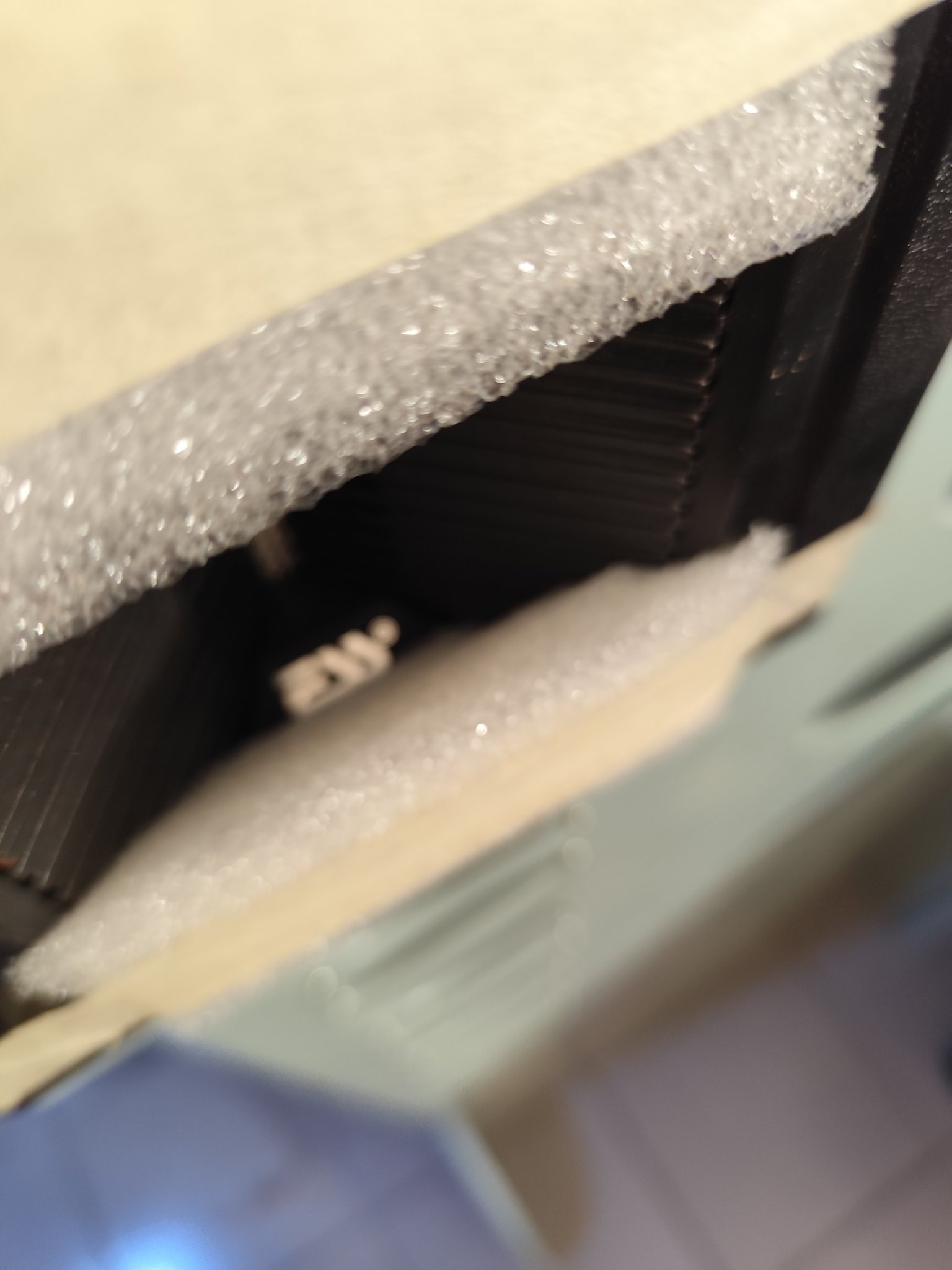

If I end up using inserts I need to find me some black foam.
Using a monopole compression driver in an OB has gotta sound unbalanced.......i suppose you plan on a separate rr firing unit if you go that route?I have made some foam inserts to increase vertical dispersion of the Heils. By the way I am 200cm tall 😂

The thin sound from the Heil is the rising response........shape it to flat and it sounds as good as any CD. ........but given the height of this thing and your seated height, i don't think the Heil is the best option.
So 1-2 mm is a normal course of midrange speakers, and if xmax is more, it is already midbass.

I plan on extensively trying the Heil, one CD and back to back CD'si suppose you plan on a separate rr firing unit if you go that route?
Depends on the listening distance as well. It is for a very large space. Also the inserts really work. I didn't measure it yet but with white noise it sounds more even when moving off axis vertically.but given the height of this thing and your seated height, i don't think the Heil is the best option.
I was very surprised when my p audio 15BM500 bass drivers were delivered in less than a day. Listened to them for 20 min and am very impressed. Very clean, extended and authoritive. Warm sound without muddiness. For only 60$ a piece they are incredible value. Workmanship looks flawless.I just ordered the 15" bass drivers but still haven't decided on the midrange.

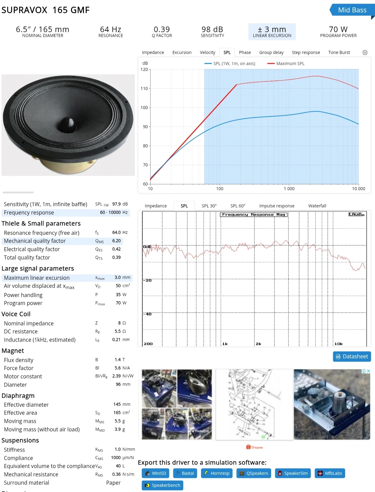

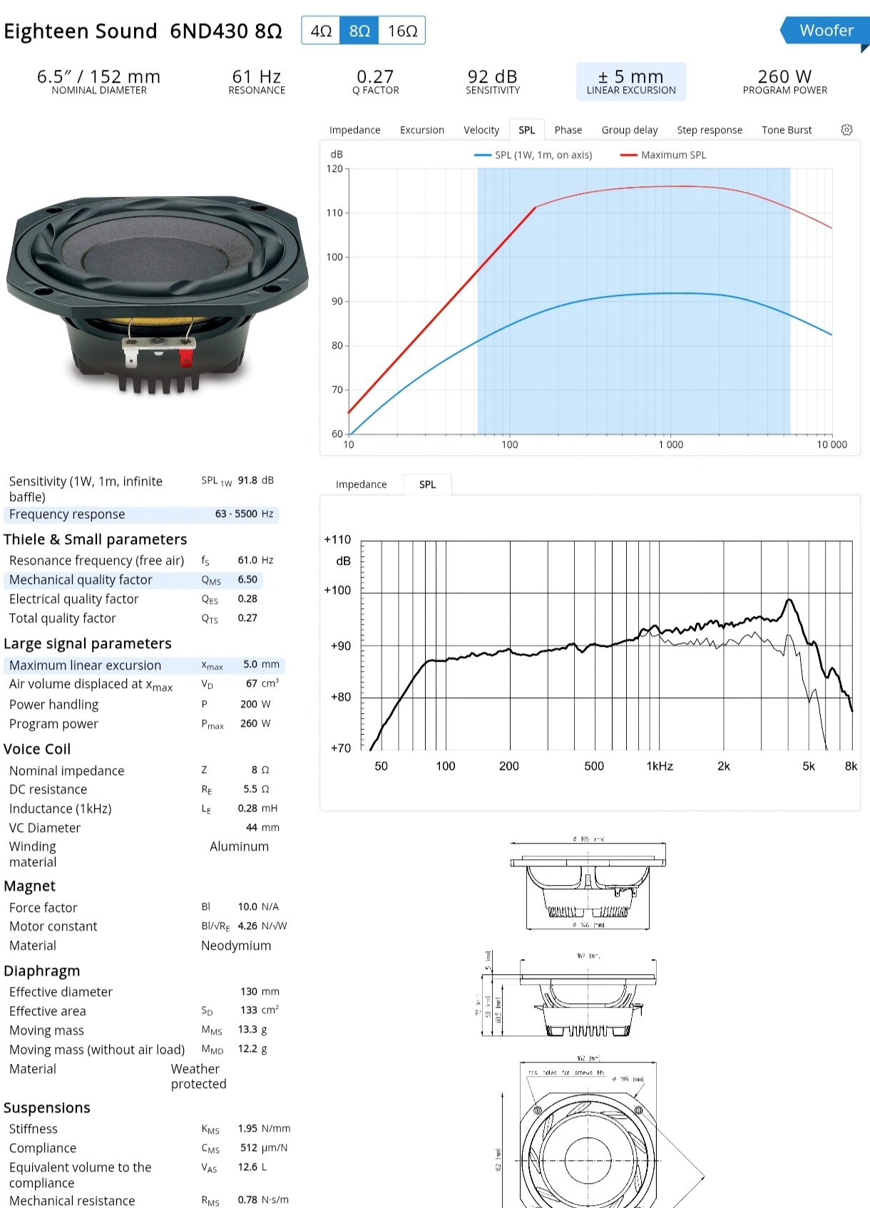

So my driver choice is all set except for the midrange. I spent a few more hours sifting through spec sheets and reading reviews and have 3 final candidates.These three seem to have the best blend of efficiency and power handling over an extended range.
For the Supravox I really wonder what it sacrifices to reach 98db sensitivity?
