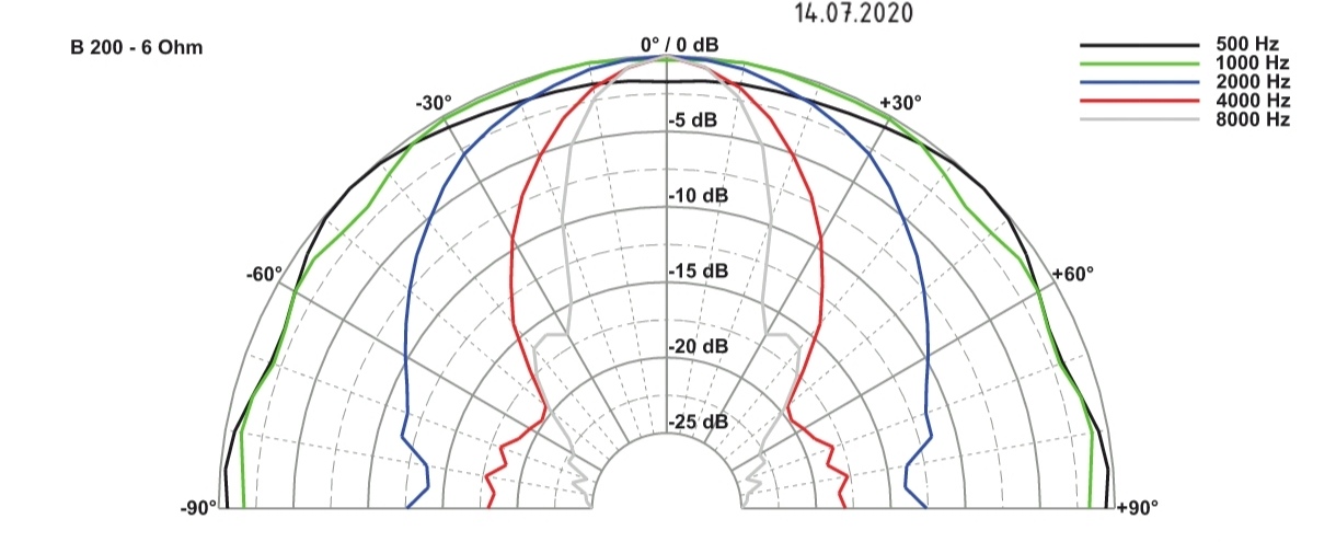

You could also consider 8" for mid? Probably better in case high volume is required. Easier to cross with 15" and could still mate with Ess.
Not sure I understand. Skip a driver and make it 3 way?18sound 6nd410 is a high sensitive midrange
you can't have it all, skip the 100hz

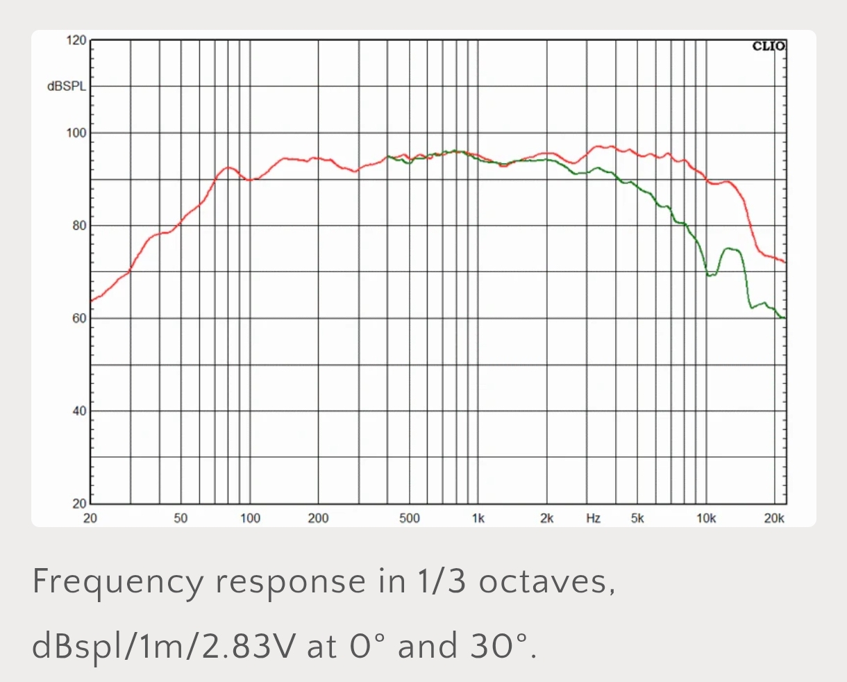

I am very interested in that driver but for this application it is too big. At 4khz it is already down 20db @30 degrees off axis. It would Crete a big hole in my directivity plot.You could also consider 8" for mid? Probably better in case high volume is required. Easier to cross with 15" and could still mate with Ess.

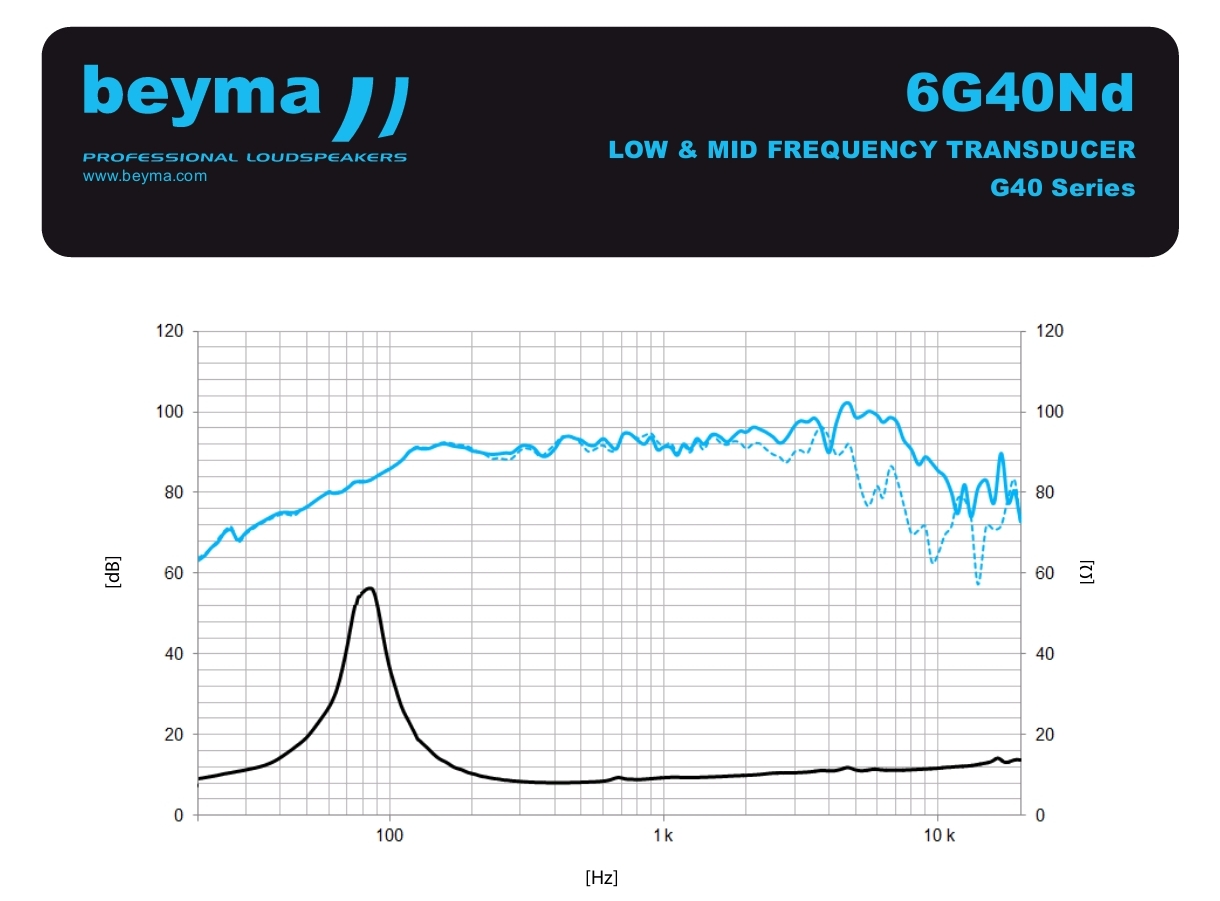

The Beyma 6G40ND still looks the best for 400-2000k with 1st order slopes. The dotted line is 30deg off axis.
On paper the Beyma looks perfect. Now the only question is if it sounds good. If I believed measurements say everything this is the one.
I don't think it would run out of steam either crossing at 400hz. It can still produce 113db @ 200hz
Are there more driver suggestions? This is arguably a crucial driver covering most of the telephone band frequencies so it can make or break the speakers.
