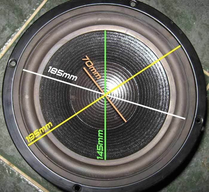

Here is the a photo of the drivers I want to do first
I took some meausrements as references, as I am not sure where the ring of dots will go, considering all that rubber.
Any help?
Also where can I get a scaleable template that I can use?
As you can see the cone is paper, coated in something like vinyl on the face side, it is very stiff

Can you ask Mongo to explain how to calculate this useing the sizes I provided, if you are too busy?
Your not missing 2 degrees, just haveing visualisation problems, rember each 2 dots is in an alternate ring
Mongo, this is EnABL. I would like to enable Mongo
To do so would require special Ed. Remember, his fingers are like clubs...so I got the calculator out anyway.
to wit: 145 mm diameter, circumference=pi (dia.) = ~ 455 mm
1/36 circumference = ~ 12.65 mm = ~ 10 degrees
watch the decimal equivalent here:
2 degree scalar equivalent is 12.65 (.2) = ~ 2.5 mm spaces
4 degree scalar equivalent is 12.65 (.4) = ~5 mm blocks

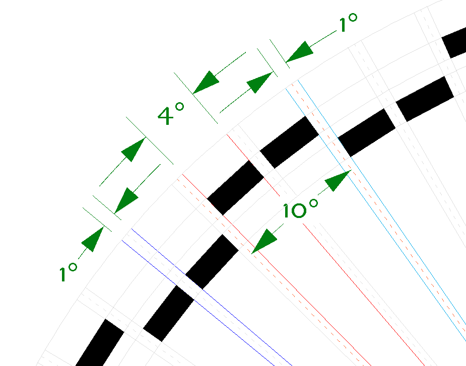

Re: Mongo, this is EnABL. I would like to enable Mongo
Here is a diagram of the angular spacing. Block height is specified as "2 degrees"
Lots of room for slop... actually one could theorize that a "perfect" pattern might not work as well as a more chaotic one.

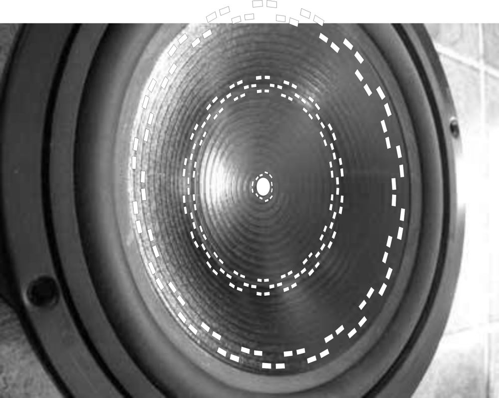

Nordic,
Here is how you want your patterns to appear on the cones.
The outer rings are about 2 degrees from the edge of the surround to cone glue joint.
Note that the dome to cone pattern is only three rings and that the center ring is right on top of the joint between cone and dome.
The little six ring set at the tip of the dome is there to suppress beaming, not damp it, just redistribute the energy across the cone surface. Net effect will be to increase dispersion.
I can scale and combine a flat pattern array onto the face on picture, if these do not provide you with enough information to work from.
Bud

Hi All
Well, if you look closely at Dave's drawing, there are openings between ends of blocks in a set, in adjacent rows. This could confuse the issue, if you are trying to make those extra spaces add up to a 10 degree interval, with each set of blocks worth 4 degrees and each space worth 2 degrees. Here is the flat template I use, dimensioned for this portrayal, to scale and cut from, though it is done in Corel Draw and printed, rather than Adobe PDF.
Again this is one of those mathematically induced paranoia items. The patterns themselves will be somewhere between what Dave is showing and what I am showing and will work just fine regardless of how many hairs are split with these various layout templates.
Bud

Guess i need to rev my templates
I don't think so. Yours are actually more likely to allow a correct, finished on cone pattern, than mine are. We want the adjacent row ends to line up, but not overlap, if possible. A small overlap is not a problem, but your patterns do allow for paint spread and so, less overlap than mine.
I put the patterns up just to clear up the confusion about arc distances adding up properly. What you are doing is fine, mostly because it works and probably better than what I use, in the hands of someone new to this.
Your patterns do show why you end up with a pattern that is slightly tighter in inter block and inter ring spacing than mine typically are. Since your center area is smaller, it appears you may be using this as the key to the spacing of the rings and this is what pulls your rings slightly closer together. However, this is not a problem, obviously, since your cones work just fine.

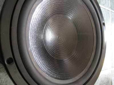

Bud, about those middle rings... the concave shape goes on there instead of the normal convex dustcap....
Also it stiff and like one piece with the rest of the cone, the connection with the spider is little over an inch in diameter... but is connected to the back of the rigid dustcap/cone assembly...
These drivers are cleverly designed I think, very nice range of 30Hz to 3KHz, downside isI am useing them in a 2way system, which asks alot from the tweeter I guess. I intend putting them in more appropriate boxes and cross over at about 2k2.
There is a range in some female vocals that just sounds wrong still (to my ear), but I lack the term to describe the phenomena... its like a distortion over sounds in that frequency band, which does not seem to effect the rest of the frequencies...
