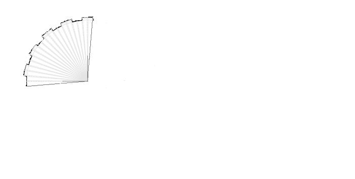

Had some issues with drawing them first, was moveing the pen hand... and at the end of the stroke I would lift it and it would leave a little upward stroke like a check..
So, I started rotateing the paper... it will probably be harder to rotate the driver... unless I had some jig... heh turntable... with pivoting arm..?
It was resonable easy to mark of 5 degree marks on the driver, my wife has these metalicy gel pens, that are easy to clean away useing some spit and your finger after playing around to get an idea of scales.... fill 4 fifths, leave one, leave one fill four fifths, move to next ring and repeat...

Nordic,
The pattern of hand and pen activity I use is this.
Rotate the cone, so that your fingers have to extend a bit to reach the correct start point. With my little finger actually touching the surface of the cone or the basket ledge, as a pivot point. I touch pen tip to paper and then I pull my fingers in toward the stroke direction and roll my wrist a few degrees, using the little finger as a pivot point and allowing the pen tip to stay on the paper by moving my fingers slightly side ways. By the end of the stroke this wrist roll is what picks the pen point up.
I do not rotate the driver to control the stroke length as this is not precise enough. Your fingers and wrist should be all that you use for a stroke as they are designed for finely scaled movements. You just may not be used to this sort of movement with them, and just need to practice straight lines first.
Bud
