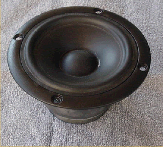

When I get a chance I'll past pictures of a couple of drivers I'm considering for treatment. One is a Vifa/JBL 4" treated paper mid-woofer that was on clearance sale at Patrs Express a year or so ago. The response plot looks as though it might have a few problems with breakup at the upper end of its range. The other is the Tang Band W4-654SE, ane of the less expensive full-rangers, with paper cone and an aluminum phase plug.

I remember Vifa BC11SG06-12 being among the PE buyouts. I'm interested in a pattern for them as well. As they are an OEM and no longer available, the closest dimensional description I find on the web is at the bottom of this link:
http://www.tymphany.com/datasheet/printview.php?id=280
Wrench,
The response graph would be different. Does this fit the description of your drivers?
Wrench,
That sort of looks like the driver in question, though the numbers aren't anywhere close to the actual part number on the driver itself.

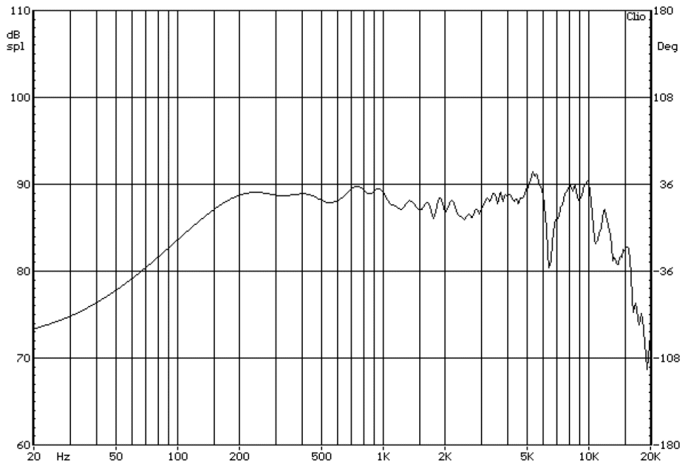

Parameters: 35WRMS Power Handling, Znom 4 ohms, Re 2.95 ohms, Fs 65 Hz, SPL 88dB/1W, Vas, 0.16 ft^3, Qms 1.44, Qes 0.34, Qts 0.27, Xmax 3.5 mm. Attached is the freqency response. Note the big notch and gereral midrange rastiness. I was thinking of using this in an MTM ported design with 0.5 cubic foot enclosure, but the low Vas makes the bass peak too pronounced, and I dont like the midrange rollercoaster. I have a 4" Tang Band full range with polypropylene cone in mind (W4-1052SD) that has a much smoother response and is also beter suited for the enclosure size. However, these guys may be useful for another project if I can smooth them out.
