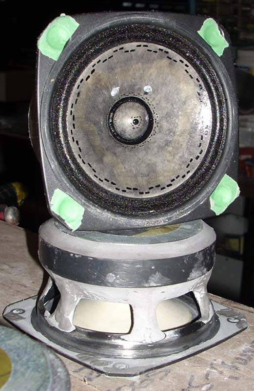

doorman said:
You guys are serious, En the baskets/magnet assembly makes a difference??
(not dissing it, just curious as hell!)
No idea if it makes a difference (these are waiting for me to search out and find my organ felt to damp the inside basket legs and i figured it wouldn't hurt to get a thousand+ hours on them until i did -- doesn't hurt to have a second set of Fonken kicking around) ... these drivers were more about the extreme basket tricks
http://www.diyaudio.com/forums/showthread.php?postid=1649080#post1649080
but when i got that done, i had a canvas that just screamed out for a bit more 🙂

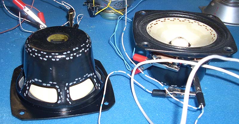

This is my personal pair so i said why not... i have a set of FE126 i'm taking to the same extreme for our A126... they are a bit more work.
When am i going to get yours (if you don't want to be out drivers, i have a set of 126 out of an Ed Horn you can borrow (or i can do up and we can swap)

Dave: I'm hoping to get down your way before Xmas, (I've got a pair of 108EZ's I canuse)
-also got a Jolida 603 cdp for you (limping, but not dead!)

Dave, rather than wait for felt, you can clumsily, at least in my experience, pattern the cone side of the basket for an equivalent effect.
