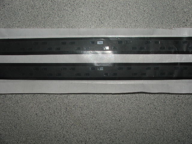

OK, so here's a pic of what the two strips look like.
- PVC duct tape on the bottom (black of course because I like a 'darker background' 😀 )
- Sellotape 'Invisible tape' (or Scotch 'Magic tape') on top
- Norton 'All Weather Tape' for the blocks
Ports are rectangular - 110mm x 50mm
Calculated block size for 10 block pairs is 6.4mm x 3.2mm - so I rounded down to 6mm x 3mm
I'll send these in the mail today.
Alex

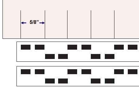

G'day voldigicam,
The .004" vinyl you have is fine to use.
What type of speakers do you have?
I assume you have round ports - are they flared or straight?
For a round port 4" diameter
Block size = 2/8" x 1/8"
Strip length = 12.6"
Start with a 13" strip, lay your blocks and then trim off the extra length when sticking the strip around the inside of the port.
Mark up a sheet of paper as a guide with marks every 5/8" to make sure the pattern stays consistent. (see pic)
Alex

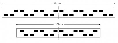

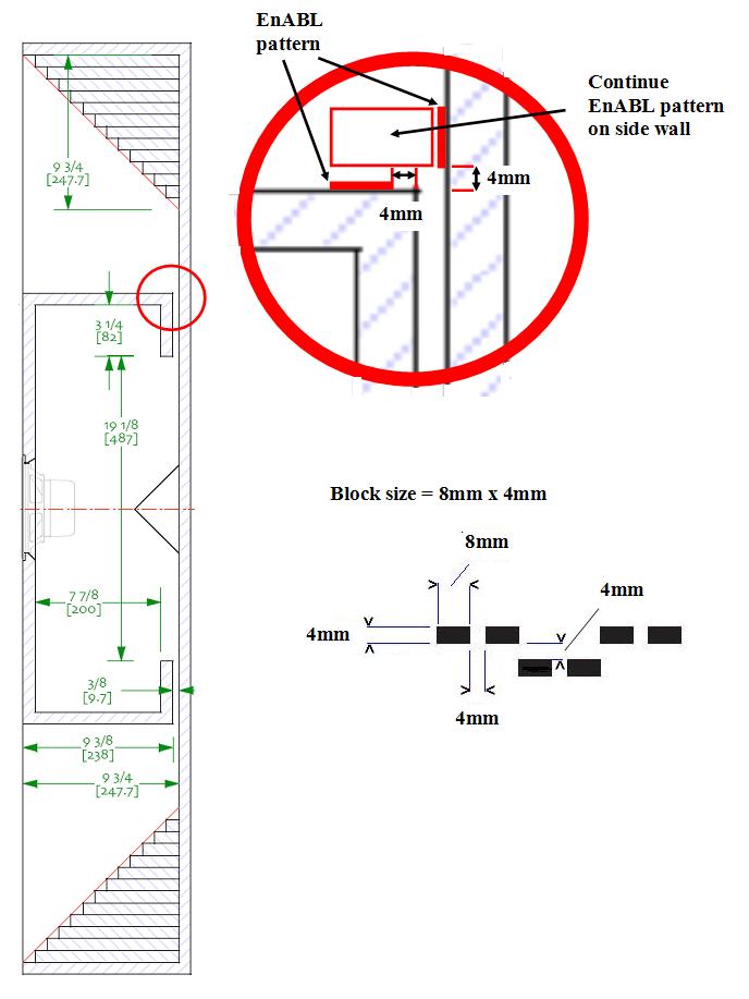

Cabinet EnABL - Chilli Chang
This is a reworking of a couple of posts I made in another thread in the Fullrange forum.
If you own a pair of Chilli Changs and have a genuine interest in exploring EnABL then perhaps you might like to try this.
Have a look at the pic below.
This is the first place I would start with cabinet EnABL for your speakers for three reasons:
1) requires a minimum number of blocks
2) should provide an audible change - which will encourage you to continue
3) it's completely reversable.
Obviously you need to repeat this top and bottom for both speakers.

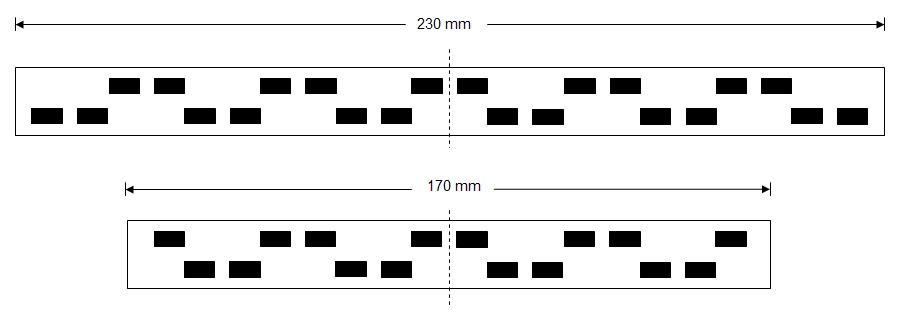

Chilli Chang cabinet EnABL - Pt 2
Parts List
1. Cutting mat
2. Blade
3. Ruler
4. 18mm Scotch 'Magic tape' or similar
5. PVC duct tape or Norton brand "All Weather Tape"
I prefer the "All Weather Tape" because it's clear and easier to cut, but PVC duct tape is also fine to use.
Lay the "All Weather Tape" sticky side down on the cutting mat and cut into rectangular blocks 8mm x 4mm.
Block size is calculated based on 18 block pairs using 4 x internal width of the mouth as the circumference.
See the EnABL block size calculator.
Once you have your blocks cut, lay a strip of Scotch 'magic tape' sticky side down on the cutting mat and then lay the blocks on top.
Look at the attached pic.
The dotted line is the middle of the strip.
The longer strip is for the back wall and the shorter one for the horizontal part.
You will need to make up four (4) of each strip to do both speakers - which equates to 152 blocks in total.
Once the strips are made, simply peel them up and stick them in place.
So long as the edge of the blocks is positioned as shown in my earlier post it will work as intended.
Try doing one speaker first, then listen to them in stereo.
Usually they will sound strangely unbalanced.
Listen with your ear close to the driver of the treated speaker and then compare with the untreated speaker - can you hear a difference?
Then do the other side and enjoy.
If there is any interest, I'll describe how to EnABL the baffle and mouths.
Alex

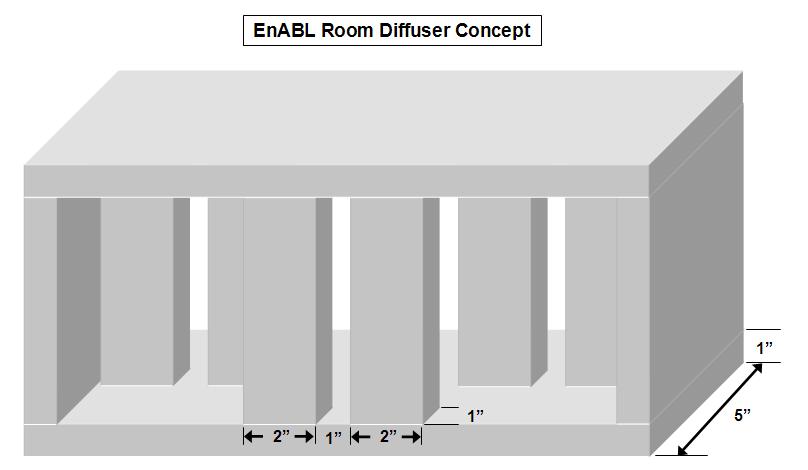

EnABL Room Diffuser Concept
G'day,
Too many ideas not enough time!
In a post a while back I mentioned that I had some ideas for EnABL room diffusers.
I have not built these but I wanted to share them with you all anyway.
The idea is really an extension of Bud's wave tank description here.
My assumption is that the range of frequencies generated in the wave tank would probably be roughly the same as the problematic ones in room ie. low frequencies.
Since EnABL blocks dealt effectively with low frequencies in the water tank, I reasoned that this could also be effective in room.
Bass trap perhaps?
See the pic below.
- Height is not specified.
In the wave tank test, a 1/2" high block pattern was effective for a 8 inch by 4 foot fish tank filled 6" deep with water.
How do we apply this in a room filled with air? Who knows.
- The 2" space behind the second row of blocks is to allow room for absorbant material to be added as/if required.
Maybe someone has some time and material to try this and give some feedback.
Alex

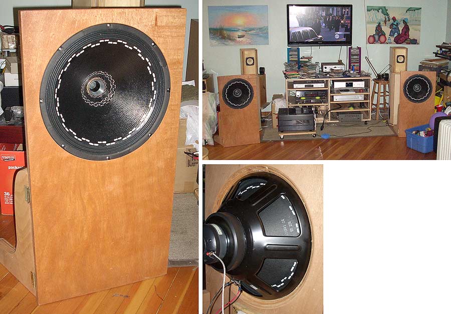

These ones were a pain to do, but on 1st listen, it seems worth it (maybe not if someone has to pay me to do anymore, but i'd encourge end-users to do theirs)
I'm going to do a separate thread on these, as there are other comments & potential mods that can further improve these.
Anywhere here is picture (Hawthorne Silver Iris 15" Coaxial open baffles)
dave
