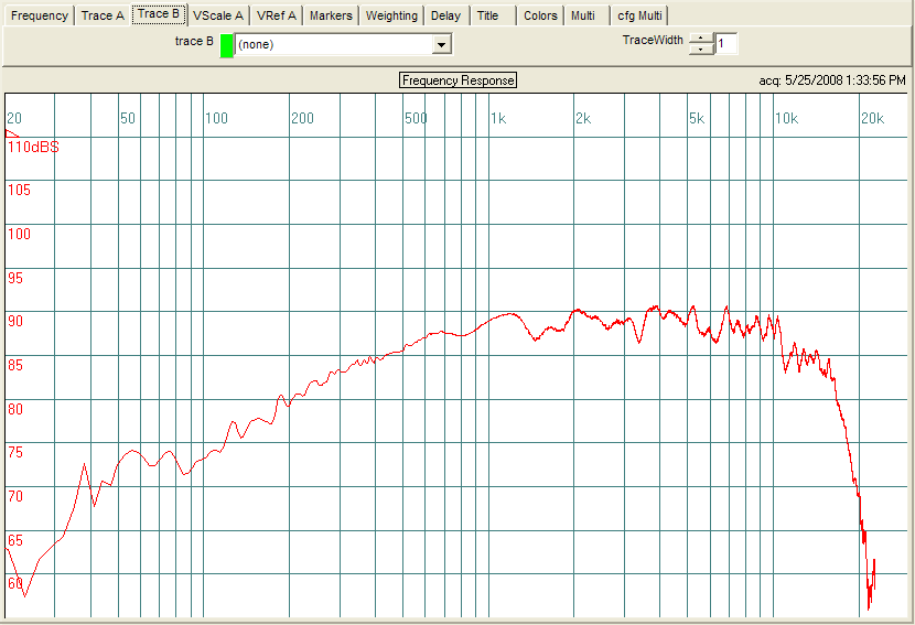

Hi Bud and Dave,
Thanks for the great directions - I did everything but practice. The B200s came out good! only a couple block pairs morphed into one, but otherwise it looks great. Those inside rings are TINY! I had to play a lot with printing rings to get just the right sizes, but eventually I got it - for the outer rings, I printed a ring that was just smaller than what I wanted to paint, and then just traced around the outside of it. Actually went quite quickly.
And thanks to Ed for the kit, its perfect!
This weekend, I'm going to measure the modified and unmodified drivers (a friend has a nice Praxis setup). I'll write it up later, but the modified drivers have Dave's phase plugs and were enabl'd according to his recommendations above. I hope to do 0-15-30-45 degree FR and 2-3-4-5 harmonic distortion measurement. Should be fun!

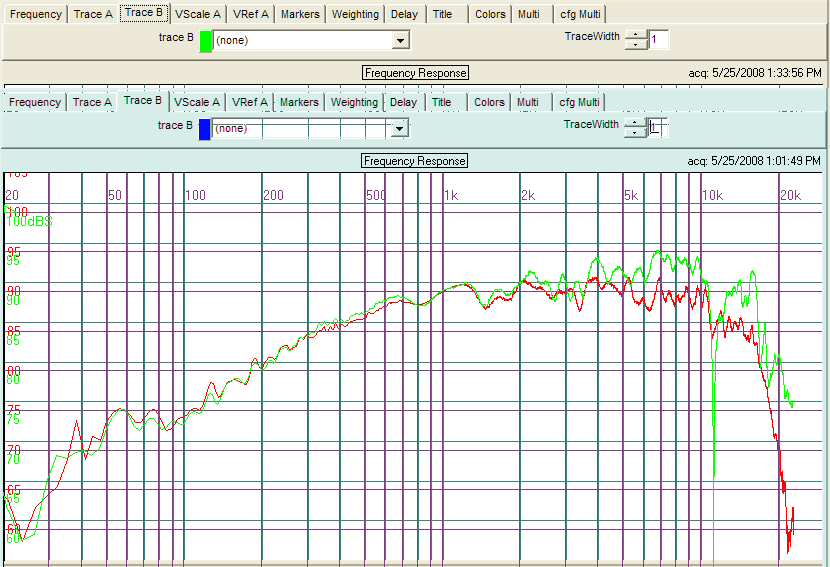

Here is an overlay with a non-modified driver (in green):
Note - we weren't careful about keeping levels the same, which is why the overlay is a little off. Similarly, THD dropped about 6db across the board (from about -54dB to -60dB), which would be great, but we didn't measure at the exact same drive levels, so I'm not totally sure of the results.
I'll post more data/discussion later, when I write up the speakers in another thread...

Thanks for posting your graphs. Probably best to post here until you do testing that has the sort of rigor the technical thread folks want to see.
