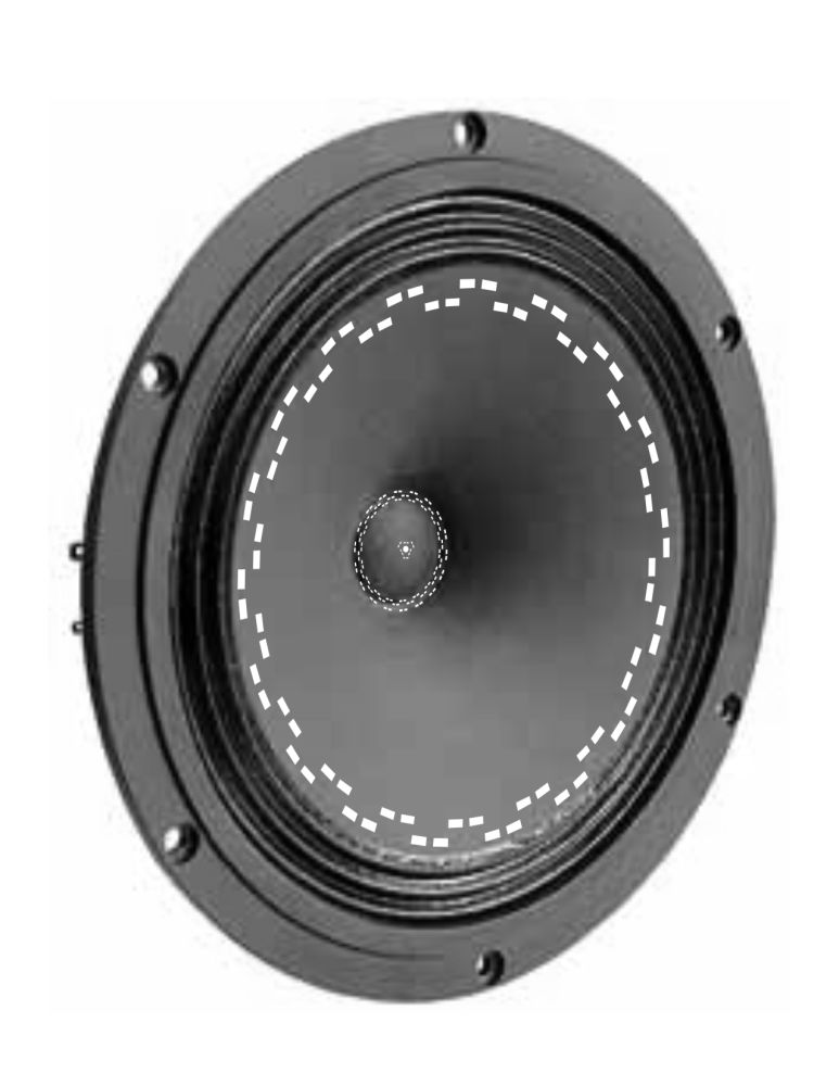

Finally, here is the generic flat pattern ring set.
This cone will respond to just the patterns shown in the picture of the virtual EnABL job. I have not treated one of these drivers yet, so I am not offering anything more complex than what I would put on a B200 I was treating, as a base minimum patterns set. The phase plug also has a set of patterns, three of them actually, so look closely. The tip has the typical six Block sets in two rings, around a droplet of paint.
When and if I do treat a pair, I will provide the mid cone rings and a set for the backside also. You will be able to add them to the patterns and Gloss coat already applied.

For all of you who were looking at your Visaton 200 cones and wondering what planet I got my picture from, it came from the 10th planet.
Dave set me straight on the B 200 phase plug issue. So, here is a virtual EnABL for the stock B200. Note that the inner rings have been condensed into three rings of blocks, from what could have been four. Looks like the voice coil dome is attached directly to the cone in the picture, and if so then three will work as well as four here.
