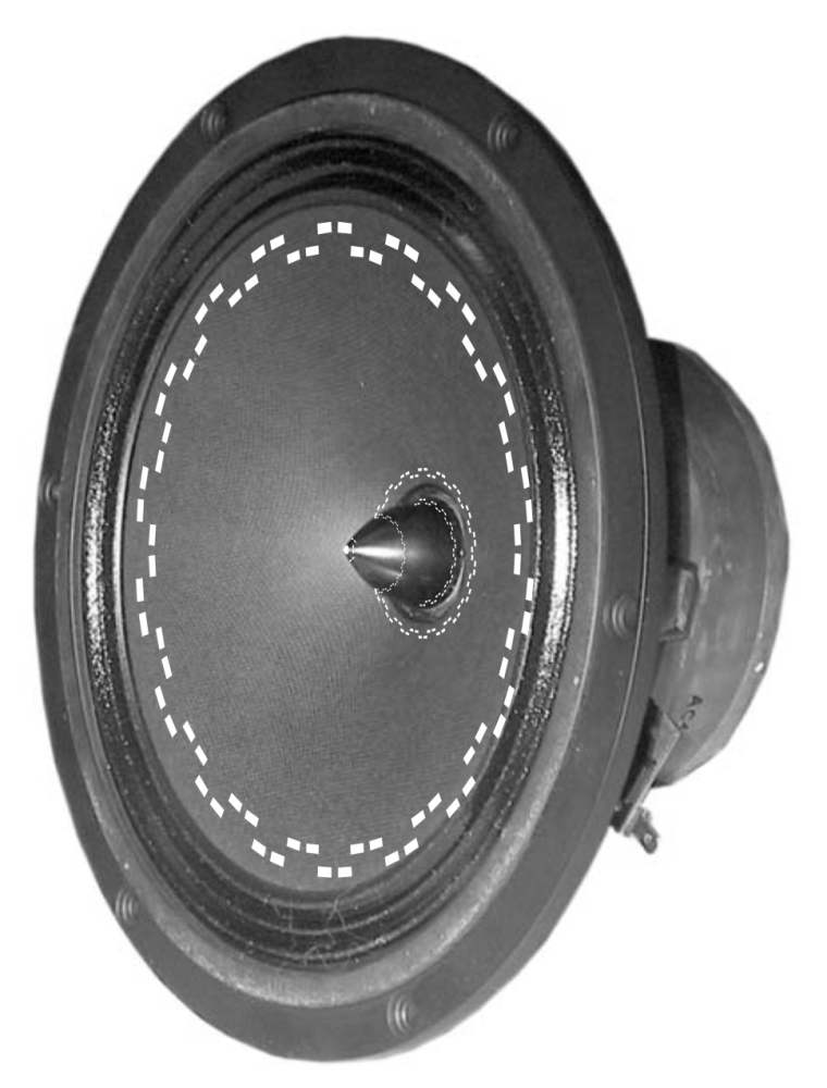

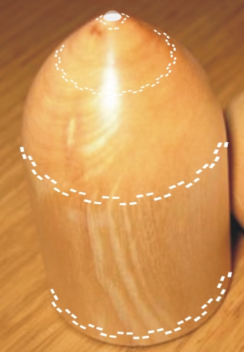

The two barrel patterns and tip treatment are the minimum needed. The interim round over pattern can be saved till all of the gloss coating is done and may not be needed at all.
These are of course virtual patterns. Their placement is visually close to where you want the actual patterns. The upper barrel pattern should begin at the break over for the bullet nose, with the top row definitely on that break over portion and the lower edge of the lower pattern right at the break over point, or as close as you can eyeball it.
Apply the patterns with a pen nib so that you can get a paint ridge to form when wet. This will dry with just a small ridge left over.
The tip patterns have a central paint circle of about 2mm in diameter with a PVA drop that size on top. See if you can support the plug upside down to get the drop to form a rounded blob.
The Gloss coat needs to go on full strength, or double coat a 50% coat. One full coat, top to bottom. Another coat over the bullet nose and covering the pattern placed there, will be the most likely Gloss coat coverage needed.
You need to listen to an event, before applying the first Gloss coat. Pick an alto female voice and play it at less than room filling volume. Get right up on the speaker and with your ear aimed at the thing, move your ear across the cone to whizzer area and over the phase plug. Anywhere within 6 inches should do for ear placement. You are listening for a shriek to the voice that eliminates the vibration and imposes an artificial and unusually loud character to this voice, as it slides up and down her range. If you do not hear any of this then listen out in the sound field to see if the "enriched" sound from the whizzer included angle has been tamed, with just the patterns.
If not, then apply the first full length coat and listen to the drivers after it has had a 24 hour cure period. If there is still some enrichment left, apply a coat over the bullet nose, except for the PVA dome.
If this still does not finish the job you will need to add a mid whizzer ring of blocks to the inside of the whizzer cone and likely an ever sticky acrylic paper glue coating to the out side of the Whizzer cone. At this point you are manipulating the overall impedence to high frequencies and redirecting that energy into the main cone. Not much of it needs to be redirected, usually.
Now, if you really want to get into trouble and also learn more about how you can manipulate the energy being emitted, a mid cone ring and a back side set of pattern rings will do nicely for this sort of terror. Take a look at the Hemp FR8c pattern pictures and pattern PDF located here

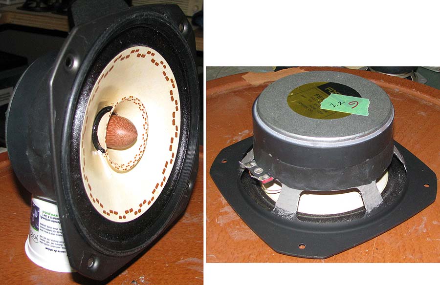

Jordan EnABL Toothgel - Update
I haven't touched the drivers since EnABLing them a week ago (or was it two weeks ago). The tooth gel has dried out now (I determine this by touching my test samples I did at the same time).
The EnABL modification is very nice (even in tooth gel, I haven't used the recommend paint yet). A couple nights ago I removed a small 0.4 mh coil I had in series with the Jordan driver to run it full range again. What I found was that I don't need this coil anymore. I continue to use my ribbon tweeter with the same 3 uf Sonicap with .22 Sonicap Gen II bypass cap.
The combo sounds really nice. I believe the tooth gel is lowering the high frequency response of the Jordan by just the right amount. My guess is that it is absorbing it.

I don't remember seeing instructions or specifics on the FE166 so this is my intended approach, very similar to Alan Hope's on his 206's:
1 - Use the barrel pattern, appropriately scaled for every of the circles to be painted.
2 - Circles to be painted:
- Main cone, outer pattern, two lines of blocks, next to the surround (as usual).
- Main cone, inner pattern, next to the whizzer/ VC union. Two lines of blocks. I'm afraid that making it a 3 line with one in the union and other over the base of the whizzer itself could prove to be an impossible task, and result in a disaster.
- Whizzer cone, outer pattern, three lines of blocks, one in the flat portion, one in the boundary line (the angle), one on the conical portion itself.
- Whizzer cone, inner pattern / dustcap boundary, three lines of blocks, one in the cone, other over the boundary, another over the dustcap. If I later decide to phase-plug it, I could draw another (outer) line of dots and be done.
- Dustcap, inner pattern, two lines of blocks around the inner void/vent/ring radiator. I suspect this pattern could be really helpful and perhaps even eliminate the need for phase plugs !
After this is done, well dried and evaluated, then it would came Gloss stage, as you very extensively described in previous posts and several threads/forums.
If still wanting for more in the midrange, then soongsc "mid-cone" (actually at 2/5 as you suggested) pattern would finish the treatment...

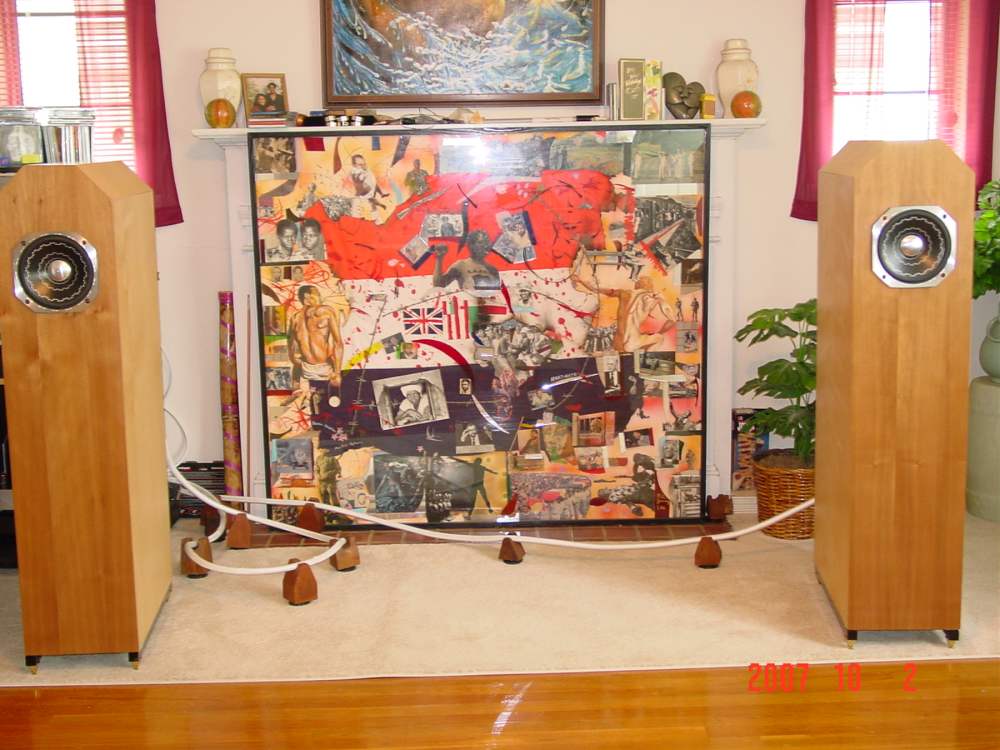

Here is a message sent to me by the owner of those Fostex F 200 A drivers that caused some feathers to ruffle a few weeks back. Looks like those same feathers will need to be disturbed again. A very interesting confluence here.
So, in the words of Gilbert.
" Hi Bud I'll post with you and let you post it for the other's, but first, those are my two girls and I am the guy in the collage, on the left, with my back in full and holding the clock------ The Fostex F200 A, in John K's cabinets, sounded great I thought, before I had even heard of this Enable process. But now, things are more than I could dream about!
Bud changed the characteristic of the f200a 's and they are the most 3D sounding speaker I've ever had. It's like opening a window and hearing everything. Bass is two or three octave's lower, they are so fast and you are really in the center of the sound, it's like a brand new speaker, all for the better, thanks Bud"
John K's cabinets are quite impressive. I have an interior picture showing just how thick walled these things are and he signs his work. Good for you John. What sort of bass loading do these provide, are they a back horn or a bass reflex or what John?
Bud

Here is a virtual treatment pattern for the B200 driver, I will also post a pdf with a generic set of 8 inch pattern guides and a conic section that you can print in Acrobat and change by % in the printer instructions. And I will post a set of generic flat pattern rigs that you can do the same thing with.
Bud
Bud
