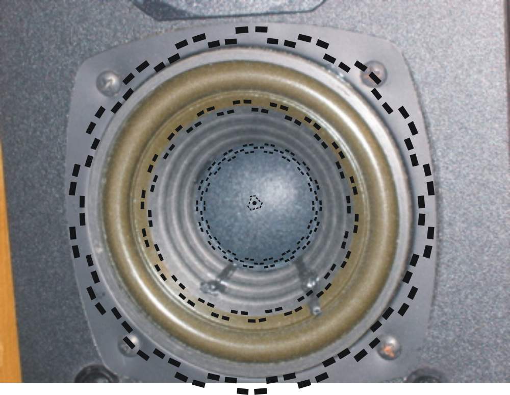

Thanks to Ed, I now have the materials to try EnABL on a cheapo pair of speakers - some Pinnacles. Main driver is a 3" cone that measures 2.5" on the inside of the surround attachment. See photos below. Since the cone is so small and the surround attachment is so relatively big, I'm wondering where the outer pattern ring should go - inside of the surround attachment on the paper cone itself, or farther out onto the surround attachment? Also, what about patterns on the inner cone next to the voice coil dome and on the dome itself? What about the back side of the cone, the metal frame, etc.? I see lots of what seem to be variants (especially Bud's last posts) and can't make sense of what's required and/or what's ideal. Will just the outer pattern on the front side work or are all locations required? :scratch2:
TIA,
Carl
Hi Carl,
Here is a preliminary look at what patterns you need and where I would place them.
We can get more detailed if you need to but I will need some measurements that are down to 0.005 inches in variance from reality, in specific places. Or, you can use a % of resize print out from one of the PDF files of patterns available, or if you have Corel Draw or Illustrator, I can provide vector files that you can scale exactly to size, for pattern templates. All can be done quickly too,
Bud

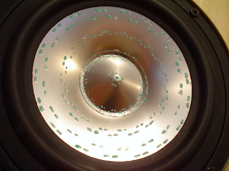

Hi Guys,
The urge struck me last night to EnABL my Jordans. I didn't have the proper paint or tools to do it, but why let that stop me.
I grabbed three types of toothpaste from the bathroom, two were paste one a gel. I experimented with a toothpick and the three types of toothpaste. I soon abandoned the toothpick and found that a mechanical pencil worked much better. Also the blue tooth gel (Kids Colgate, Sir Shrek cartoon character on the font) worked the best.
I would dip the pencil lead into the tooth gel and when I pull the lead out it would make a consistent gel string on the end of the lead. There are a couple ways to use this little gel string while doing the patterns. To make bars, touch the end of the string to the driver so that it sticks then lift and stretch the string and position the other end where you want it. Doing this reminded me of those little green inch worms in the garden. but smaller and nice smelling.
After doing the first driver I put it back in the cabinet and tried to hear a difference from the untreated driver. I tried putting my source into mono mode, switching one speaker on/off, both on and so on. Nothing really stuck out as different other then when back in stereo mode with both speakers playing it sounded odd, can't really describe it.
With both drivers treated it was easy to hear the difference. Much more detail and soundstage, almost all shrieking is gone, beaming is gone. But I think I may have put a little too much gel on. Now some of the female vocals are not so clear and in my face as I am used to. I am sure I will get it right in future attempts.
Now that I have a feel for EnABL I will get up to speed with the proper paints/tools and see how they compare. In the mean time I may take another crack at it with the tooth gel to get more experience on pattern placement and how each patern affects the drivers performance/sound.
Thank you Bud for the excellent speaker mod.
I didn't sleep a wink last night, such fun.
BTW... I noticed my tweeter ribbons already have little dimples on them, maybe that is why they sound so good.
Brent

Could also just be the amount of pollen in the air. Do try some very complex music and anything you remember as being a challenge for the untreated drivers.
Brent Welke,
Good for you and nice to see that you included Soongsc's mid cone patterns. When you get to the more permanent materials, though with the metal cone, not necessarily much more permanent, do close up the gap between the two outer rings please. They are right on the edge of becoming ronc's random patterns and we can't have that getting out.....
Bud
