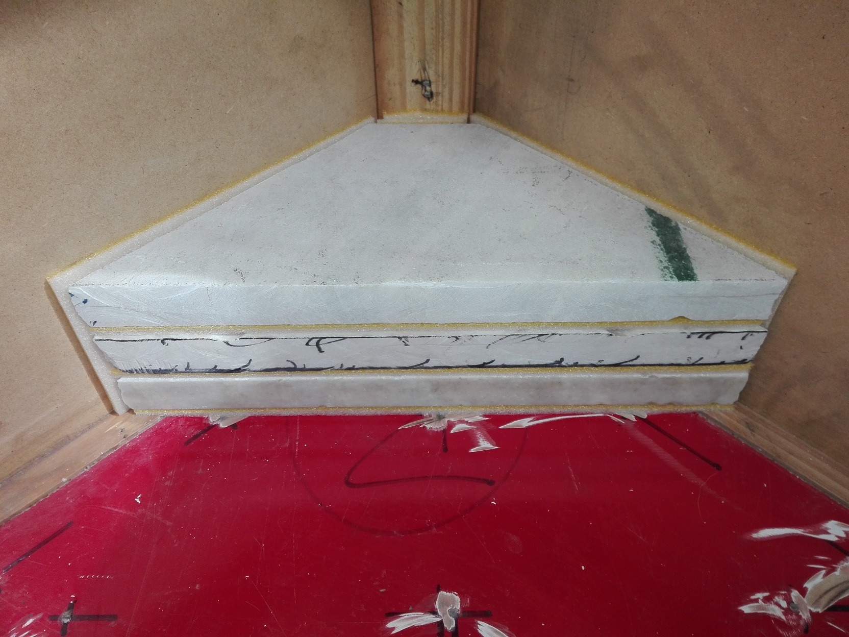

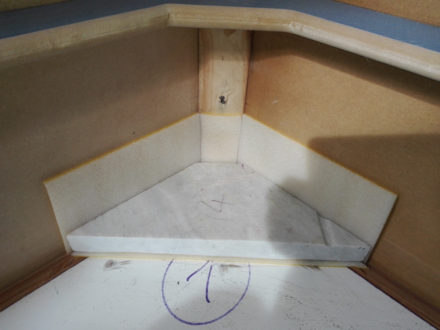

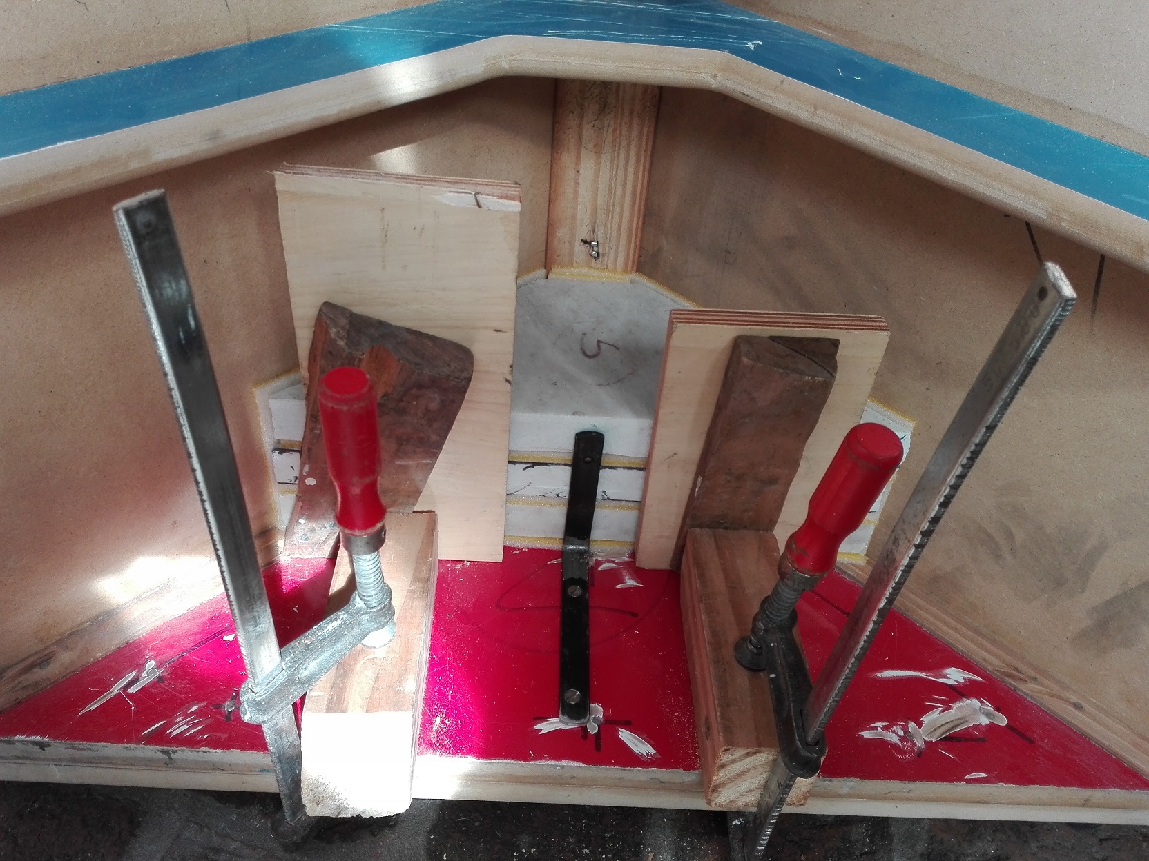

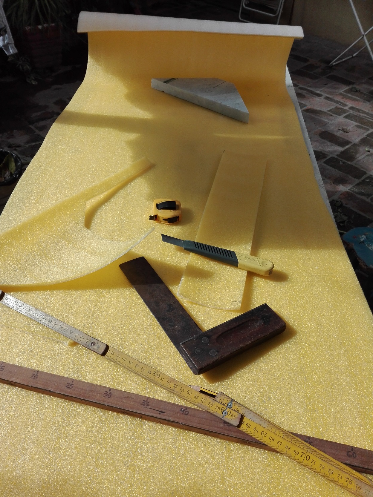

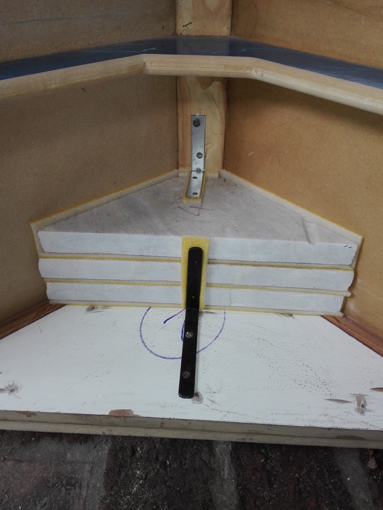

Installed the marble blocks with 6 mm thick expanded polyethylene foam to avoid any kind of annoying vibrations.
Remember that the order of the photographs does not correspond to the order of work.
But it is quite close, with a little deduction you can follow the correct steps ....

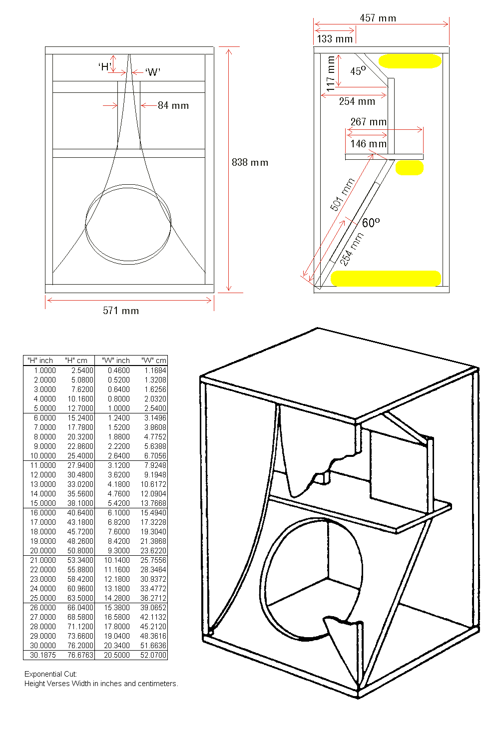

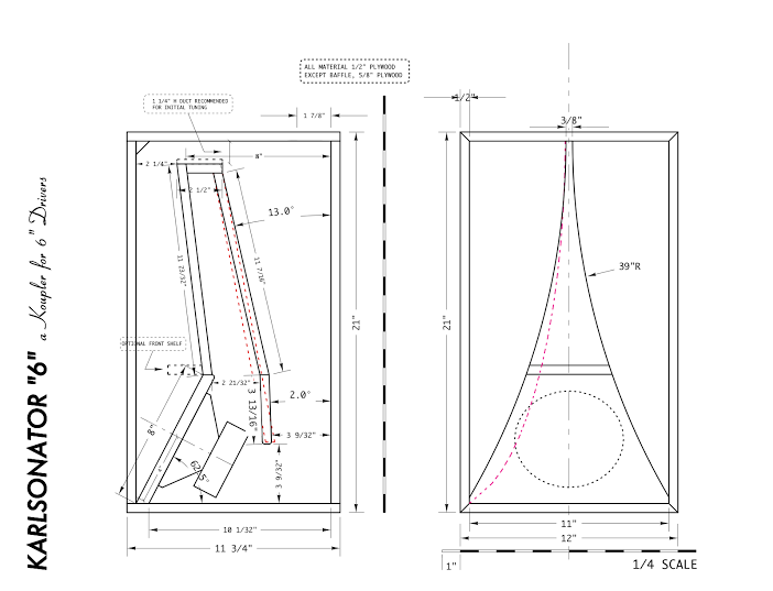

1972-10 has a labyrinth speaker project
(I'm looking for Karlson type)
Radiorama : Free Texts : Free Download, Borrow and Streaming : Internet Archive

There are quite a few Karlson pages, but in Spanish ... I can send them if you are interested

Here some material about Karlson's I searched time ago, and mines.
No one problem with him. A pioneer. But several steps over our Saul Sorin 🙂
Osvaldo and freddi, here they have info that surely already they know but there are comments and interesting photos.
Caja Acustica Tipo KARLSON | Pagina 2 | Foros de Electronica

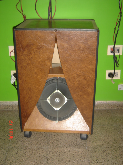

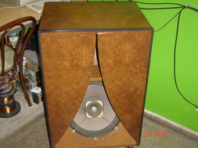

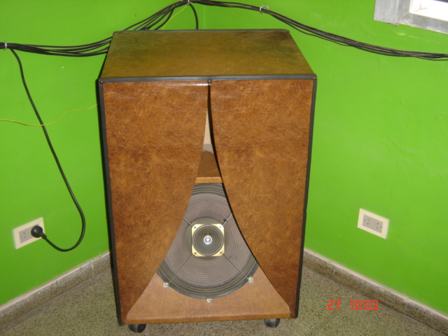

I was cheating. Say to those gilazos that he says "few means and highs" and "piped sound " that in the originals of Karlson he himself says that it is necessary to use speakers of extended range or coaxial, what a bunch of ********, they do not know nor to read.
As of 15" I didn't have (those of the photos are repaired units), I coaxed them myself with a 4 "tweeter in front of them.
Los estuve chusmeando. Decile al gilazo que dice "pocos medios y agudos" y "sonido entubado" que en los originales de Karlson él mismo dice que hay que usar parlantes de rango extendido o coaxiales. Que manga de pelotudos, no saben ni leer. Como de 15" yo no tenía (esos de las fotos son reenconados), los coaxiales me los hice yo mismo con un tweeter de 4" delante.
