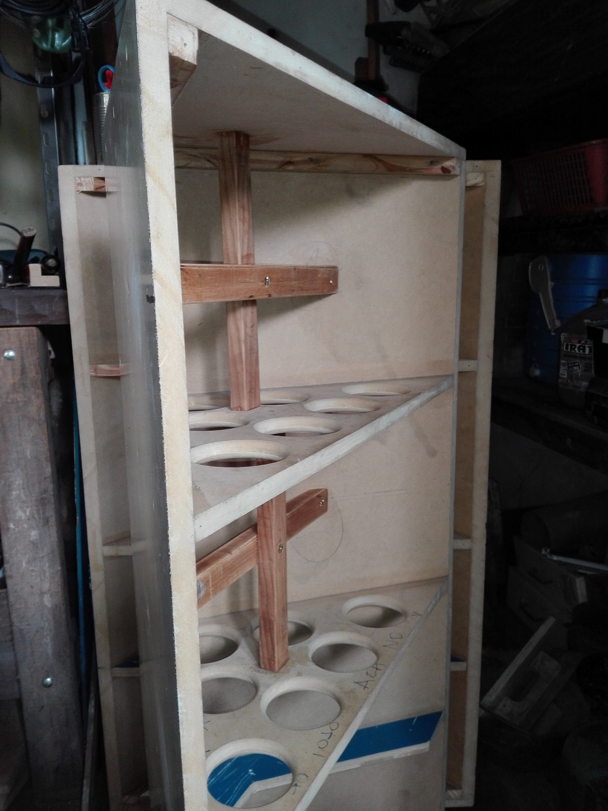

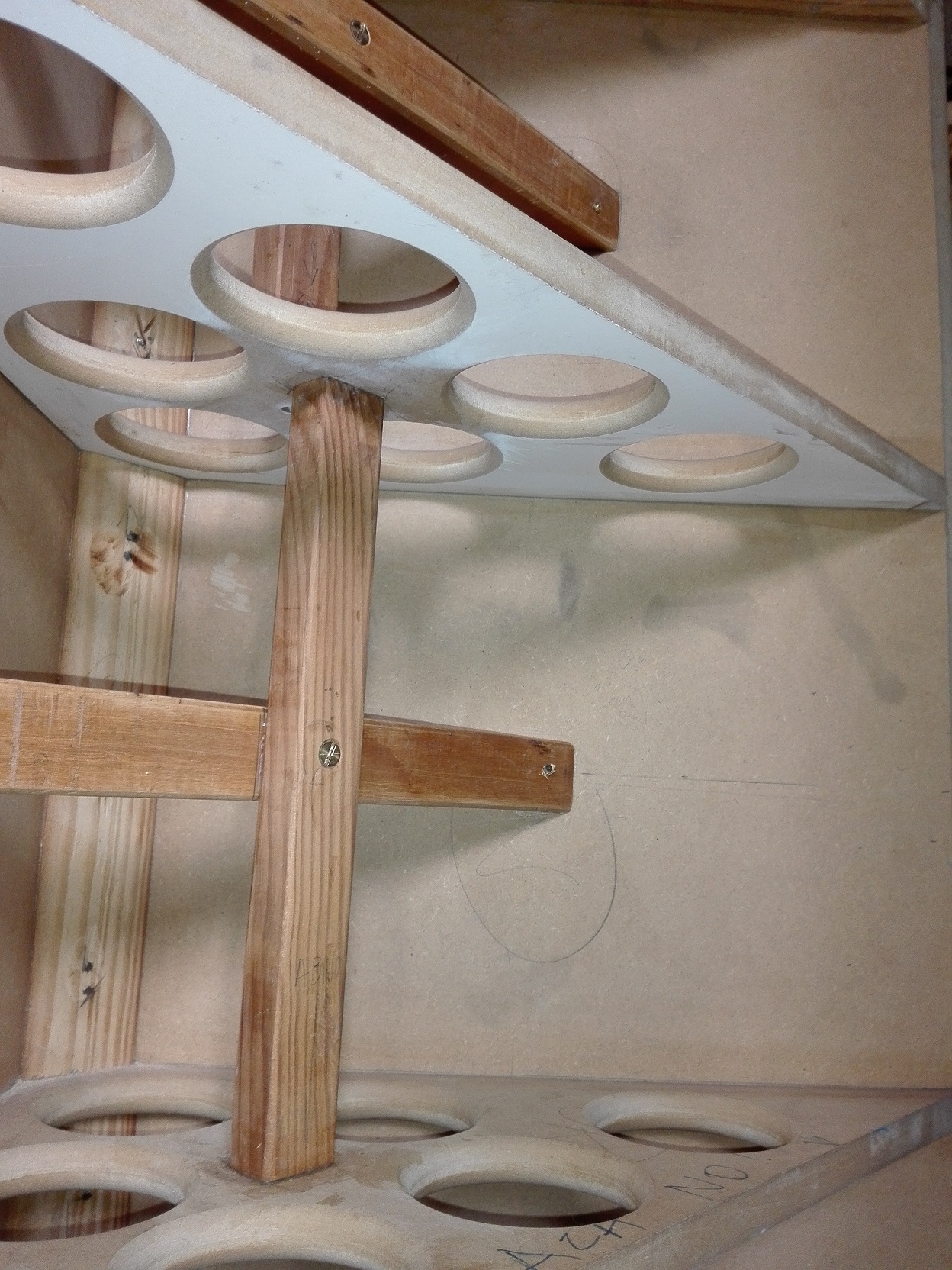

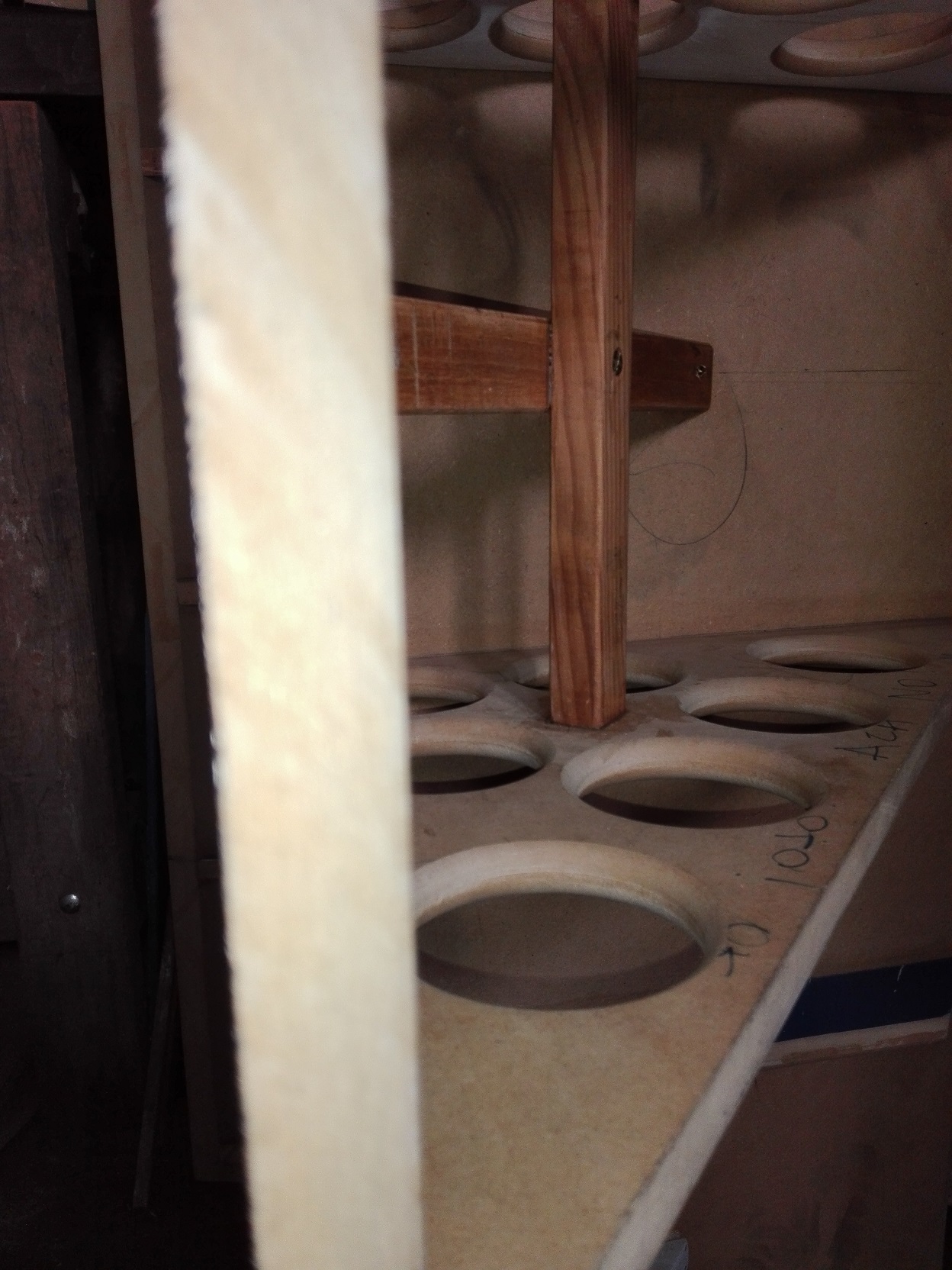

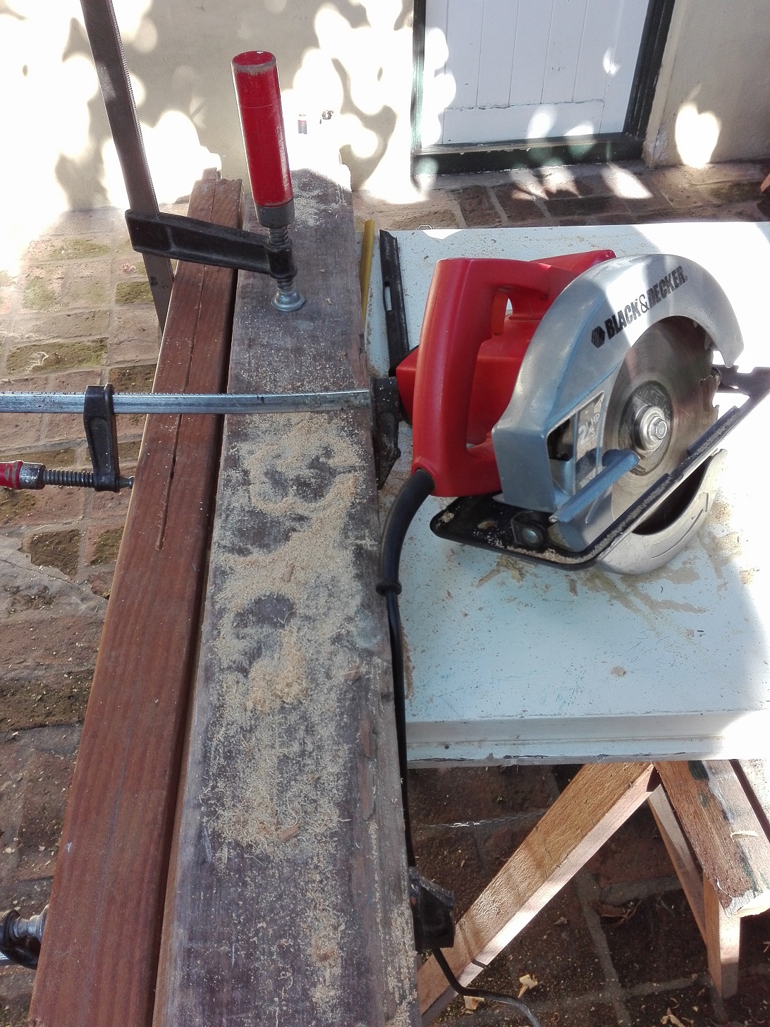

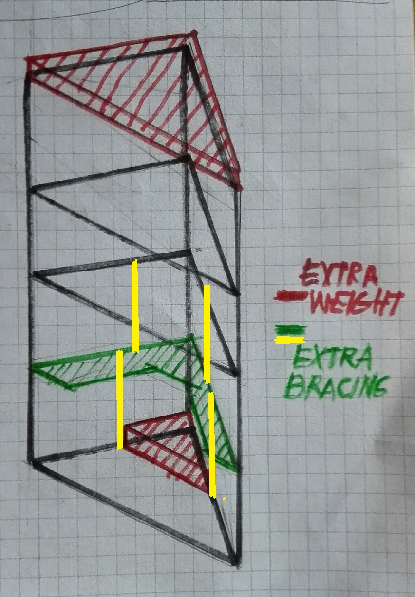

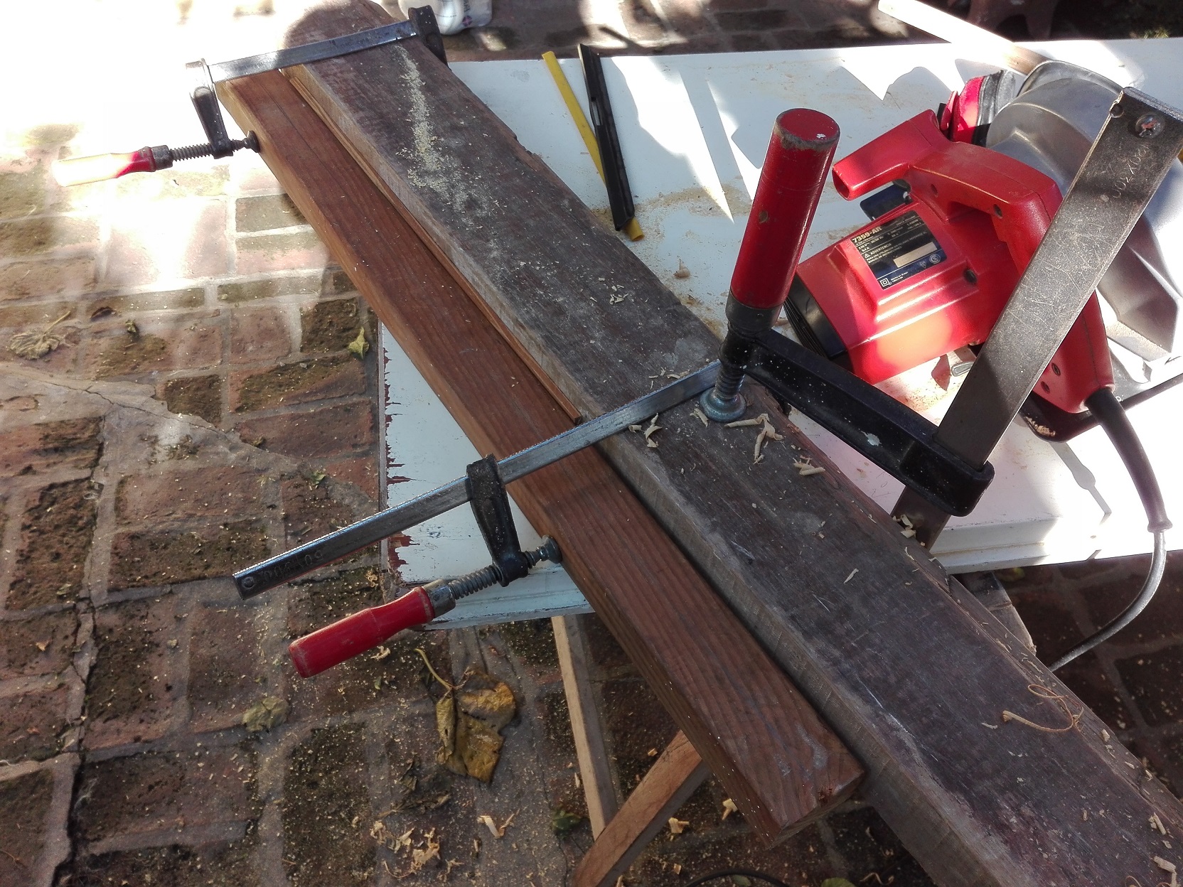

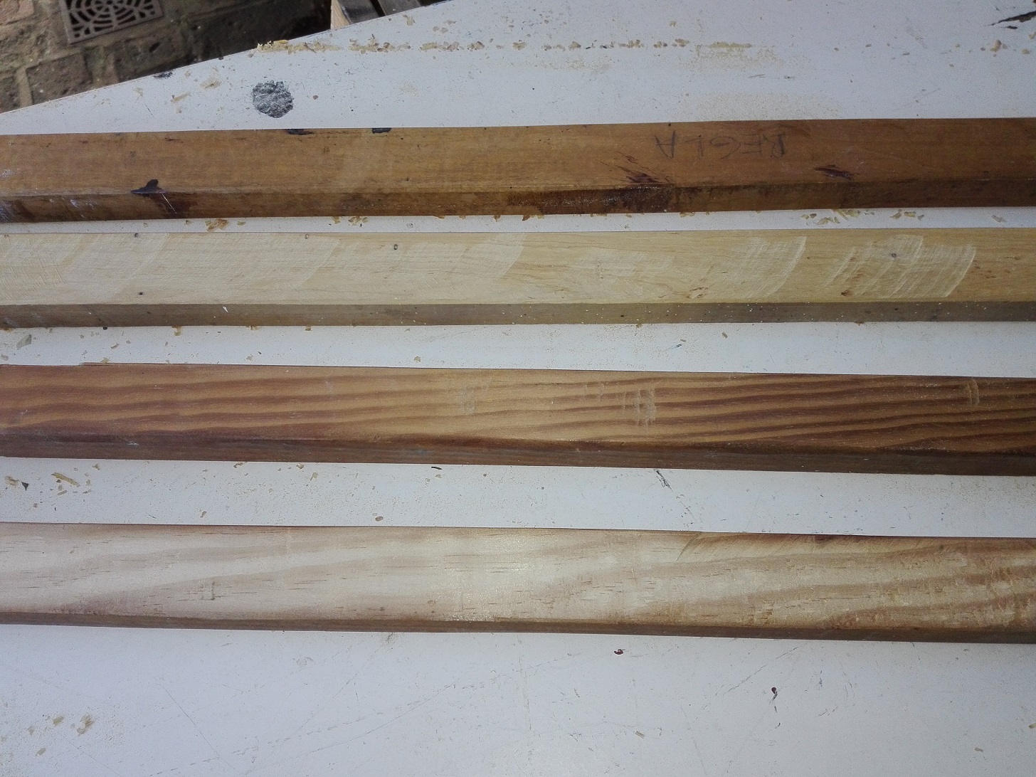

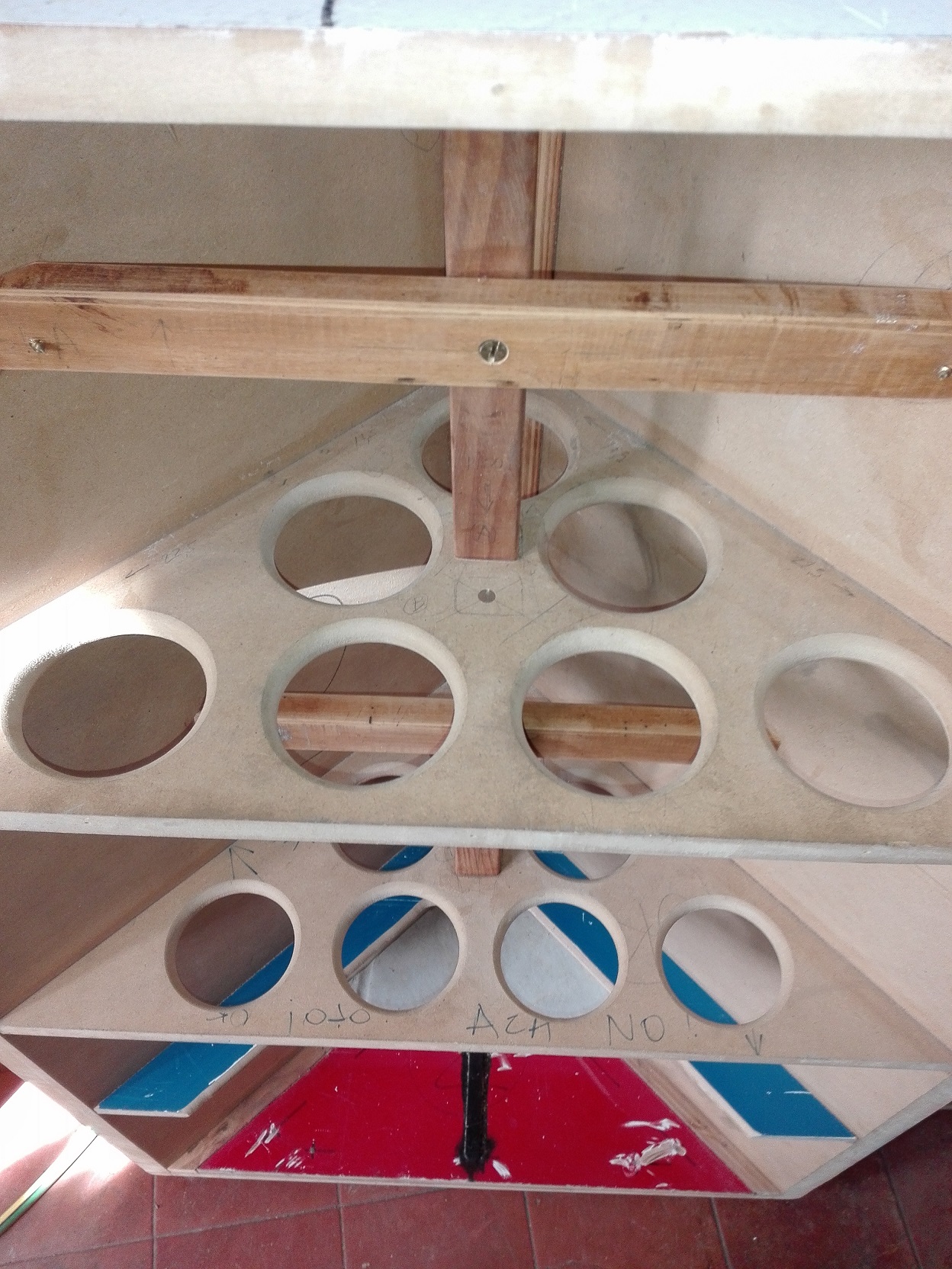

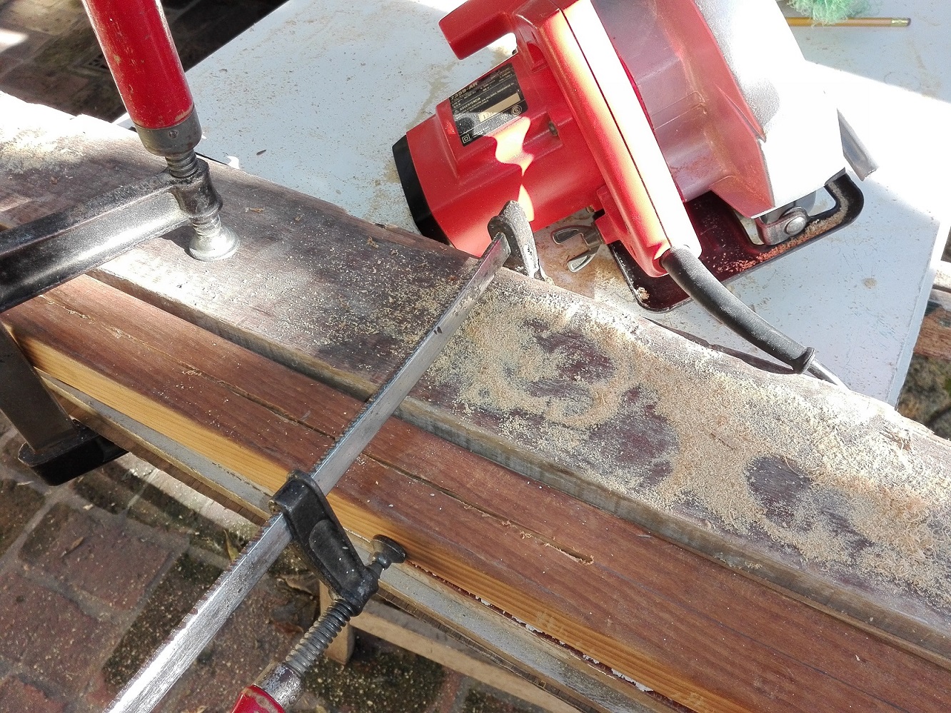

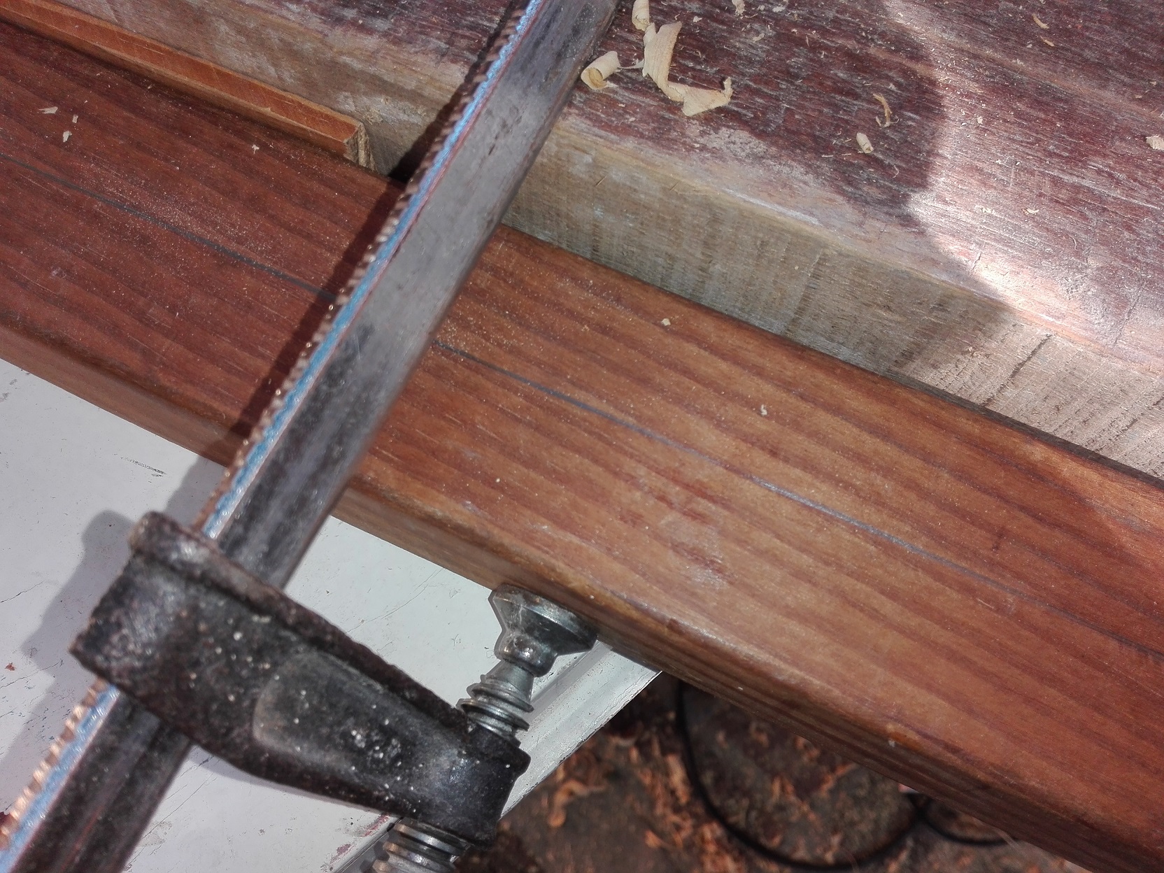

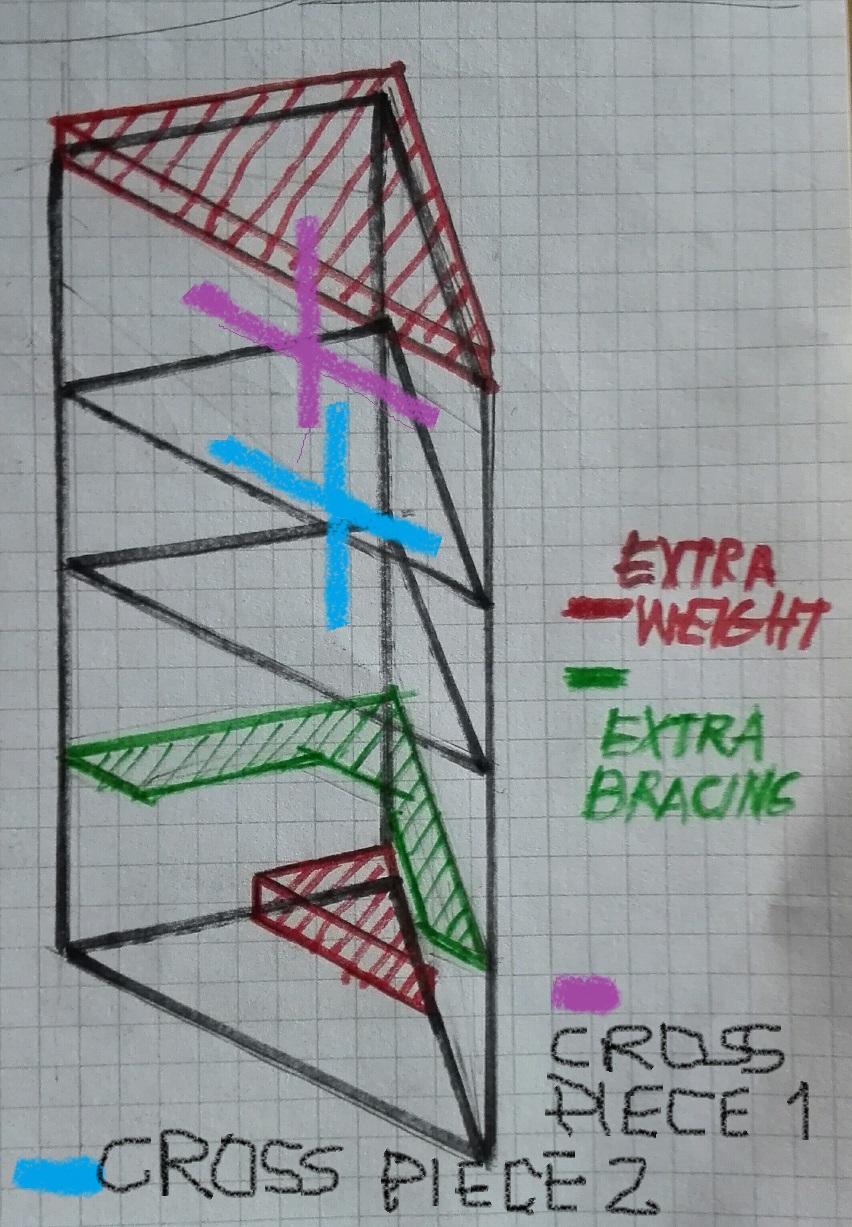

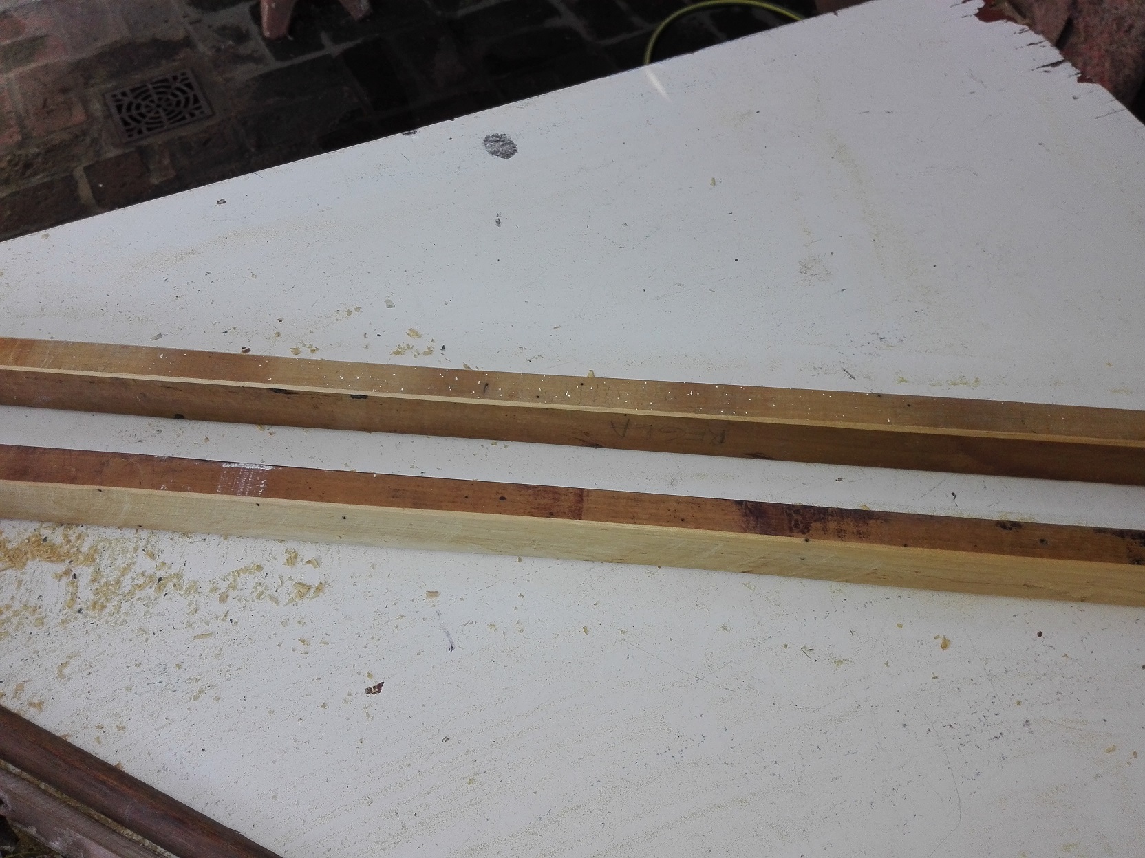

I have found two hardwood slats, (here we call it teak) and I thought it would not be too much to place two cross reinforcements in the upper compartments to increase the rigidity and raise even higher
the resonance of the panels outside the working range ...
I had to cut them in half, (they were too big and not enough for both cabinets, and yes, the idea is to take advantage of all the elements that I have at my disposal ...
I do not use all the tools offered by Paint, so the letters and lines seem to be written by someone suffering from Parkinson's Disease ......
Luckily that is not my case, and I hope you understand the idea of how they will be installed.
This is going to be very heavy ...

Che, ¿pero agregar tanto refuerzo no te quita excesivamente volumen interior? ¿Tuviste eso en cuenta en el diseño original? Ojo, no es una crítica molesta, sinó una simple sugerencia constructiva.
It seems to me that to add too reinforcements inside the cabinet will reduce internal volume too much. Did you take in mind when designing the box? I am not criticizing the construction, only a constructive suggestion.
I was cheating. Say to those gilazos that he says "few means and highs" and "piped sound " that in the originals of Karlson he himself says that it is necessary to use speakers of extended range or coaxial, what a bunch of ********, they do not know nor to read.
As of 15" I didn't have (those of the photos are repaired units), I coaxed them myself with a 4 "tweeter in front of them.
Los estuve chusmeando. Decile al gilazo que dice "pocos medios y agudos" y "sonido entubado" que en los originales de Karlson él mismo dice que hay que usar parlantes de rango extendido o coaxiales. Que manga de pelotudos, no saben ni leer. Como de 15" yo no tenía (esos de las fotos son reenconados), los coaxiales me los hice yo mismo con un tweeter de 4" delante.
I had Karlson cabinets with Leea 12-inch extended-range speakers, it was many years ago and I do not think it lacked highs. They were those of the metallic dome, I do not remember the exact model....
But of course, I could listen to 20 Khz at 18 years of age .....
In any case, what I liked most was the great sound stage they achieved.
Yes, it is contemplated, the filling will compensate all the reinforcements with spades.
Before closing the baffle I will calculate all the extra volume that I added, to have an approximate idea of the resulting Qtc.
It will not be exact because there is no way to calculate exactly the percentage of virtual volume that is added with the filler material. But surely it will not be higher than the ideal of 0.707, although I prefer it to be less.
Si, esta contemplado, el relleno compensara todos los refuerzos con creces.
Antes de cerrar el baffle calculare todo el volumen extra que agregué, para tener una idea aproximada del Qtc resultante.
No será exacto porque no hay forma de calcular exactamente el porcentaje de volumen virtual que se agrega con el material de relleno. Pero seguro no será superior al ideal de 0.707, aunque yo prefiero que sea menos.

I wouldn't worry about bracing the top & side panels. Top is small, making its resonance naturally high. The sides lie against the walls, so their output is easy to absorb. Damping the baffle seems like the #1 priority here....it would not be too much to place two cross reinforcements in the upper compartments to increase the rigidity and raise even higher the resonance of the panels outside the working range...
IIRC, you're already using the basket for this. Maybe put the teak on edge, radially around the cone to stiffen the baffle without reflecting or blocking the rear wave.
I think you have not seen that the baffle panel is twice as thick as the side walls, they are
2x 18 mm: 36 mm !
Anyway, you're right, I'm looking to reinforce even more the panels in the lower sector where the speaker will go ...
I think that some strips glued and screwed directly on them will be enough ...

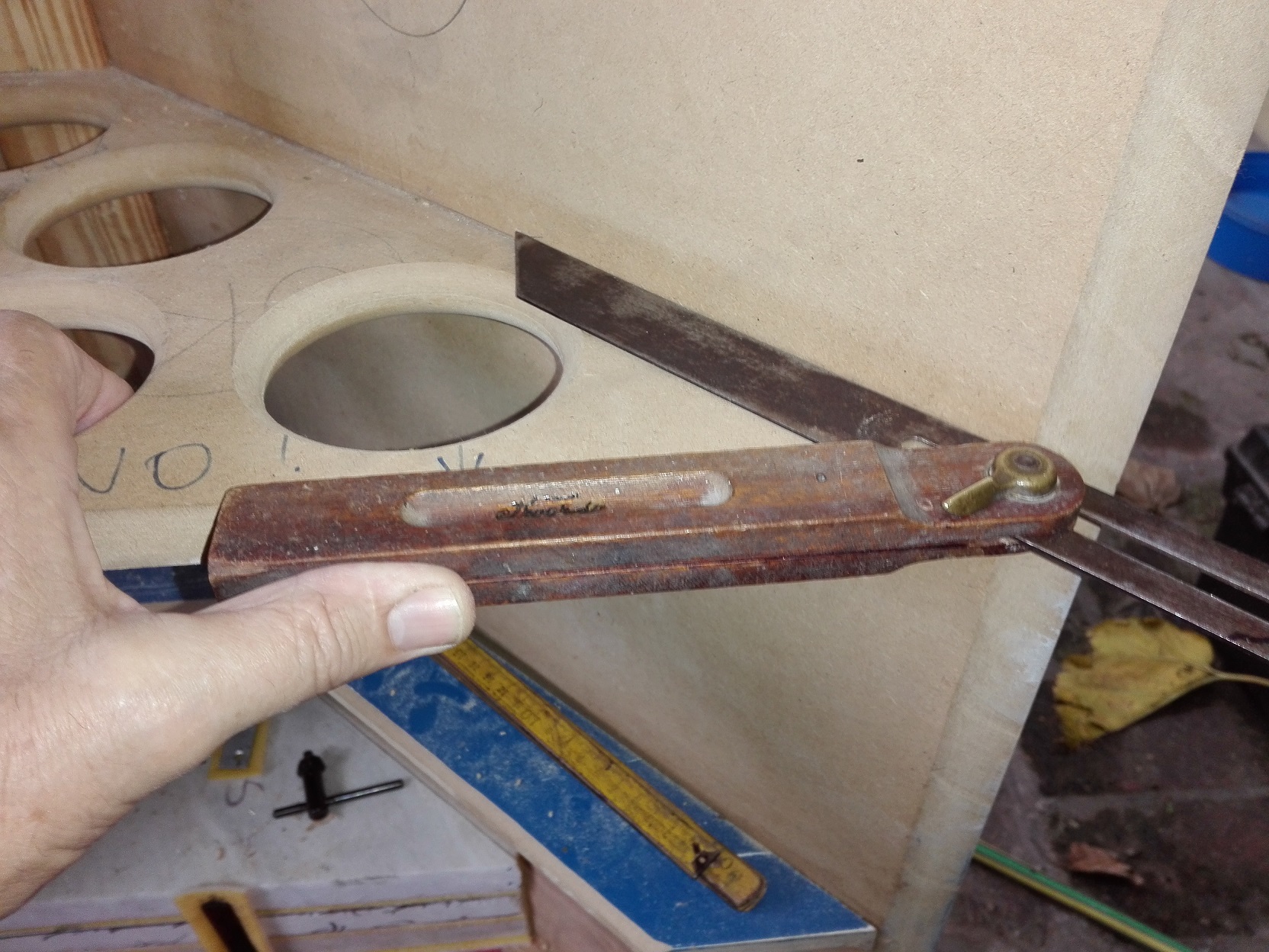

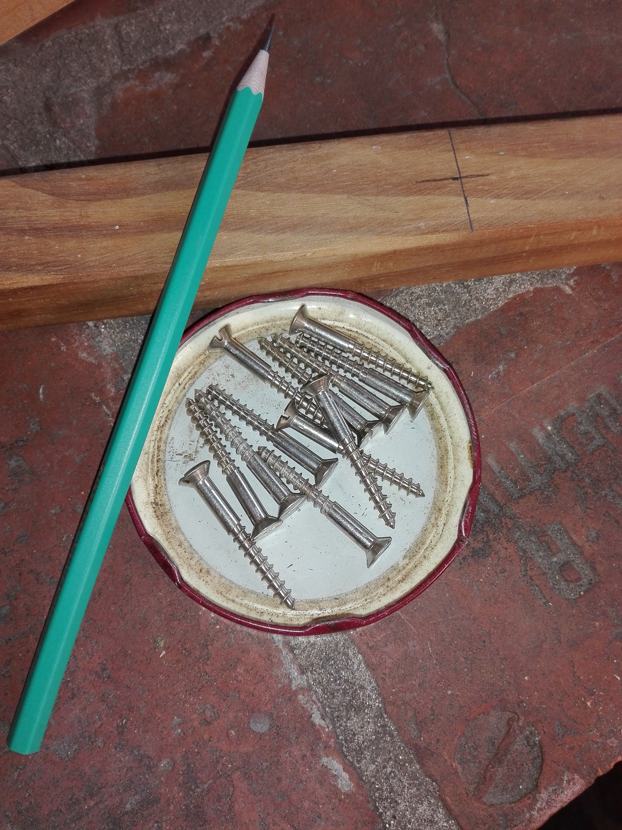

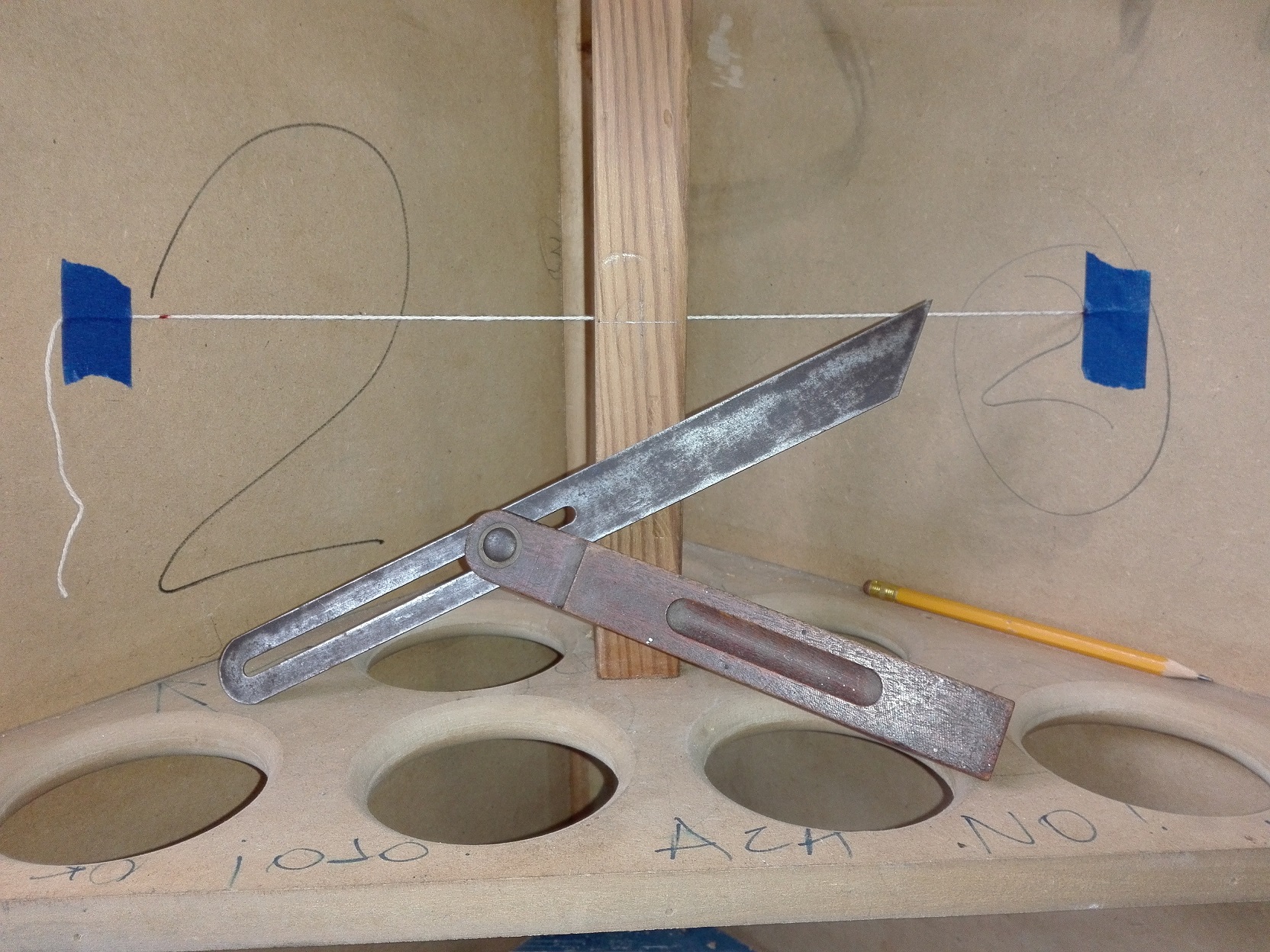

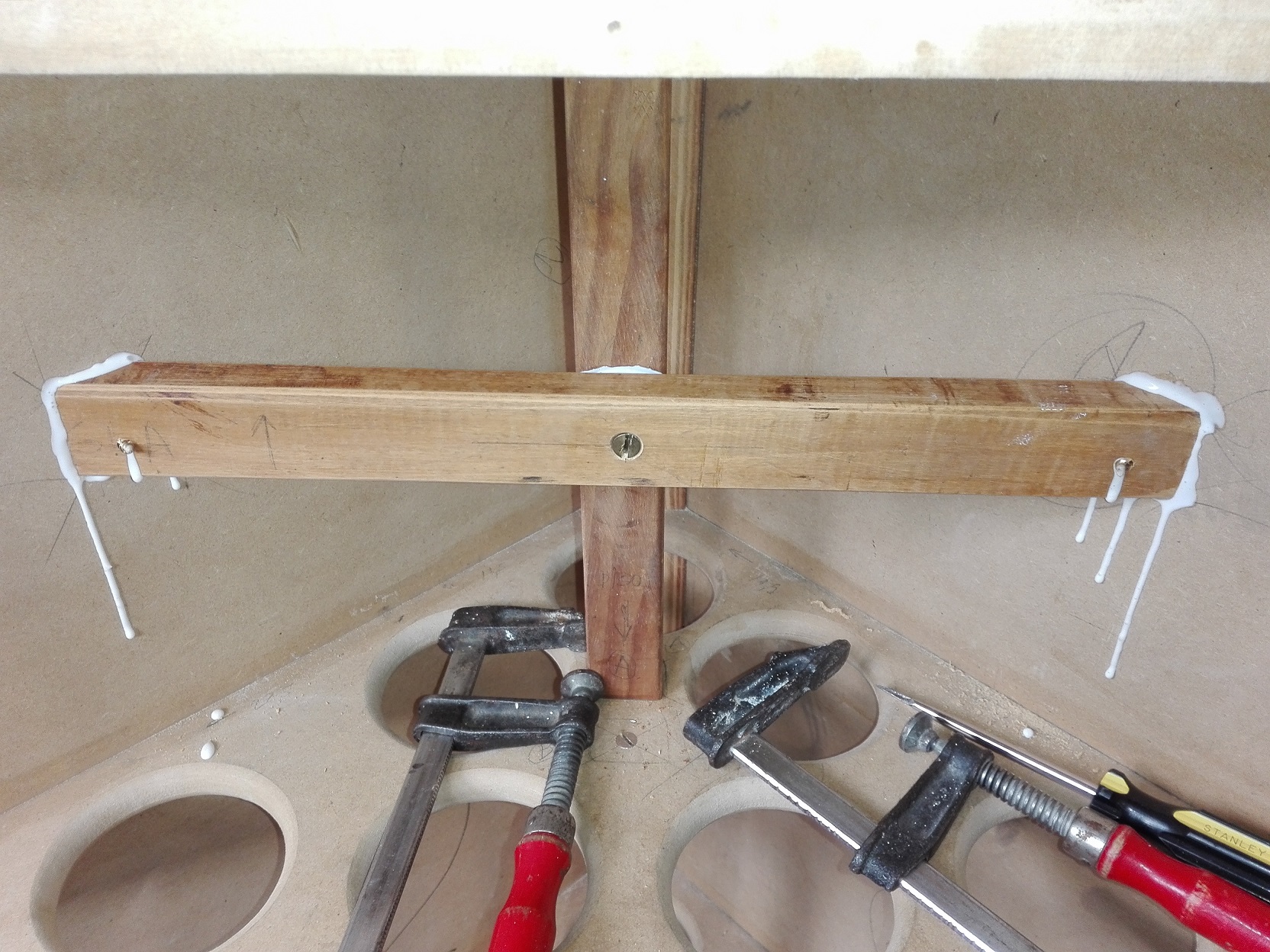

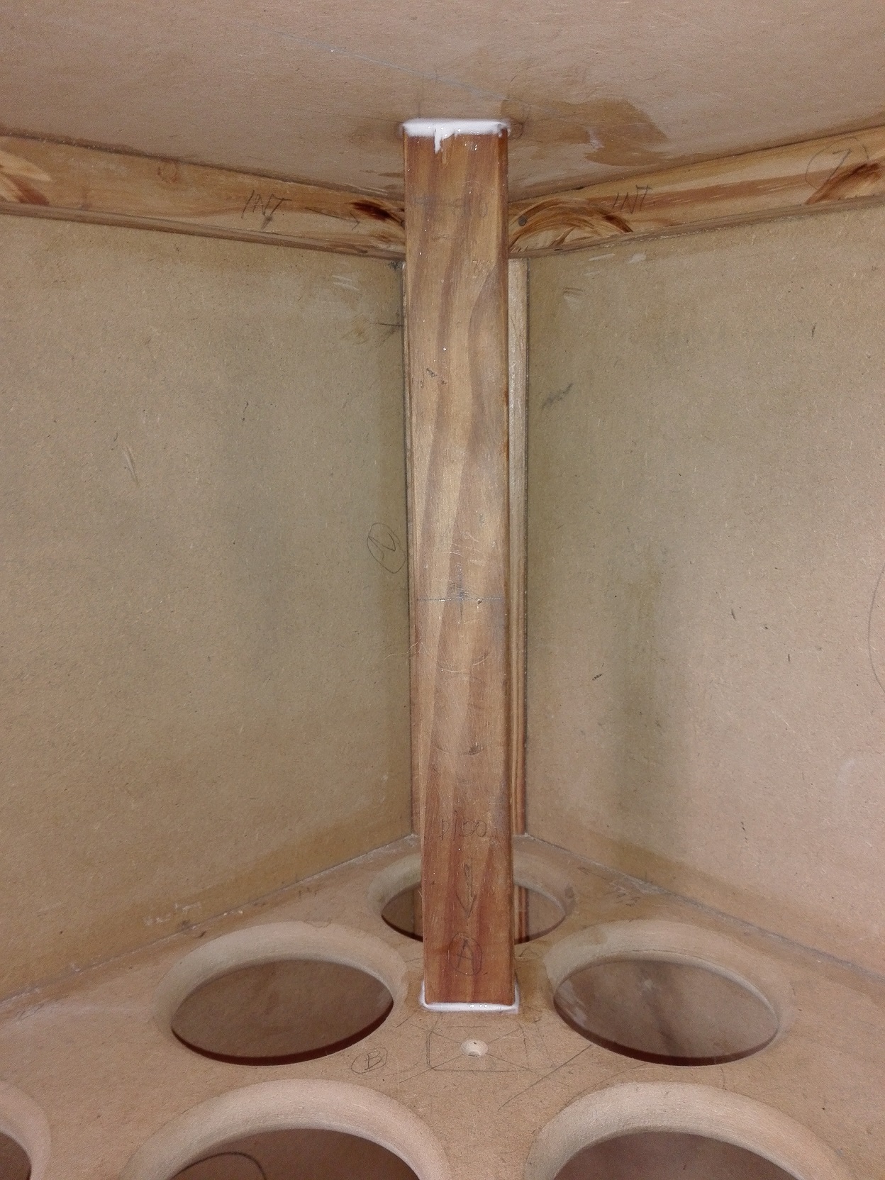

A little late, but here I leave some images of the last work, which is not yet finished.
I thought about doing a "fit" between the vertical bar that can be seen and the next that will be horizontal, but definitely not worth the extra work.
At least for me.......
PS: I treasured these chrome-plated brass screws for a long time, finally the time came to give them a utility !

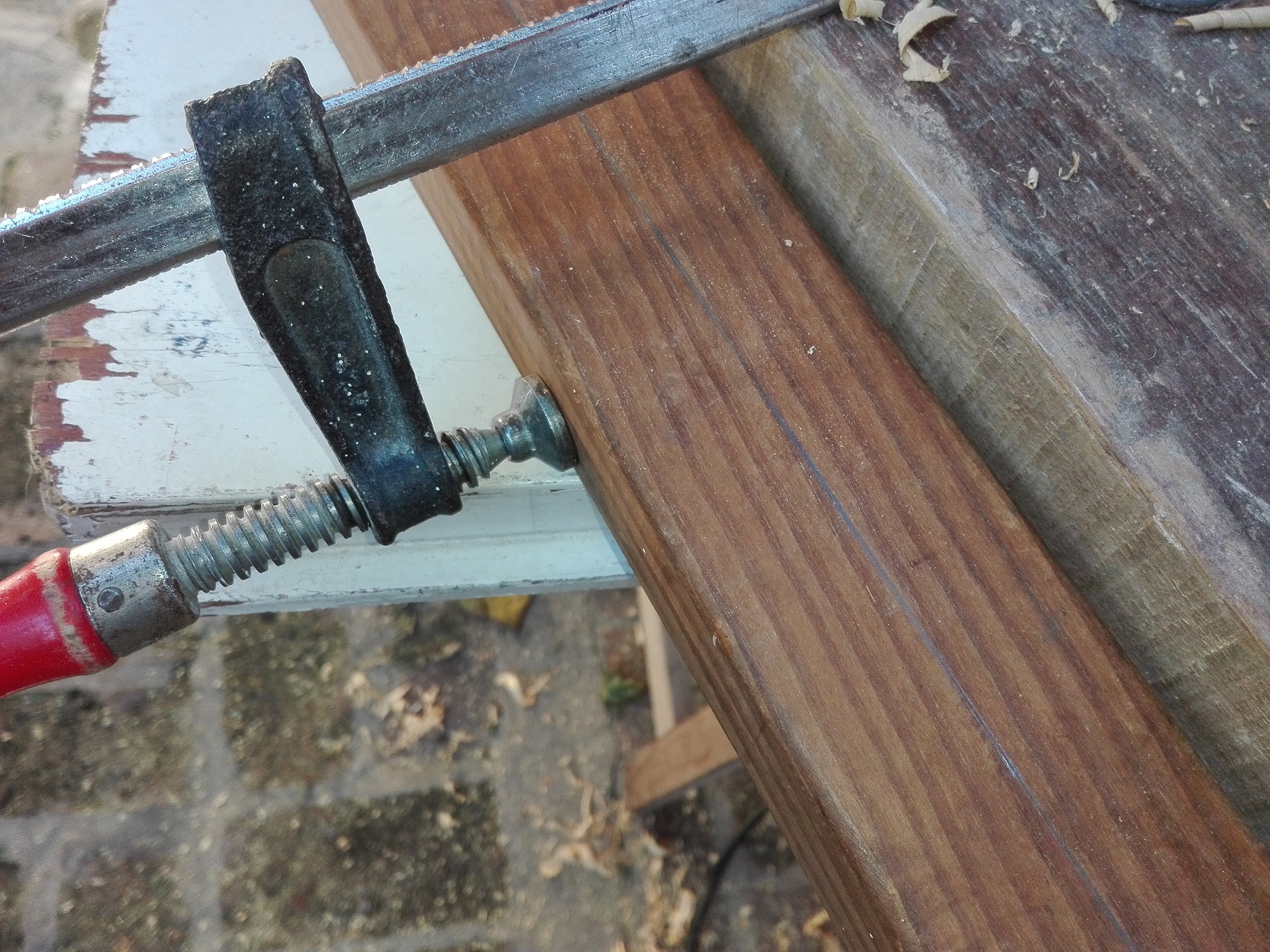

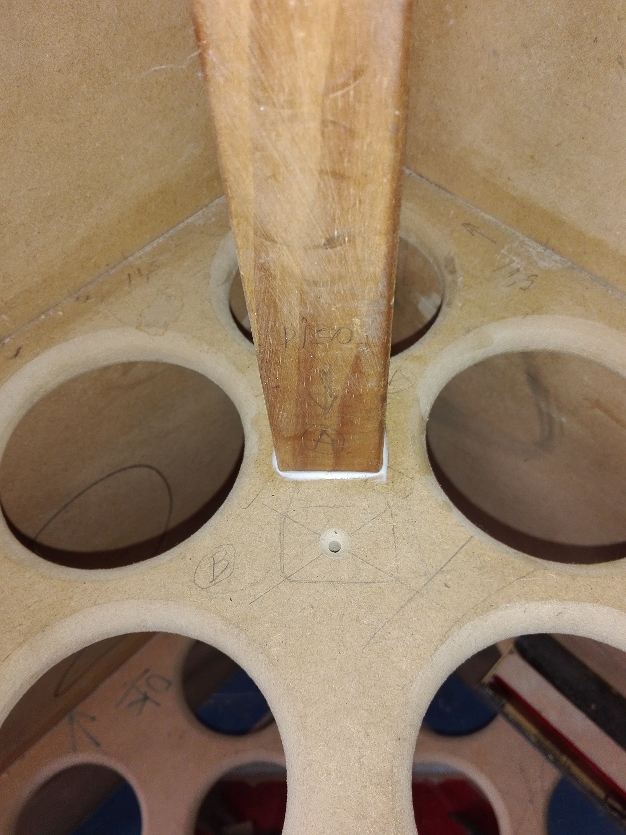

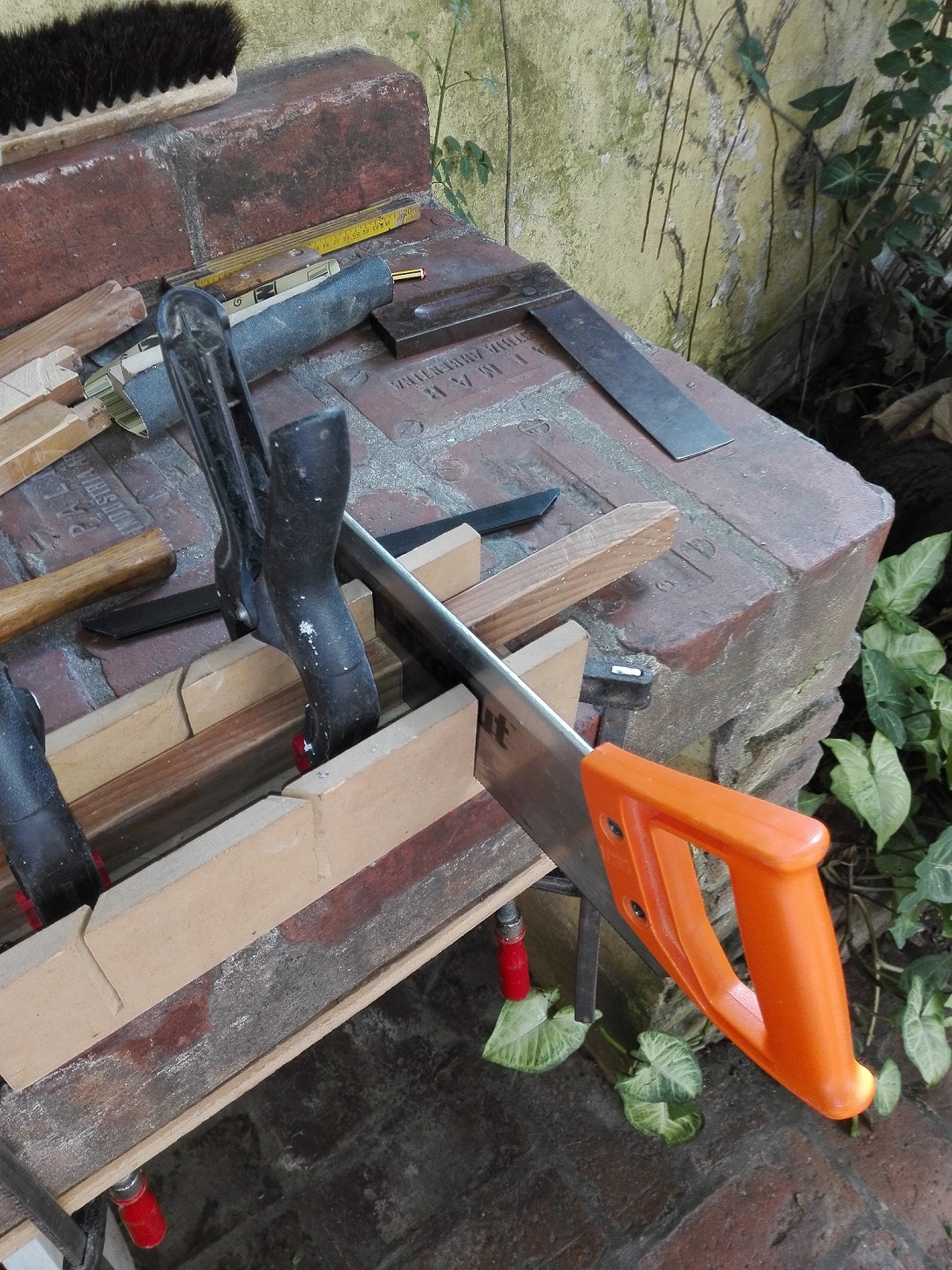

The crosshead of the upper compartment is finished. The reduction of resonance is remarkable when compared to the central compartment (simple test, striking the knuckles)
The cut at 45 degrees with the miter is simple, but calculate the exact distance not so much ....
The old trick of the thread has worked again, remember not to tighten the same, just enough to keep it horizontal.

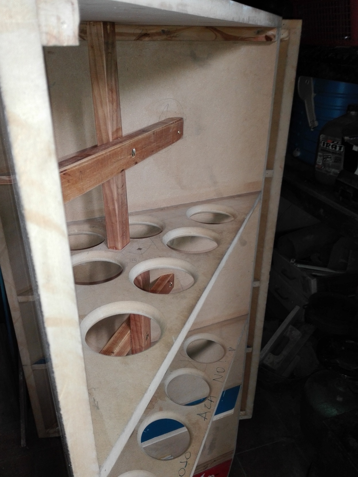

The reinforcements of the middle and upper sector are ready....
