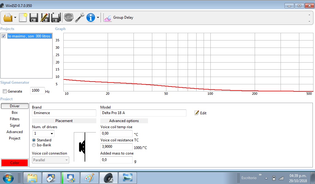

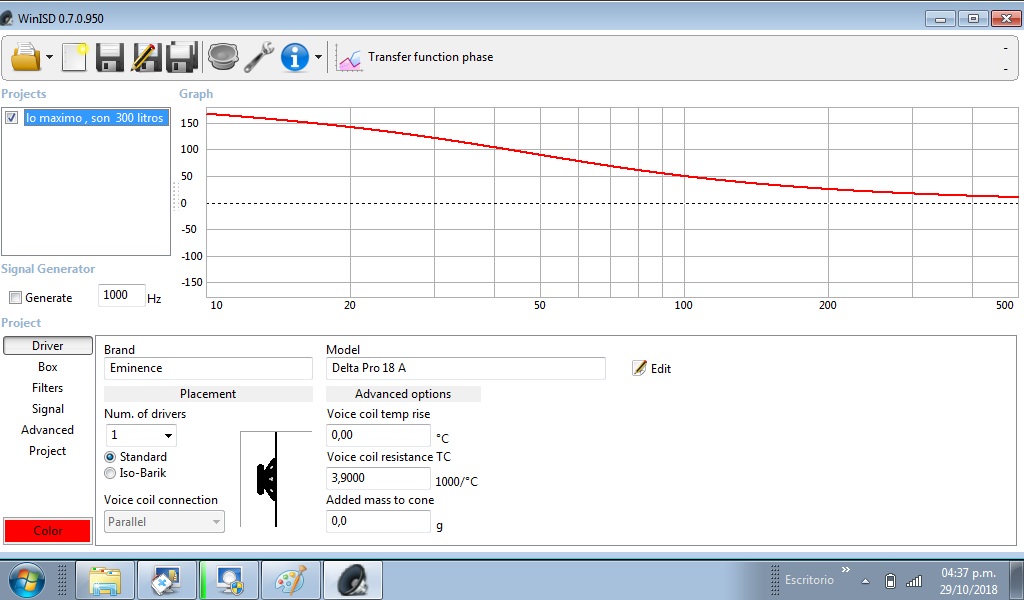

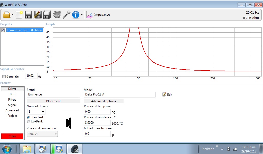

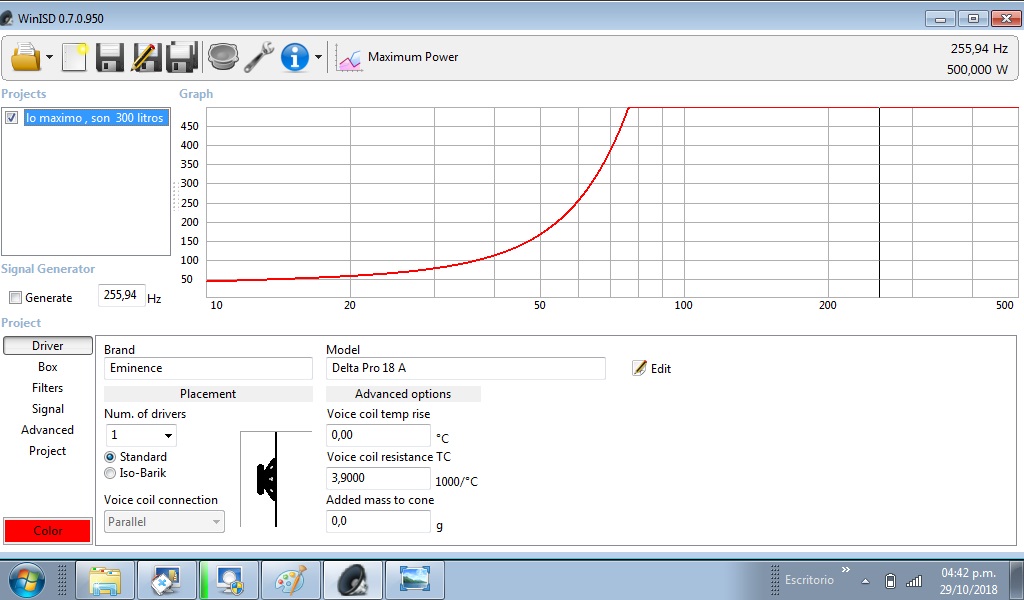

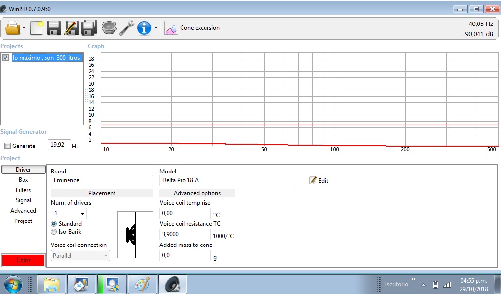

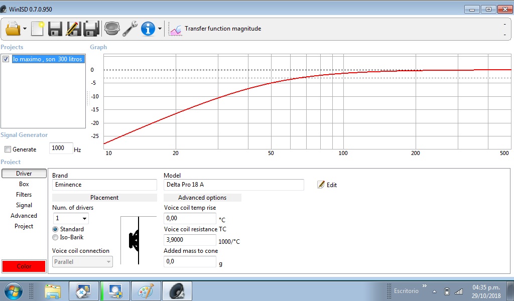

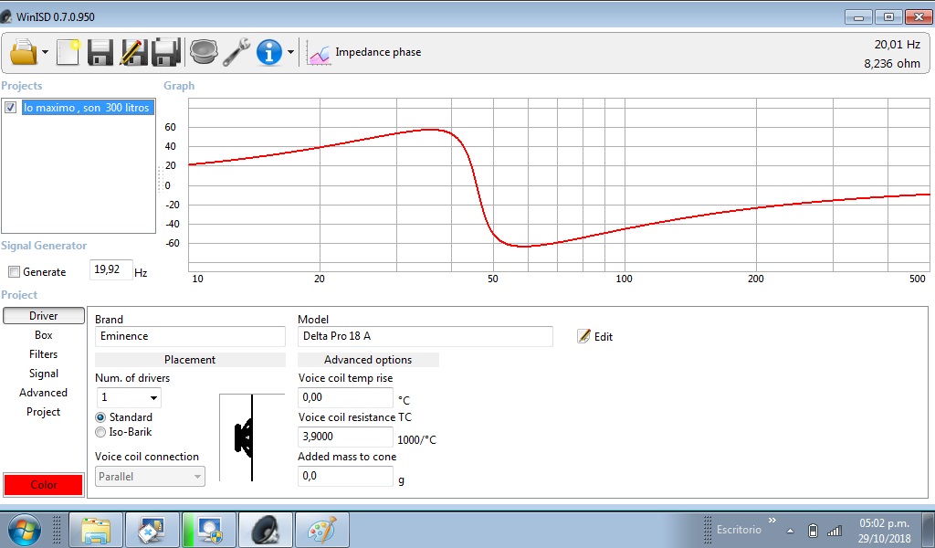

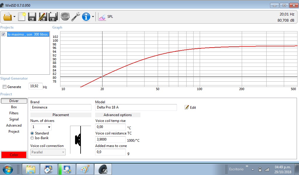

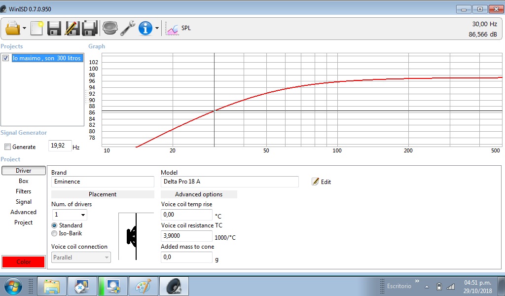

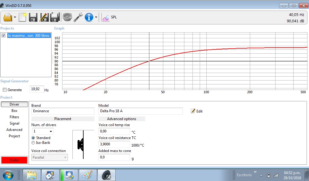

Here the simulations
I have attached SPL to 20, 30 and 40 hertz which is the range that I am most interested in reproducing with these boxes, remember that there will be room gain because they are located in corners of the room and are two cabinets, so we will have to add a minimum ( FWIW ) of + 3 DB to each graph of SPL in practice.

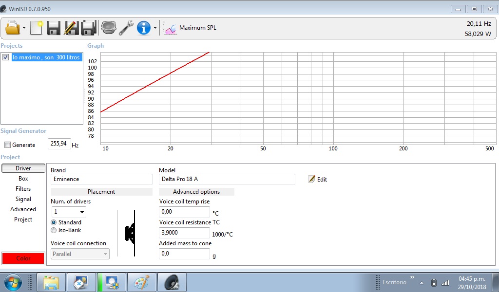

....the last, power management.
Power management was repeated, the missing graph is this :
Maximum SPL
I'm sorry

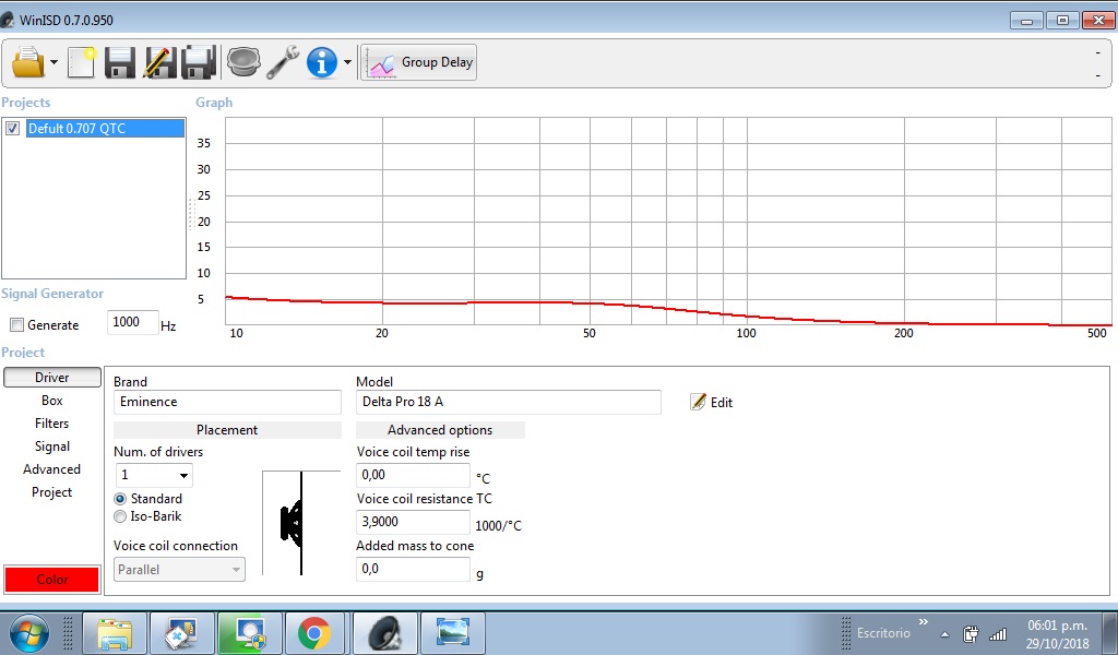

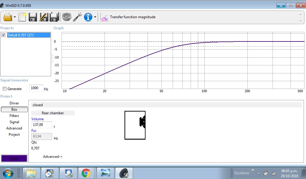

Why does the group delay increase as the volume of the box increases? Is it closer to the behavior of a BR box? Is that ?
Compare 137 liters ( Q 0.707 ) with 300 liters ( Q 0.550)
Someone can shed some light on this ?

Win Isd does not reach 2 mm (the red flat top line is 6.70 mm, driver spec)
I'm struck by that.
There can not be the possibility of having entered incorrect data?
Or that Xlim (15 mm) has been put in place of Xmax (6.70 mm) ?
Because that tremendous peak in the displacement of the cone? (red line) and blue line 8 mm flat between 10 and 40 hertz?
That is the effect of the condenser?

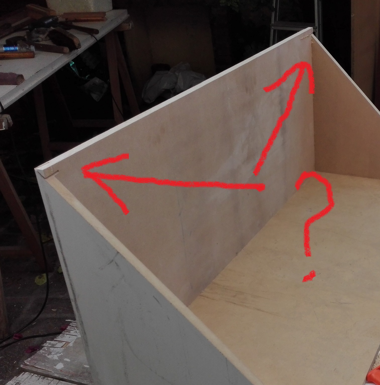

I'm thinking about the sharp angle of the triangle ....... this will force me to place the speaker terminals on one of the sides .... hummm and if I turn the triangle into a prism just by adding a small face in that place ? Let's say about four inches (10 cm), there will be not a loss of internal volume too significant ....
Or maybe (it would be less work) to place the terminals in the lower triangle (base) facing the floor, for this I would have to place three feet raising the cabinet an inch approximately .....
But I should throw myself on the floor whenever I want to connect or disconnect the speakers ......
But on the other hand, the corners where they are housed are already defined, it will not be something to do too many times ......
Any suggestions ?

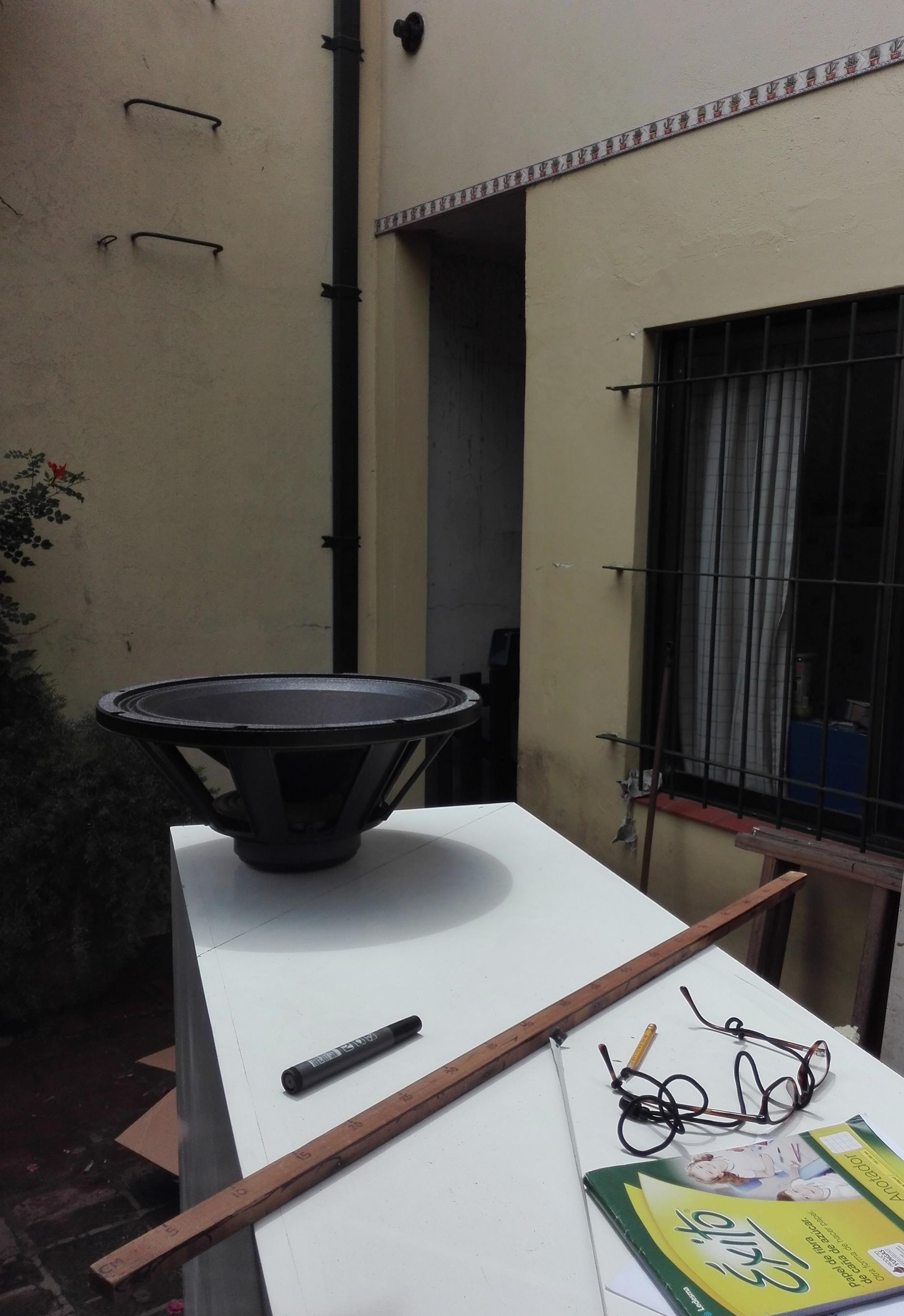

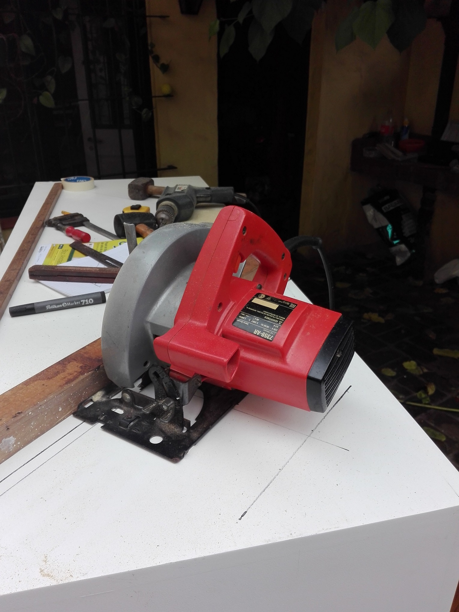

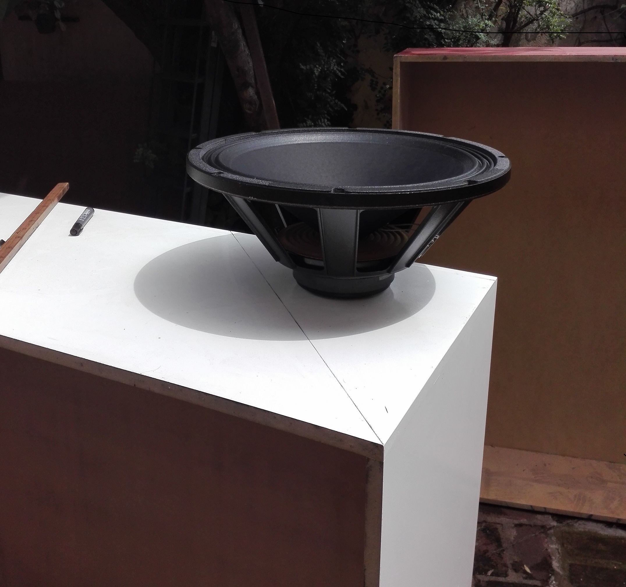

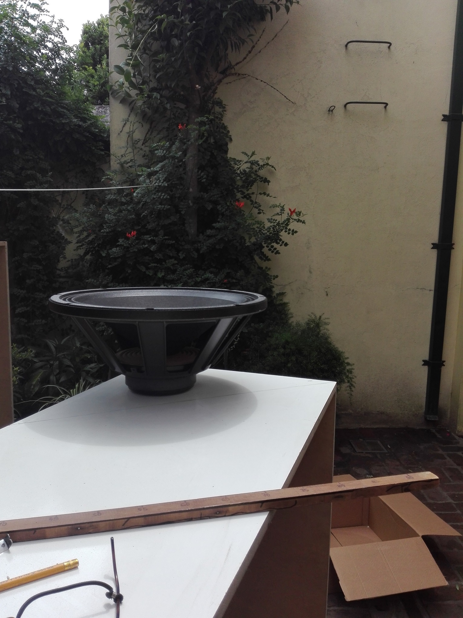

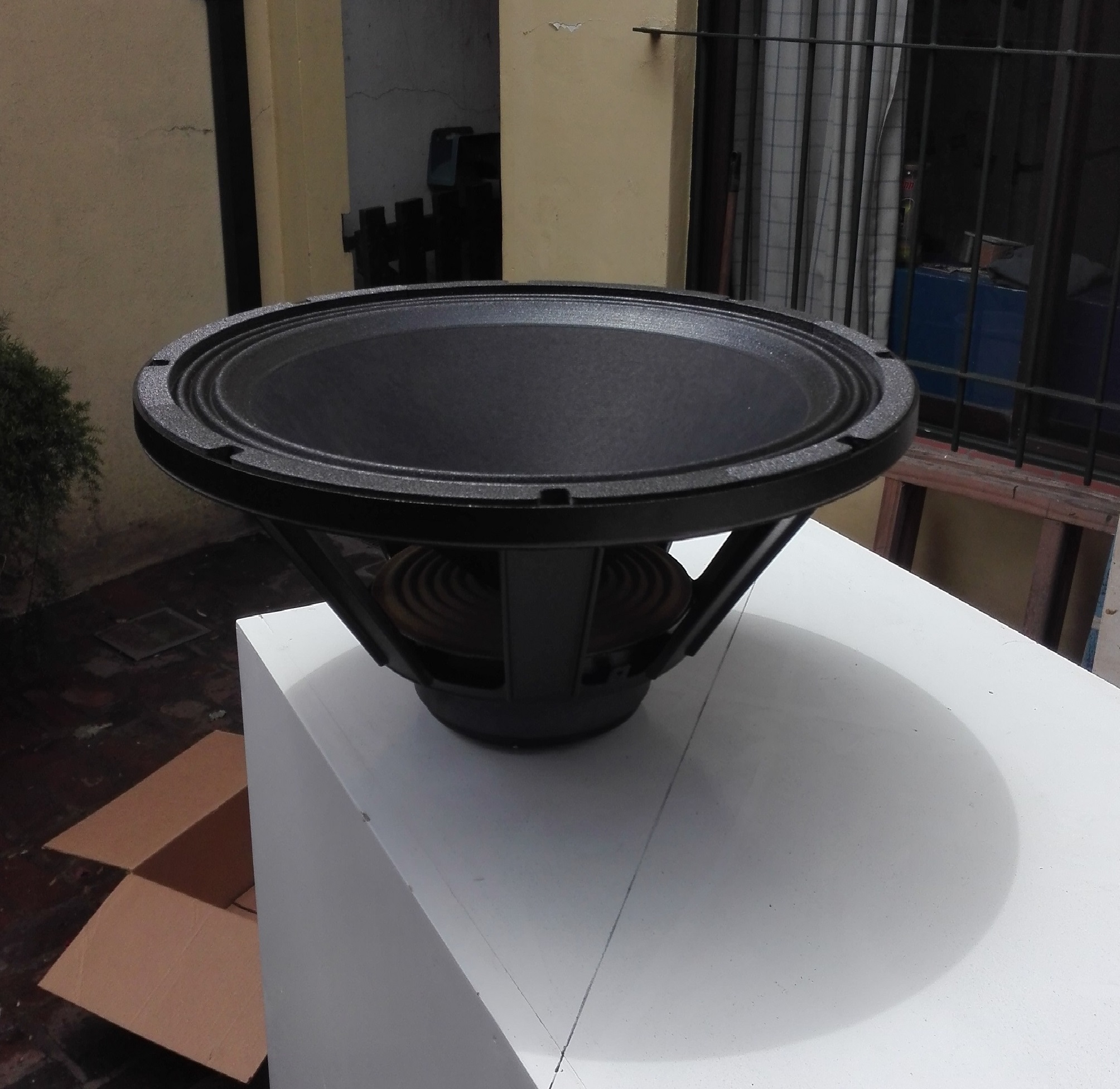

More pics !

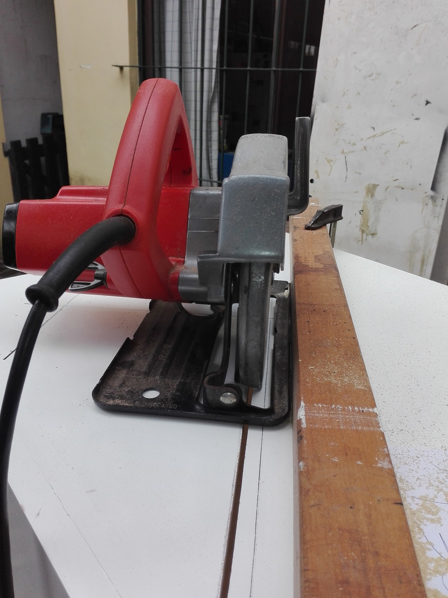

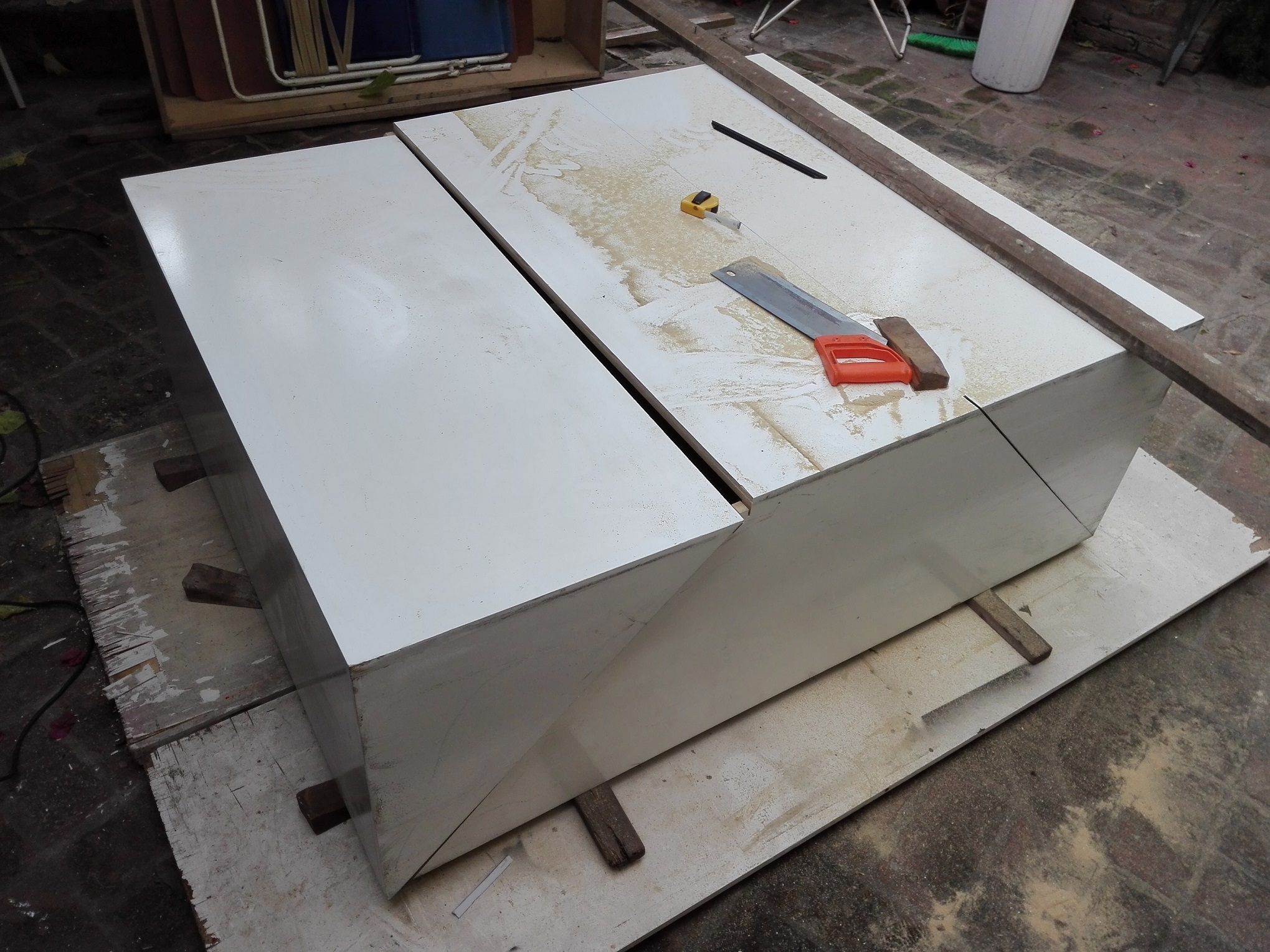

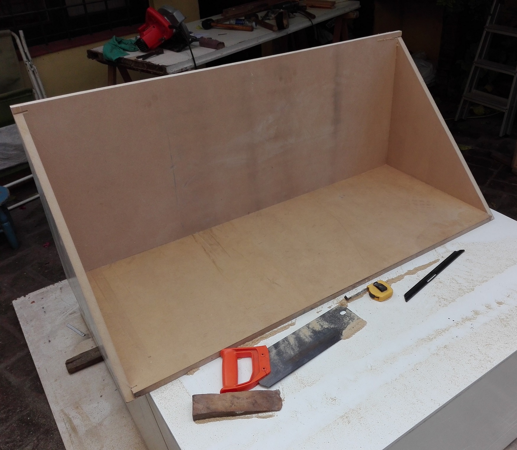

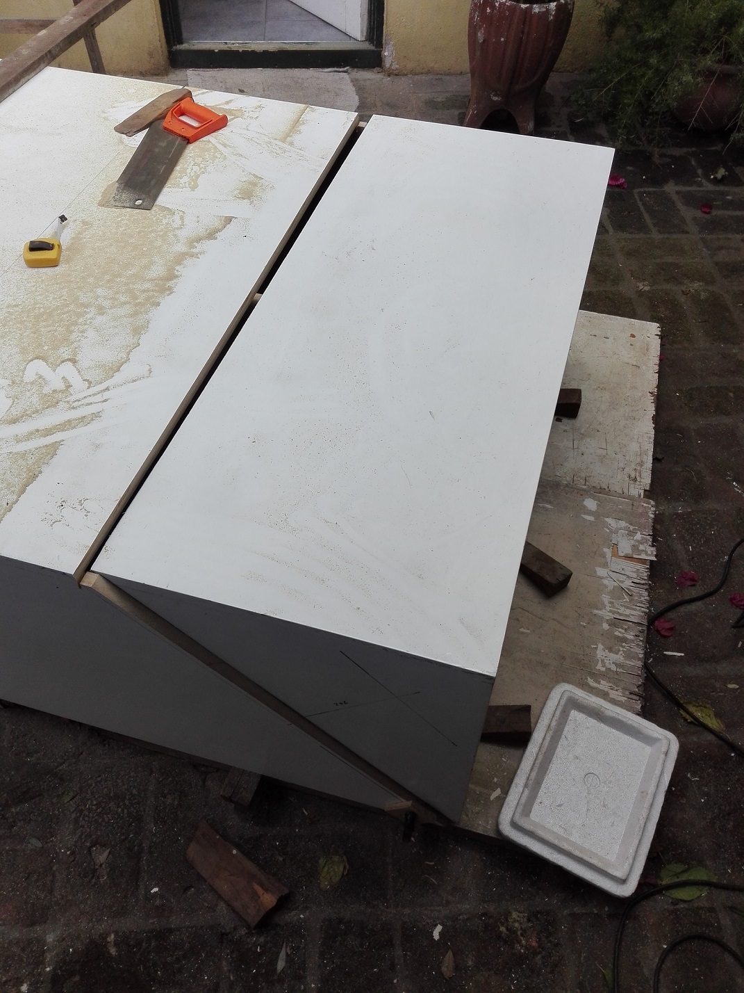

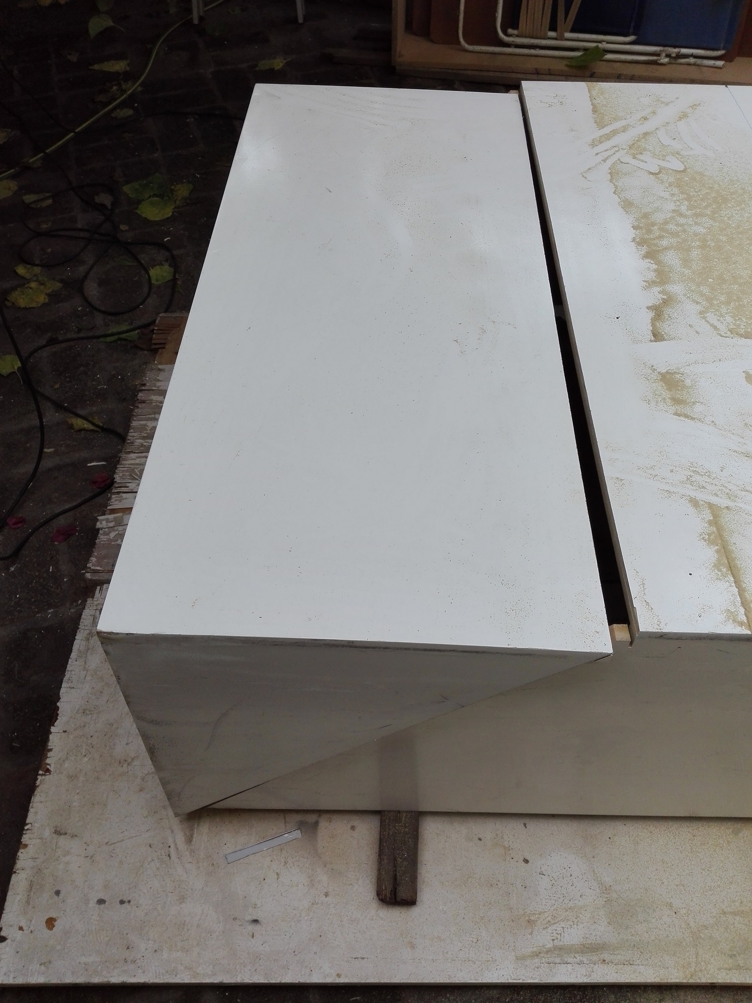

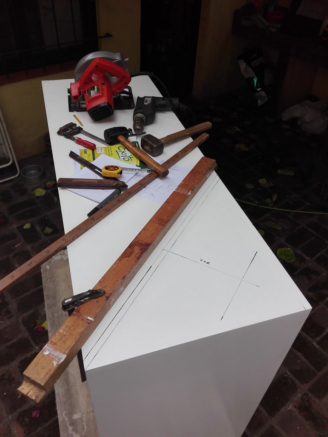

Another point to solve ...
I must finish these edges at the proper angle to join with the front panel (baffle)
I will try to use the hand saw again, placing a guide again and looking for the appropriate angle inclined the adjustable disk, I think it will work. I do not need great precision here, all the defects for poor adjustments will be covered with putty and then the cabinet will be sanded and painted.
The strength is assured, everything will go with screws and glue, and there will be two reinforcements for each cabinet.
WAF looks at me and thinks "every time is more crazy"
But the good thing is that he thinks it with a smile of tenderness on his face ....

Cut the panels close with the handsaw but leave a couple of mm. Then place a flat piece of ply across the 2 sides and use a router to trim the panel accurately.
