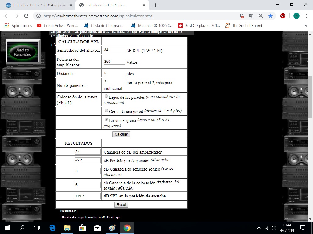

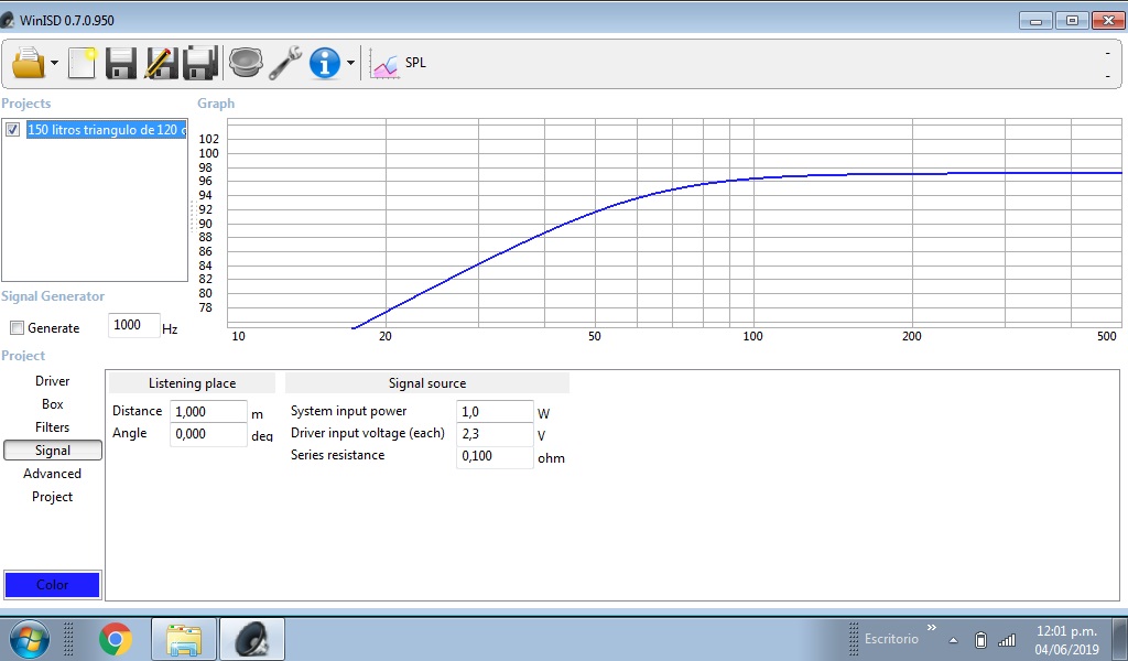

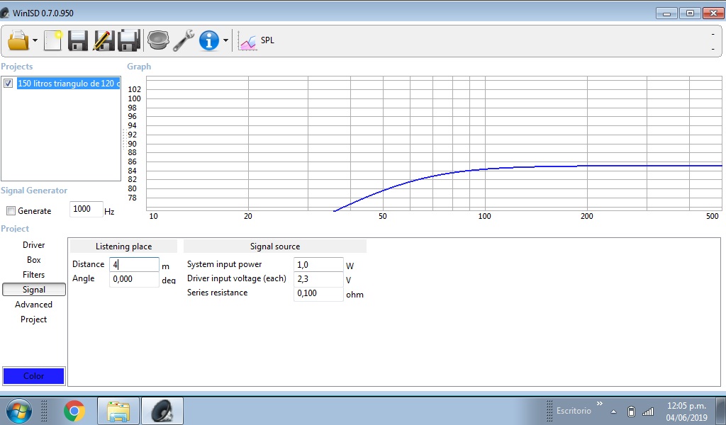

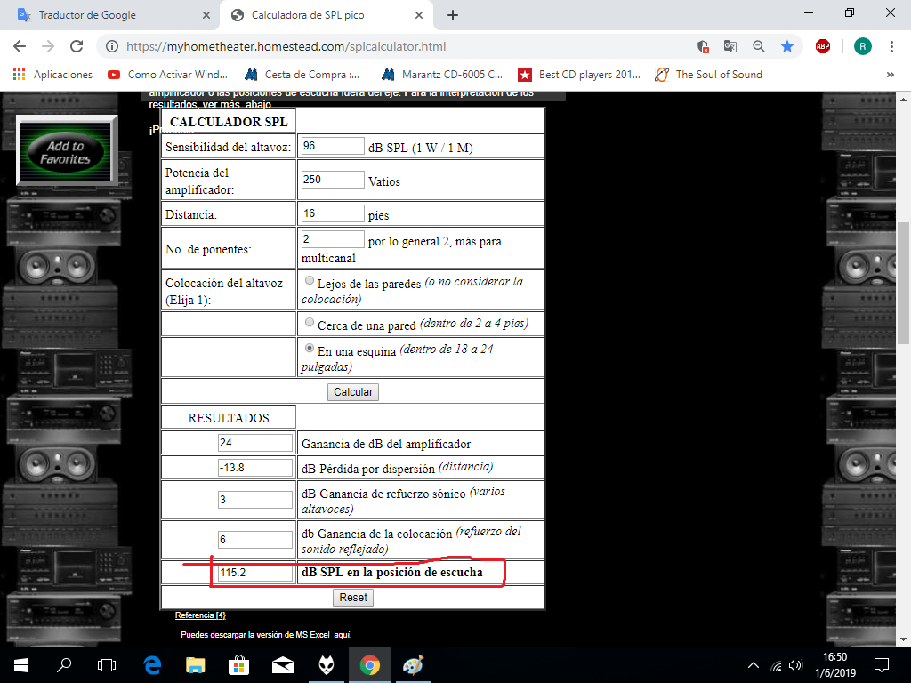

I found this SPL calculator.
After entering the data of this project, the result is excellent, but a question arises here.
Within the values to be introduced, the sensitivity of the speaker refers to 1 W / 1m) but, and the gain or loss of the cabinet?
It is not the same a bass reflex, horn or sealed, correct ?
Thoughts ? 🙂

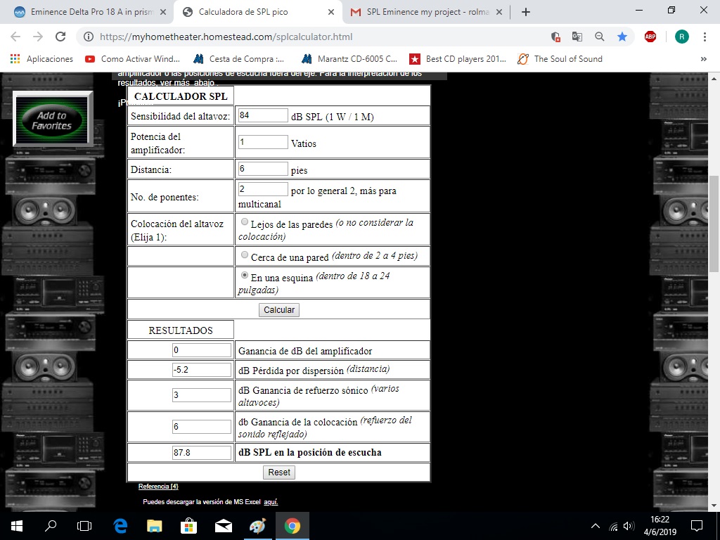

I think the writer of that tool expects this to be used for finished speakers with a flattish frequency response, thus one can expect there to be one sensitivity value that is a reasonable approximation of the whole speaker's response level.
Your project is a bit different in that you are accepting a loss in sensitivity as frequency decreases, so if I were you, I'd input whatever value corresponds to the expected sensitivity at the lowest frequency of interest rather than the nominal sensitivity which would only be relevant at higher frequencies. I thin that will be about 86dB for one speaker in your case.
HTH,
David.
HTH,
David.
Sure help, thanks ! 🙂
I will make the new calculations within the range I need, and upload them again.
I forgot the link, here goes :
Peak SPL Calculator

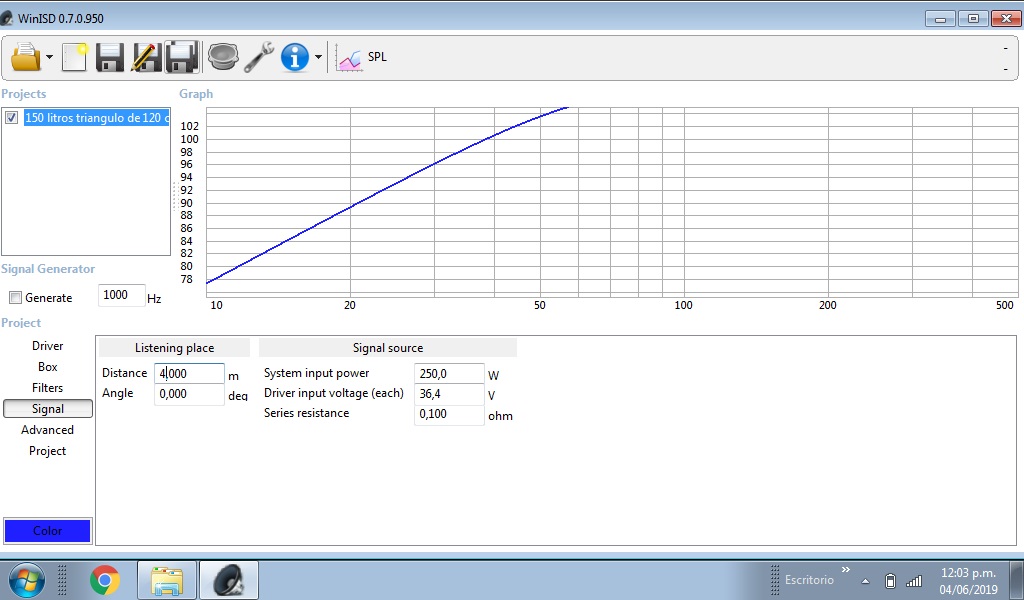

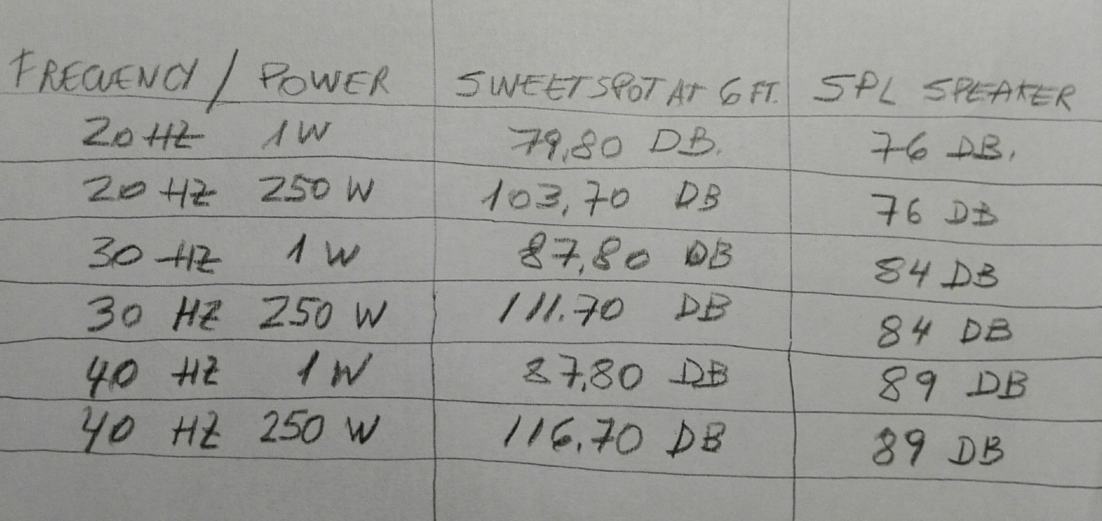

Well, here the final results, two subwoofers of 18 inches, sealed cabinets of 150 liters and located in two corners.
Listening point 6 feet (4 meters).

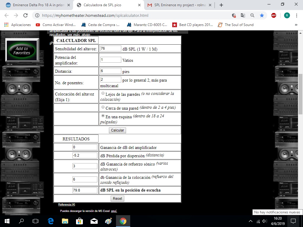

I have drawn a graph for a quick comparison of the SPL obtained at 20,30, and 40 hertz, with 1 Watt and 250 Watts ....
Please, read:

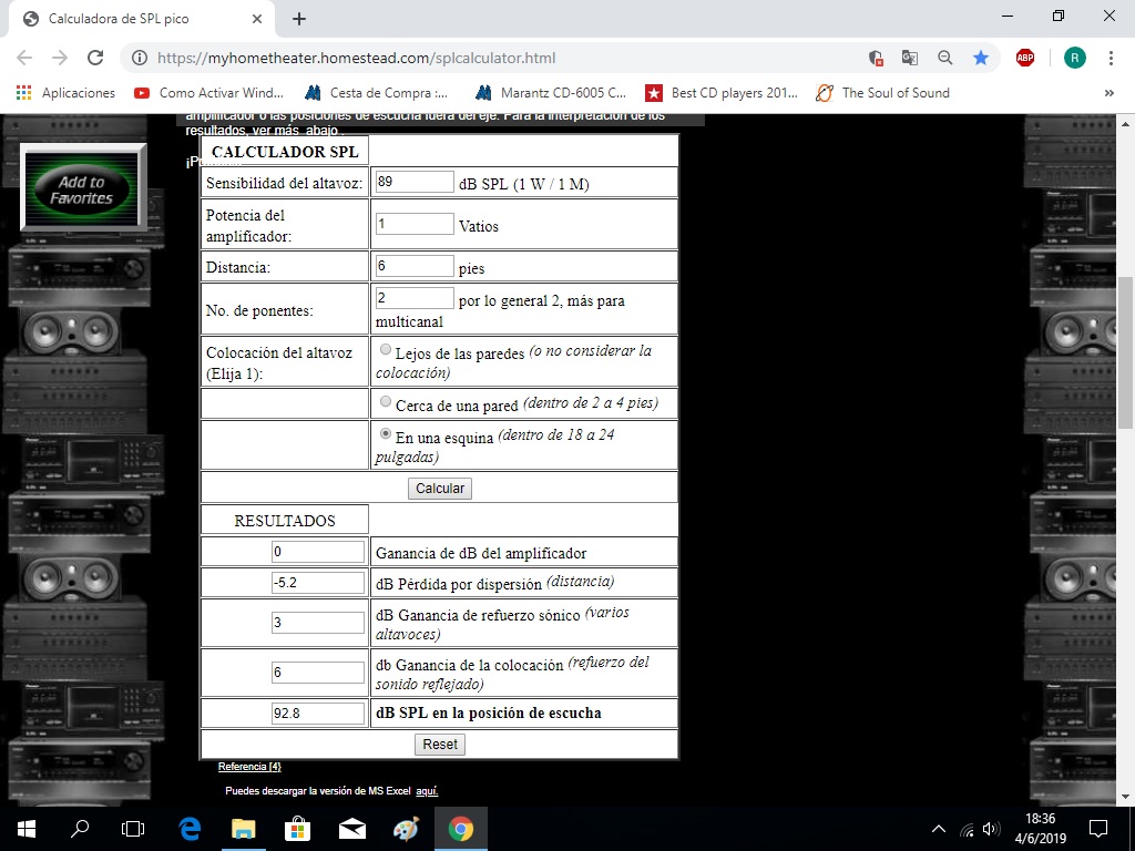

40 hz 1 Watt , 92.80 Db at 6 ft.
I'm sorry, there was an error in the graph ........... 😕

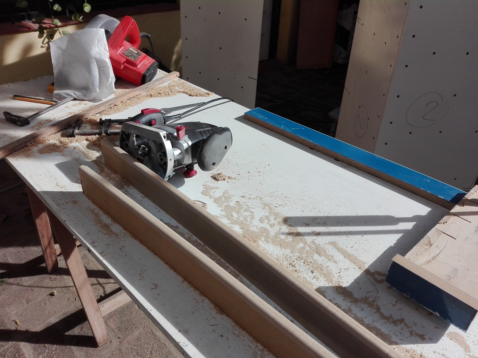

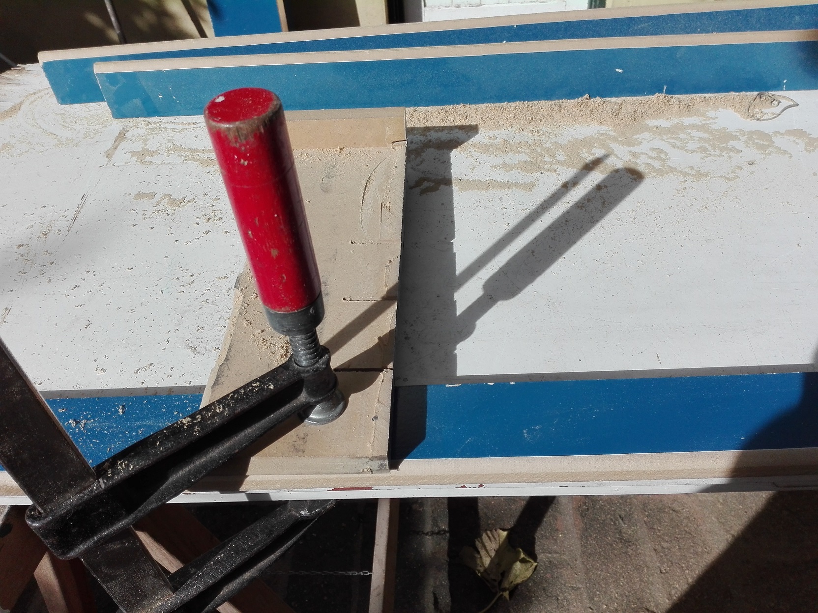

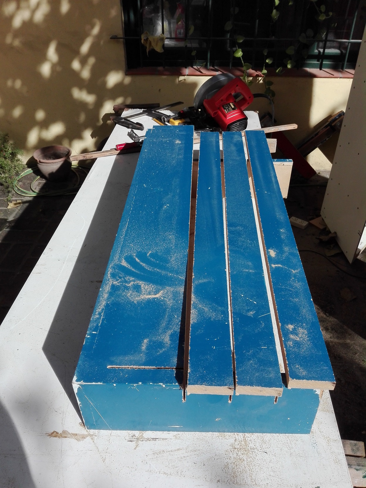

At last the sun has come back and today I advanced preparing the parts for the last reinforcement.
We had two simultaneous catastrophes, one is very well known here, it occurs minimally once a year, during a week followed by the city of Buenos Aires, fall on her the famous "sudestada", the sea wind coming from the south- east, works as a plug to the natural drainage of the Rio de la Plata, accompanied by copious rains and electrical storms, also raising the level of the river flooding the surrounding coasts .....
But the most worrying was to cope with this natural climatic phenomenon, accompanied by another unprecedented event, a tremendous blackout of electric power (never seen here, remember when something similar happened that affected the USA and Canada?).
So this time I have a good excuse for the people here who are asking me to hurry up the work!
How do you expect me to work under these conditions ? 😱

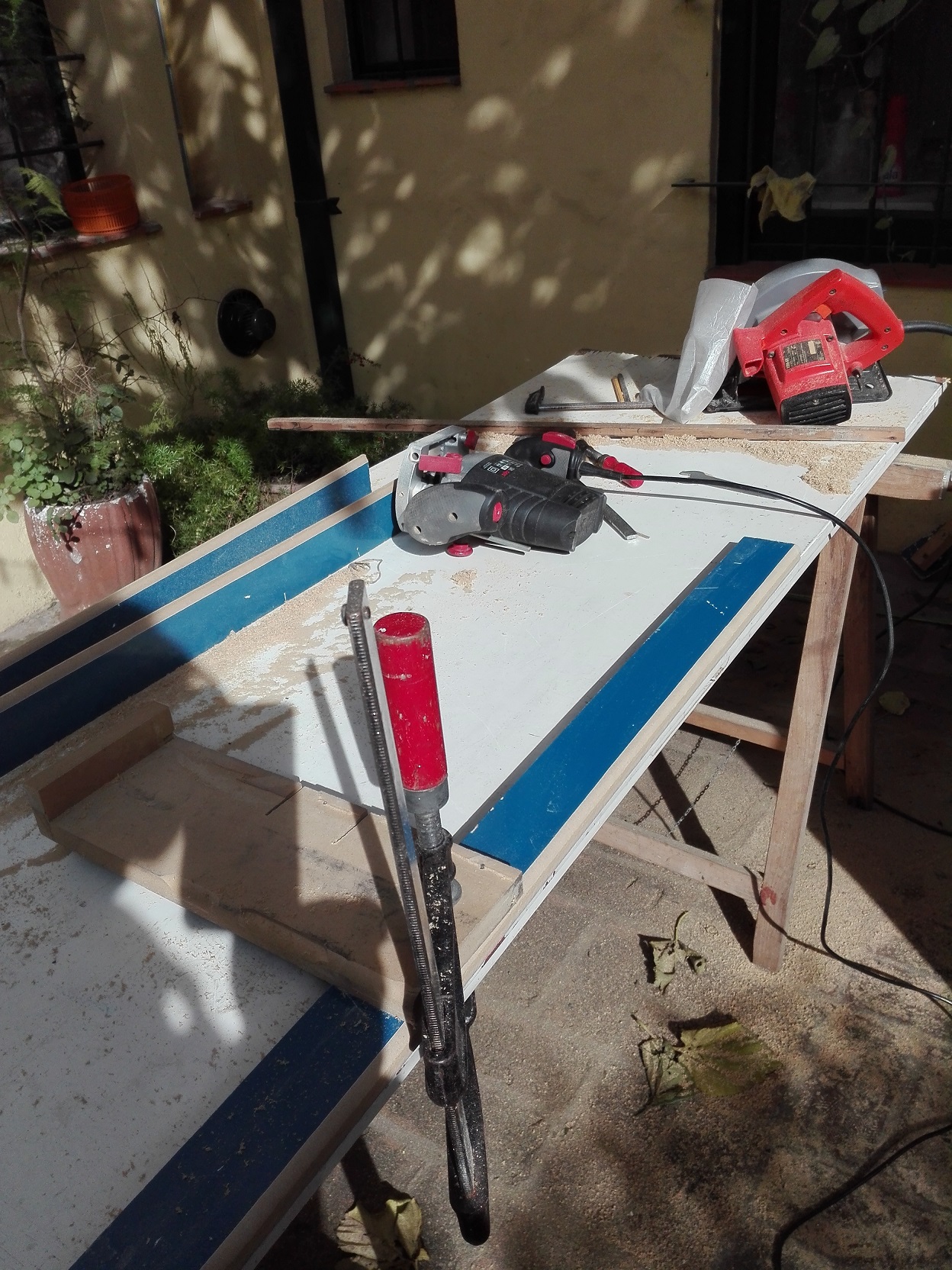

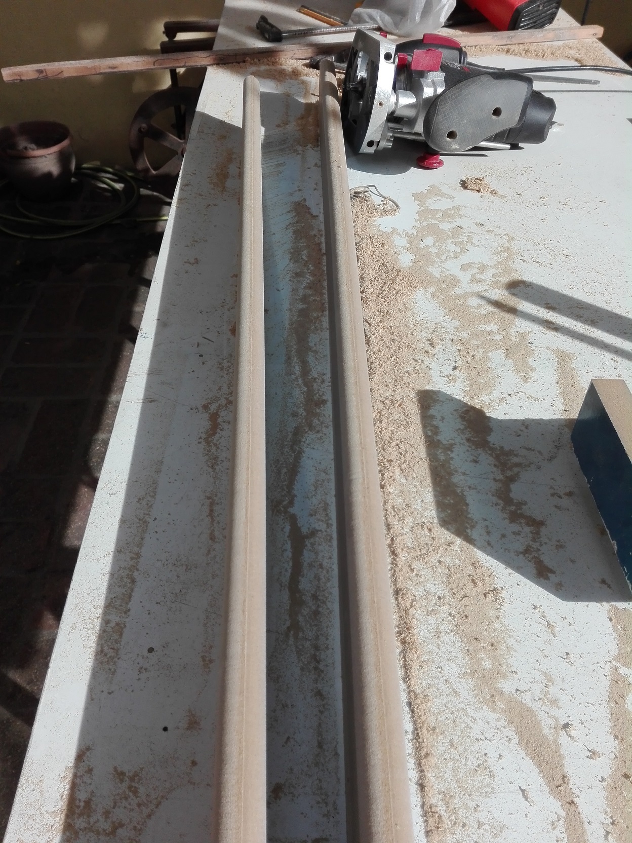

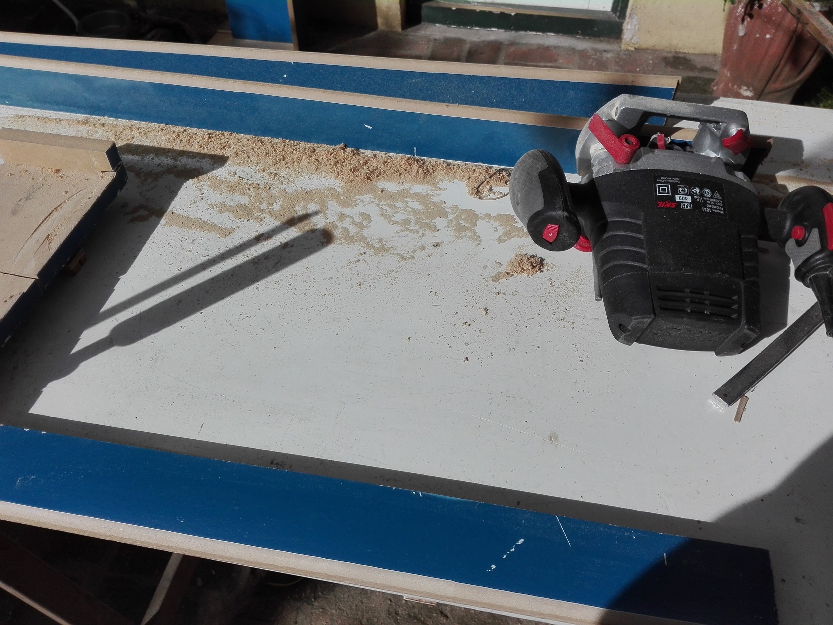

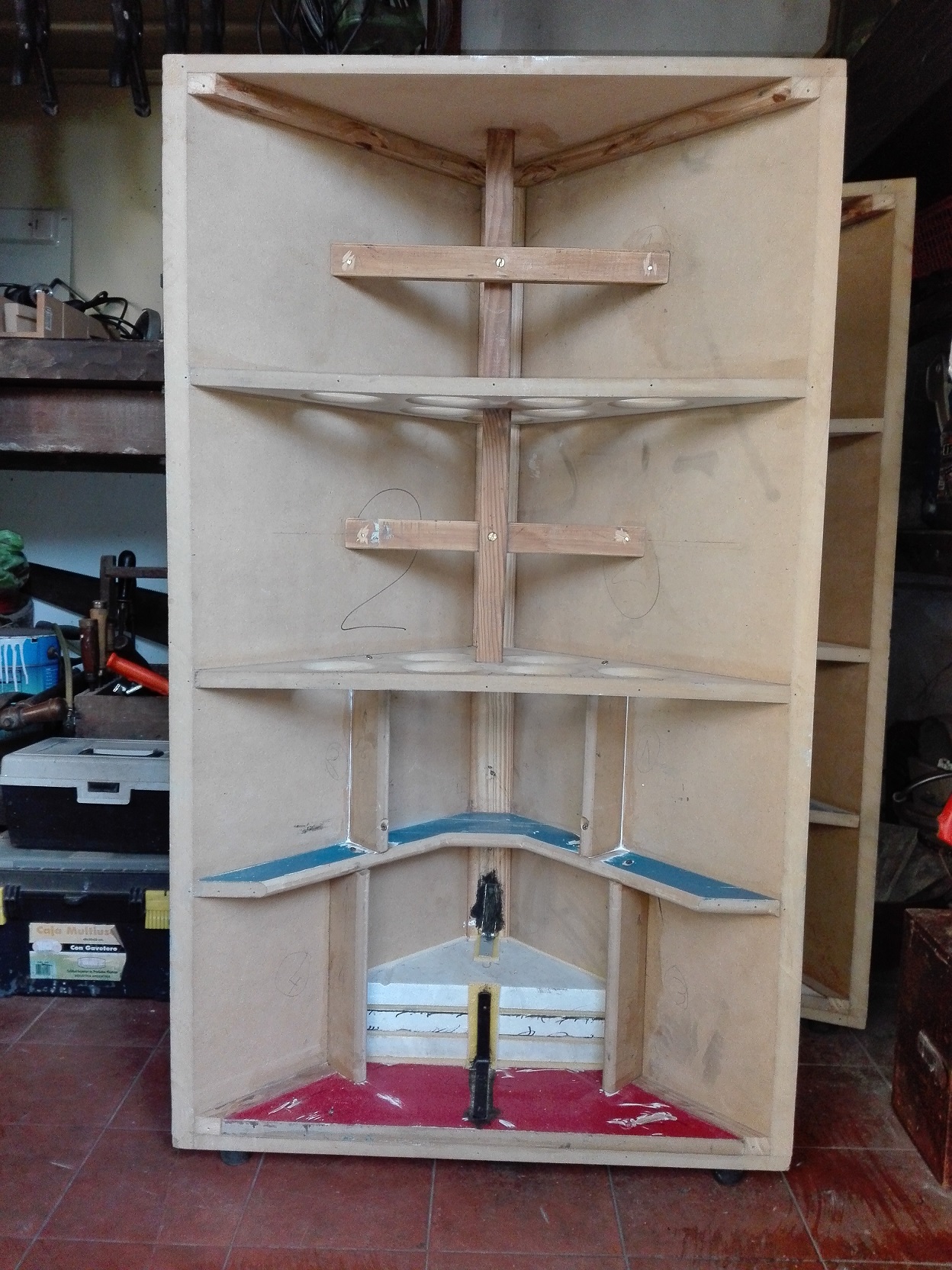

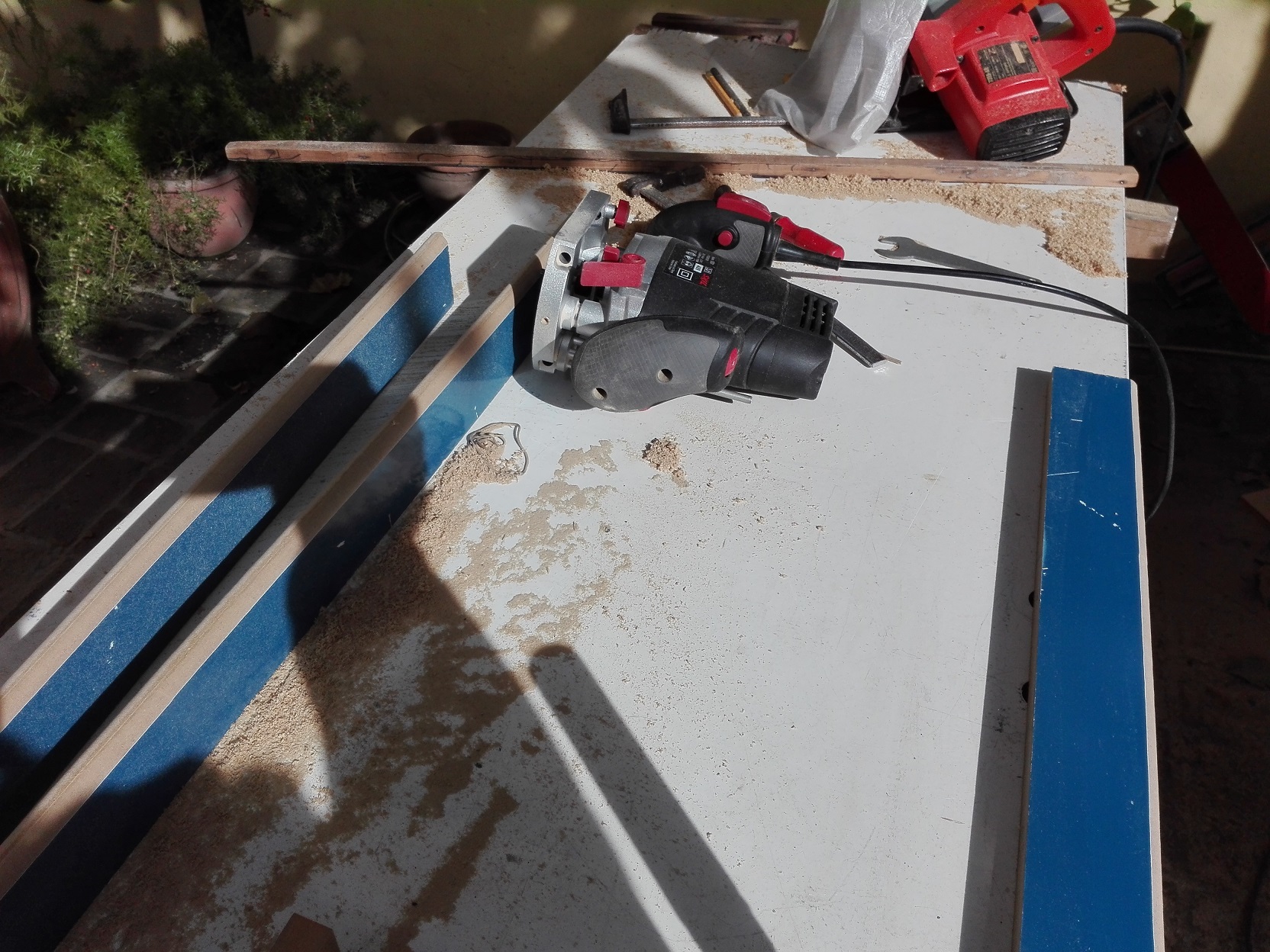

I have finished the last reinforcements in the interior area of the cabinet.
I was thinking that placing the speaker on the outside of the baffle panel will help to compensate a bit for the excess reinforcements. Anyway, a lot of stuffing will return things to their place, the big question is:
How much exactly? I think I remember an article about how to calculate it, but I'll have to dig into " Markers " of Win .....
If someone provides a link, it will be very appreciated 🙂

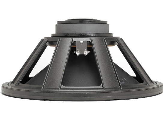

I have read something that woke me curious, many people prefer to leave the speaker compartment free, without polyfill there.
What would happen if I do that and compensate for that with more compact filler in the middle and above ?
Is there any benefit ? The only thing I find is that the polyfill can interfere with the cone if I put stuffing down, which can be avoided by putting a net, etc., but I would prefer not to do that ....
This concern is because the basket of this speaker is quite open to be 18 inches !

Today in the morning I went to buy the filling material (polifyll) and in the afternoon I calculated the real volume (net) of the cabinet, that is, discounting everything that occupies space within the gross measurements of it.
The calculations are very encouraging, the final volume is very close to the statement in this post, and I can still increase the virtual volume.
