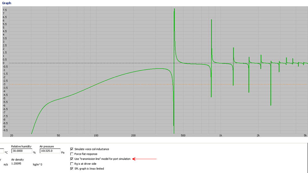

WinISD can't sim the 1/4 WL pipe action's impact on the driver's mid bass response.
Actually it can. Under the Advanced TAB you'll find that opton 😉

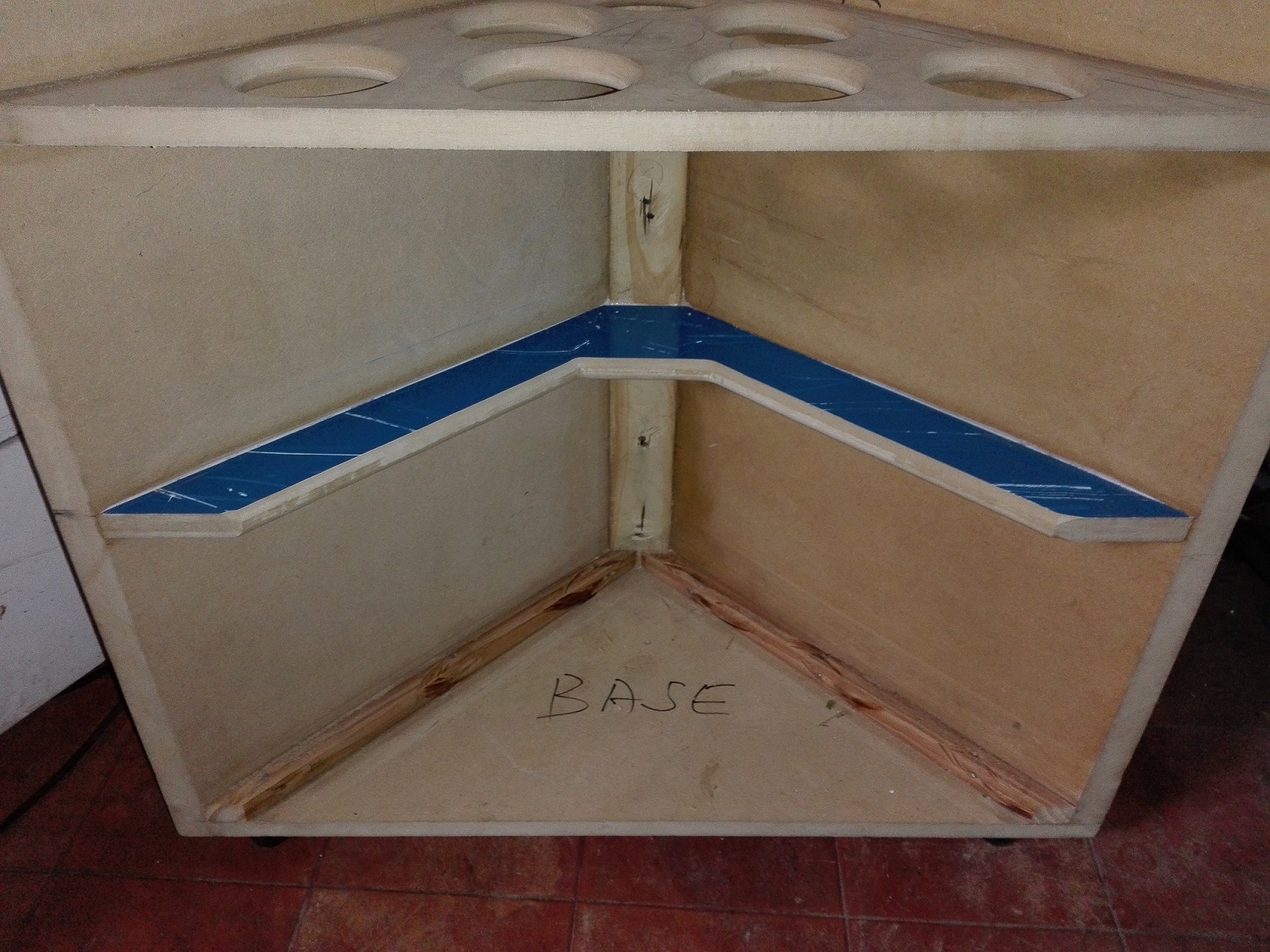

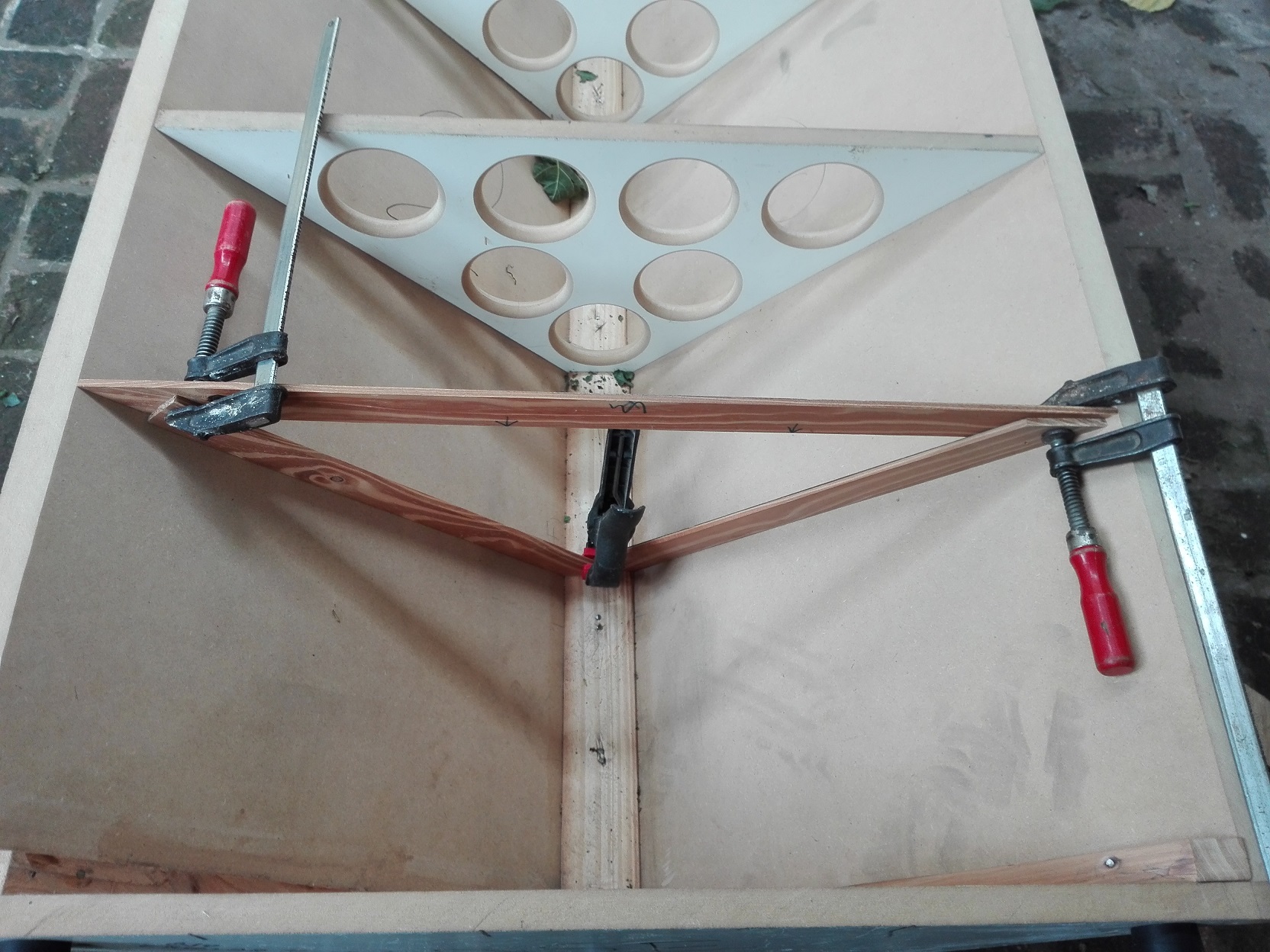

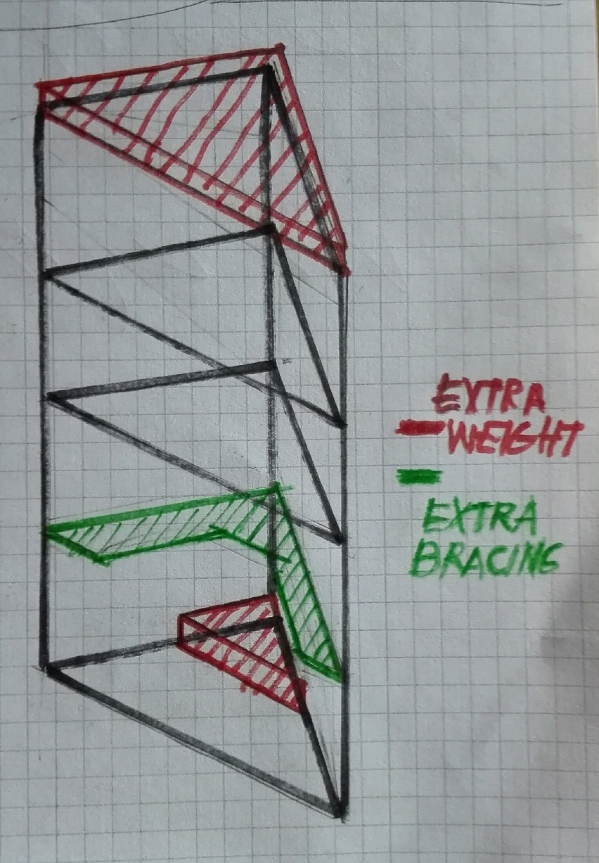

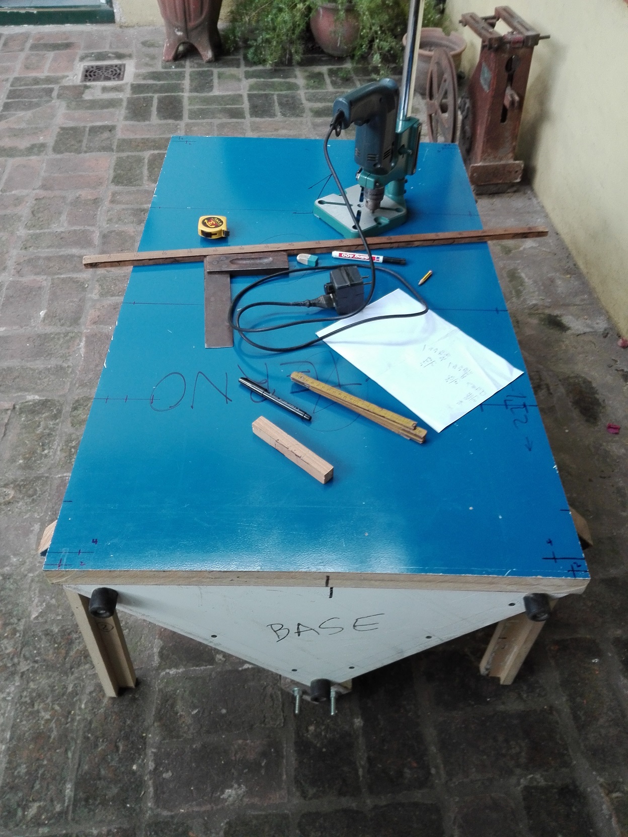

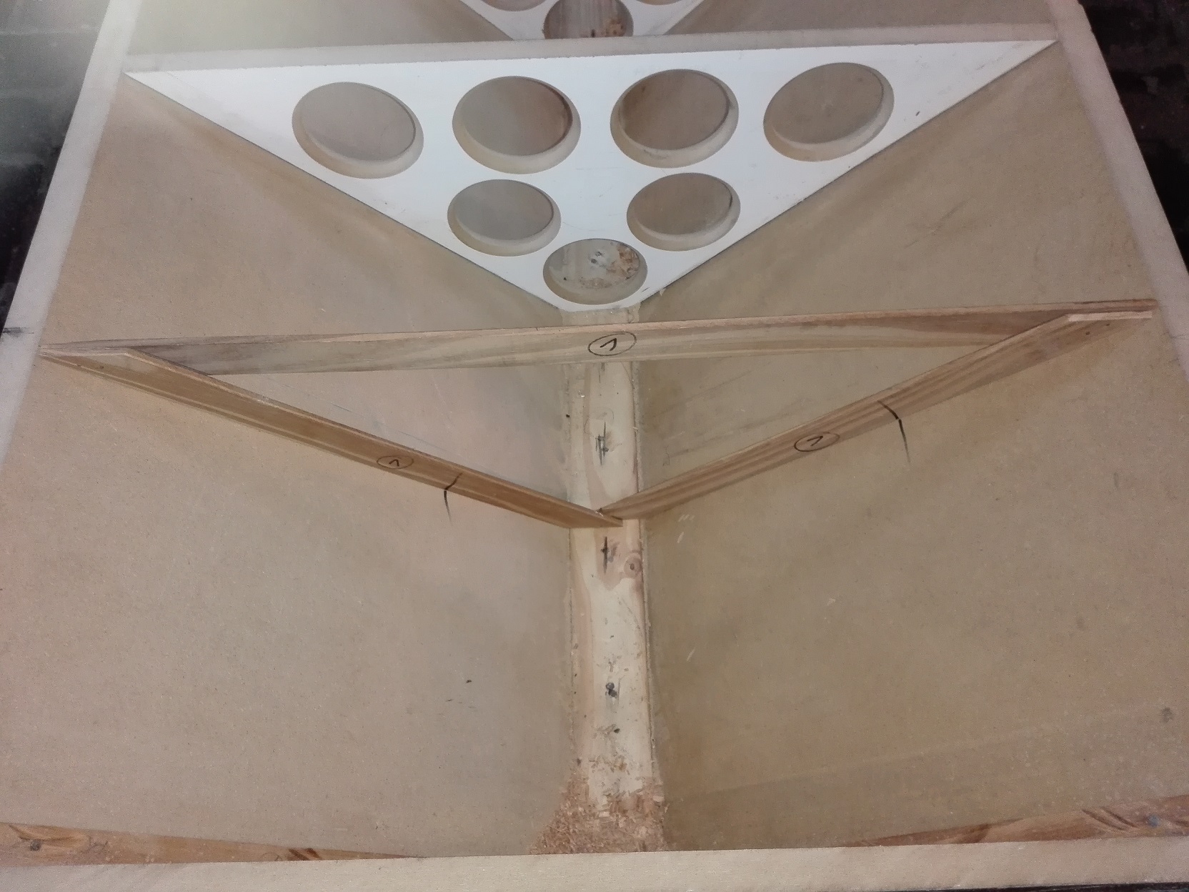

Reinforcements templates of the lower compartment. (green in the drawing)
I was thinking whether to lock the speaker back against the vertex to give greater strength to the whole ....🙂
(I read that somewhere here)

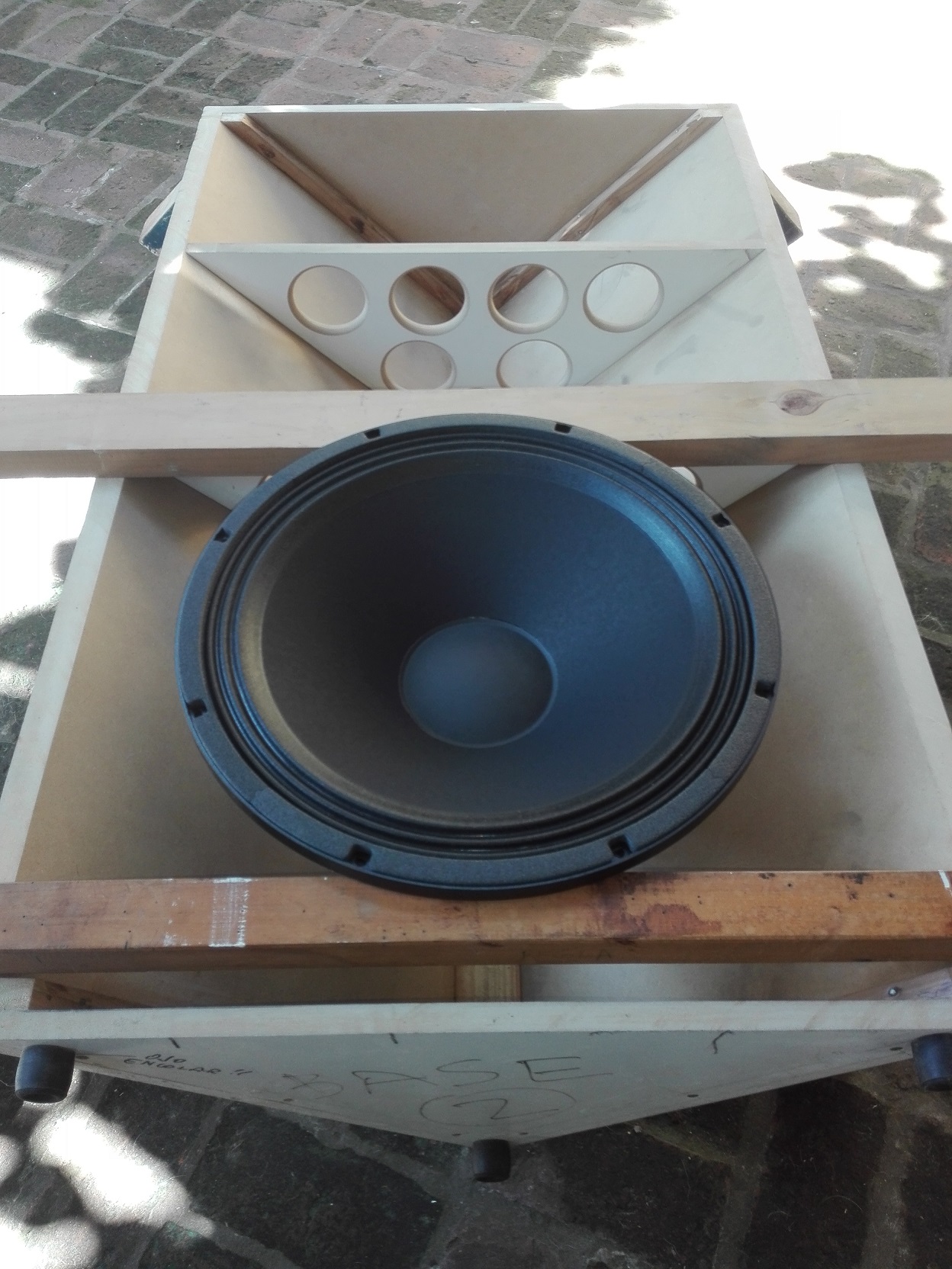

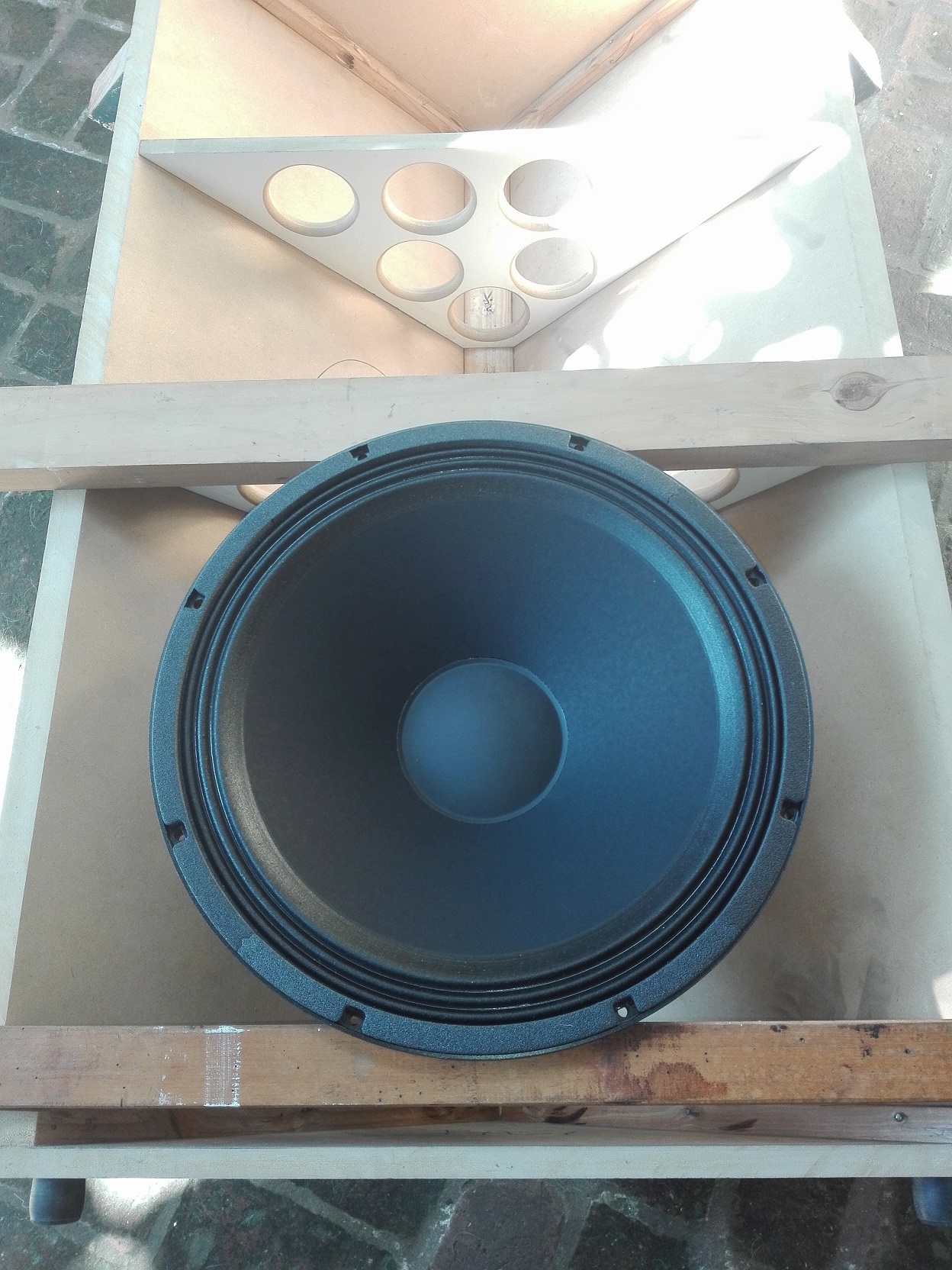

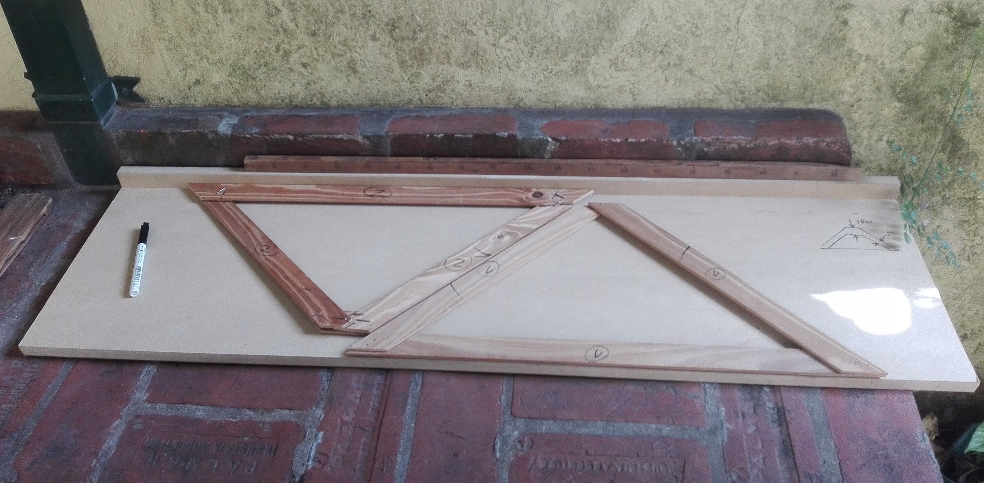

100 x 50 x 18 mm are the measurements, the big question is whether to place the reinforcement displaced from the midpoint so as not to obstruct the rear ventilation of the speaker and also not to form two panels of identical dimensions and resonances, or two reinforcements (above and below). under the engine) to achieve more strength ?
Can so much bracing´s be necessary? Is this audible ? 😕
Please help for me ...

Boxes, frames, etc., historically were clamped to sufficiently rigid/massive tables so that they could be twist tested, so in your case, once it can't be twisted at all, you're done........ except now there's still the issue of panel 'drumming' and for a 'sub' woofer one ideally needs it to 'ring like a bell', which when making it out of wood normally requires very rigid material [high MOE] + some bracing. FWIW, my test is to be able to stand an old square edged coin on end and have it not 'walk' or fall over when driven at high power in the LF. Takes quite a bit of 2x4 bracing 'skinned' with 3/4" marine grade no void plywood for dual low Xmax 15" in ~30 ft^3 and why I built them like a small house.
GM
Ideally you break it up into odd order [3rds, 5ths, etc.], and areas at golden or acoustic ratios if triangular; whereas when in parallel, just have to space them apart at golden or acoustic ratios.

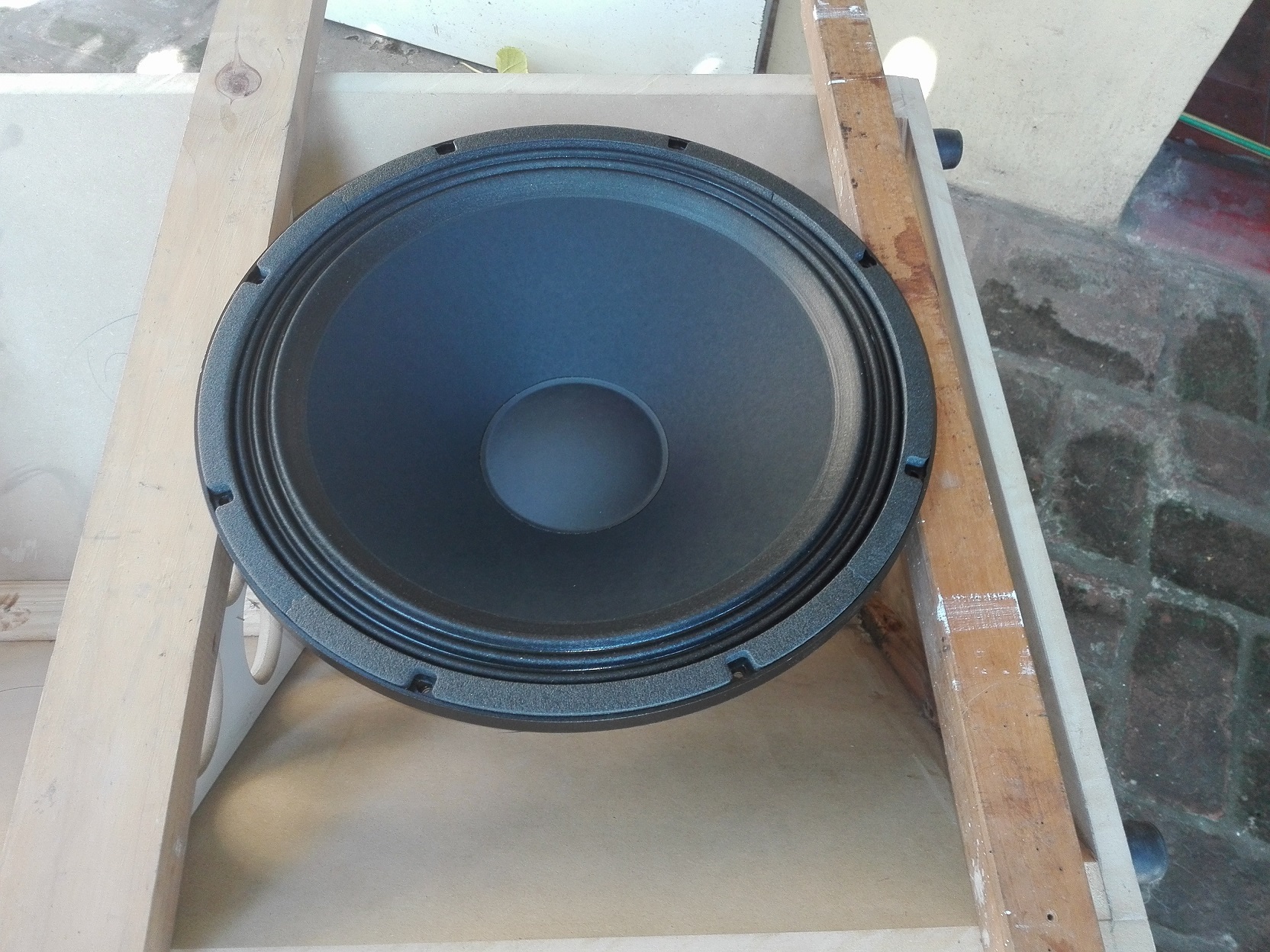

As I mentioned earlier, best to have good vertical airflow and a motor brace. Said brace should be clamped to both add rigidity and tie the driver to the cab, i.e. make it a key component of the cab's bracing. Here's a common way [slight gap filled with felt or similar such that when the driver is torqued down, it provides just enough pressure to preload the driver without bending/cracking the driver mounting flange: http://www.frugal-phile.com/boxlib/GM-A10-MLTL.pdf
GM
GM, you have convinced me. The plan of your link attached is very clear about it. Then I will do two bracing for each speaker making a stop with the engine.
The bracings in a horizontal sense will remain this way for practical reasons, they are already installed and I want to listen to these subwofers this year!
But maybe I can play with the filling to favor air displacement in the vertical direction, I thought about filling the base compartment making it very compact, less pressure in the middle and uncompressed (only loose) in the upper compartment.
I think that can help, although it is impossible to calculate. If in total I get a virtual increase of ~ 20% I think I'll be fine ...
Thank you !

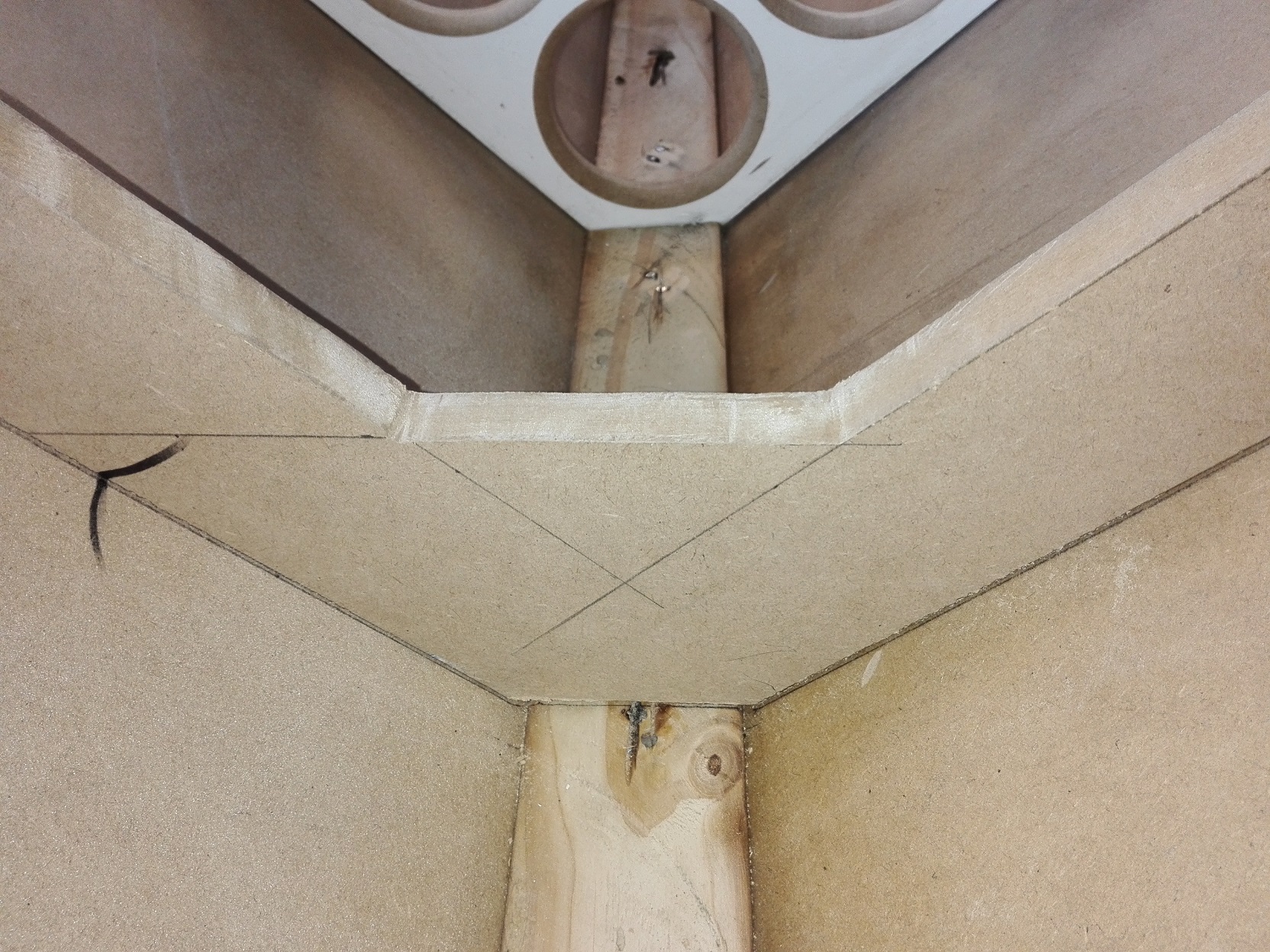

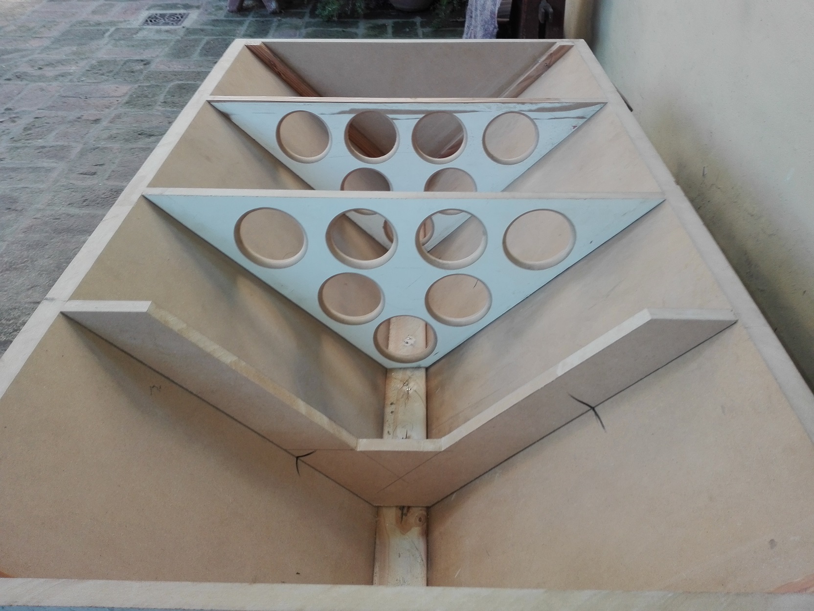

I was calculating the two reinforcements to lock the speaker against the posterior vertex .....
I mention two because in that way the ventilation space of the motor would be free.
Of course I could also do it with a single reinforcement, in the center and make a cut in it so as not to obstruct the speaker's vent.
But ... will I get a really audible result with so much extra work?
Decidedly my answer and decision is: NO 😱
So General Motors ( GM) this time will have to leave the tip to Ford Motor Company ( FMC) and accept their defeat.....😀 😉
I built a single reinforcement for each cabinet, lightly displaced from the center, with enough space to not obstruct the vent, and a marble plate on the entire surface of the base will give a solid settlement against the floor, achieving a better coupling with the floor and therefore a greater room gain to be really 2 pi.

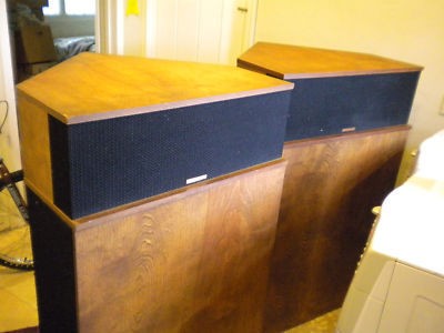

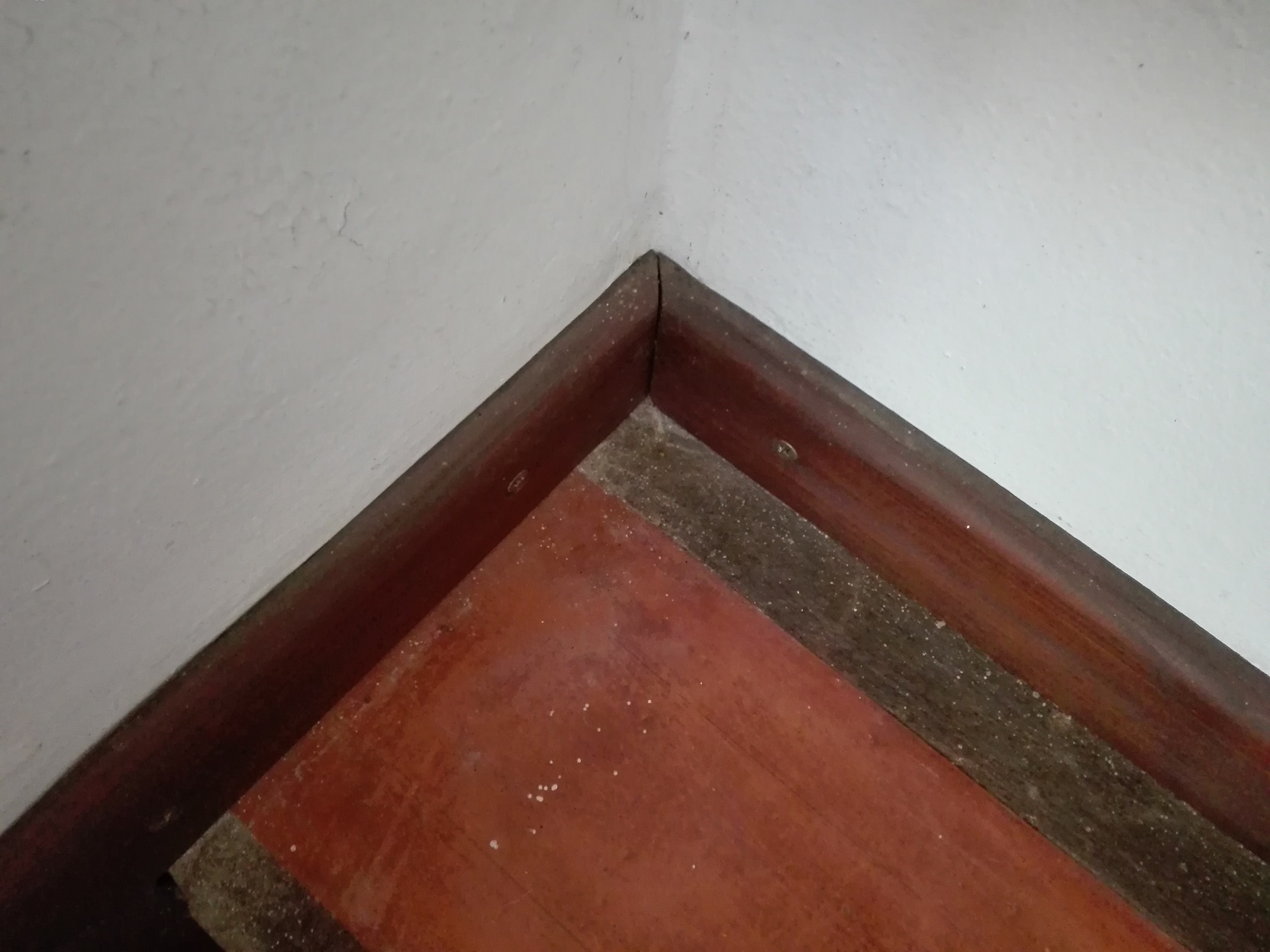

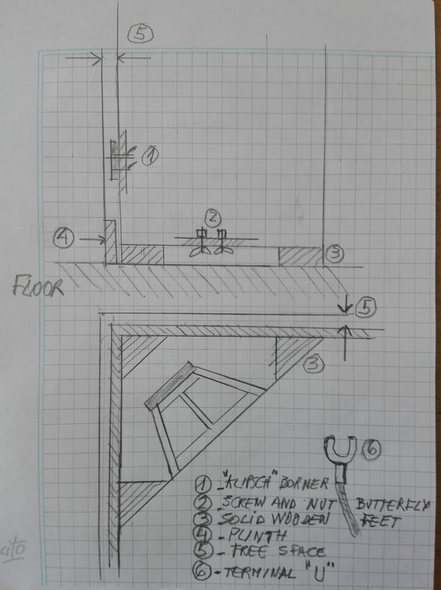

Oh ......... but ... 😕 and how will I locate the connection terminals? I thought to do it in the space between the feet and the bottom panel ....

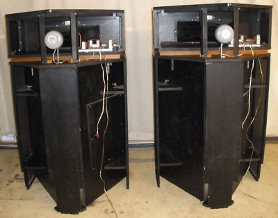

How is this usually done in the corner cabinets? (like the famous Klipschorn) Can someone give me information about it ? 😱

The reinforcement is already glued and screwed...:up:
It is an irreversible fact. 😎
100 x 60 (increase the width here) x 18 mm thick.

re: Klipschorn's basshorn terminals - it used a two screw barrier block as such with two screws (top ones) which ran though the side-wall from the inside. Ring terminals were used to connect wires to the woofer

That bridge of connections is easily available here...
From what I can see in these pictures the shape of the Klipschorn cabinet has ample space so that the connection bridge is far from the wall.
Not my case, although moving a little away from the wall cabinet would be the matter solved.

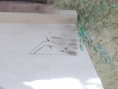

But I am thinking about placing three solid feet of wood, and in this way making the connection with screws / wing nuts, and "U" connectors.
That way the connection could be easy without using screwdrivers and could bring the cabinet to the maximum against the lower base of the wall.
I leave a sketch so that it is understood.
Also first I must put the front panel, make the hole for the speaker, etc.

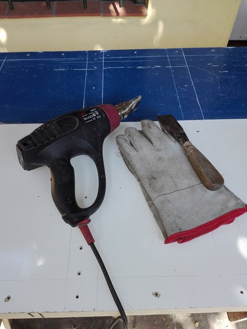

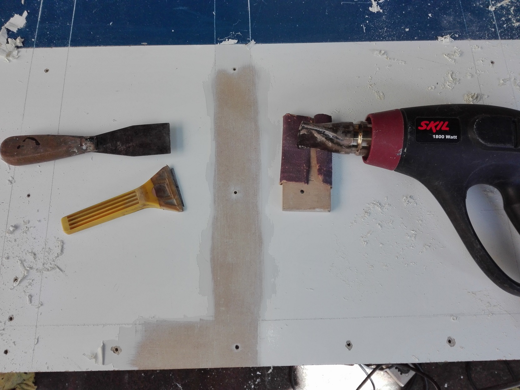

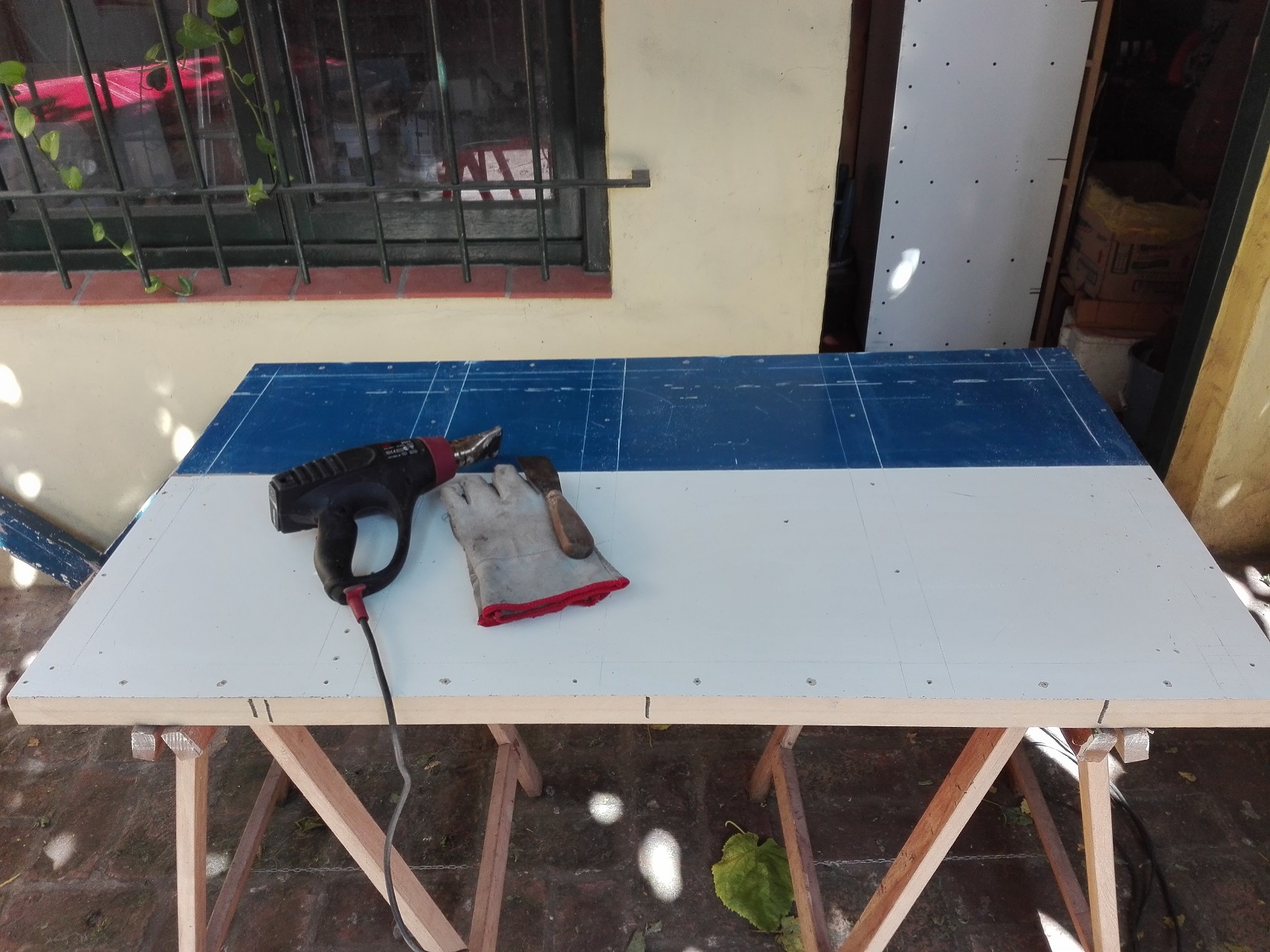

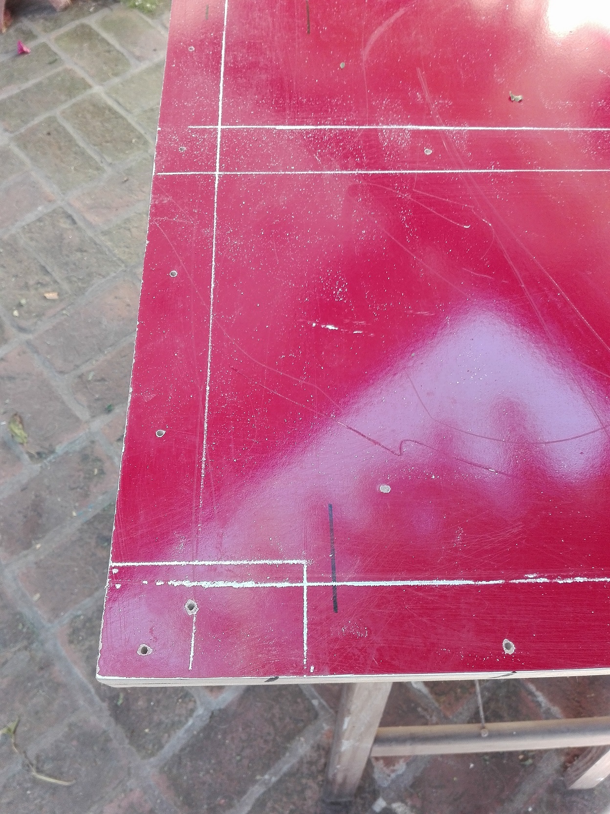

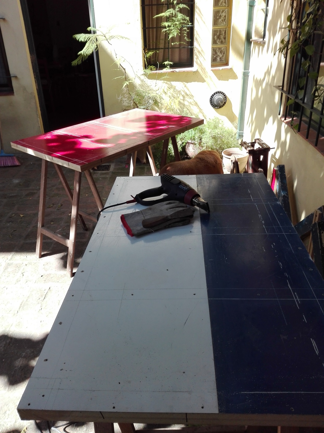

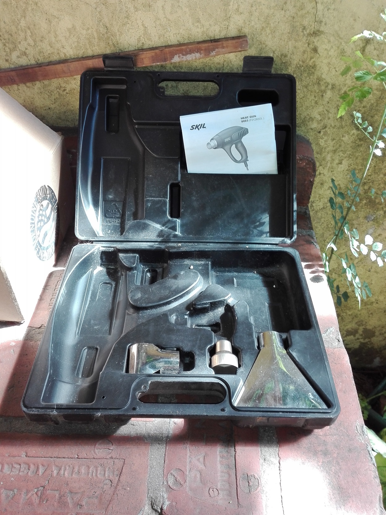

We must eliminate the paint in the areas that will be glued, the task is done with the heat gun, spatula, and sandpaper.

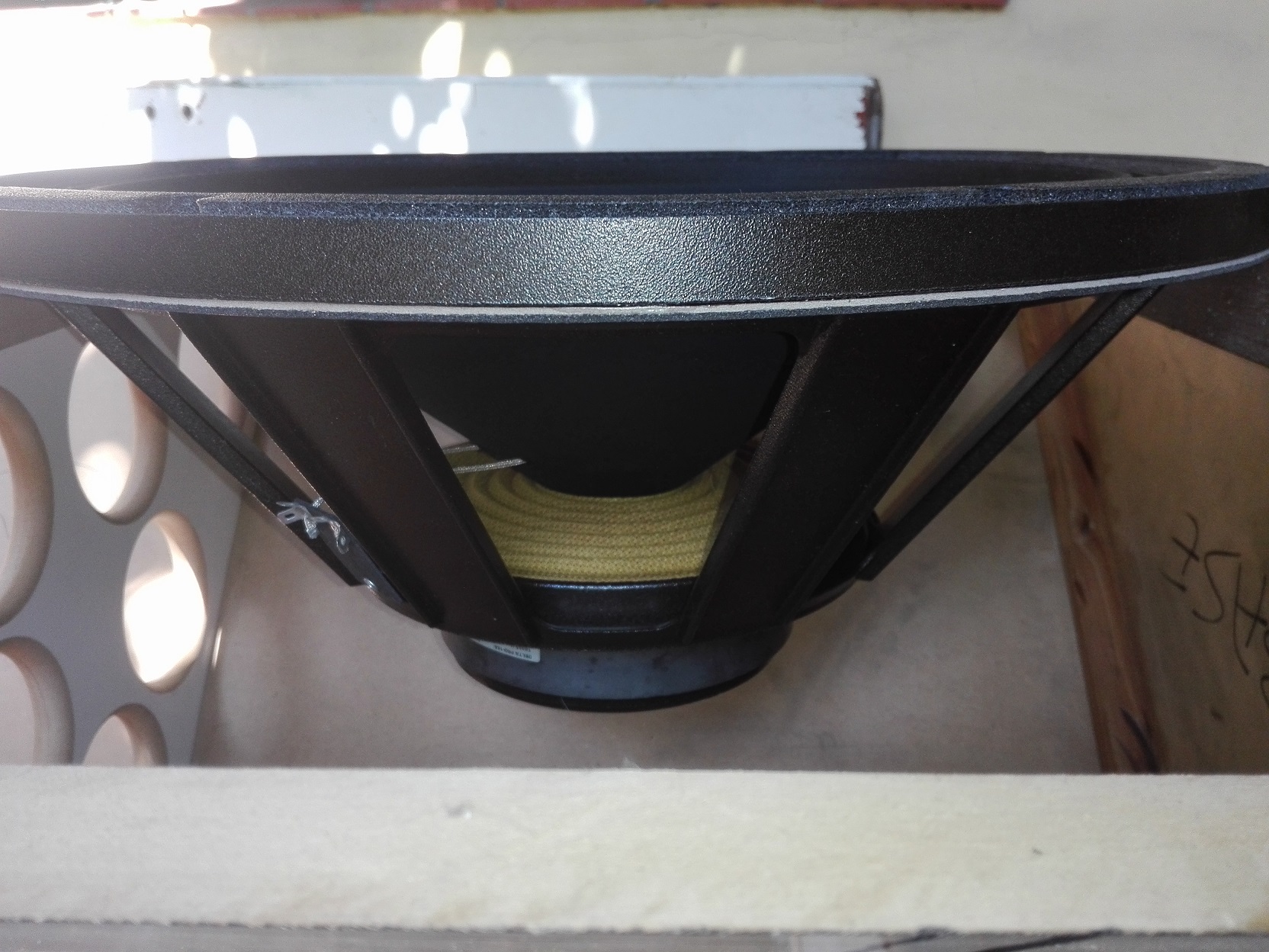

I have another question here, should I place the speaker completely on the outside or make a cavity with the router? The latter will weaken the deflector if it is too deep .....
Deep 1/4 ? 1/2 ? 😕
What do you think? Any suggestions ? 🙂
