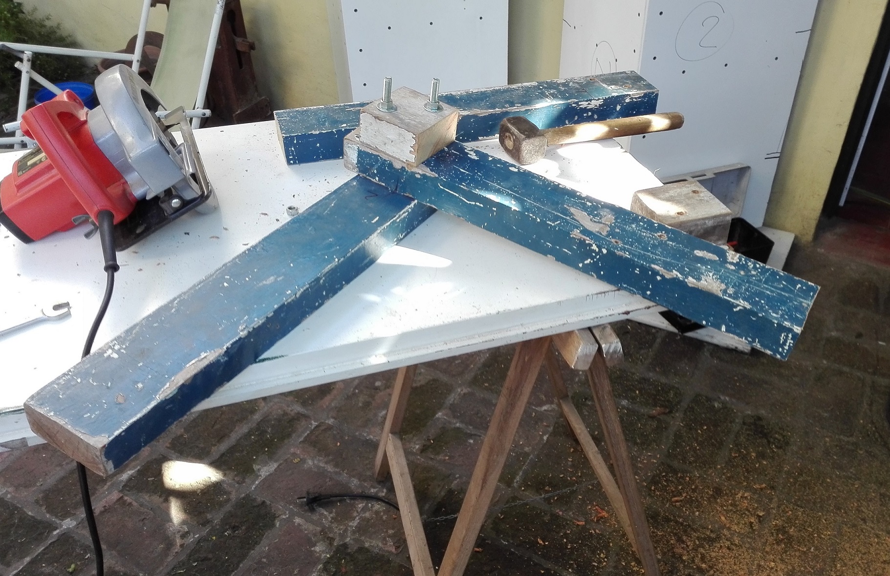

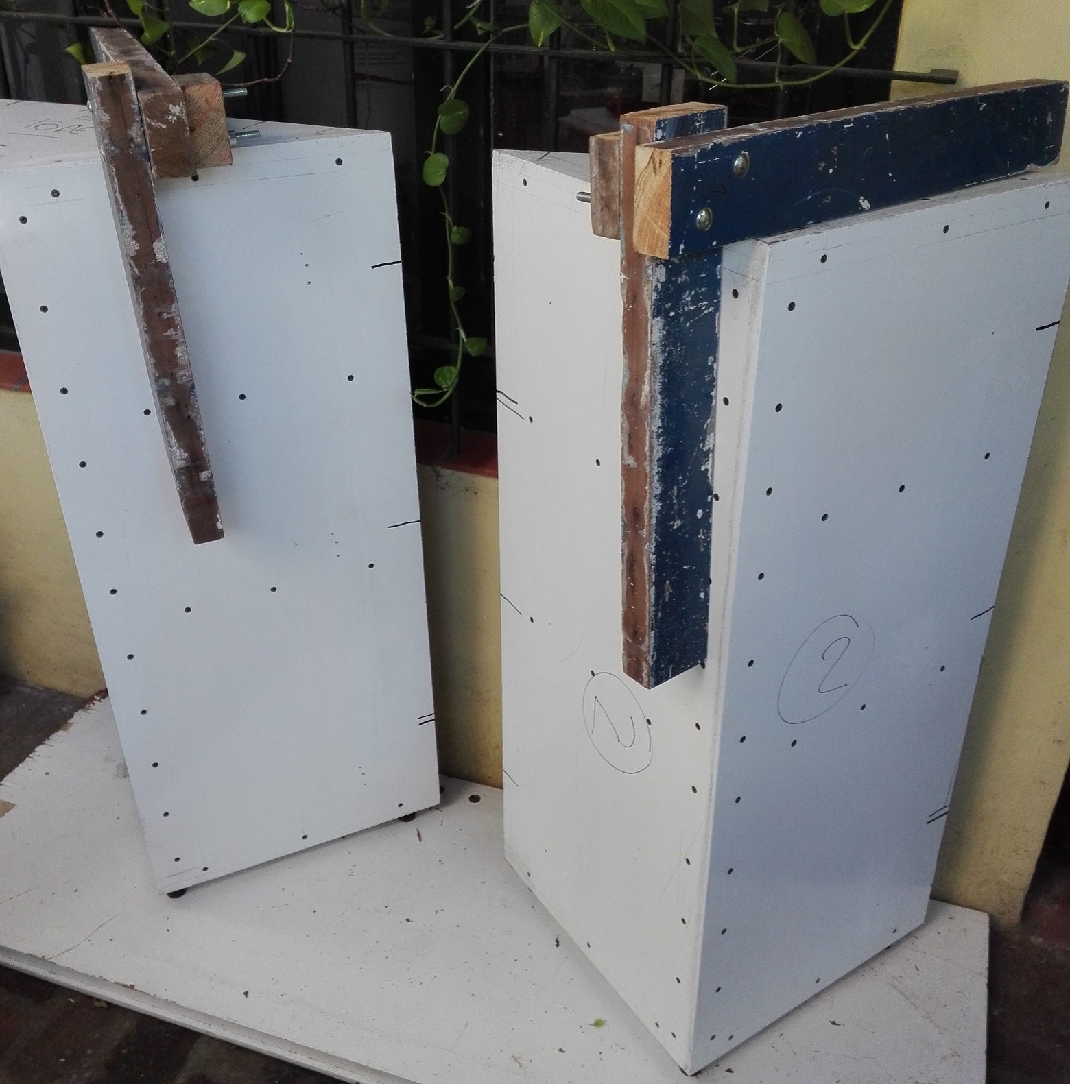

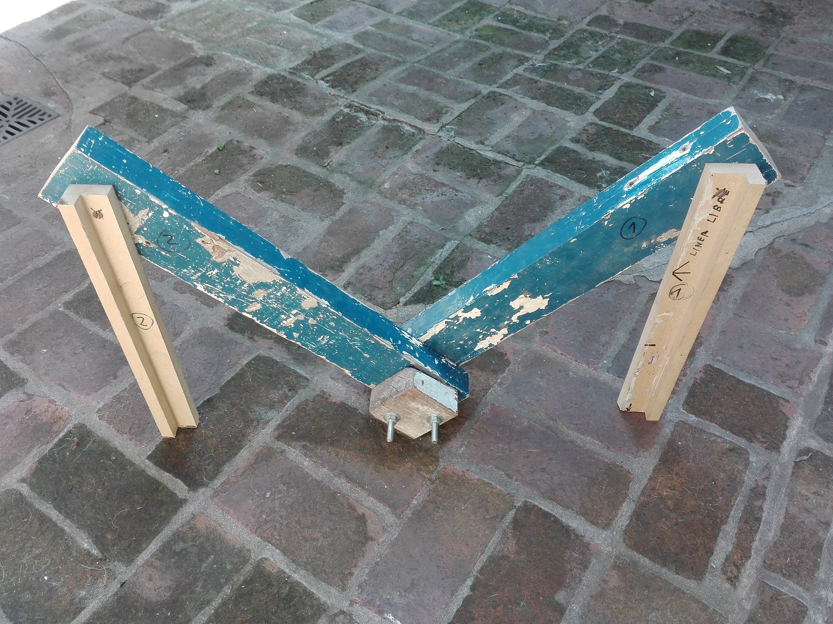

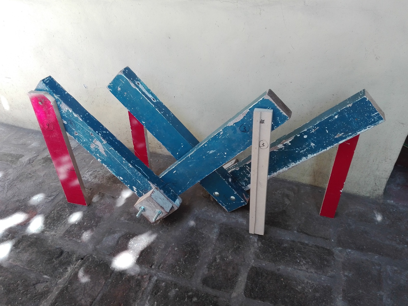

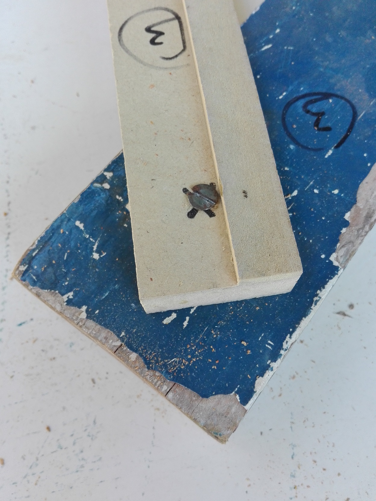

For now I dedicated myself to building two supports to work in the cabinet placing it horizontally.
They are finished.
This has been "child's play" compared to the rest .....😉

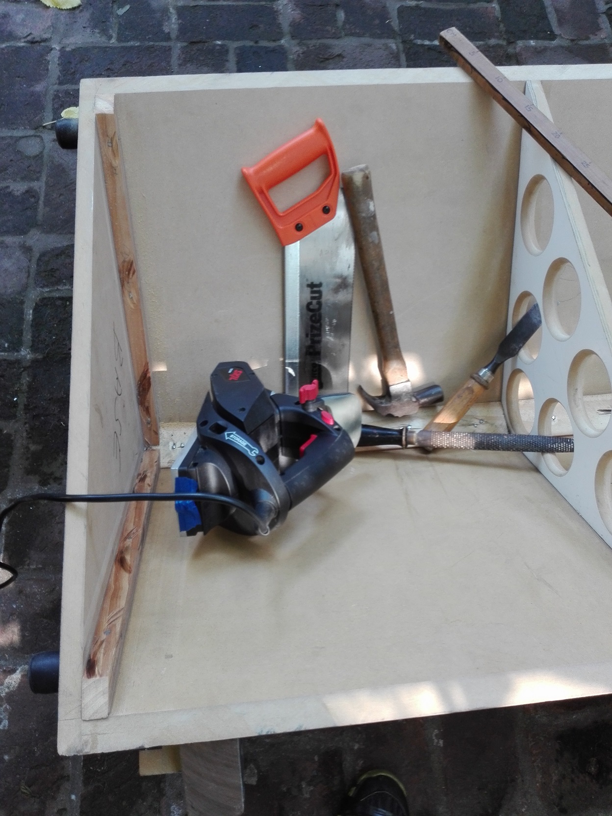

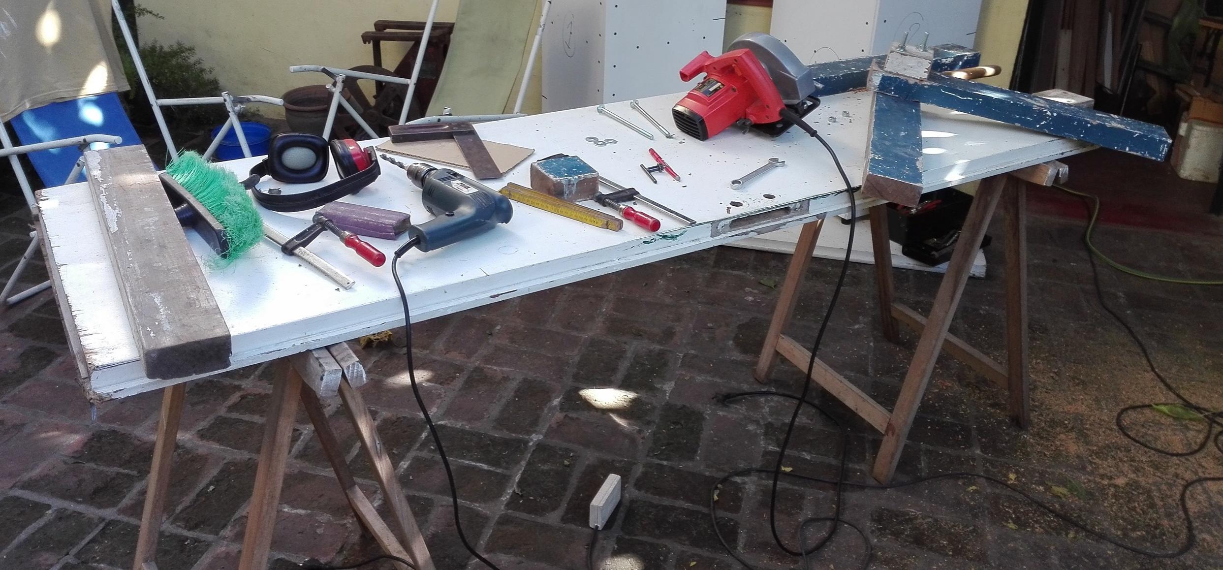

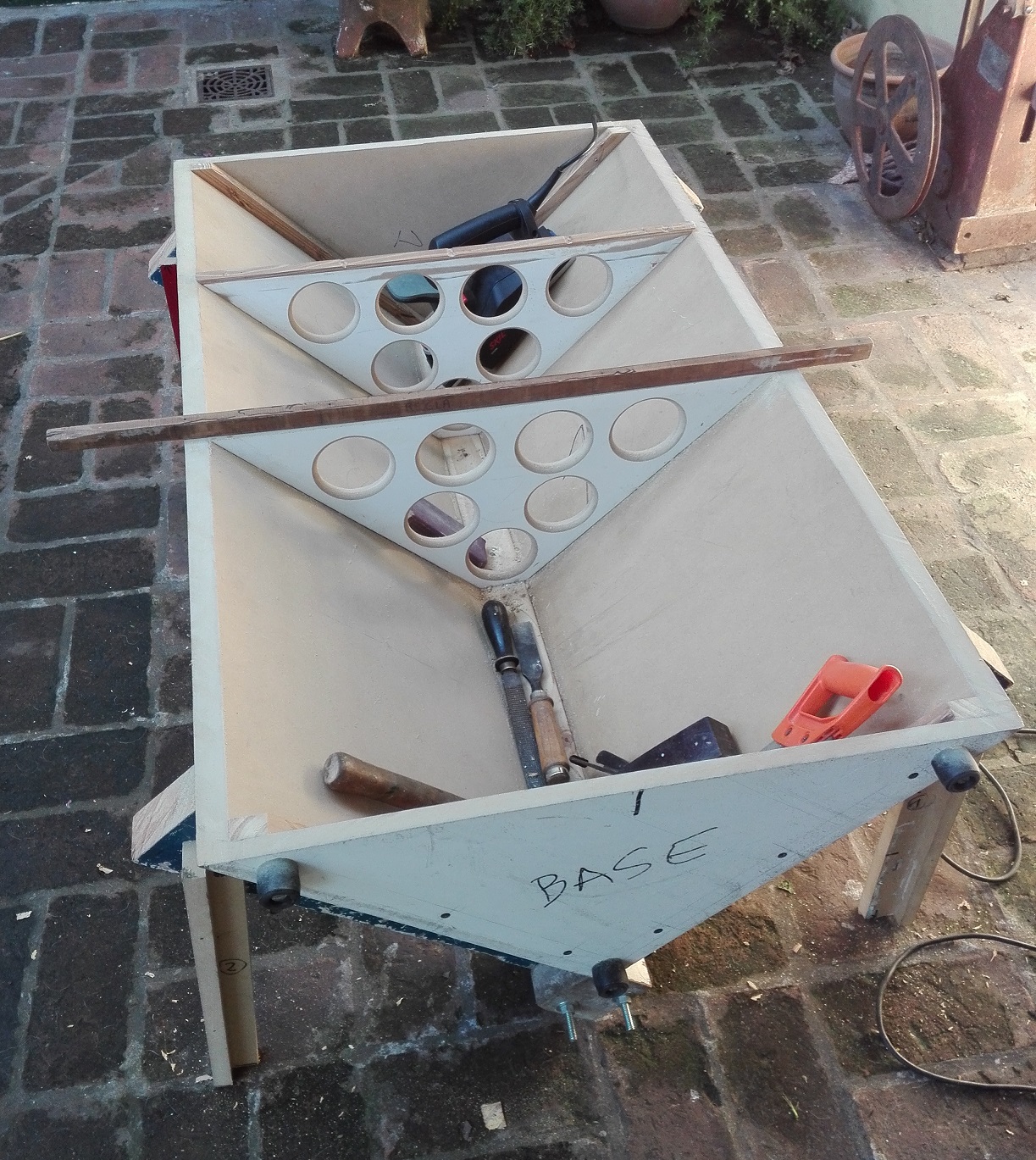

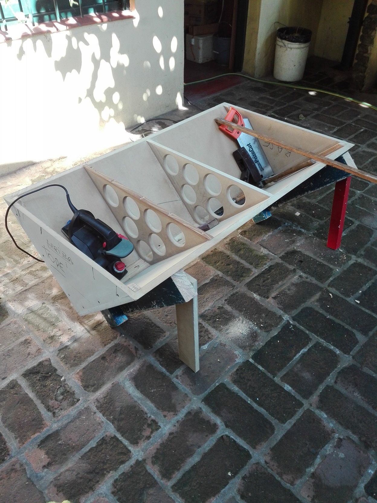

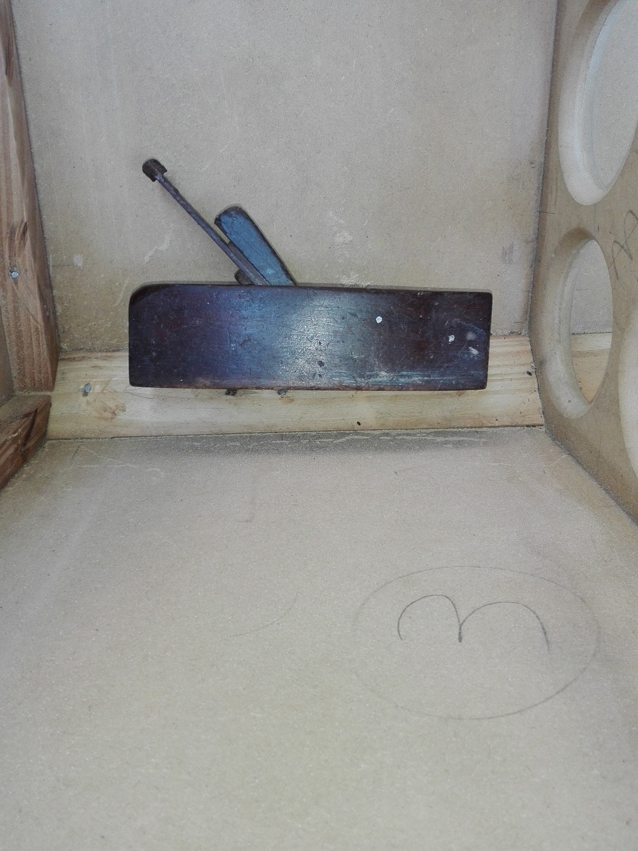

A lot of rain again, but it has already started to dry and I'm working again.
This step is about achieving the most perfect plane possible to assemble with the front panel.
The electric brush is useful but you have to make many passes of little disguise (0.5 mm is the minimum) because if you pass there is no return ....
In the corners I use the traditional manual brush, chisel, etc. and then sandpaper.
In this tool the method to regulate the depth of the blade is very unintuitive, but once you learn it, it is incredible .... if there is interest I could do an explanatory drawing ....🙄

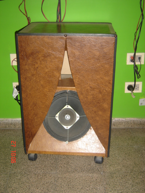

I thought that the speakers of this Eminence series have the "wing" of the classic "accordion" cone, it is a cloth covered with a semi - sticky material, it looks a lot like asphalt, you know what it is?
Don't know if everybody used the same petroleum based chemical by C.P. Moyen as Lansing/Altec/JBL, but here's the modern water based version. Note both versions dried ~clear, so the color of the cloth surround dictates and why some are brown, red or black: https://www.parts-express.com/pedoc...9111X1517312X2dd27f09a5d3f2df0a44439528787efb

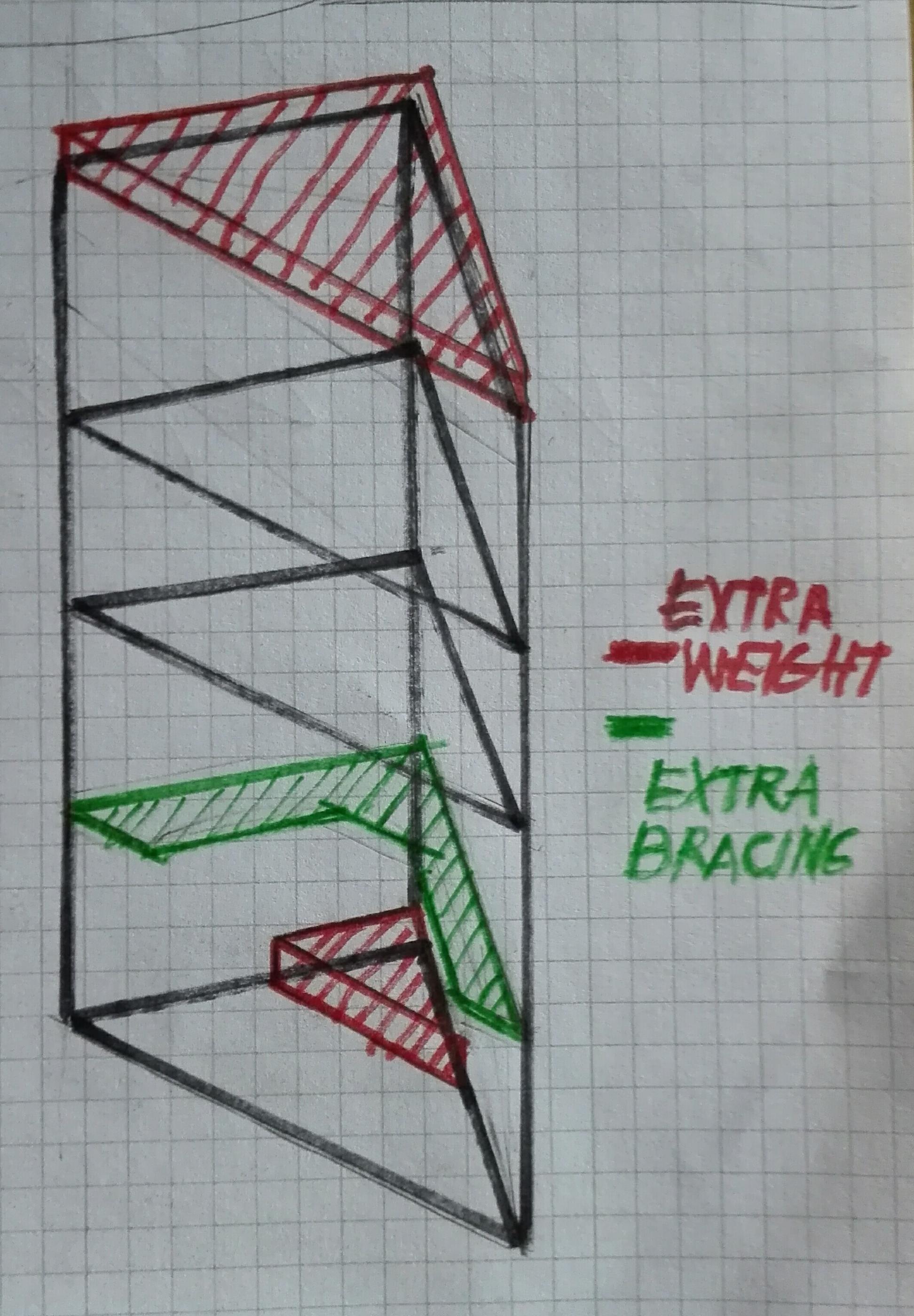

GM, (your nick inevitably refers to cars) your recommendations are very logical.
So I've thought about refocusing the lower part of the cabinet, (where the speaker will go, see bracing in green) should bear most of the pressure of the speaker diaphragm. (Is this so the air pressure of the interior will be distributed equally among the 3 compartments? I tend to think this last, but how will the filling affect?)
I will add a reinforcement there (green in the drawing)
The total weight of the cabinet, being a prism of five faces, would be badly distributed. The front part is very heavy (almost 8 kg of the speaker and 24 kilos of the frontal panel), then, when supporting it on the floor it will be almost in balance!
To compensate for this (distribute the vertical forces) I will add marble plates in the back corner of the base (red in the drawing), and it would not be bad then another marble plate on top (red too), as you say .
GM
FMC ohhh, no! you are GM ! 😉
Thanks for the link, I think it's about this water based product, because it's not too sticky, rather it gives the feeling ....

No, just can be an added perk if done with this in mind. 😉
Hmm, missed some earlier posts and just now getting around to simming it as an offset driver in HR, but no clue how much acoustic resistance the drilled brace plates might effect performance, so while it's long enough to have 1/4 WL resonances, not sure how much gets damped, though in theory the two ends are high pressure points, another good reason to have the massive weight on the top.
Note that best to double up the bottom plate if not sitting hard on the floor.
For future reference, high aspect ratio cabs should ideally be braced along the line with with boards or similar on edge and tied together with a cross brace to help form the driver motor brace, leaving an otherwise open column.

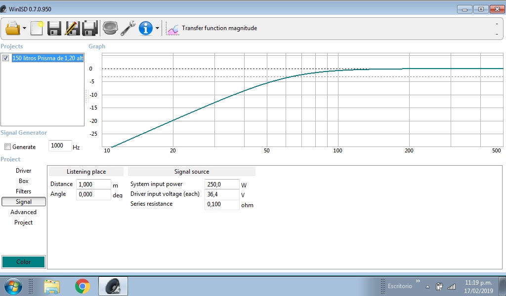

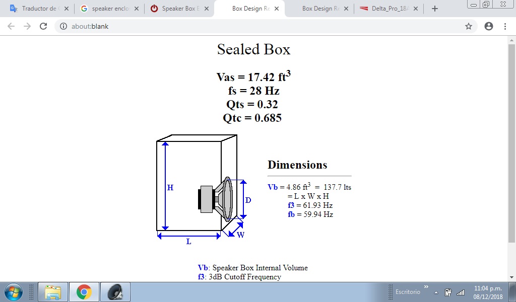

Anyway, noticed you list it as 150 L, but HR says ~128.3 L before subtracting the driver's 796 cc, internal bracing, any added blocks of weight, so looking at a ~40 Hz F6 in 2pi space. Seems kind of high, so is this going to be enough once corner loaded?
GM
The actual volume I have not calculated because I start with the rough calculation of the cabinet, and as you say, should subtract the volume of reinforcements, speakers and other internal objects to know exactly the litraje. But being a sealed cabinet, with plenty of stuffing inside, it does not matter.
For all that I have read, the virtual volume that adds the padding is very controversial, so maybe a bit of trial and error with it is better when everything is finished.
That supposing that it is not satisfied with the result.

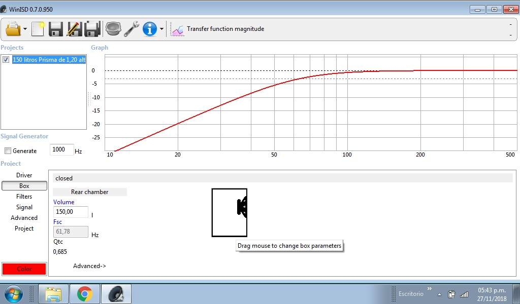

Then, the definitive and exact QTC will be an unknown, but I imagine that it will be something below the ideal of 0.707 "maximum plane".
Remember, I'm looking for an overdamped cabinet result for 20 to 40 hertz, QTC between 0.5 and 0.6 maybe.
GM
Win Isd is throwing F6 ~ 50 hz.
Applying 250 watts, power compression through.
Well, but I guess in a sealed cabinet that does not matter at all

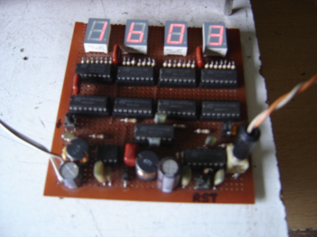

It looks very creative! I did not think that so many ICs would be needed in the circuit ... I guess there is a conversion with a DAC, to convert the pulses of each turn to bits for the display...
Se lo ve muy creativo ! No pensé que se necesitarían tantos CI en el circuito .....supongo que hay una conversion con un DAC, para convertir los pulsos de cada giro a bits para el display
No, they are 40192/3 counters plus 4511 display drivers (a pair for each digit), a L4971 SMPS and some pulse conforming/debouncing.
