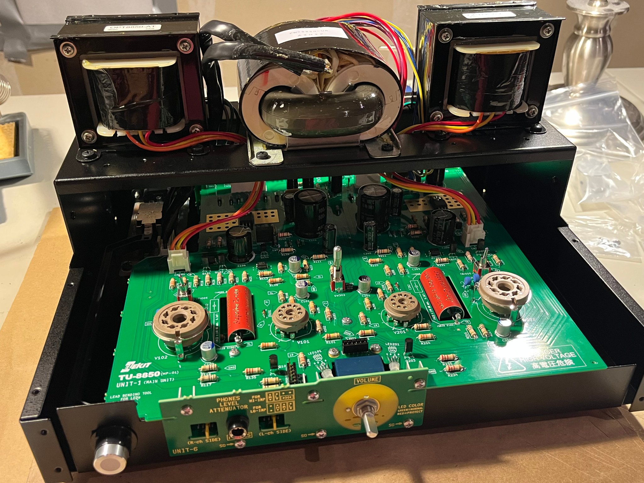

I have just completed my build of the TU-8850 with Lundahl opt. Currently running EL34s sound great so far.
having built it I now would like to understand how the circuits work. Is the a description any where that describes the circuits?

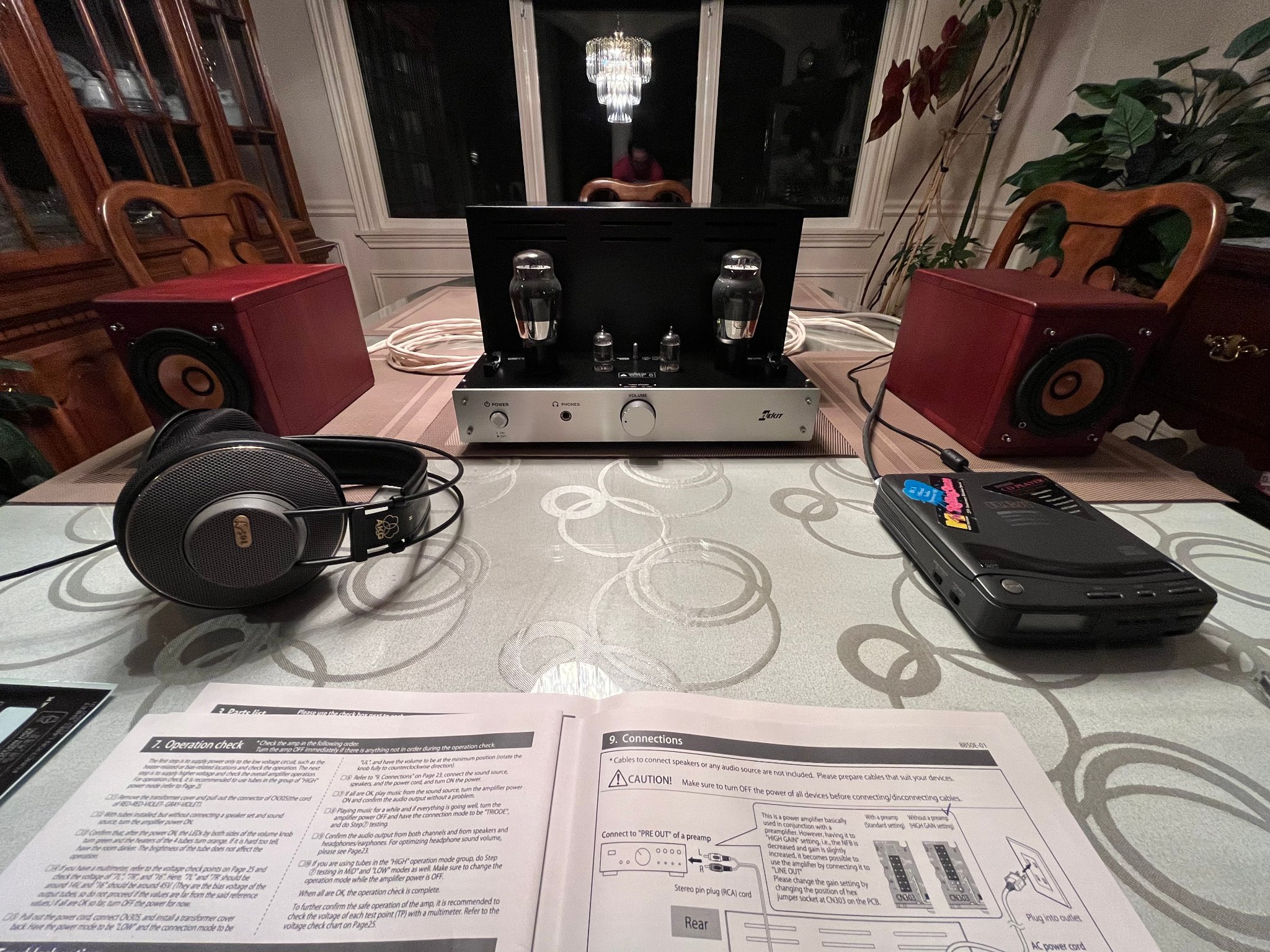

Oh man! Finally got around to building this kit, after having purchased it back in spring! So three-dimensional and natural sounding, I'm so elated listening right now! 🙂 I was worried my low-power 6L6G tubes wouldn't have enough oomph--and they are definitely limited in output--but the three-dimensionality and lifelike tone are making me not care so much. I'll try KT 170 tubes in high-power mode down the road, but for evening relaxation, this is truly an analogue bubblebath. 🙂 Happy listening, all!

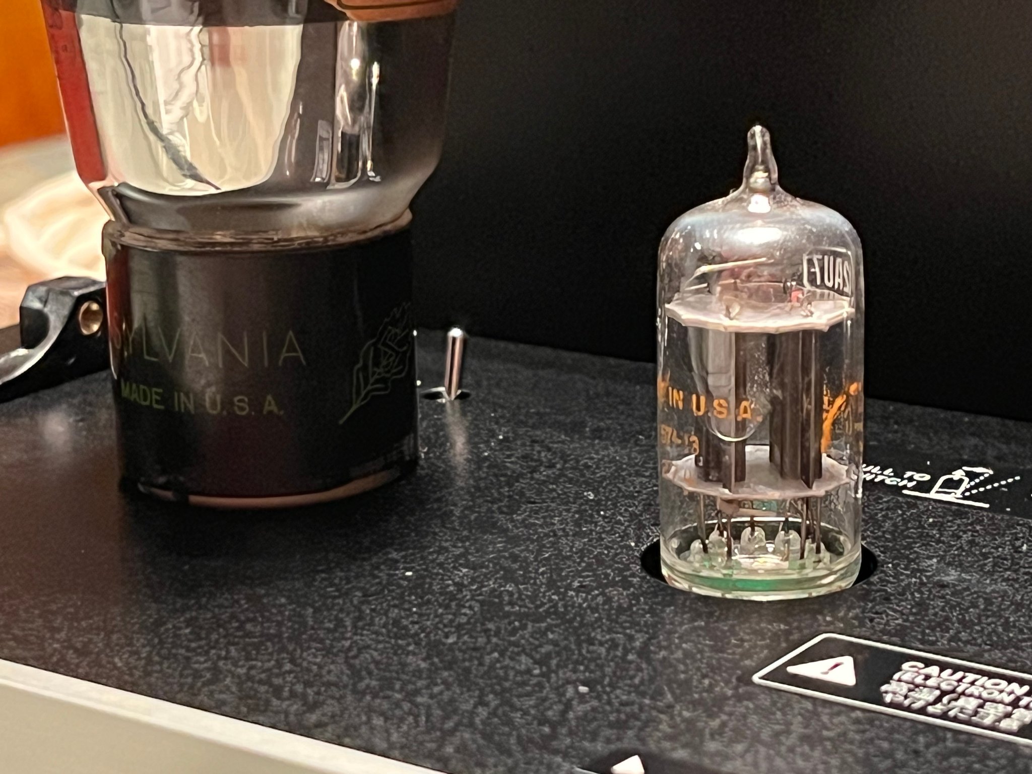

P.S. I used Jantzen 0.1uF Superior Z-caps for the coupling caps and got the Alps 100KAX2 Blue Velvet upgrade volume pot. The tubes are Sylvania 6L6G and RCA 12AU7, both vintage made in the US. I'm running the amp in low power and triode mode.

I'm putting together the TU-8850 kit and it is going good so far. The question I have is pertaining to the plastic rod and its attachment to the power switch. The manual warns of too much force breaking the switch. It works as is, but not sure if it is supposed to have the first part of the switch actally inserted into the plastic rod. It seems like it will require much force to insert as it is very tight. Anybody know the correct position. The manual isn't very clear here.
Yes, it requires a scary amount of force to seat the rod in the switch. Just be gentle but persistent.
Thanks Victor.I will install the Rob before install the power PCB on the chassis
Gentle force is ok

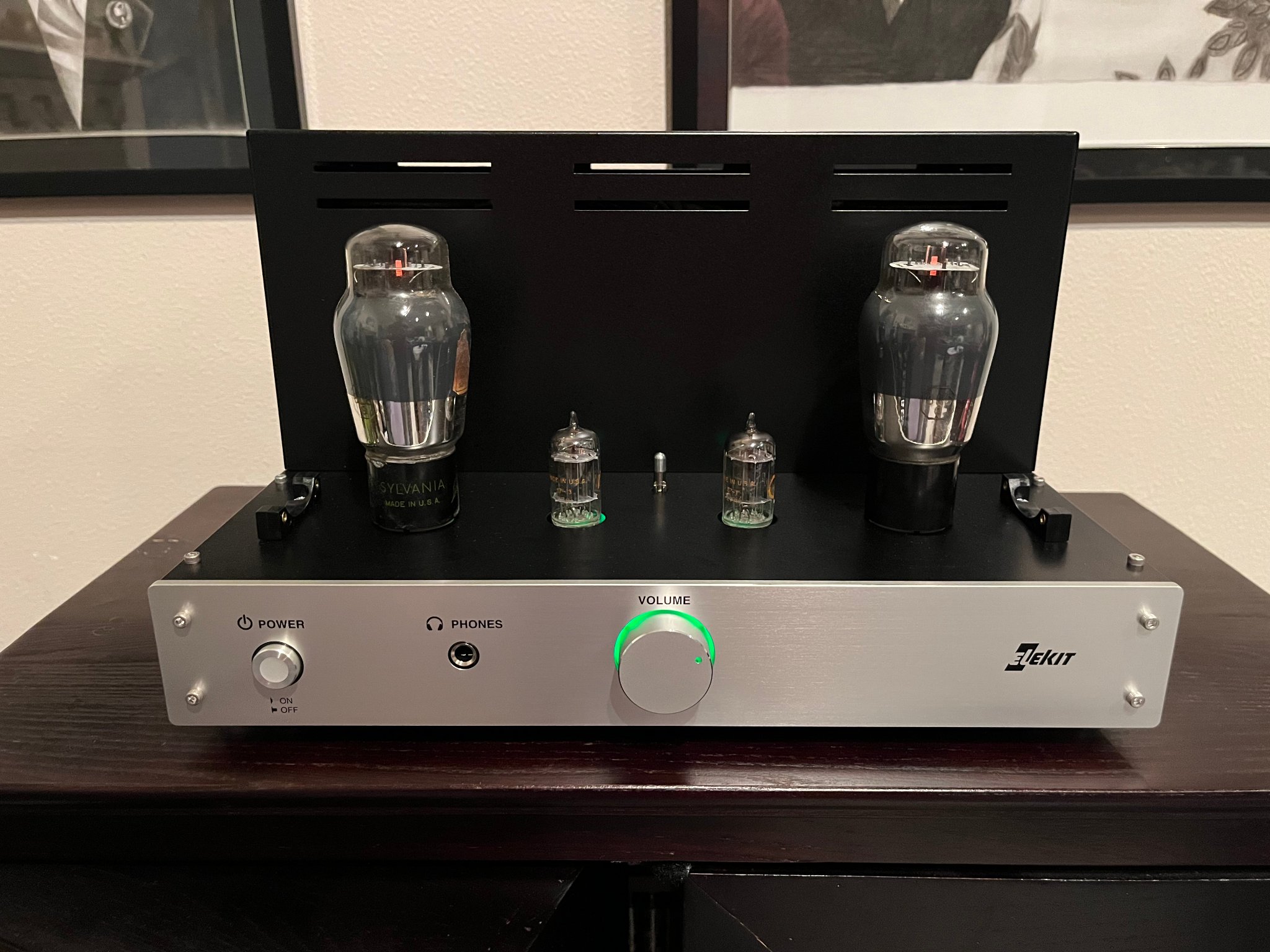

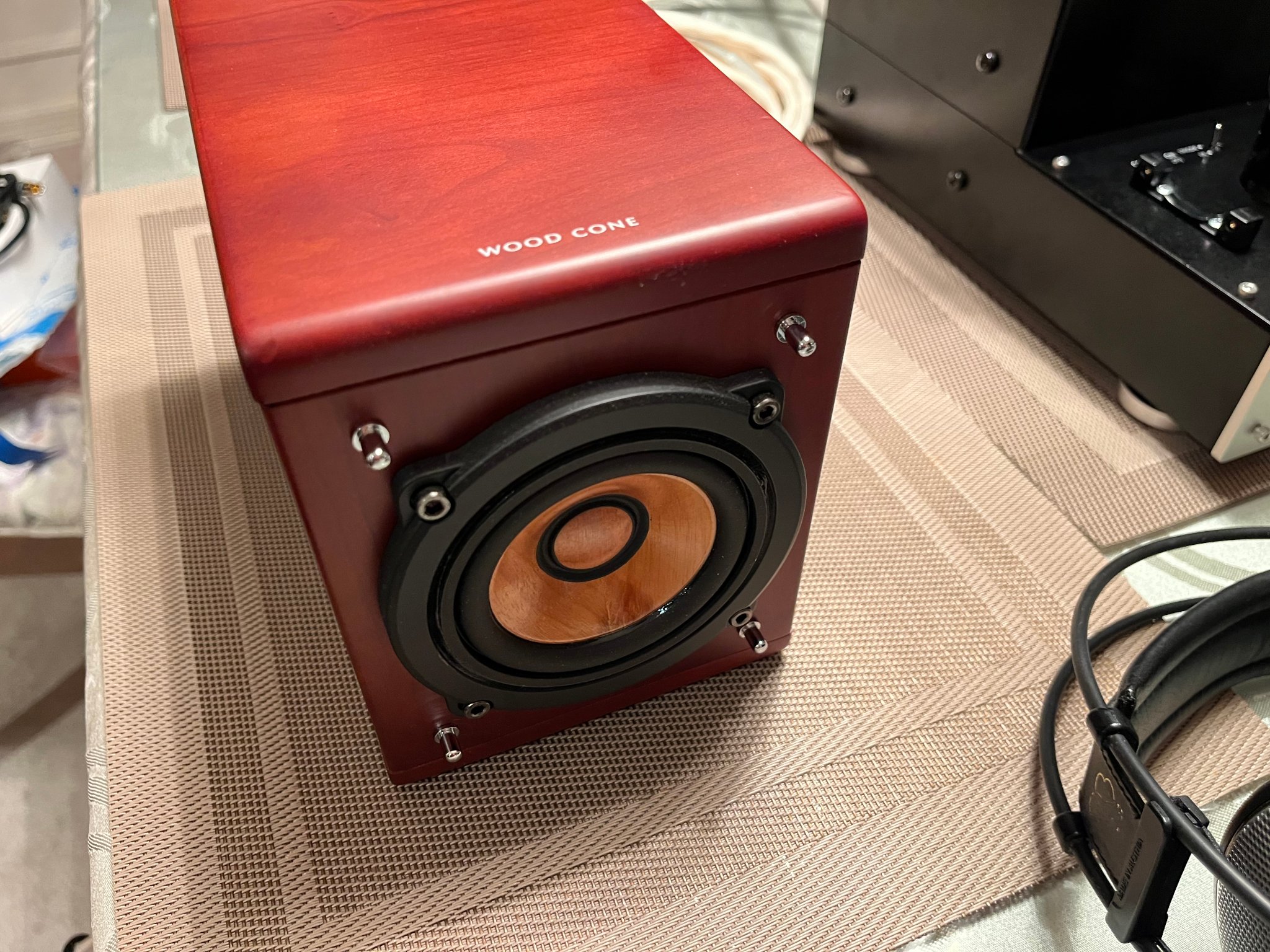

Well I guess I'm another happy Elekit owner. Fired right up with green light and initial voltages checked out. Been listeniing for an hour or so using CD player for preamp and Little Bozak Sonoras speakers. I haven't checked Low and Mid or Triode, yet. The amp is dead quiet with the Sonoras, that might change some with the Fortes IV. This was a fun kit to build and the performance is excellent.

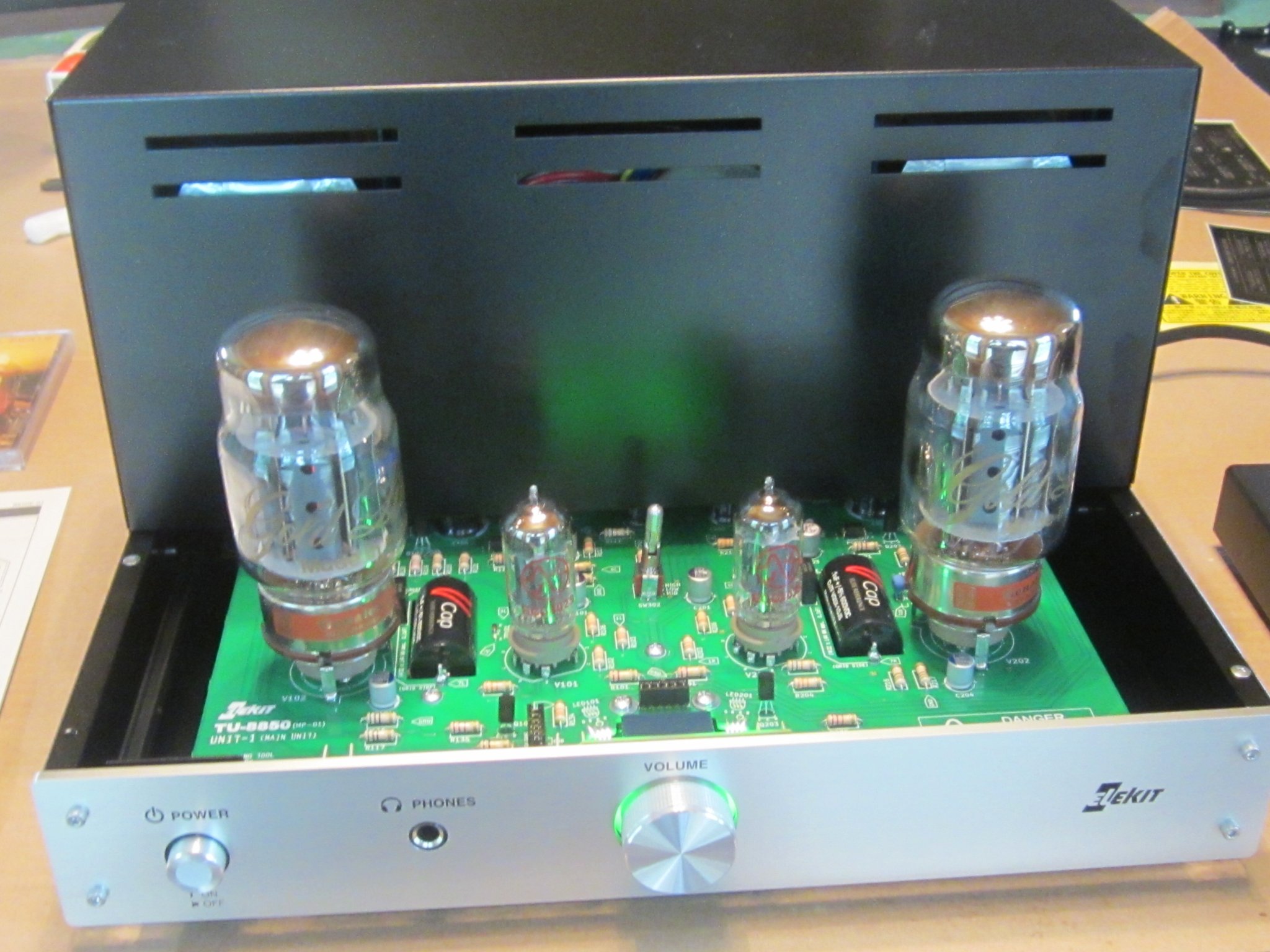

So, this morning I went ahead and took the rest of the voltages. They all are within range except TP 2,3, and 4. Variac set to 118V inputs shorted and power resistors on outputs. KT88 installed, Mode is High and UL. Using new JJ ECC802 tubes for drivers. Should I be alarmed. It works great and sounds great.
TP2 Should be 65VDC I read 72
TP3 55.5 76
TP4 48.3 74
TP3 55.5 76
TP4 48.3 74
Well, after going back to the book and checking voltages, I found out I messed up the numbers. All the voltages are within range. I use to be good at math, too. Anyway, I have about 10 hours on it and I think it sounds very musical. Happy with the purchase.
