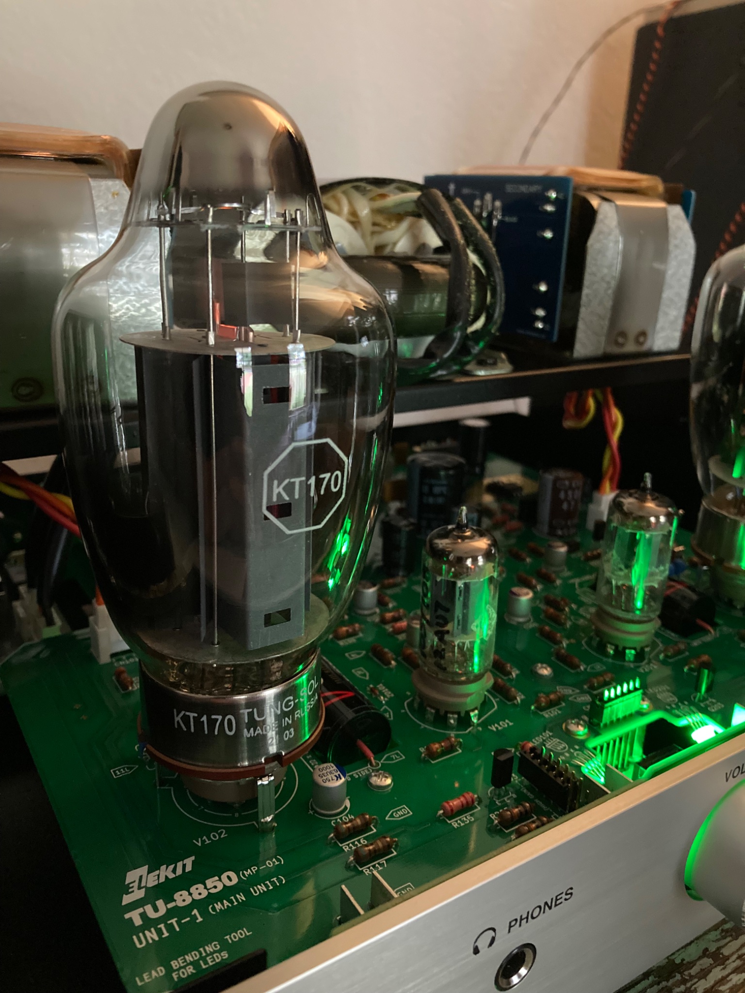

Not to get off subject, but, I have a tube amp that runs in pure class "A" output. I have been listening to the Tung-Sol KT120 tubes for a while now and like them. My question is what noticeable differences would I hear? Thanks!
@Jarous How do you like the sound from the KR Audio KT150's? I know the price for a pair are higher than giraffe ears..LOL
From my understanding, the SQ from the Tung-Sol KT170's really shine after 200 hours or so. I have 2 pair coming here today for my tube amps. They will be running on pure class A output from amps. I purchased them from Tube Depot here in the USA. They offer a 24 hour burn-in on them at a small charge. We shall see. I have been using the Tung-Sol KT120's and have to say they do sound good to me in my system! Hopefully the 170's will be a step up 🤞

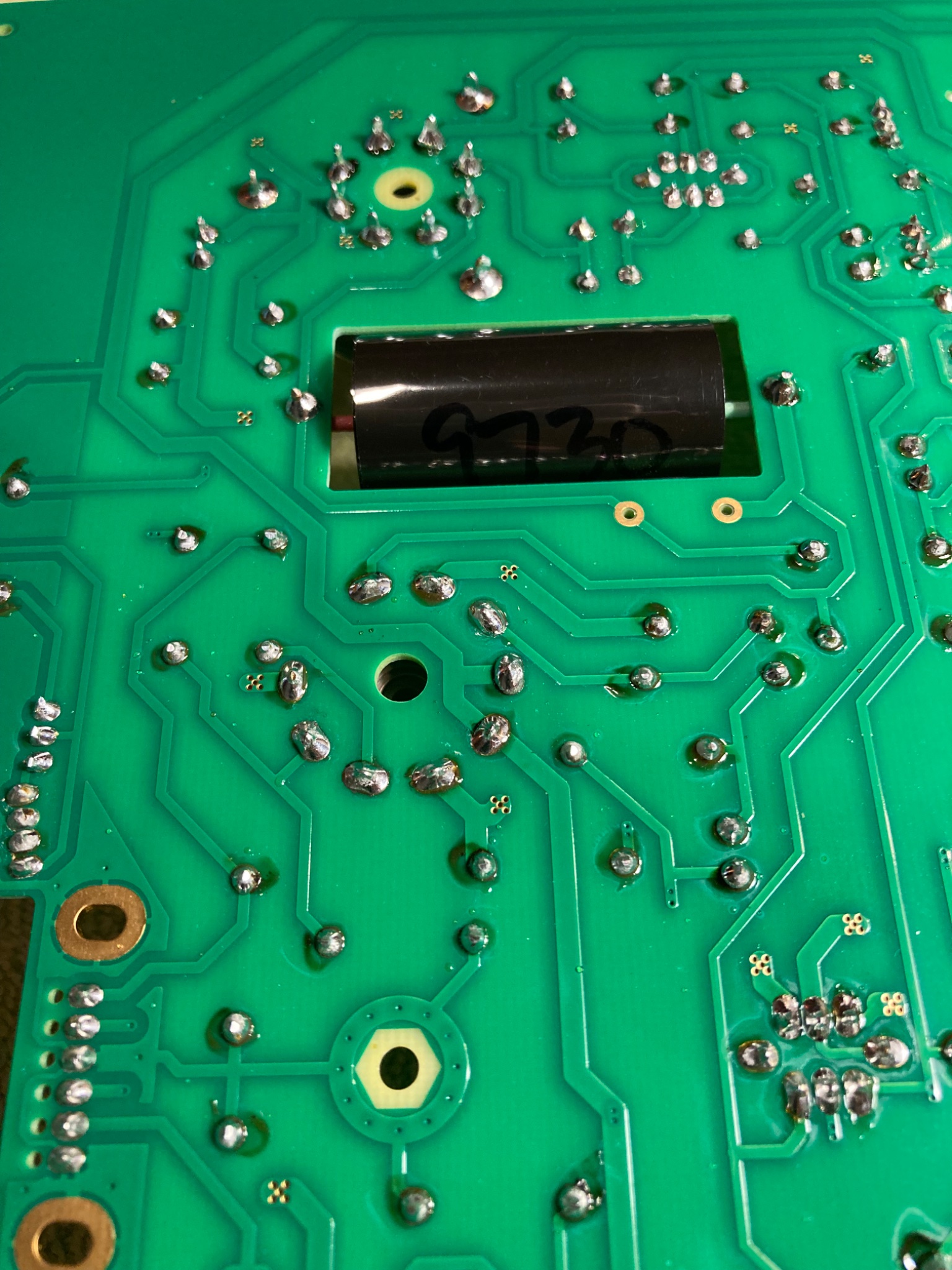

Hello all,
I’m nearing completion of the 8850 kit I got from Victor. A question — what’s the best way to solder the coupling cap leads to the pins in the circuit board? I’ve looked at the photos in the thread, but the resolution isn’t great. As a beginner, I’d like to do this right, so I thought I should ask. Note, the more detailed the answer, the better, please.

Hi Greg. I didn’t use the solder pins that came with the kit. I just soldered the cap leads directly onto the circuit board pad. I figure one solder point is better than having two solder points on each side of the cap. Less to go wrong and easier to remove if needed.
Here’s a couple pictures. I hope the resolution is good enough to see how it looks. Cheers Thomas

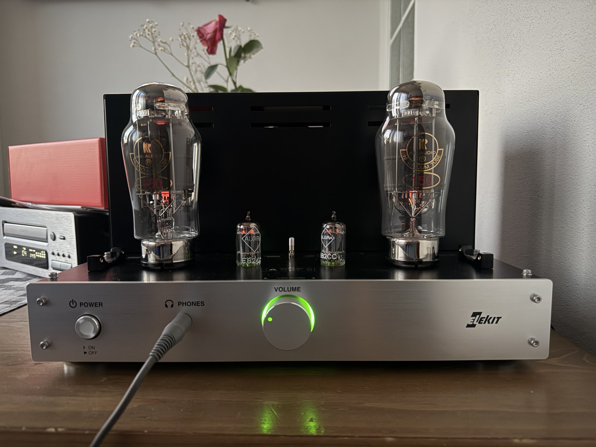

Dear Friends, thank you for your recommendation about TU-8850! It is very good alternative to TU-8900...in terms of more power.
After tricky trouble with one triode-ul switch, things are getting better now!
One of the best combination ALGRA E82CC + KR Audio KT-150, love them in Ultra-Linear mode!!!
Lundhal OPT, Miflex KFPM capacitors...
