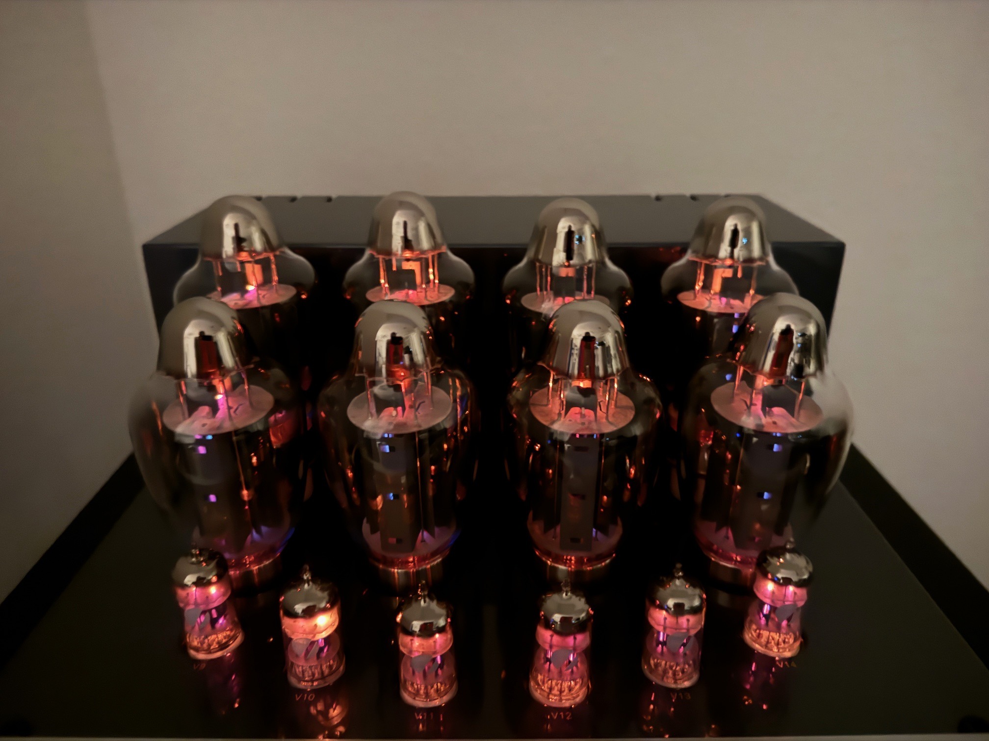

In my PrimaLuna DiaLogue Premium HP integrated (night shot), the KT-170's are warm, mid-range spooky and what a bass slam. It's about the design and voicing.KT tube is not warm
