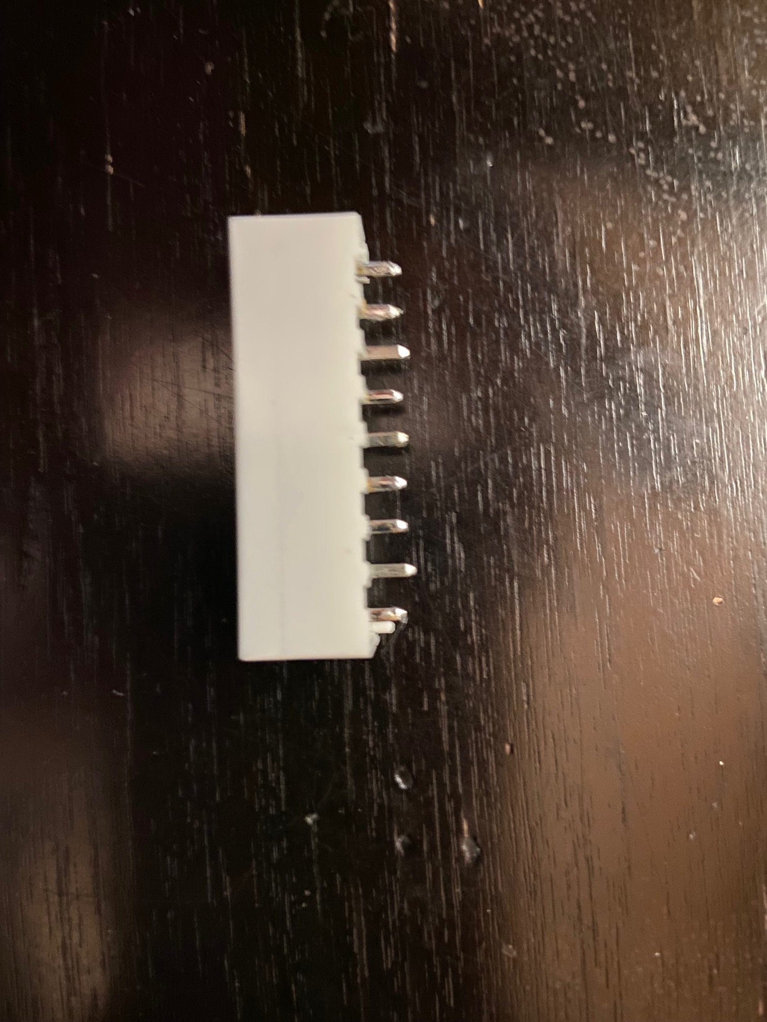

Argh, I am such a moron. After going through all the parts I had left over I realized I installed the circuit board for the 100V power instead of the 115V power. I've removed all the parts and am in the process of installing them onto the correct circuit board. However, I noticed the pins on the 9 pin box VH connector are now irregular. I'm assuming they've shifted from the heat of soldering/desoldering. Is this ok to use? If not any idea where to get another one?
